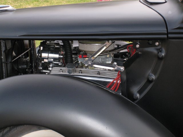

  1. I used the stock hinges and support . Got new ones in ss frombob drake. Look in there cat. if that don't help let me know .
  2. Hows this ?

    Great!! I need these (I don't have any hinges or springs)
    Got the part numbers by chance??
    There seems to be a bit of confusion between sedan & pickup
    (or is that just me?)
  4. Bob drake has them listed as 91a-16796/7 , and I used the 91a-16782/3 (40-41)support arms . 38-39 only used 1 arm but I welded extra brace to hood and used one on each side . both were not listed as pu but fit. bob drake 1-800 221 3673 . Call them and ask if these will work but this is what I did .

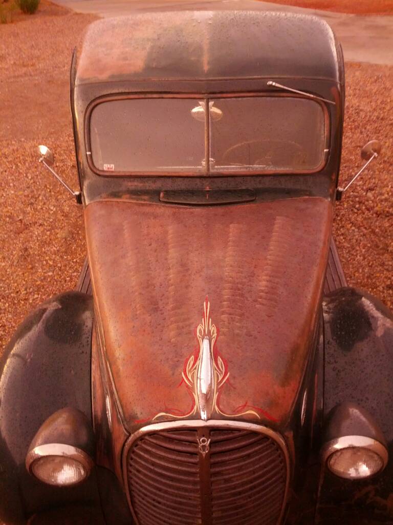

  9. Rainy day in Vegas today.. Bad Bob your trucks looking good.

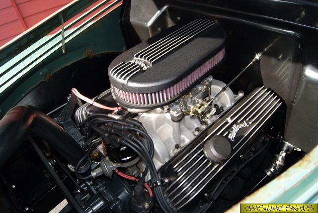

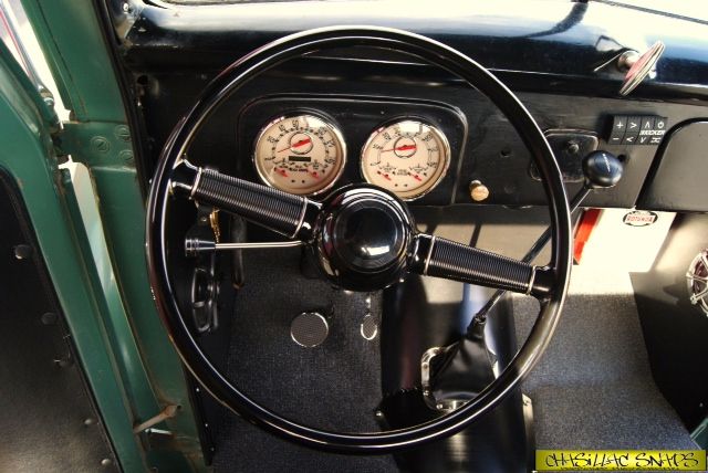

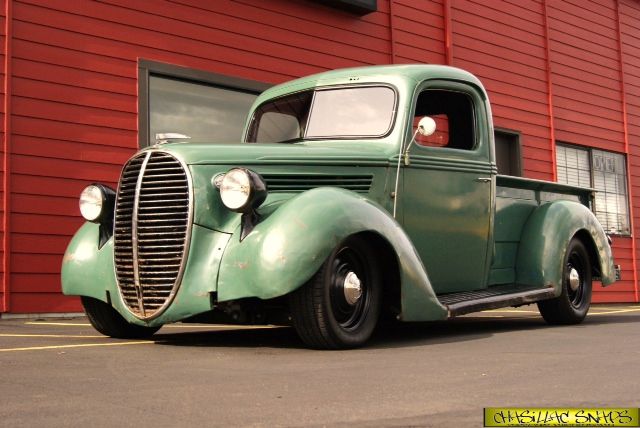

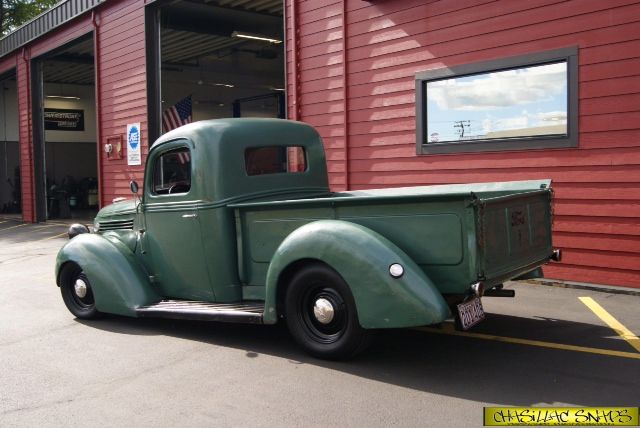

    Can I join too?! I have a 1938 that I use as my driver and shop truck. It has a 289 Ford w/C4, 9" rear and Mustang II frontend. I found the body at an old farmer's estate and left it as I found it. I drive this thing all over the place-its super dependable and a blast!!I've always loved these pickups, even when everyone else thought they were ugly!
  13. 38shoptruck Great looking truck I've been thinking of going black on black (wheels) even more so now. Cool ass truck.

    A very cool '38 mate!!

    Thanks guys! All these trucks posted are bitchin'

    Sweet looking shop truck. Green with gloss black looks awesome.
