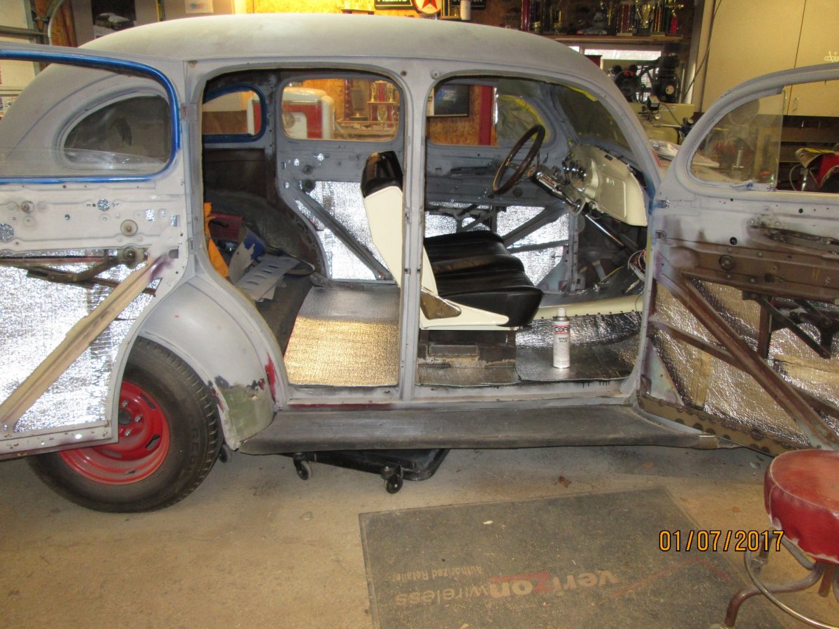

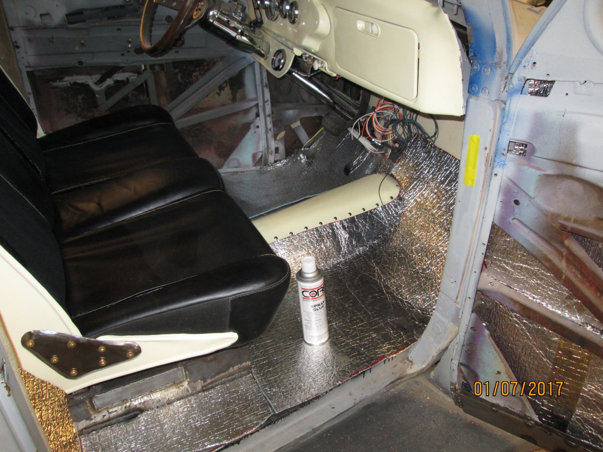

    Hey I just wanted to give some publicity to an Alliance Vendor E Z Cool. They are listed under Automotive Insulation if you are looking for them. I purchased a roll of their insulation for my project the shipping was fast and the product is Great to work with! Below are some pictures of the mocked up insulation I still have to glue it down.

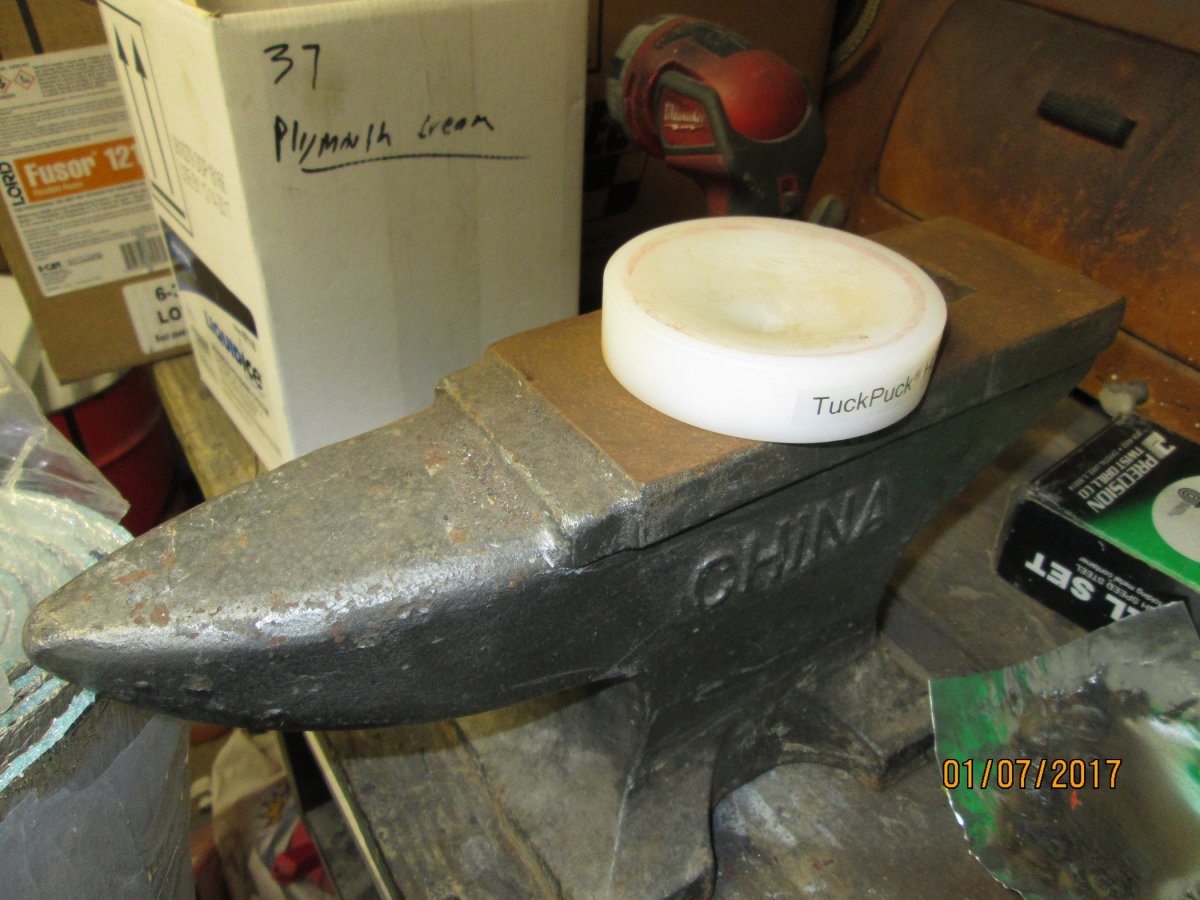

    I also ordered a Tuck Puck these things are Great for metal shrinking and take up no space I usually would go with the traditional stump, but room is a consideration and you are still hand shrinking the metal. here is a link and a pic of my Tuck Puck http://www.tuckpuck.com/

    I highly recommend this company Great communication and really nice product. Comes with tape knife and applicator cuts really easy with scissors. Hobo Jim

    OK so I had to try out my Tuck Puck and try my hand at metal shrinking. I started with a piece of 16 gauge sheet metal, yeah I know that's heavy metal. After trying several hammers with no luck I finally went with a heavy ball peen hammer and the metal started shrinking really nice and easy. I had lots of tucks forming and then I went to the planishing hammer to smooth out the walnut size dents. Here is a picture of what I ended up with, not to bad for my first time. I have to clean up the edges to make it true, but overall not a bad circle.
