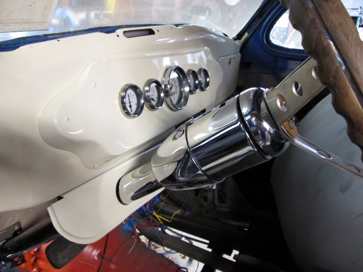

    I didn't have any metal to fab the running board so I started working on the layout of the door panels I am really excited about how this is looking. I have some more thinking as to the finishing details but it is really nice to see them on the doors for the first time.
    This shows how they will flow with the dash and carry throughout the interior.
