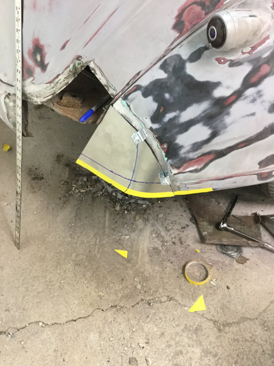

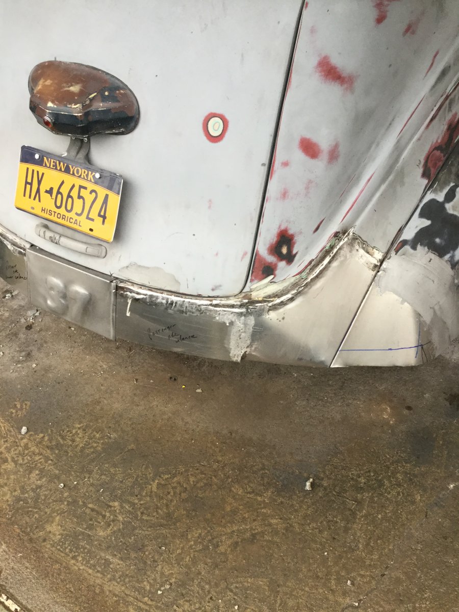

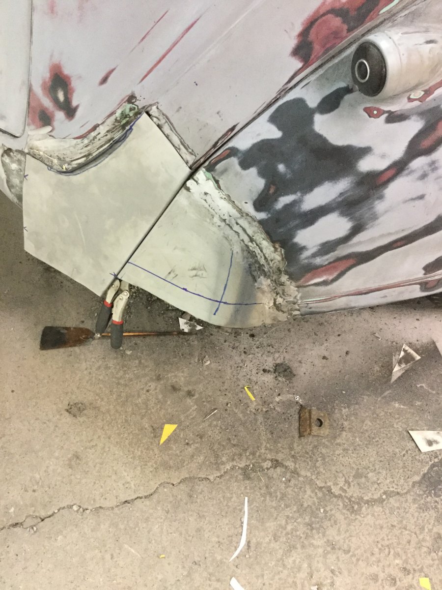

  4. Got the finish welding done on the fender and the final fit on most of the lower valance corner. I will be working on the curve to match the lower valance tomorrow.

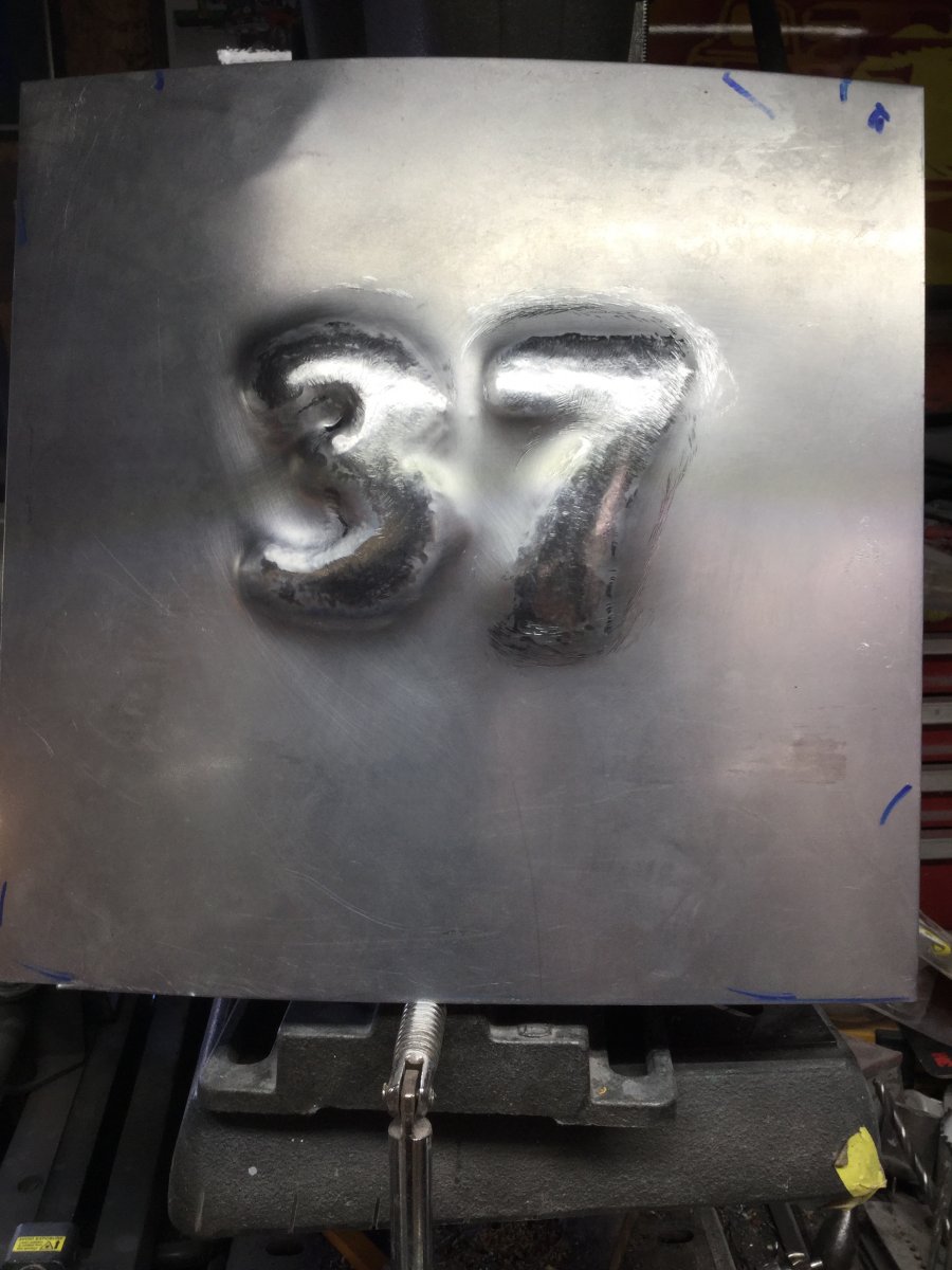

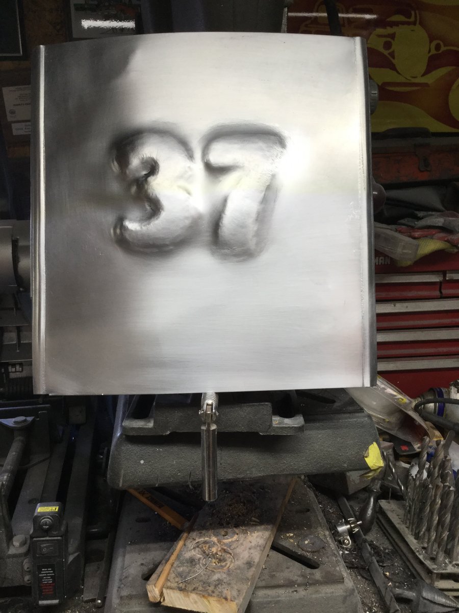

  5. Spent today working on the Center section and the focal point of the rear valance. Hammer formed the 37 in 18 gauge metal then bead rolled the edges. I will be working on the bends and final fit soon. Hobo Jim

  10. Thank you very much I made it the old school way used a plywood cut out a hammer and a cut off trailer hitch pin to form the 37. Then planshed out the imperfections polished with scotch brite. Hopefully it will be installed today lots of welding to do once the garage warms up! Happy New Year to you!

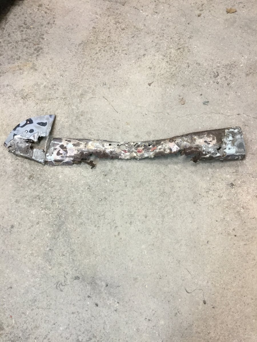

  11. OK so this is the update that I have been waiting for. The fabrication and welding are done on the rear valance! I still have to do the grinding and final trimming but I think it came out fantastic! It went from 3/4 inch of filler covering this
    To this custom designed valance that I am very proud of

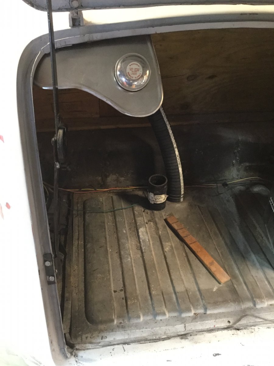

  19. I have been working on the fuel system and in typical Hot Rod fashion using what I had available. I soon discovered that my Ford gas tank and sending unit doesn’t like my Chevy fuel gauge that is in my Plymouth! My solution was to order a new Ford fuel gauge problem solved. My Ford tank was being filled by holding the trunk open with one hand and leaning all the way to the back of the trunk to reach the four inch fill tube. I found a set of Ford trunk supports that were given to me so I modified them to work on the Plymouth. Now the trunk stays open on to the next issue. I installed a flexible filler hose that I routed up to the top of the trunk. I then fabricated a plate to support the filler hose and gas cap. At the end of the day my fuel gauge works and I don’t have to strain my back to fill the tank success!

  21. Hey thank you David for your interest the plate is attached to the factory body supports probably used to support the top panel of the trunk interior. I just bent a angle on the backside of the plate then used sheet metal screws to attach it.

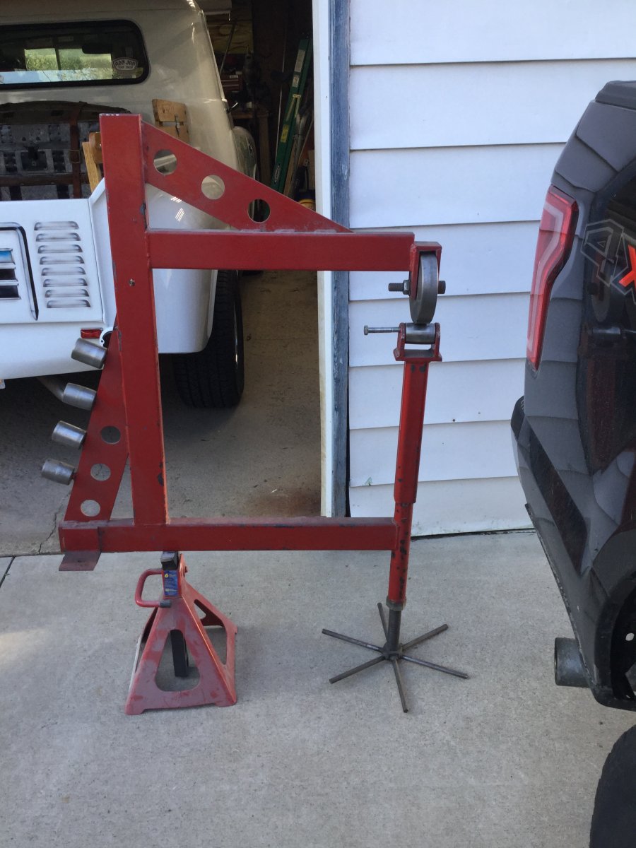

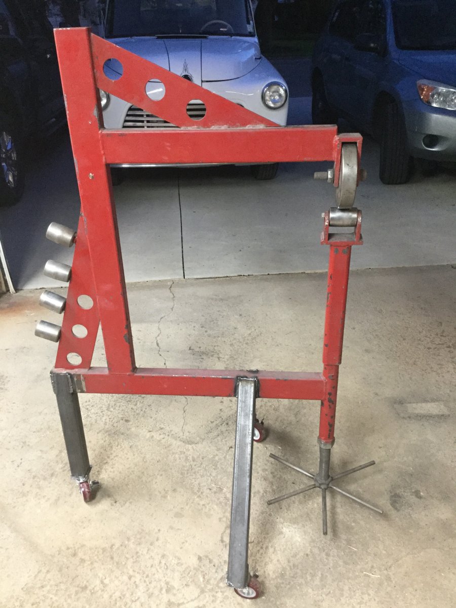

  27. So a couple of weeks ago I went to the Rhinebeck show and flea market. I found a good deal on a bench mount English wheel that I just had to have. Since all my benches are full it was time to fabricate.
    So since I am waiting for my life to slow down with college graduation for my youngest son and going out of town to spend time with my older son and his wife. I haven’t had time to begin the paint on the Plymouth. I decided my English wheel needed legs. A little fabrication cutting and welding and it has legs! I will be installing some more bracing for the legs but I am happy with the balance and the height.
    Now onto thumb smashing rolling ha ha Hobo Jim

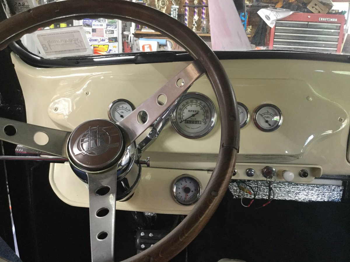

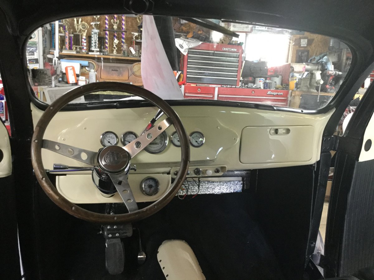

  29. Dash is done! Painted the windshield trim ring and installed the horn button I bought from @donald turpenen I think it looks Great!
    I am planning on shooting primer real soon I am really looking forward to that been a long time coming! It always amazes me what you see in pictures that It’s doesn’t show up when I’m in the car. I noticed I need to run the carpet higher on the firewall. Back to the garage! Hobo Jim
