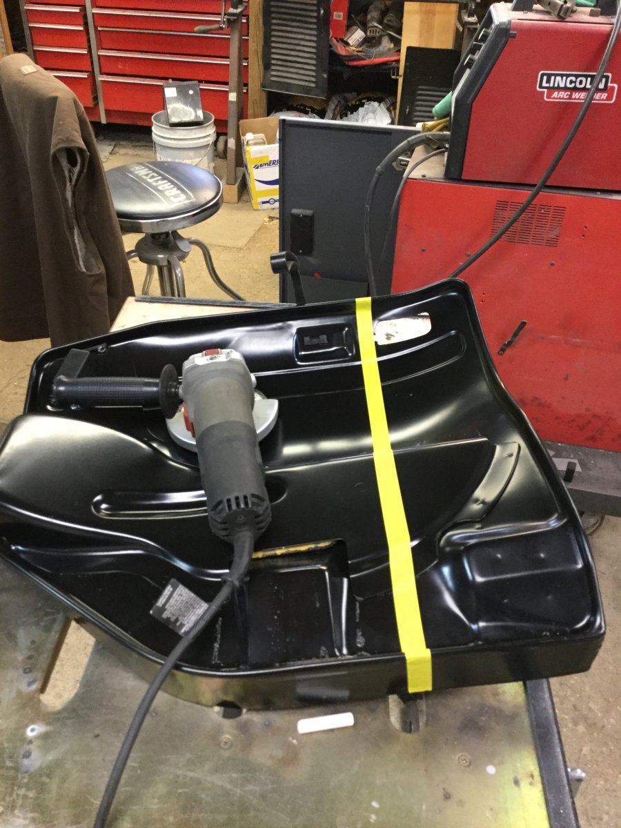

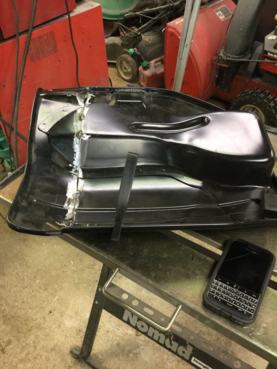

    I found a back seat today at the local junk yard it was an inch to wide on the base so I sectioned the lower seat pan 1" Then re welded the pan still needs brackets and finish welding ,but for 25 bucks it will work

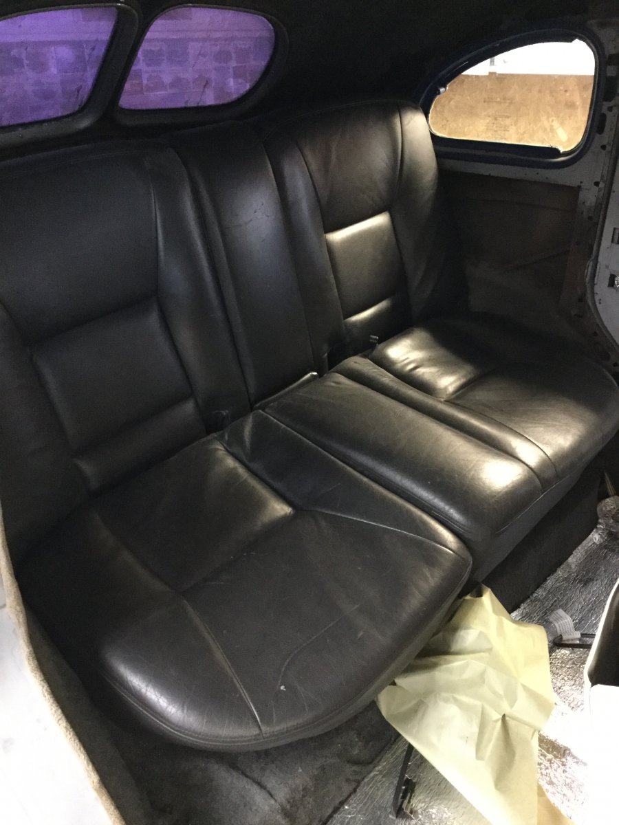

    Thank you I just finished fabricating the mounting brackets the seat is really comfortable and the height is spot on. I still have to work out the finishing metal for the front where the brackets are but I am very happy with the results. Hobo Jim

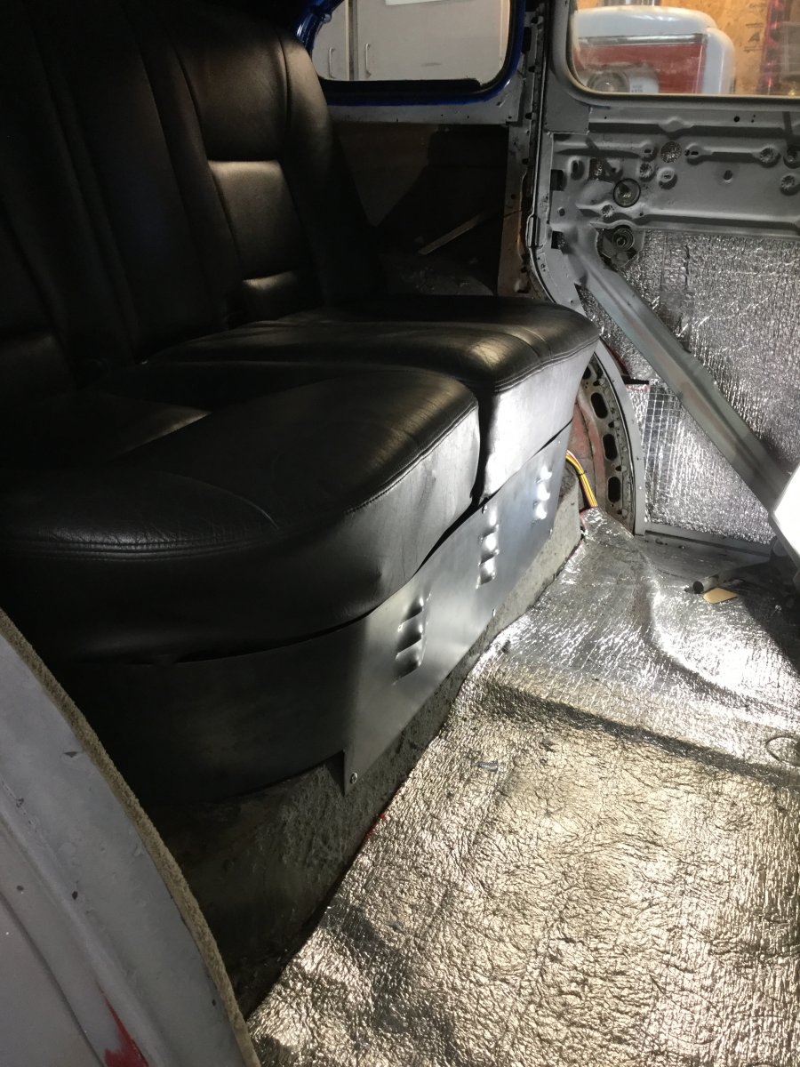

    I have finished the metal fab on the rear seat lower valance. This is made out of one piece of 16 gauge with 9 louvers hand punched in it. This will be painted cream to match the rest of the interior. This was a very challenging piece to make due the size 54 inches long I had to move the slip roll all over the garage to have enough ceiling clearance to roll the ends. Hobo Jim

    What was the donor for that seat??? What is the width?

    It was out of a Saab black leather with a steel seat pan that I was able to cut an inch out of then re weld the pan. I didn't cut the bottom of the seat foam. This was able to easily compress for the install . I will get you the measurement of the width this afternoon but I think it started out at 50 inches. I will confirm it's been a while thank you for your intrest and good luck with your build! Hobo Jim

    . Assuming its the rear seat. Some one mentioned third row from gm suv like suburban Tahoe etc. Looking for seat for Studebaker put. The one I have is about three inches too high with only an inch or so available to adjust. Pots my head in the headliner.

    Yes I am sorry it was the rear seat out of the Saab I didn't pay attention to the model. I just took a measurement of my rear seat area then headed to the junk yard looking for a black leather seat that I could make work. I found most of my prospects in the small foreign car section. Check out this thread it has a lot info on seat dimensions may make your search easier. https://www.jalopyjournal.com/forum/threads/junkyard-seat-dimensions.260/#post-2569
