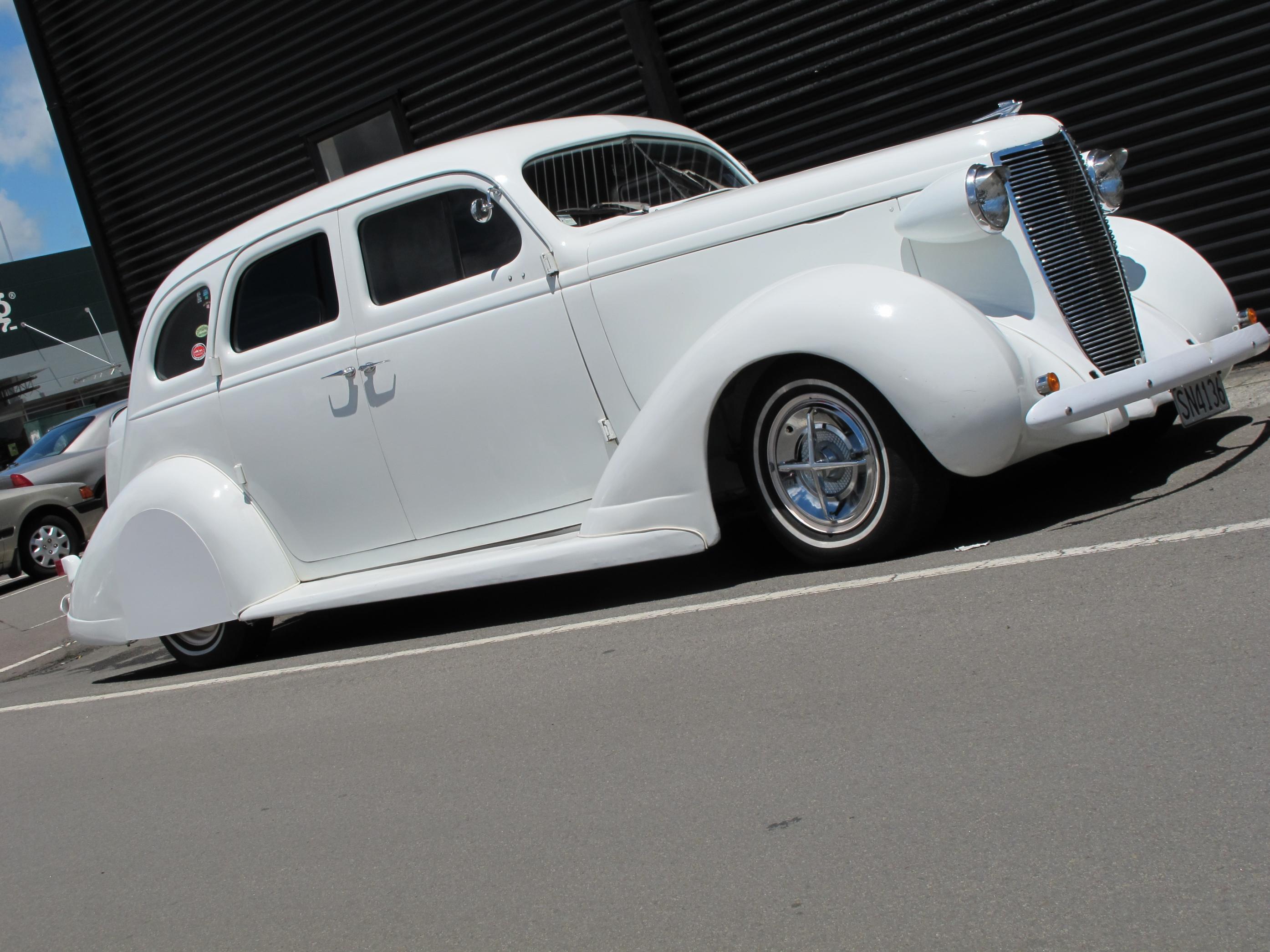

    Hi All, I;m a newbie to H.A.M.B. What a great site, its a petrol heads heaven..

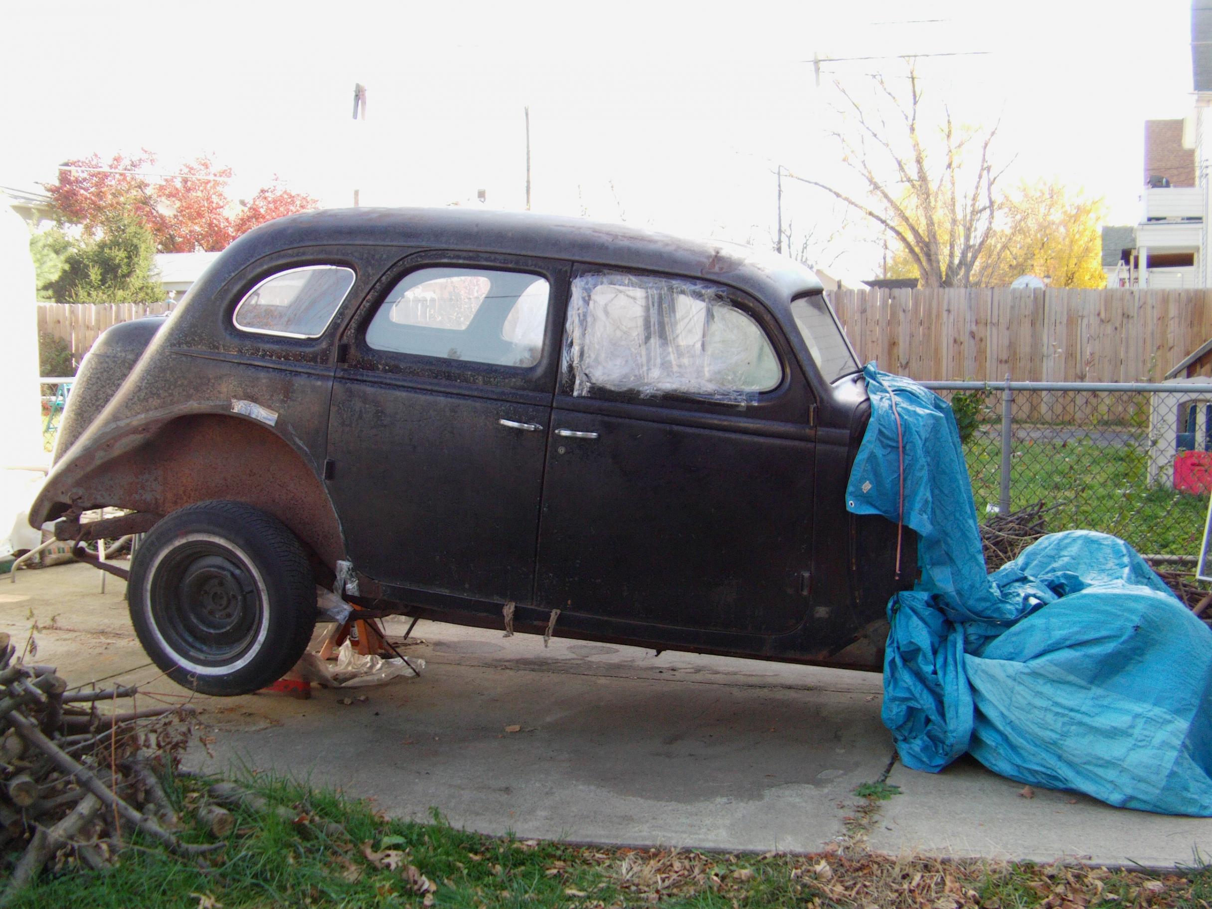

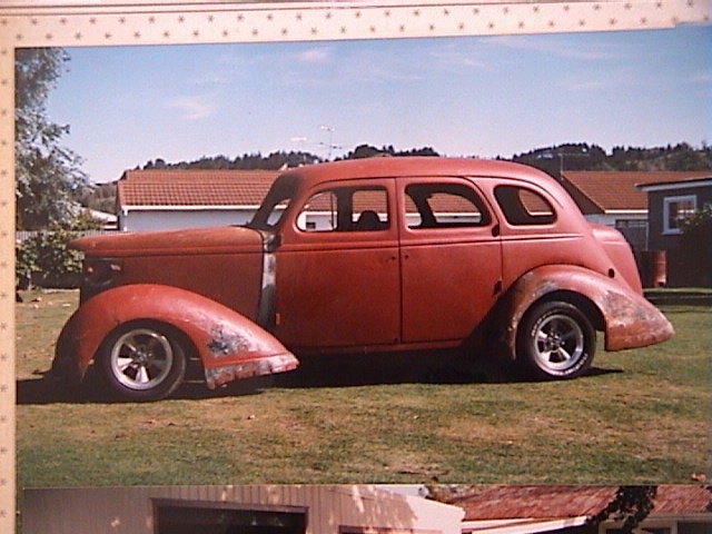

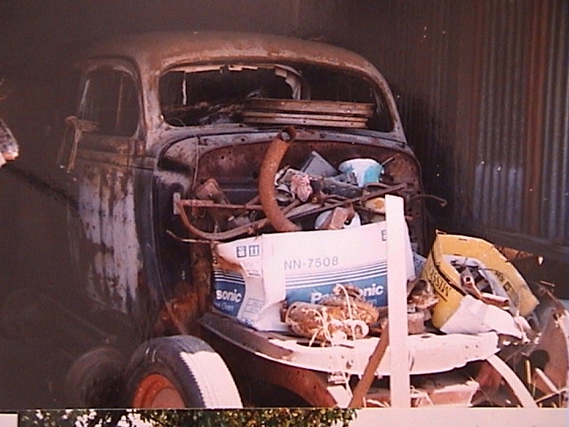

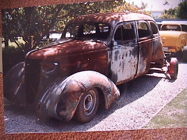

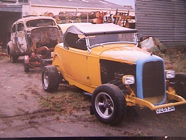

    About 12 years ago,I found a 1937 Nash in a shed, it was totally stripped, including the motor, gearbox, and diff, all the parts were lying on the damp floor covered with rust.
    I had owned the common old Chevs and Fords from the 30s, but this was a different breed which appealed to me.
    So $250 later and this rusty gem was mine, with the help of my sons, we towed it home and started the 2 year rebuild.
    Many parts had to be custom made ( running boards, bonnet sides, tail lights, grill, to name a few) being a rare car, we couldnt go and buy replacement parts like chevs or fords of the same age.

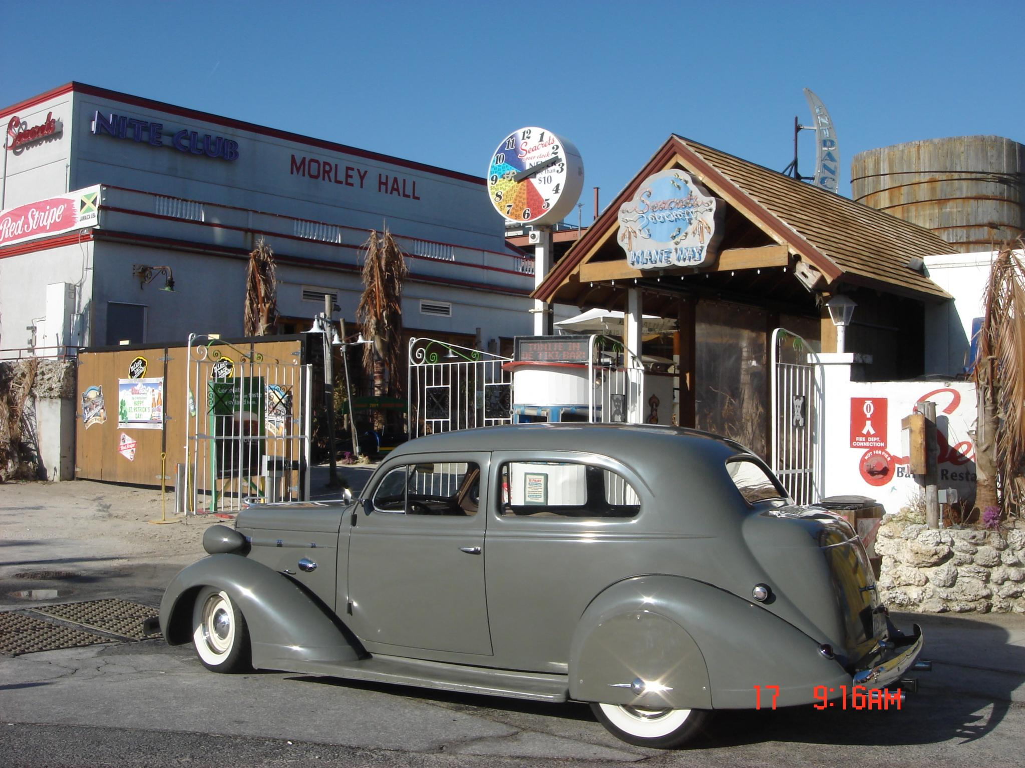

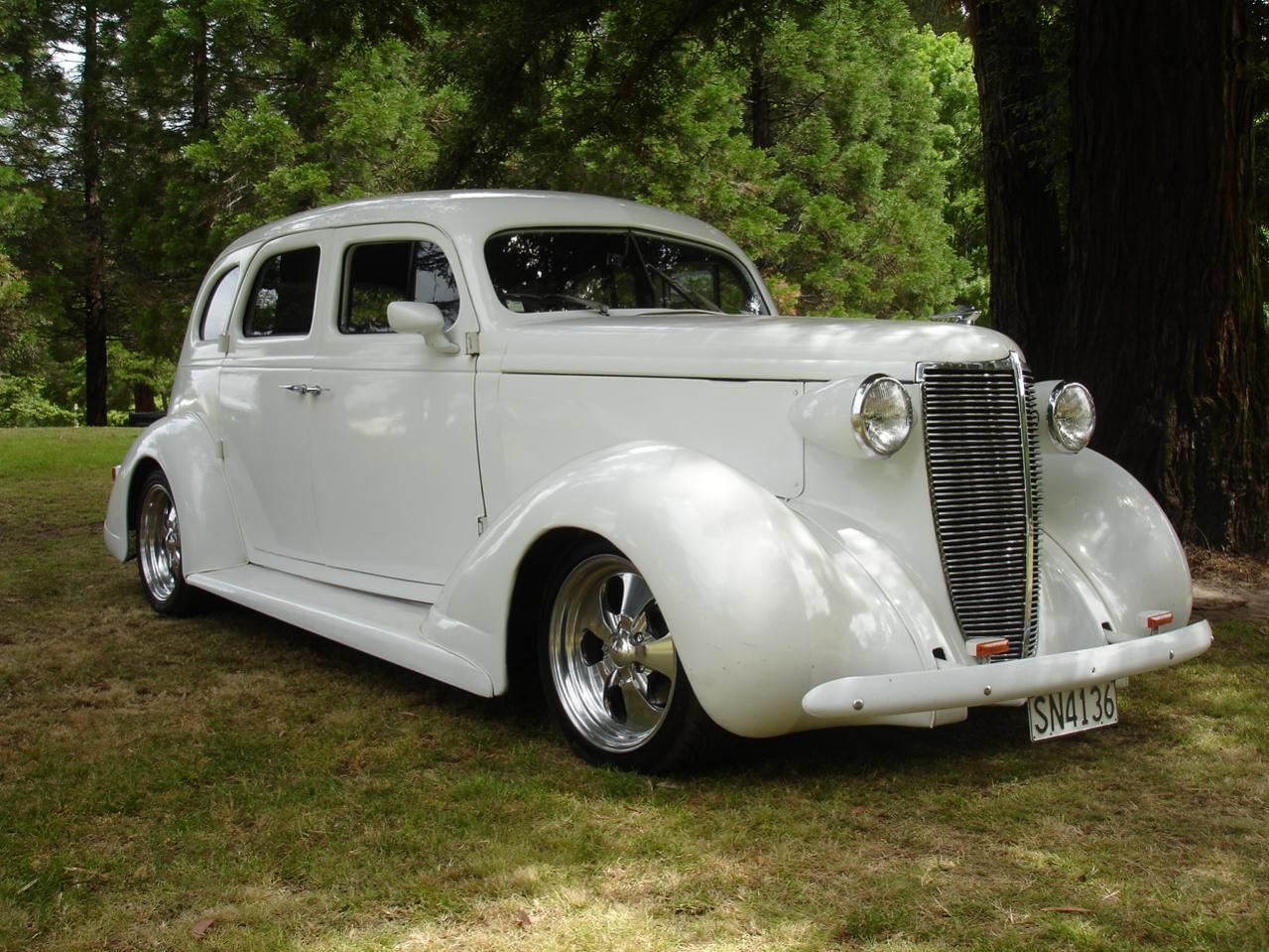

    I fitted a holden (Australian GM) front end with discs, a chev 350/T350 combo, with a single 4bbl tunnel ram, driving thru to a 9" diff running HQ holden axles and tubes(gave me holden stud pattern all around, and matching factory brakes front and rear)
    It all came together and hit the road on chrome 14" American Racing wheels, I changed to 17" Eagle alloys after a few years, and now (with my kids influence) runs 14" steels with whitewalls and caps, and skirts on the rear. Crusing is what its all about, and most weekends my partner and I head out and enjoy the local scene.
    I have added a few pictures from when I found it to the present day, hope you enjoy.
    Cheers, Grant

    That is outstanding, perfect ride height, and your son did you right -- those 14" wheels, spinner bars, and skirts really make it!!
