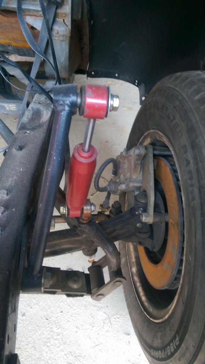

    I forgot to mention, rebuilt rear end with 500 miles, rebuilt 39 3 speed with 500 miles, disc brakes, tube shocks.... IMAG1266.jpg IMAG1267.jpg

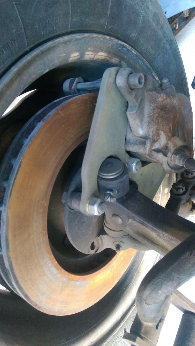

    anyone recognize this front disc brake setup? looks like an adapter plate and some kind of later caliper? In case I need to replace parts...
    kidcampbell71 likes this.

    Looks like the gm calipers I've got on my heidts front end. So I was told.
