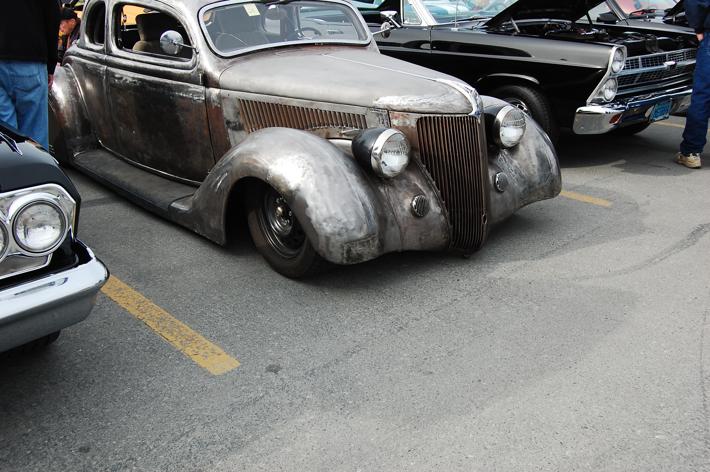

    How much of a section are you planning on taking? Here is what 3&3/8" looks like taken just below the belt line of my 36 five window. I loved the work you did on your "A" so I suspect this project will turn out equally fine. Please keep us posted.
    Best Regards and good luck with all your endeavors, KB.

    Thanks KB, I am not sectioning the body just narrowing the 55 ford dash. Love your 36

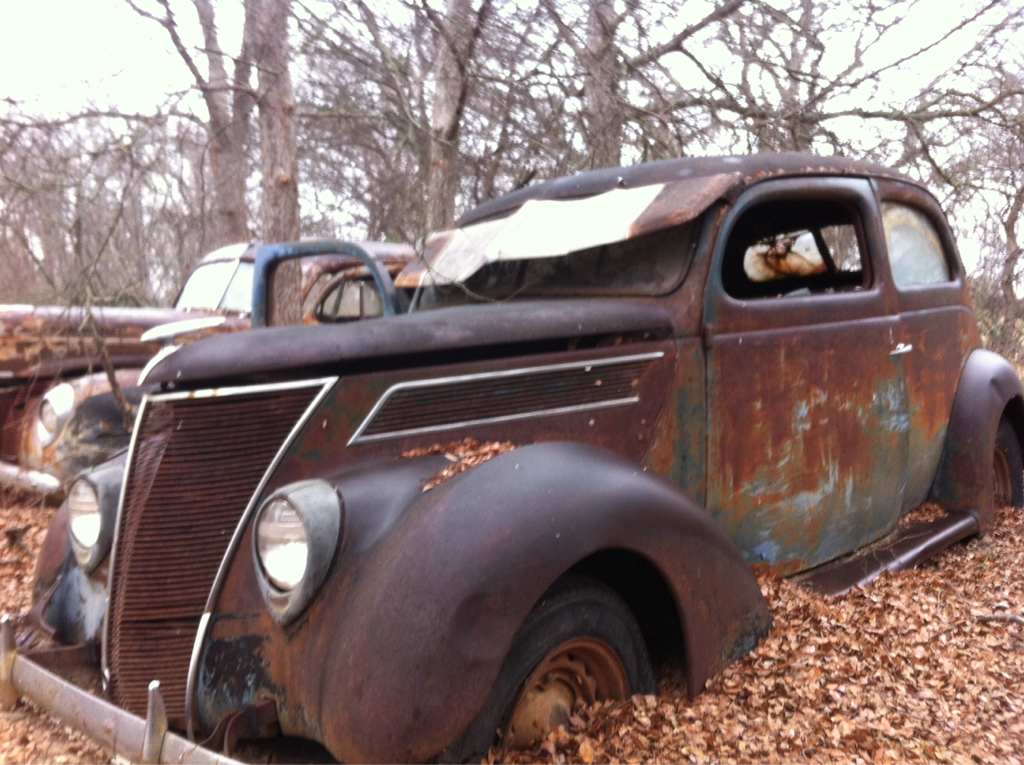

    Looks good. I love 37's to. I have a 38 standard body. That I'm going to make it a 37 some day. Found a good parts car for it to. ImageUploadedByH.A.M.B.1425484566.043020.jpg ImageUploadedByH.A.M.B.1425484605.789810.jpg

    Thanks, looks like you have a nice body sitting there! That 37 looks real solid!! My dad found a sedan that is in about the same great shape and am hoping the owner will sell me some parts off of it! Or the whole car
