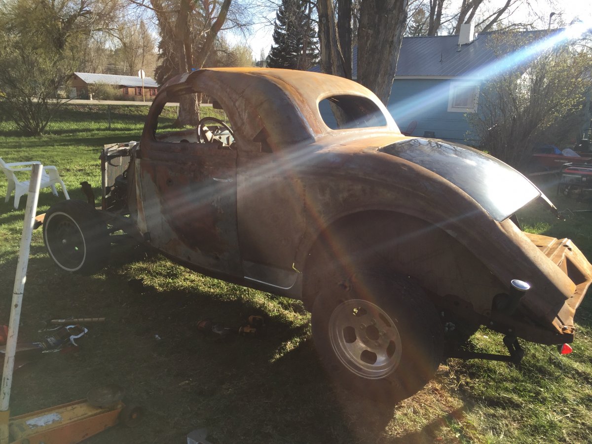

    Figured I'd share my project for anyone else lacking time, talent, tools, and money such as myself.
    When I was a kid I built a model of a chopped 1936 Ford 3 window Custom with my old man. It wasn't the first or last model I'd built but for years it remained my favorite. Something about the long lines of the car, the simplicity of the 3 window doors, the aggressive and bulky front end, and the heavy rear tail dragging rear end, it just stuck with me, and it grew into my lifelong dream car.
    I was lucky enough to get into a 5 window coupe in my teens but had to sell it for school expenses. Then as I grew older I missed out on not one, not two, but THREE genuine 3 window coupes. I was either a little short on funds or couldn't pull off the shipping. Flash forward to a few years back when I see a for sale post on here for the back half of a 5 window coupe and a tudor that Chris at Salt Flats Speed Shop had been modifying into a 3 window coupe. At the time he was selling the metal cheap because his hands were full working on the real thing, as well as several other high end vehicles for his clients. If you don't know this guy is incredibly talented and this project was dirt under the fingernails of his skilled hands, but it was the perfect start to building a 3 window from scratch.
    I hopped into my truck at midnight and was at his door 100's of miles away by 6am the next morning. Outside of the back half parts we settled on a few door pieces, as well as a new tail pan.

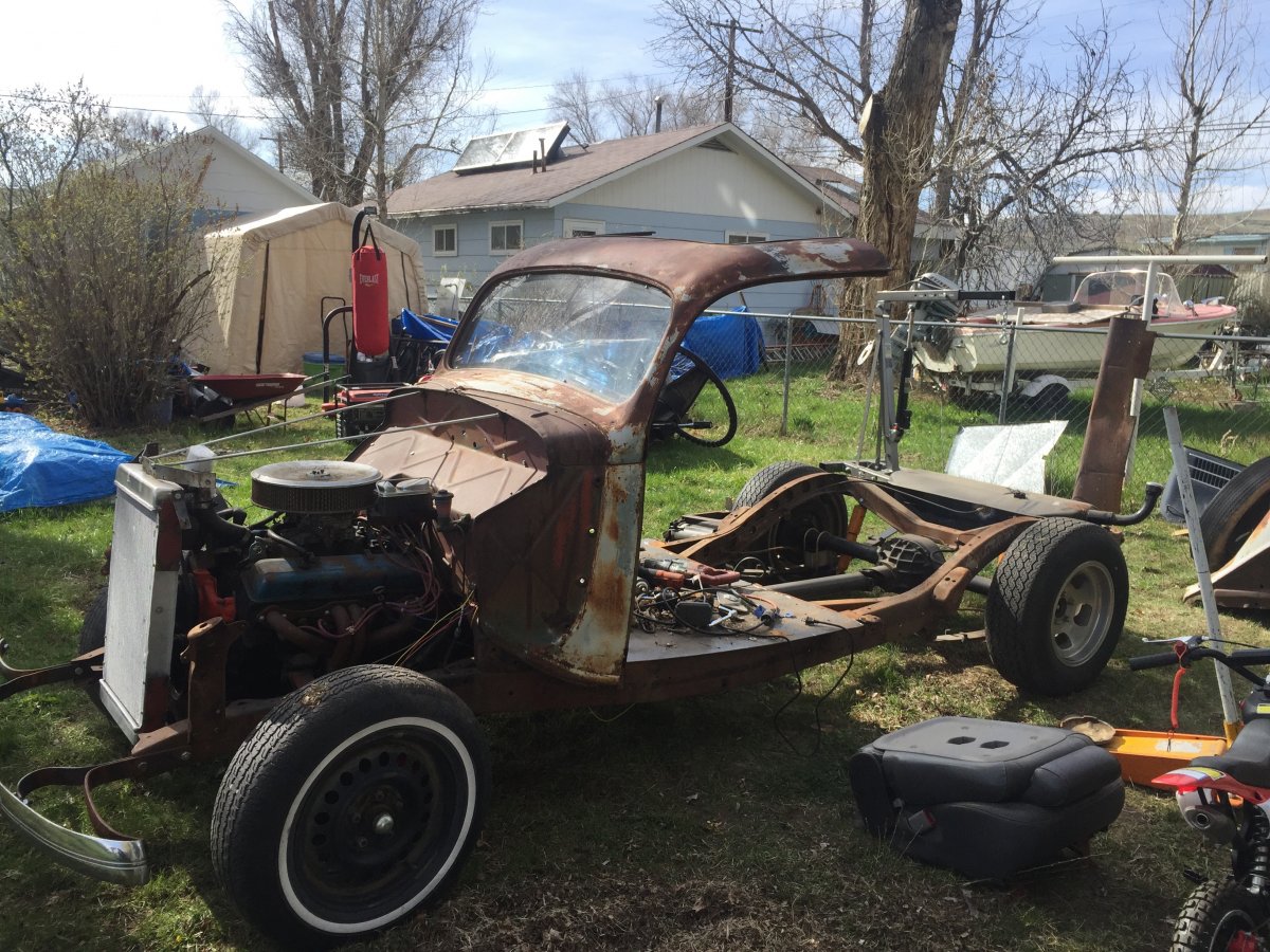

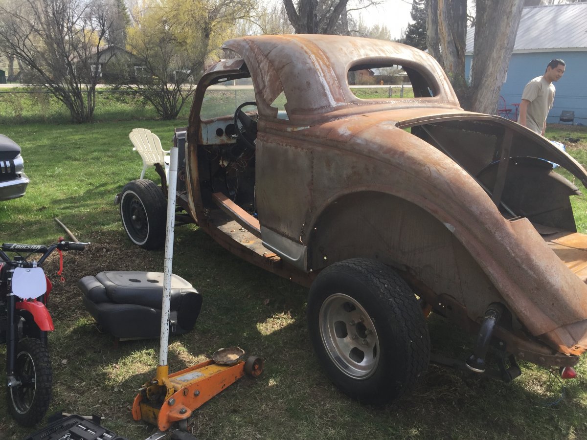

    For many months the parts sat in storage waiting of the correct tudor donor to pop up. Sure enough I found one on craigslist that the seller claimed to be a running/driving car with a 350 engine, ford 9 rear end, and a 3 speed trans. Jackpot! Or so I thought...
    As far as I can figure the car was built between the time that I called him for directions and the time I picked it up, about an hour give or take. Every single bolt right down to the suspension was finger tight, and although it did run and drive onto the trailer, the shotty wiring caught fire when I went to start it to pull it off. No complaints though as it had the A pillars I needed, usable fenders and running boards, tons of great sheet metal, and a clean title.
    I decided I would start putting everything together when I found a coupe decklid to use as a guide to line everything up. Good luck there. I found a used fiberglass lid and just settled on that. It was time to start cutting.

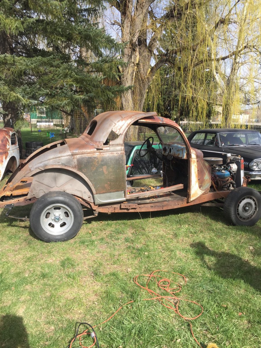

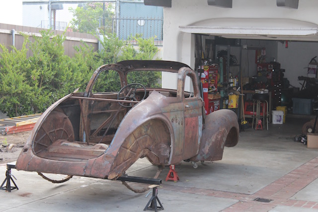

    Started by disassembling everything to get to the bones. This is where I was glad it was all finger tight.
    I'm a stubborn S.O.B. and my goal was to build this car 100% by myself, originally I thought I could pull the back half off using just my cherry picker, but despite every angle that was proving to be an uphill battle. So I had to call a buddy to help me pull the tudor back off and place the coupe pieces. This was the only point in the build that I asked for help even though I should have asked several more times.

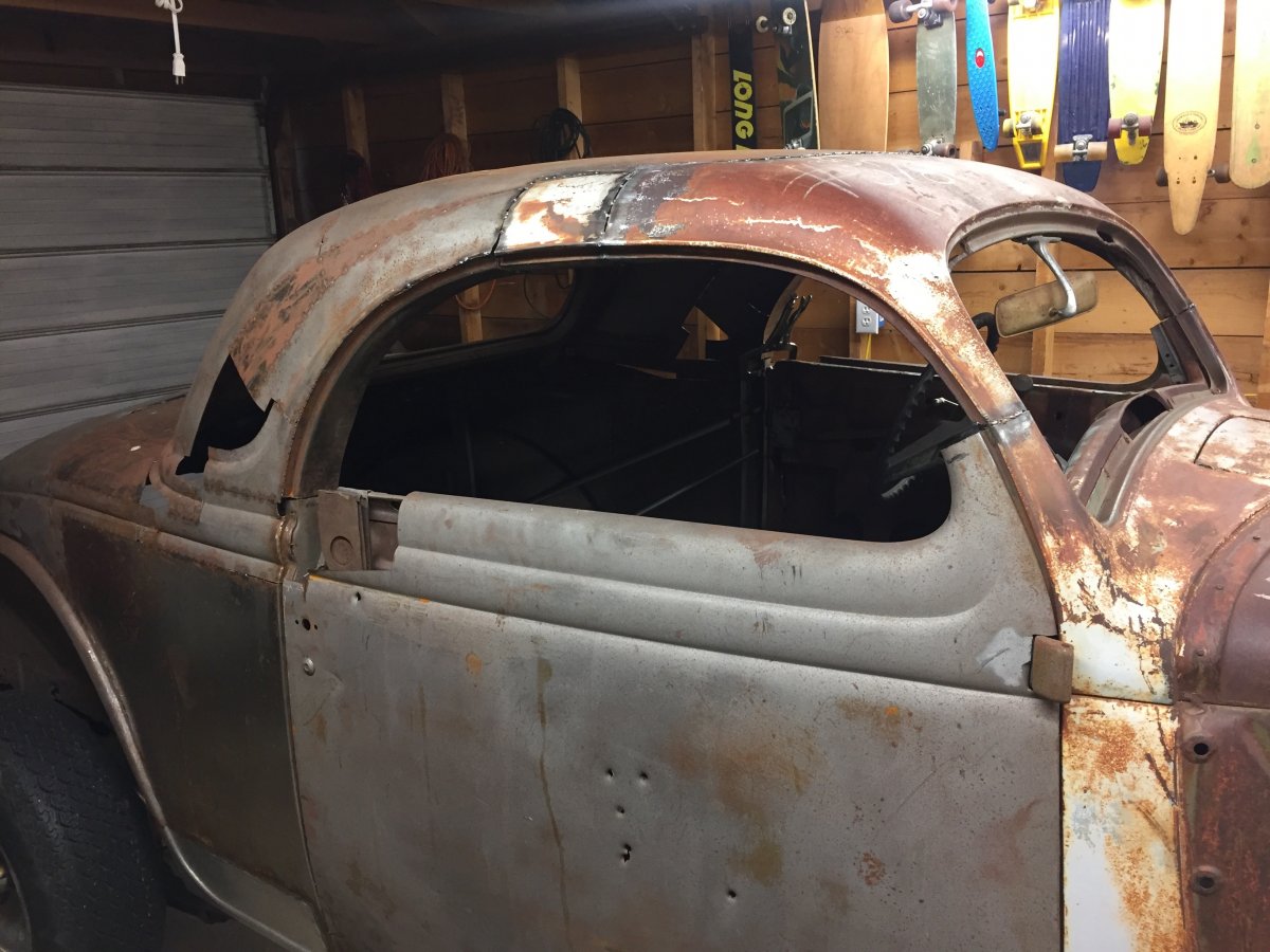

    Using my glass decklid as a reference and a spreader I was able to sleeve the body pieces over the frame.
    After a full day of work the passenger side was kind of coming together, but the drivers side wasn't fitting worth a damn. Keep in mind this was a chopped back half used from the roof of a tudor going on the stock height front half of a tudor, which meant lining these two up was a guessing game that took me weeks to place.
    Pulled into the shop now I was able to finally find a roof shape I was happy with. This was achieved by cutting the A pillars a quarter inch at a time until it looked right. My goal was to have one line where the two roofs met but despite my best efforts they just never lined up and I had to create a gap that I would then fill with other areas of the tudor roof.
    After pushing, pulling, bending, and pleading I finally got the drivers side to line up a little better with the same issue in the roof gap.
    I don't have a whole lot of pictures of the door tops being built but holy hell they were a nightmare...and they're still not done by the way but I think the hard part is done. This roofline is that of a tudor and slants more forward than an original 3 window, which means no door...ever...fits in this gap. So using 4 different doors and testing several bends, I finally was finding the curve I wanted. The entire time I was working on the passenger side I just kept thinking..."dammit, I still have to do that drivers door." but it all worked out in the end.

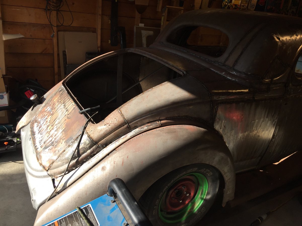

    Now onto the back. Outside of the reproduction tailpan this car basically had no back end so it took some time to determine where that piece needed to go.
    Thankfully the tudor was able to give up enough metal to fill the large gap
    Using the outer lip of the tudor I was able to somehow get it all tacked in to where it was finally looking like a quarter. Now before you say anything I'm well aware of how thin that patch of metal on the passenger side of that quarter is. It's swiss cheese and I plan to replace it, I just have to keep my eye out for a coupe passenger quarter. Still looks better than a big hole for the time being.

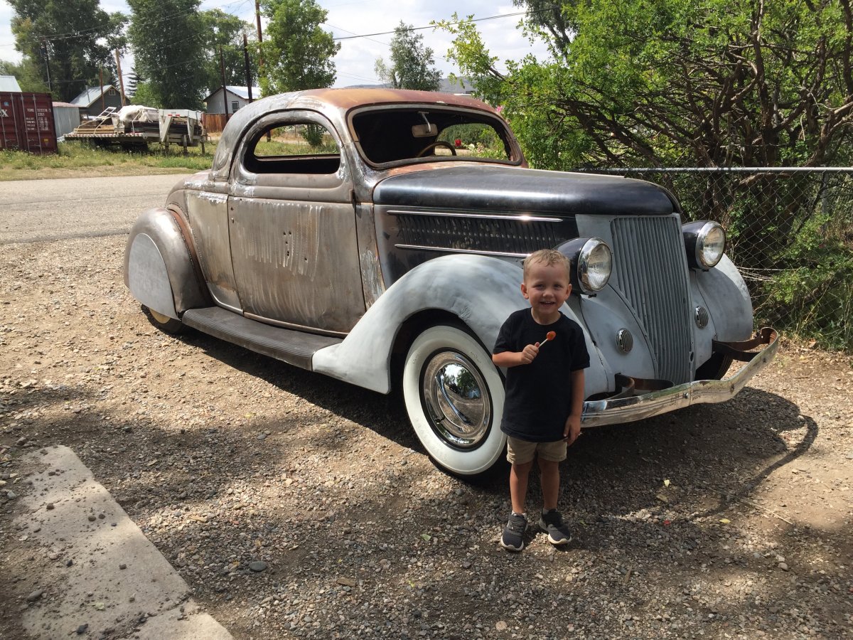

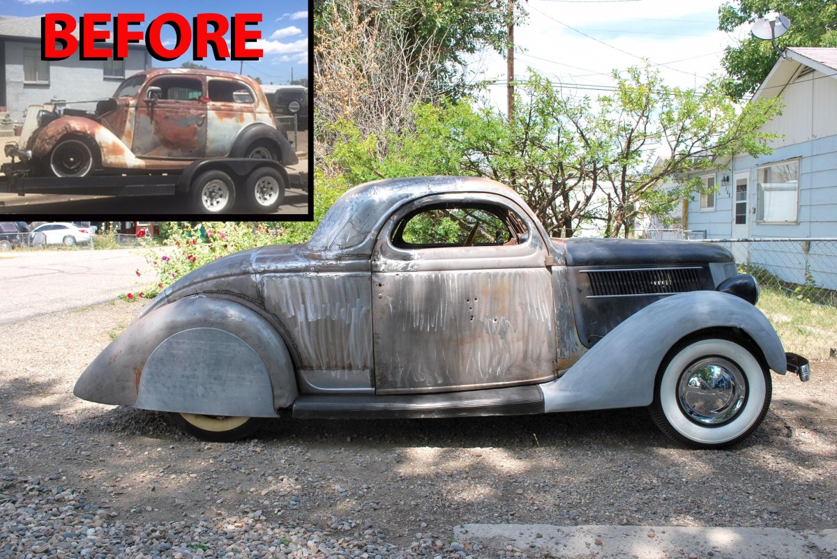

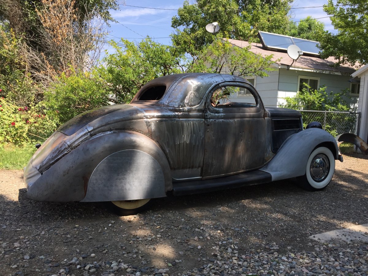

    It's taken me 5 months but this is where it sits today. The drivers side is pieced together but is not as far along as the passenger as my small garage makes it easier to work on one side at a time. A few of the quarter pieces were created on the english wheel at salt flats speed shop but otherwise no planishing hammers, english wheels, or other fancy metalworking tools were used. Not saying that wouldn't have yielded better results, I just didn't have any. All of the gaps I filled were done by either finding metal that had the same shape, or bending it over my knee or objects I had in the yard. I'm still not sure if I want to fill the bullet holes in the door or just leave them.
    I bought two new whitewalls for the front but the rears I had sitting around, this was my biggest expense outside of the original tudor. I spent about $150 on all of the numerous vise grips and butt clamps I needed to hold it all together from Harbor Freight. All said and done even if you count the miles of welding wire and all the shielding gas, I've yet to hit 5k in build cost, but if you figure in labor at minimum wage I'm into it for about 7 figures.
    It's far from perfect and miles from being done, but my hope is to push others who may not have a whole lot to work with to just START something instead of just TALKING about it and see where you end up. My thought the entire time I was building this car was "screw it, at least I'm learning." This wasn't top shelf original parts I was working with so I had no guilt or fear in making the cuts. Even if someone was to look at this and see junk, it's my junk, and it taught me a lot.
    All of the work was done with simple tools in a tiny garage with the small bits of time I had after putting my two young boys to bed, or on Sundays. Outside of lifting on that back half everything was done solo as until now only about 5 people knew that I even owned or was working on the car.

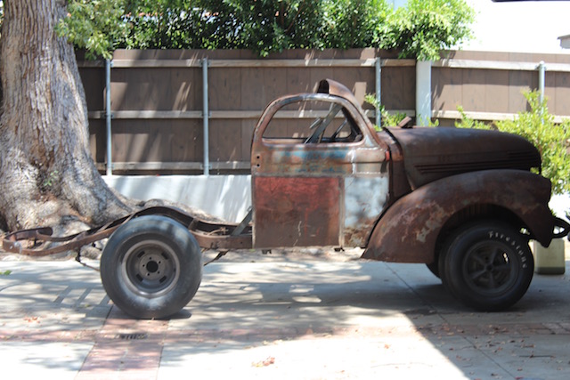

    Wow, ultra impressed, similar to my willys jigsaw build. Mine took 7 years, I raised a daughter while welding at night or any free minute that I could scrounge up.
