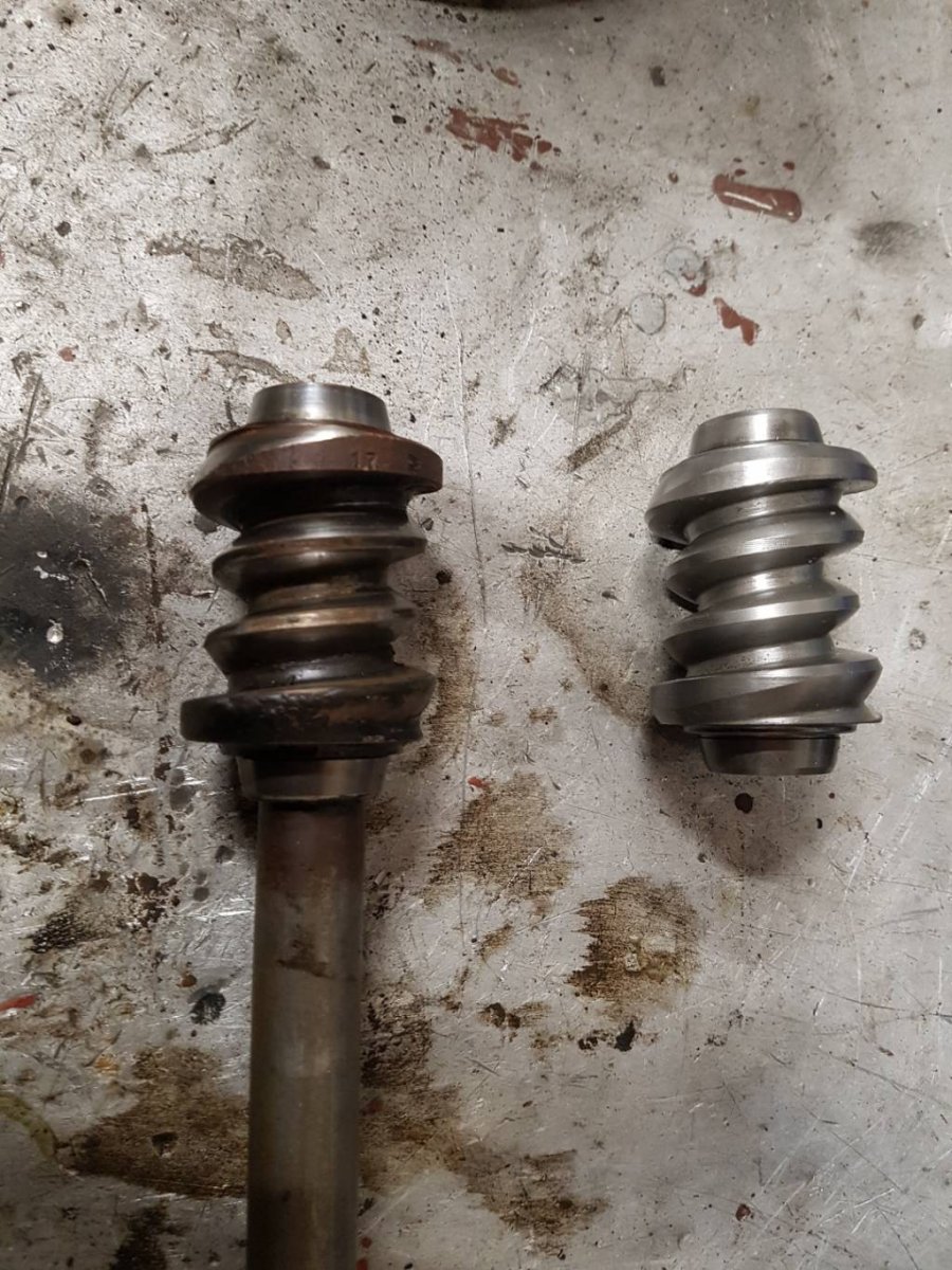

    Has anyone got any special tips to make replacing the worm easy, or at least possible? I've done it before and it was a nightmare.
    I was thinking of cutting the old worm off carefully. Then heating the new one in a household electric oven for half an hour then fitting it. Would that work? 20191205_133118.jpeg

    Might work. Last one I did I cut through the old worm, then used a brass hammer to pound on the new one. It was a nightmare.
    I've seen guys press them on, and also seen them bend the shaft while pressing. If you try to press make sure to carefully protect the threaded end, and clamp some heavy angle to the shaft to keep it straight.
    And make sure to show us pics of your successes (or failures).

    Yes I found it did. So I removed it and then I lightly hand sanded the shaft to reduce the diameter by a thou or so, then hammered the worm on cold. It took heavy blows towards the end but it ended up flush again and tight.

    Indeed. Pressing is no good. You need the shock blows of a hammer.
