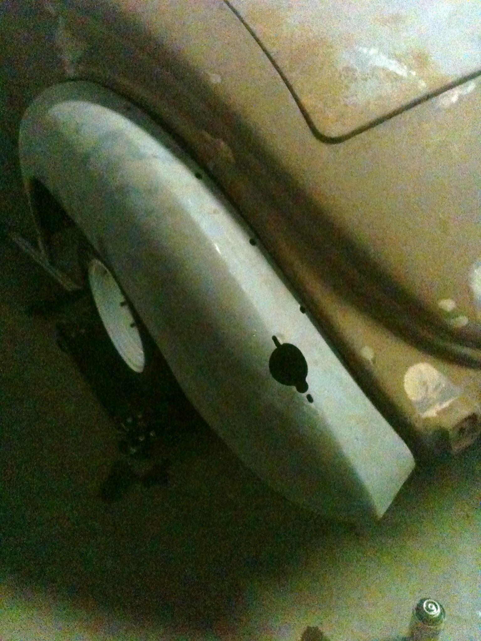

    Here's a couple of pics of the two fenders. In the first pic (from the running board end, the sedan fender is on the right and the coupe on the left. Note how the five bolt holes from the running board to about mid fender are spaced the same.
    The second pic, shows the fenders from the rear and the sedan is on the left and coupe on the right. Note how the (3) bolt holes from the rear - forward are not spaced the same.
    Hope this helps,
    -Bob

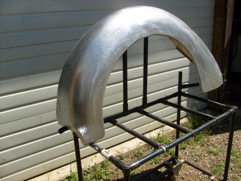

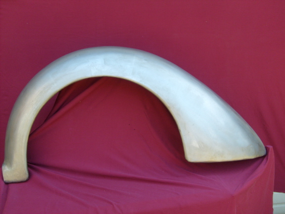

    Is this the fender you were thinking of.
    All hand formed.
