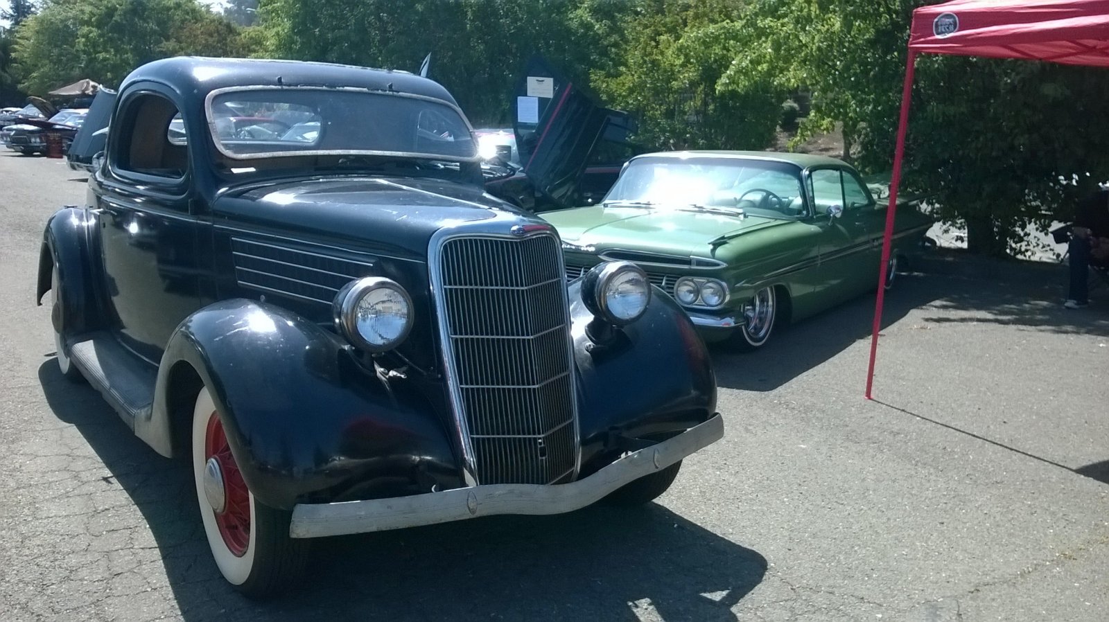

    my smart ass friends are on the hamb this evening, all ready seen my post and texting me saying post photo of the 35 or it doesn't exit! here you go! FOT6303.JPG

  8. Nice car. HRP
