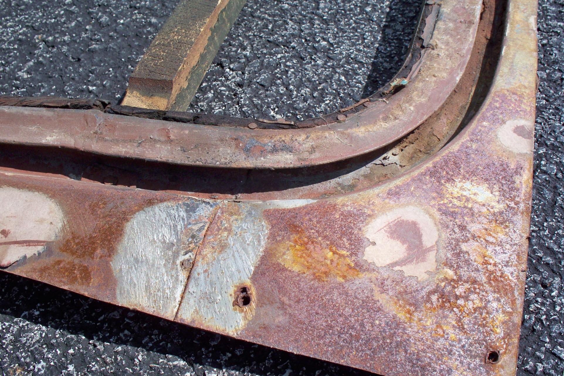

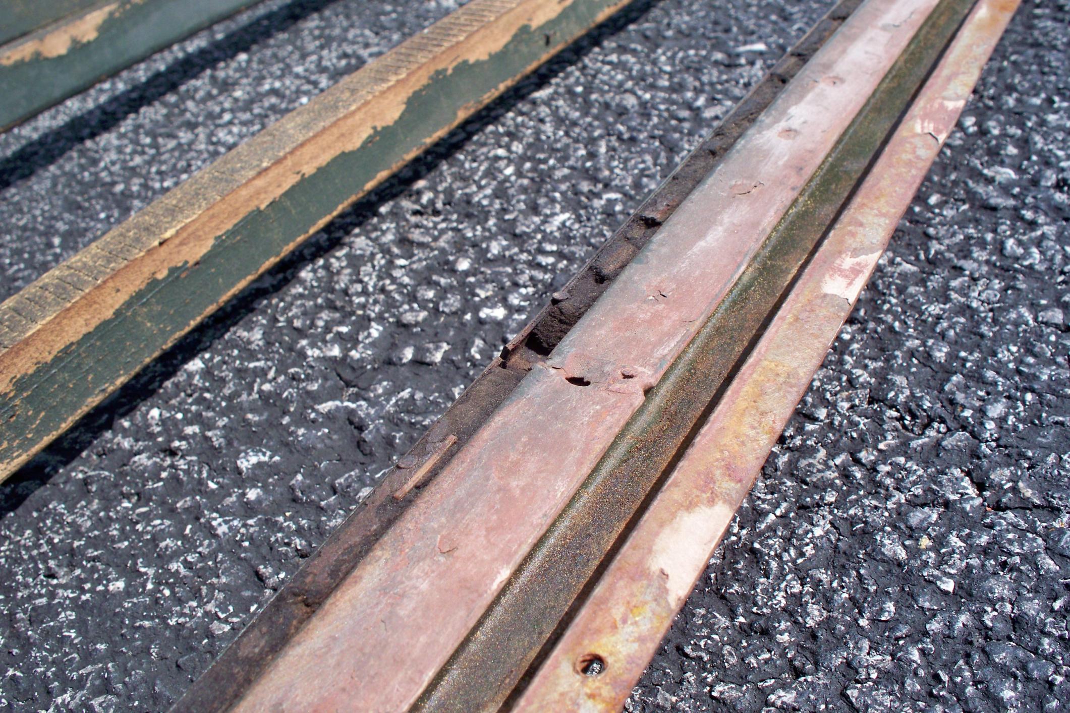

    Here's 4 photos of one of these sections which was cut from a car when the opening was being filled. I'm probably going to sell this piece because it's not quite right for my non-'35/6 Ford coupe. Perhaps these photos will help answer the questions regarding how the pieces look when assembled.
    reagen likes this.

    There is no tack strip similar to 32's or 33/4's. The top material is held in place by a thick rubber strip that pinches the top material into the groove and traps the material. If you have the material necessary to do the job follow the instructions from a Juliano top kit and the installation procedure is similar with the exception you do not have to drill any rivets. The roof seal kits are sold in two lengths one for coupe and one for sedans.

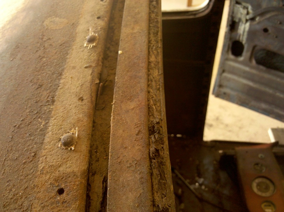

    if there is no tack strip then what is the tacs in the Pic?

    I just started building my 35 and i was confused on the top when i saw it. So a big piece of rubber smashes down in the groove and holds the top canvas down? I guess the little tack strip to the inside holds the cloth?
    Now my great uncle added his own top to the car is why you see the screws/holes around it. That is not original.
