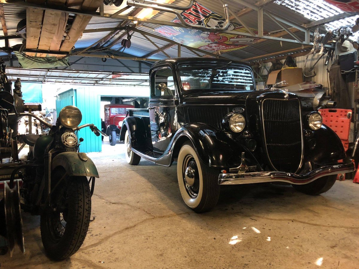

  6. Here is My Heap" Great Info on these pages

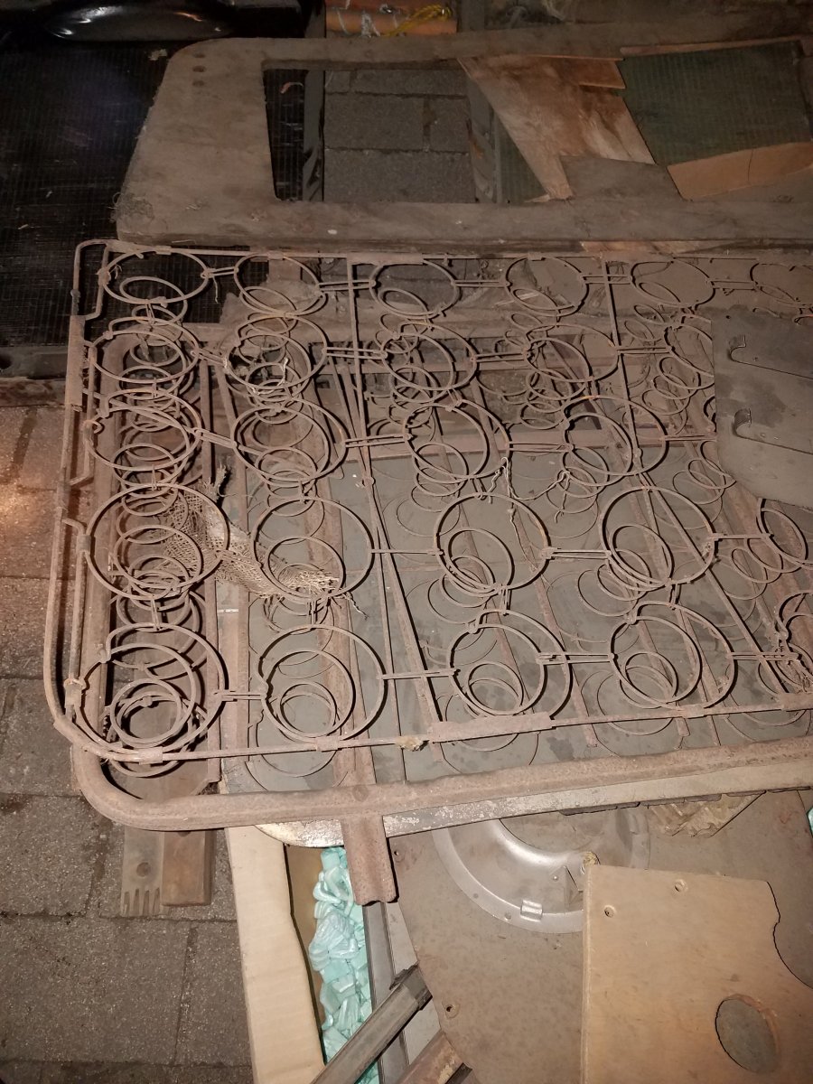

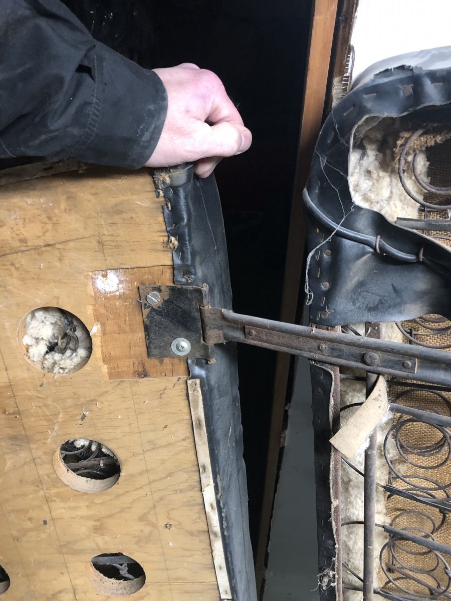

  16. I seen this when you posted it the first time, forgot to go look at my 36 for ya. I think what you have is a 40 seat back. As I remember it 35-6-7- had like a fold over that hooked in a Slot in the Cab cross brace. I just sold a 40 Truck to a friend with stock seat in it and as I remember it had the hinge on the seat back. Could be confused so will try to check it out for ya today.
  17. Posting what I did above and then what I actually see is why I never swear to anything even if I did know it before. Getting old has it's draw backs, yes you know a lot of Stuff. Problem is it's all mixed up.
    Your seat back frame may in fact be correct. The hinge goes to the Bottom. The strait leg goes into a Slot in the lower edge of the cross brace in the Cab. The hinge is fastened to a wood frame work that sits on top of the seat riser inside the flange and locked in place with the large pins on the front corners of riser. The bottom cushion sits on top of the wood frame held also by the dowels. Here's a couple photos of the Stock 36 parts. Take notice of the corners of the seat springs. The bottom corners are very squared off and the Top corners are much rounder.
    If you have more questions just ask.

  19. These photos are of the wood and springs as they came out of my unmolested 36 Truck.

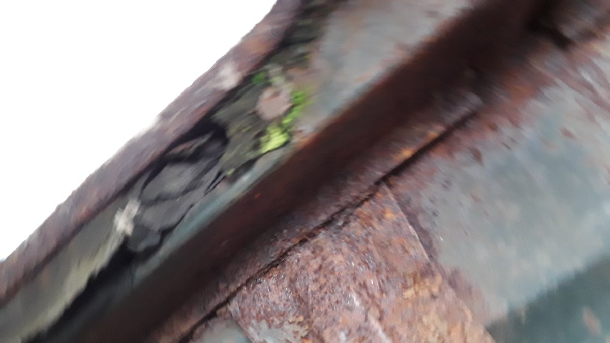

  20. Roothawg
    Joined: Mar 14, 2001
    Posts: 18,821
    Roothawg

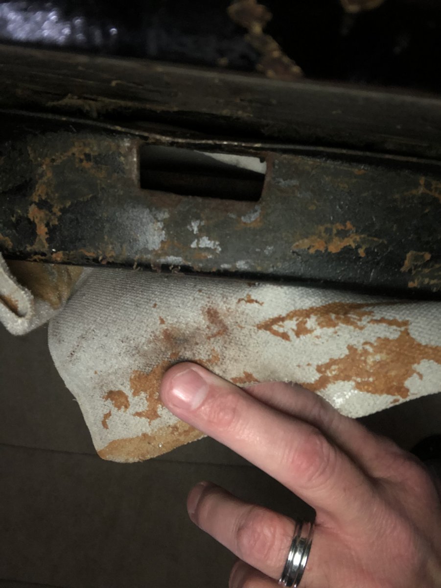

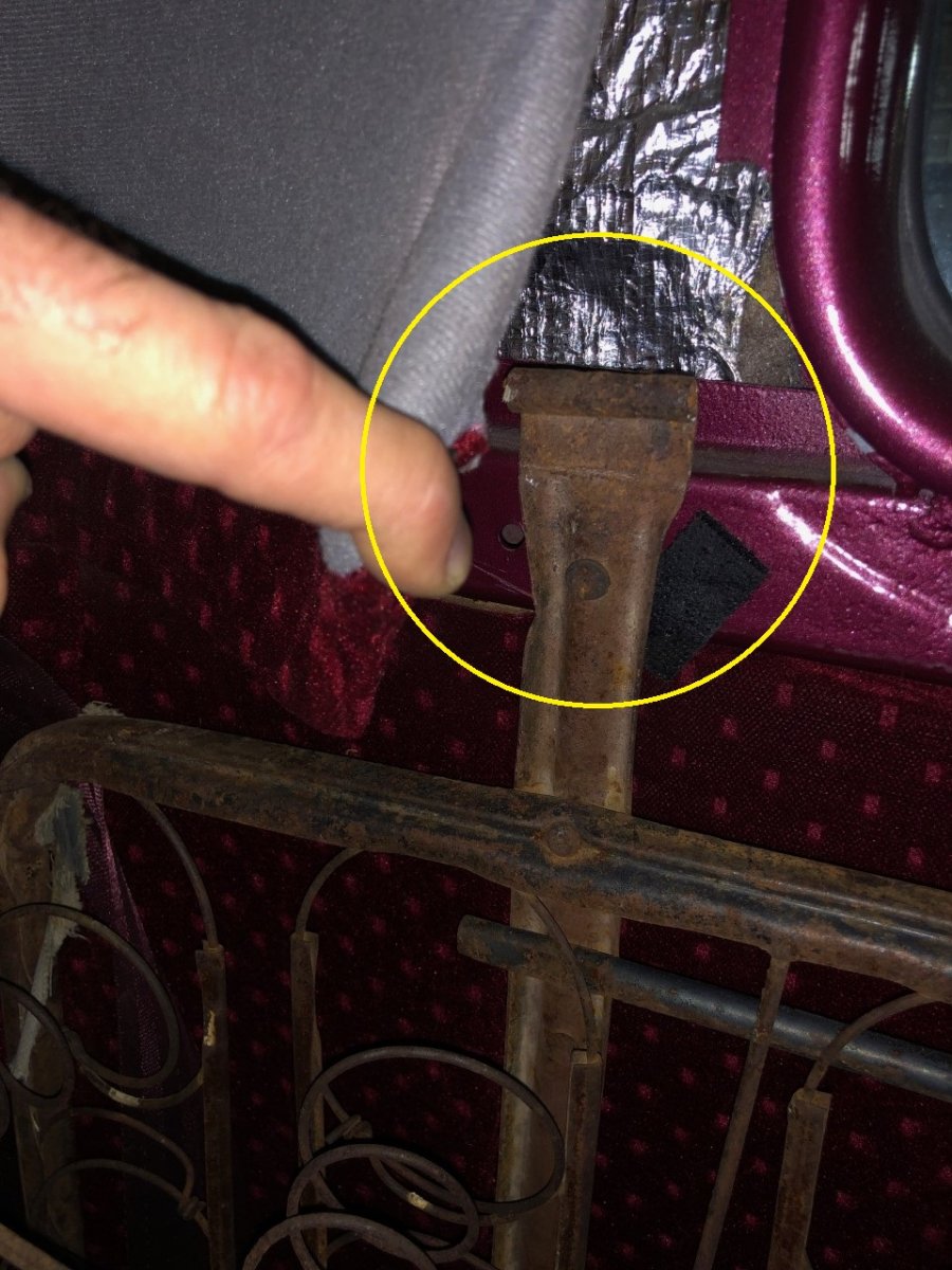

    The piece you asked about is the upper half of the hinge. You can kinda see what is missing.
    45BDC8A2-63BB-4D5C-A475-700B541247E5.jpeg 65649825-6931-4099-B17C-7F3403100632.jpeg Maybe this will help. The whole in the rear brace looking up.
    This is the piece that goes in the slot.
    Below is a pic of the rear brace under the window.

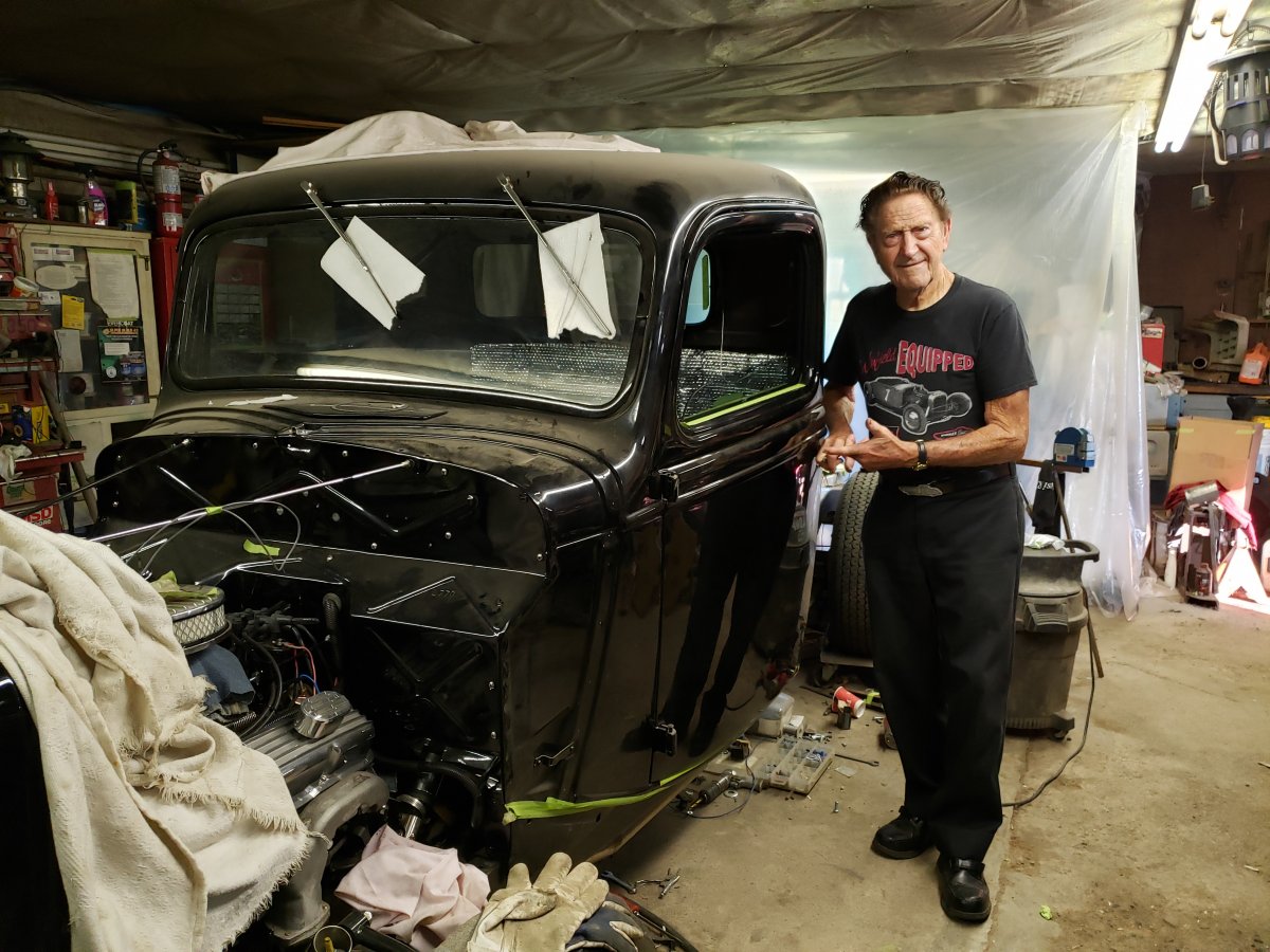

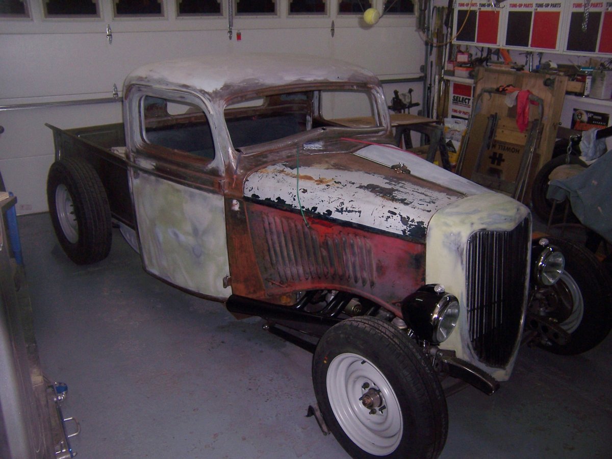

    here my 36 been in the works for a bit started as 1 1/2 ton coming along.

    The seat bottom has a row of three holes on each side, front corner that fit on the two dowels at front corners of seat pan. That allows seat to be adjusted back and forth. That is the only seat adjustment. The back of the lower seat is hinged to the seat back at the bottom. The hinge is attached to the seat base made of 3/4” plywood. It has a upper brace that goes into the hole in the rib brace at back of cab. I do not know if there was anything in the brace hole, but I am putting a cover over upper seat brace to prevent any rattle.

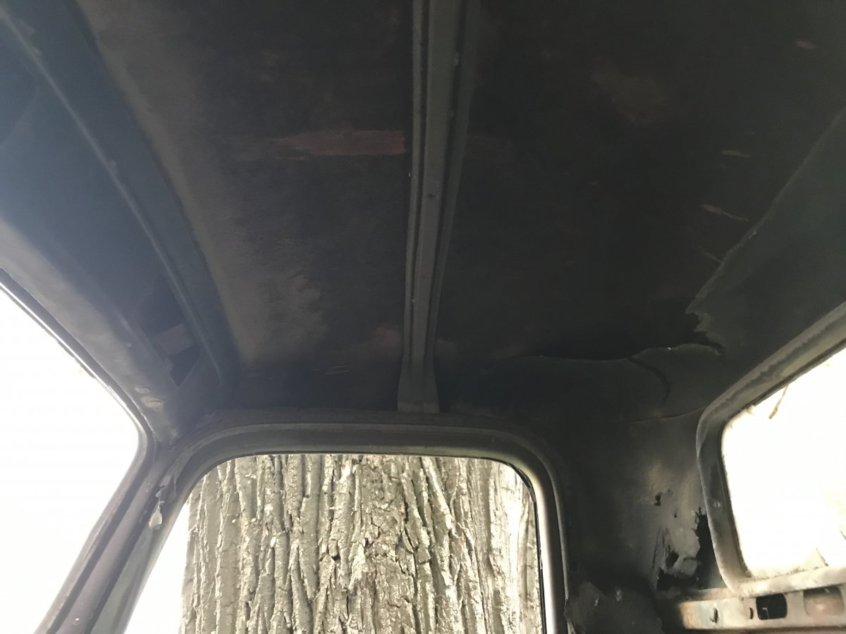

    Does anyone have any ideas on how to reattach the cab roof bracing? I have 2 different cabs and in both of them the roof bracing is coming ‘unglued’/separated from the roof itself. Both have a single brace and I cannot find any type of weld indicating that they were spot welded or otherwise, neither do I want to weld them for fear of the weld pulling through at a future date. Any thoughts?

    This doesn't help, but mine have been that way since the 70's. I'm not sure they were ever attached. I kinda wonder if they didn't have some sort of card board stuffed in between them to keep them from rattling from the factory.

    Root,
    In the formed channel section there is some sort of fiberous material and I have been wondering why they put that in the channel and then glued it. The part that I can feel feels like a rough cardboard rope. Your conclusion may be correct. The paint on the inside shows where they sit vs where they sat when painted but I guess that doesn’t indicate that they were ever attached. Any other ideas anybody?
  27. Isn't that simply the bow to hold the headliner in place? Originally, the headliner was made from cardboard sections. I don't think it has any other structural purpose for the cab --- it's certainly not a roll bar!
    Mine is close and follows the contour, but it has never been attached across the top. It's attached at the sides.

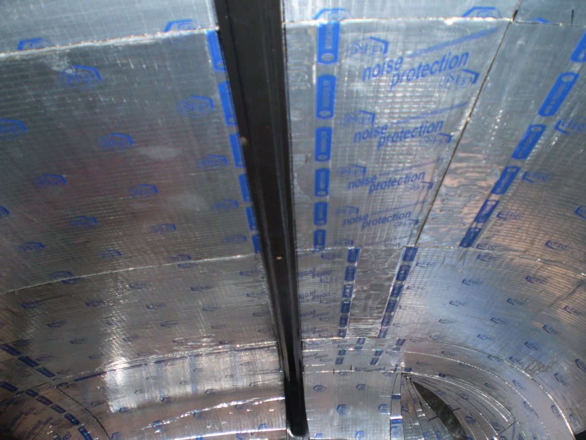

    here is what im doing(38 chevy) pu cab.never payed any attention to the brace until I started insulating the cab and discovered the brace was loose from the roof skin.i carefully loosened the screws either side using liberal amounts of wd40.discovered the screws are brass?.removed the brace .underside revealed heavy surface rust on the brace and on the roof skin.couldnt have that so it turned into a big job.coated everything in POR15 and removed the dried up tar from the brace.at this stage the roof skin sounded like an empty biscuit tin.i used 2mm sound deadening on the roof skin then offered up the brace.it fitted fine.the plan is to bond the strip to the sound insulation using TIGERSEAL.i don't expect ill have any issues with it coming loose.im not using a roof liner . ill apply another layer of 2mm foil backed noise insulation followed by a 3mm layer of foam heat insulation.leaving the painted brace exposed and have the option of running wiring through it from side to side as may be needed for interior lighting .so far with 1/2mm layer of noise insulation on and the brace not stuck on yet the cab is 1000% better than before I started.

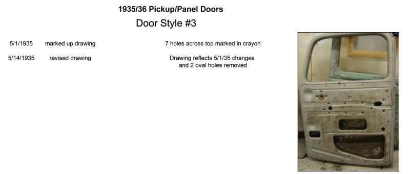

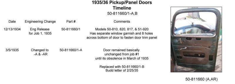

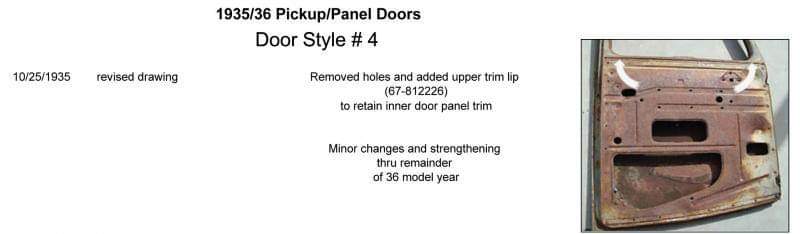

    I received an email from Zach Suhr the other day. He found these illustrations buried in the archives of the Ford Barn. Thanks to Don Rogers over at the Ford Barn for taking the time to assemble this info and thanks to Zach for forwarding it on. This thread keeps the learning going. I have always wondered about this, but couldn't prove anything.
    1935 36 Door style 1.jpeg 1935 36 door style 2.jpeg 1935 36 Door style 3.jpeg 1935 36 Door style 4.jpeg
