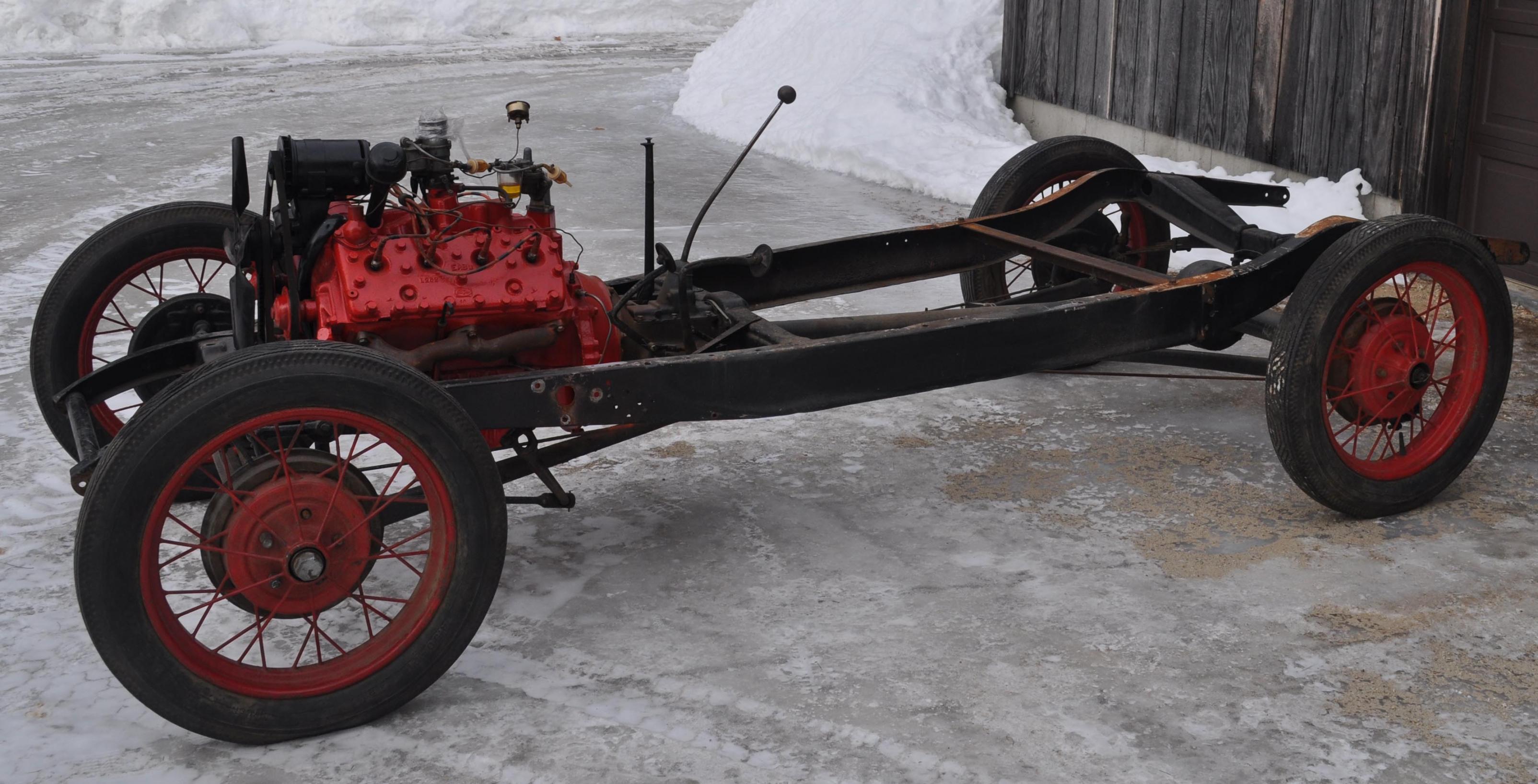

    I also found this 32 chassis with a rebuilt 53 flatty, reworked trans, rebuilt rear. The rails have been patched up and it has mechanical brakes. It cost me a really cool motorcyle but I am more of a 4 wheel guy anyway. I will build it into a hotrod but I like 34's better.
