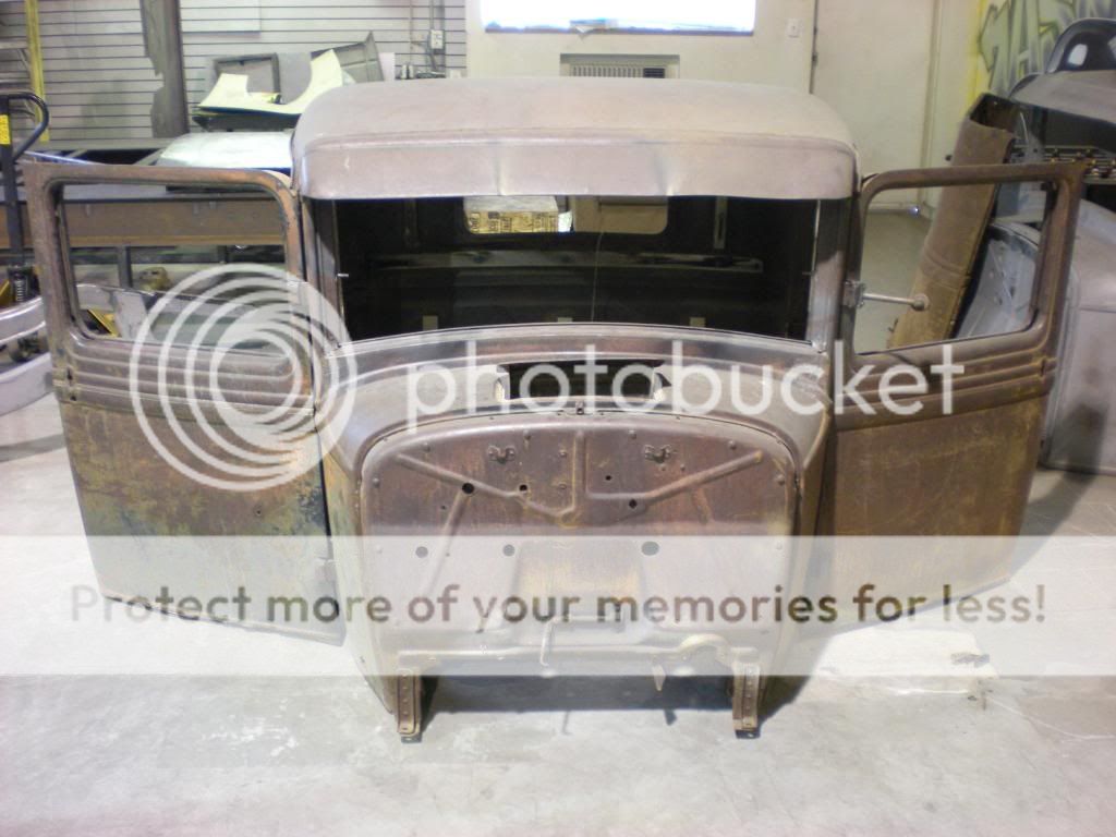

    This 34' cab is for David Gilliam out in florida. Its a cab I had here in the shop that he bought and im going to do all the metal work to get the cab nice. It will be chopped 4" and channeled 4". Hope you guys enjoy :)
    What it looked like before the blasters:
    And back from the sandblasters:

  7. I didn't know they made 34 cabs with the metal on the bottom 6 inches:rolleyes:

    I know, mine is missing at least 6in on the bottom. :)

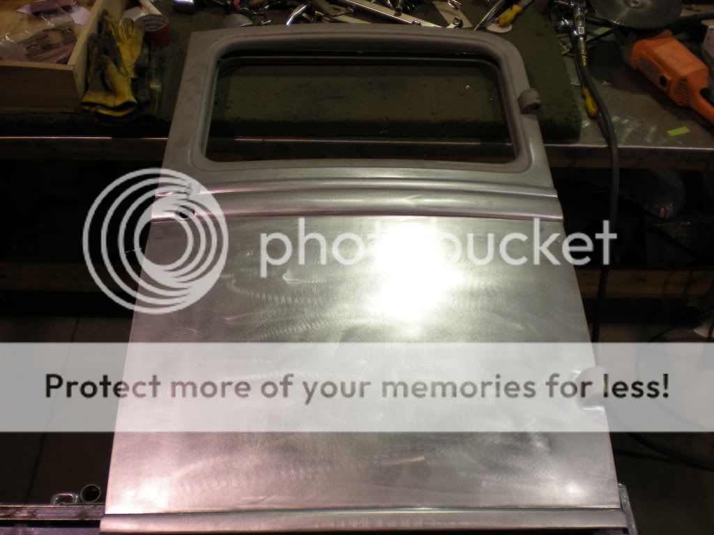

    I got the roof, and the drivers door finished up.
    This is the 7th pickup door I've done so for. Defiantly getting the hang of it :)

    Door skin looks great,Who's metal is it? Thanks

    Great work on the doors

    I make the door skin, and the bottom patch here at the shop. I find I can make the patches fit better. Plus I can make the profiles on the beads closer to the original. Just allows me to make a more accurate product.

    great job on the door....definately got some talent there!:D

    I could defiantly make some skins for you guys. The skin would have the bottom bead, bottom and side's flipped, and would go all the way up to the bottom of the middle beads. You would have to trim the hinge area.
    I'd make the skins for 450$ each. or 800$ if you buy a pair.

    Sounds good ,what gauge metal are you using?How long does it take you to make them and do you make panel for bottom of back of cab? Thanks.

    I find that the 20 gauge I get around here matches closest to the original gauge of sheet metal used. Ive used 18 gauge but where its thicker its harder to get the seam to finishes smooth with the existing panel. I can make it with either 20 or 18 gauge your preference.
    I can make the skins in a couple days time.
    I find that I have to make the bottoms fit each door. The ones they sell work well, and probably cheaper than I can make them. :)
