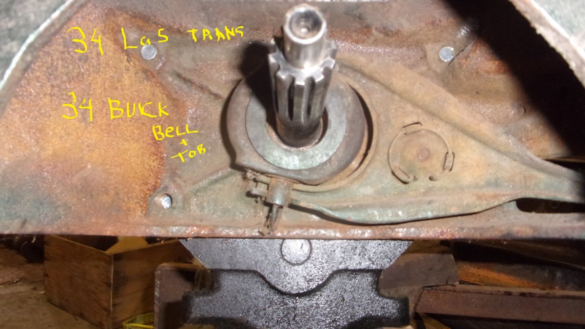

    Ok, I went pretty deep this morning on the trans swap tech for my 35 Custom, and Ray might end up with the same stuff!
    I need a trans guy here to see if I missed something, as I normally do! Not sure if anyone here on Hamb can follow along, unless they do trans swapping of bits and pieces...and,... I know what I am trying to say, but don't always make it understandable...because YOU don't have the same pieces in front of you!
    Ok. Not sure what I did first, but will start somewhere. Will the 34 LaS trans bolt up to the 4 threaded holes in the Buick bell? Yes, but we have a small issue in that I will need to cut a shallow step in the bell center bore to clear the typical GM OD snap-ring on the front main bearing. Look in first pic for the gap I have, because that snap ring is keeping the trans from snugging up.
    ^^^ the Buick front main bearing does have a empty groove on it, AND that bearing OD matches the LaS OD, so that is sweet, as the "bearing"step bore in both bells are identical! Look at the very odd way the buick main bearing is set up, so it cannot go "too deep" into it's bored hole in the case:
    ^^^^ Buick uses an internal snap ring to give that bearing a "stop", Then to keep that bearing from walking forward, the recessed step in the bell does that. This setup is why Buick does not use that empty groove on the OD of the main bearing.
    ^^^ here you can see that the Buick bell has a single step for the OD of the bearing, but does not have the shallow 2nd step to clear the OD snap ring on the LaS bearing retention system. Ok, that shallow snap ring recess needs to be very consistent in depth, but the OD diameter can be inconsistent as long as it can clear that ring. So, I am saying it should be possible to hand make that ring recess, all you need to something to control the depth of the die grinder bit! No $$$ Bridgeport work needed.
    ^^ I am rushing here, so my printing ain't all pretty :) We NEED to know if we need to recut the LaS splines deeper. He, he, unless I screwed up, we DO NOT! We will have 1/4" EXTRA! BUT>> I do not own a 34 Buick clutch disc to see if the hub extends more to the rear that the LaS disc.
    Meaning: I looked for wear marks on the LaS and Buick splines to see how far back each disc runs, ...so my calculations will only be correct IF the buick disc does NOT extend further back than the LaS disc. I am betting we are OK, though.
    ^^^ LaS disc: 10" stock. The LaS flywheel and pressure plate CAN accept a 10.5" heavier duty disc, but the Buick parts cannot use anything larger than the stock Buick 10". The Buick spline diameter is BIGGER, even though that trans looks less strong as the LaS trans.
    ^^^ LaS 10"disc in the Buick wheel. This is what we will need to use.
    ^^ Ok, we know the buick input shaft is bigger OD, so will the TOBs be same ID bore hole, and OD of the carbon wearing face? Yes, they are!
    So, wrapping up so far; I need to shorten my LaS input shaft and machine the snout smoothly to take a typical early Olds or Chevy Oilite bushing. I will skip looking for the stock Buick ball bearing as I prefer Oilite. I will need to make a simple adapter ring on the lathe to reduce the bored OD in the Buick crank, Ray can reuse his 34 Buick ball bearing in his crank now.

    Ok, Driveshaft flange requirements for the 34 trans... Well, here we go again...the auto history books say the 35 is virtually unchanged from the 34 LaS...sorry again, idiots...the trans rear flange AND driveshaft changed for 35! Almost no parts interchange on the 34 to 35 in a general statement: Here are 2 of 5 transmissions I know I have, I think this is all I have, not positive. I only have one 35. I need a 35 for my Custom as I simply have a 35 shaft, and do not have any spare 34 shafts! I do have ONE 34 shaft for my 34. and the 35 one from the 35 sedan chassis for the Custom.
    ^^^1935 LaS: see the "mechanics" type U-joint flange? That is a trade name for that type, same as on the rear pinion of Early Olds V8s.
    ^^^ 1934 LaS, SEE the flange type? See some driveshafts I have below. The Ones with yellow junkyard marking are ones I got from a hamber who's real name is Gerry and from New Jersey. He included this stuff when we met in central Ct for me to buy two old time modded 37 topshift roadmasters with Olds guts. I think I bought one LaS 37? shaft that day and the rest were free. One he said was the rare 50 Olds was not! It is selector!
    ^^^ sorry I clipped off the REAR 34 type flange so Ray can see! I am rushing, and a bit off my game with all that is been happening lately.
    This post took way WAY too long, but I needed to post while words were still in my head LOL

  19. is it possible to make a "tin" 10 gauge spacer to go between the tranny and bell to clear the clip? since you need to shorten the input shaft any way you can spare the distance.
    F&J likes this.
  20. F&J
    Joined: Apr 5, 2007
    Posts: 13,222
    F&J
    Cannot do that because then the bell step that holds the main bearing in correct spot is now allowing the bearing to move forward by same amount of that shim plate thickness. Cutting the snap ring step will go Ok, I will make something up to act like a router, then use a template. Cast iron cuts really nice!
    But I am glad you brought that up as I need to see if the LaS trans shift rail that might stick out into a hole in the bell , is lined up with a hole in the Buick bell. It may not need it, but the 36-38 Roadmasters do need a hole in the bell.
