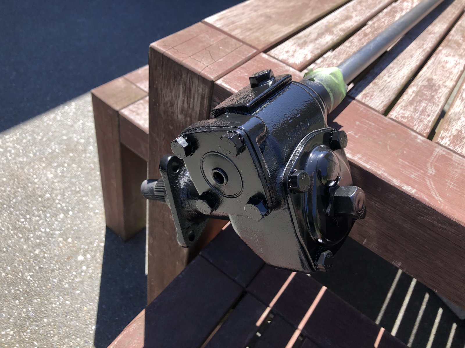

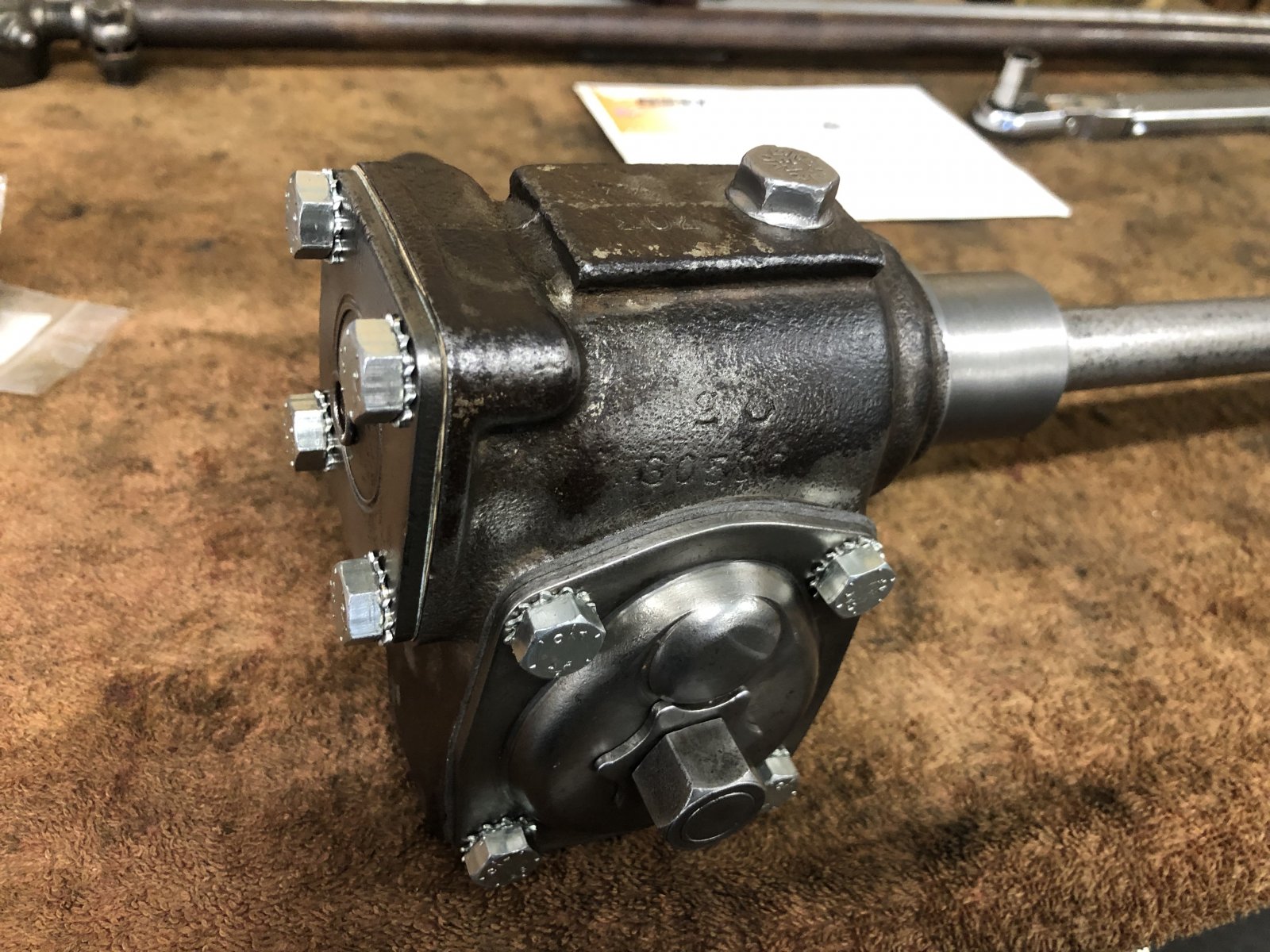

  1. HUDSON STEERING BOX REBUILD: Got this thing stripped and the housing all looks good and useable. Ordered parts for LHD 39 Ford to replace all the bearings,bushes and worm and roller.
    Will get a friend to machine jacket post down to Ford size and see if we can get a seal into the ID of the housing for the sector shaft. The Hudson had an external seal held against housing with a spring.
    There isnt enough meat in the snout to machine a recess for a standard Ford seal. I am going to see if we can recess the outer bush 1/4 of an inch inward and fit a 1 - 1/2 x 1 - 1/8 lip seal in there.

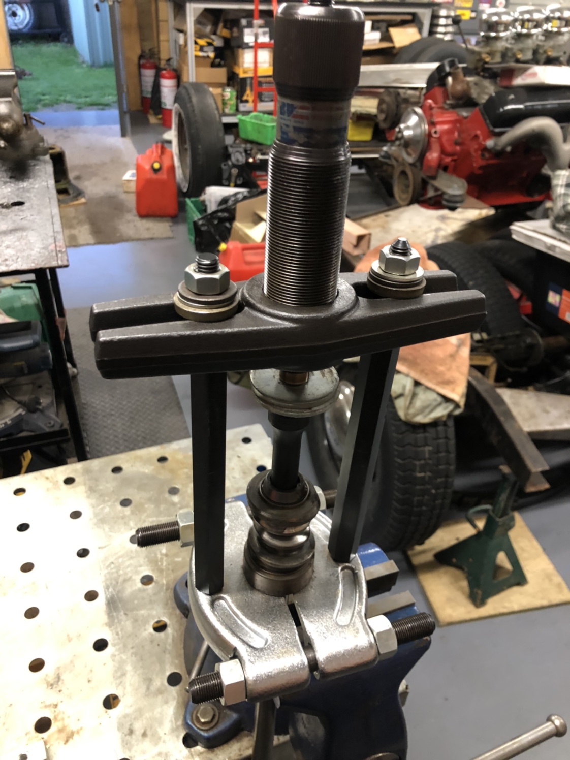

  2. HUDSON STEERING BOX REBUILD : Got the rear bearing out was too stubborn for the slide hammer so shrunk it with some weld.
    Pulled an old steering shaft from parts and removed the worm with a little map gas heat and puller for the new one to go on when it arrives.
    The Hudson had mounting studs like a wheel stud that tapped out with a hammer and punch.
  3. HUDSON STEERING BOX REBUILD: well it’s looking a bit better than found and have got the usable parts cleaned up.
    Should all come together when internal parts arrive from Third Gen soon.

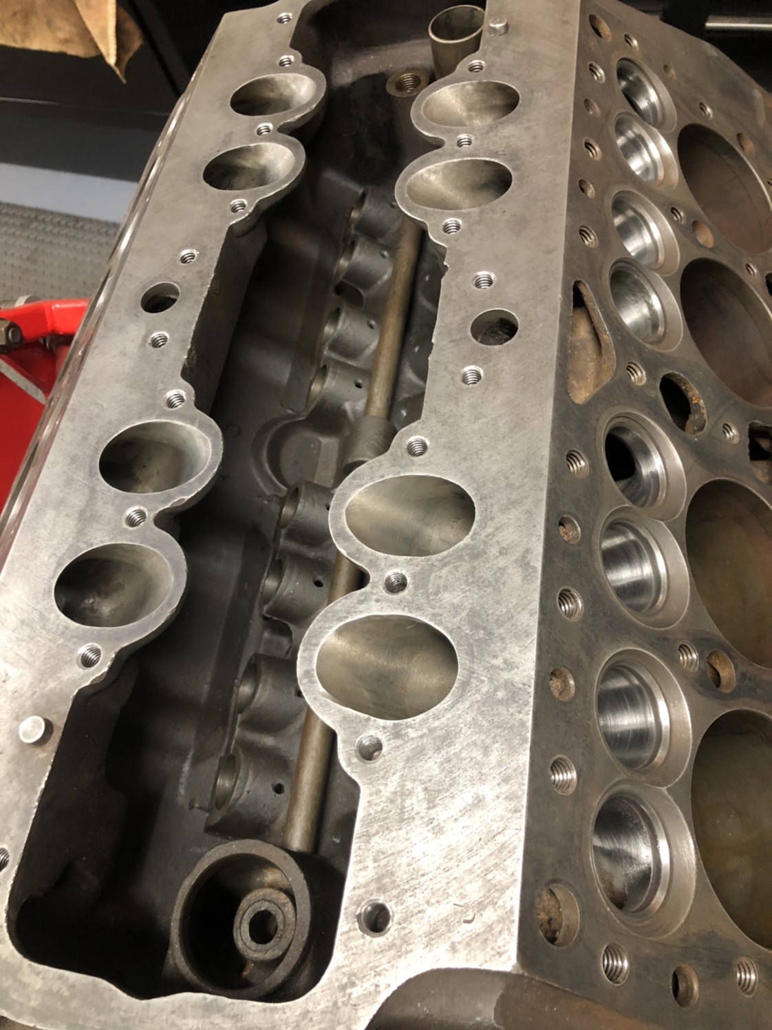

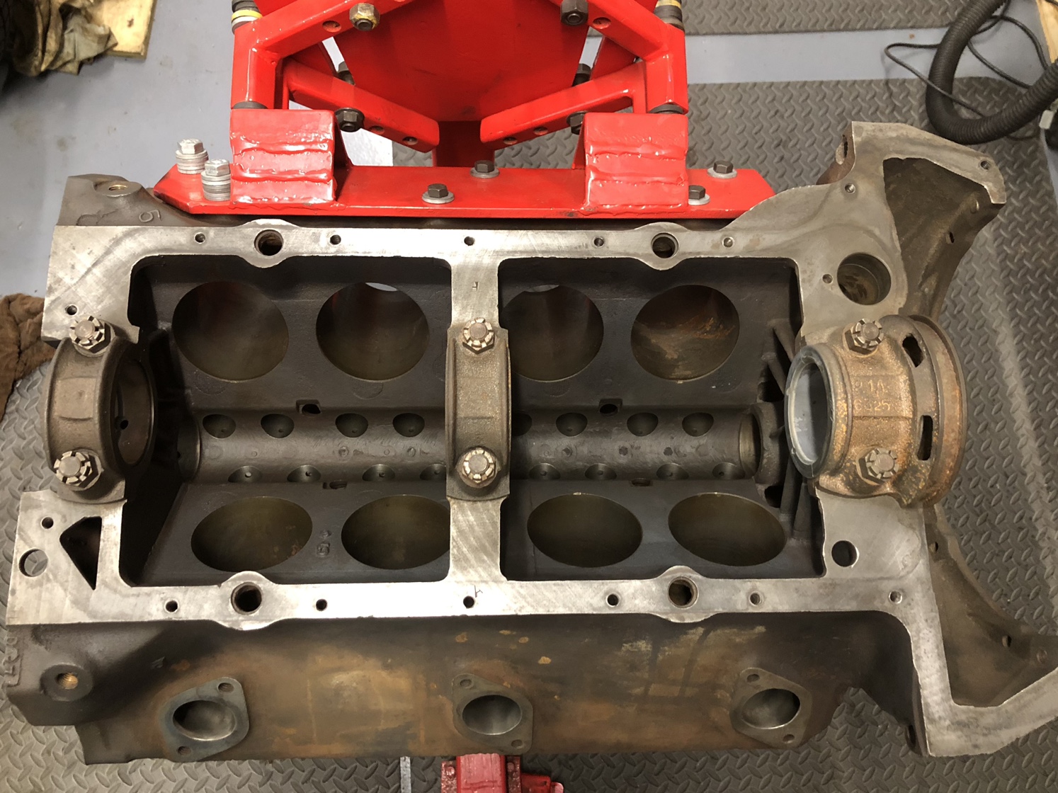

  10. ENGINE BLOCK PREP : Bit more clean up of the block before it heads off to the machine shop. It’s a C59A standard bore 3 3/16 bore block. Have spent a lot of time on cleaning this thing but will all be worth it when done. Got a lot of core wire out of it and silt in the lower block, removed as much casting flash from surfaces as possible and a light porting..
    Will be 3 - 5/16 bore and 4 - 1/8 stroke 284 Cube when completed.

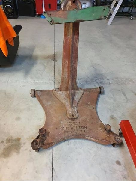

  11. KR WILSON ENGINE STAND - I bought one of my bucket list items this weekend, cant wait to get it picked up and back home.
  12. KR WILSON ENGINE STAND: Well it arrived and have to say it’s a pretty good one. Gave everything some lube and replaced handle rotation lock spring and she’s ready for service.

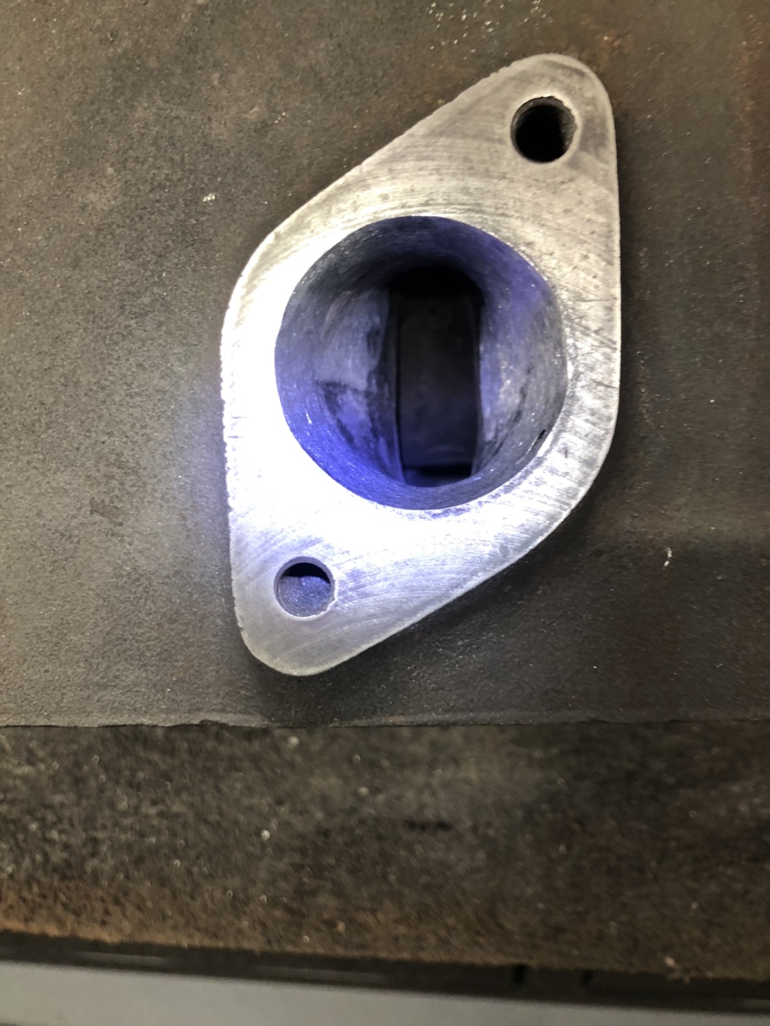

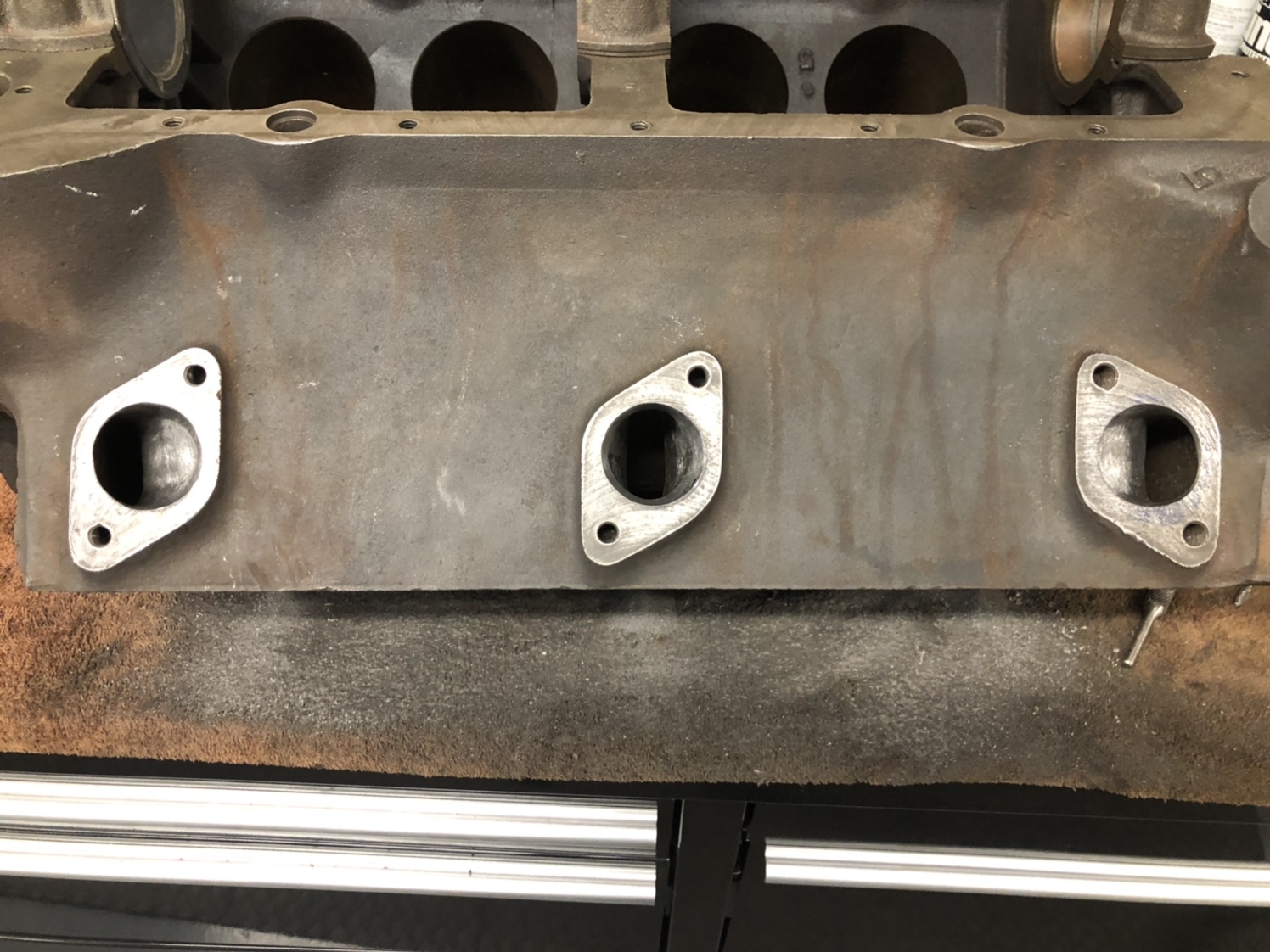

  14. ENGINE PORTING PTII : got the block off the stand so the other side exhaust ports could be completed. A little finessing and will call it done. Gone from 34mm to 42mm

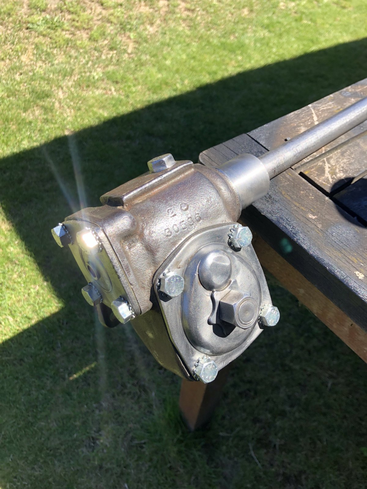

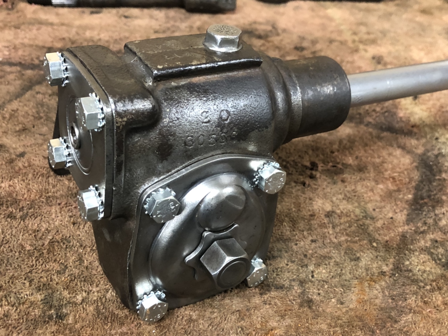

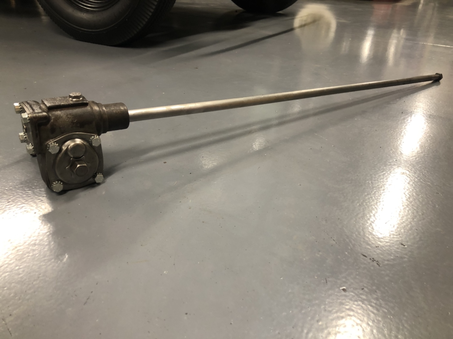

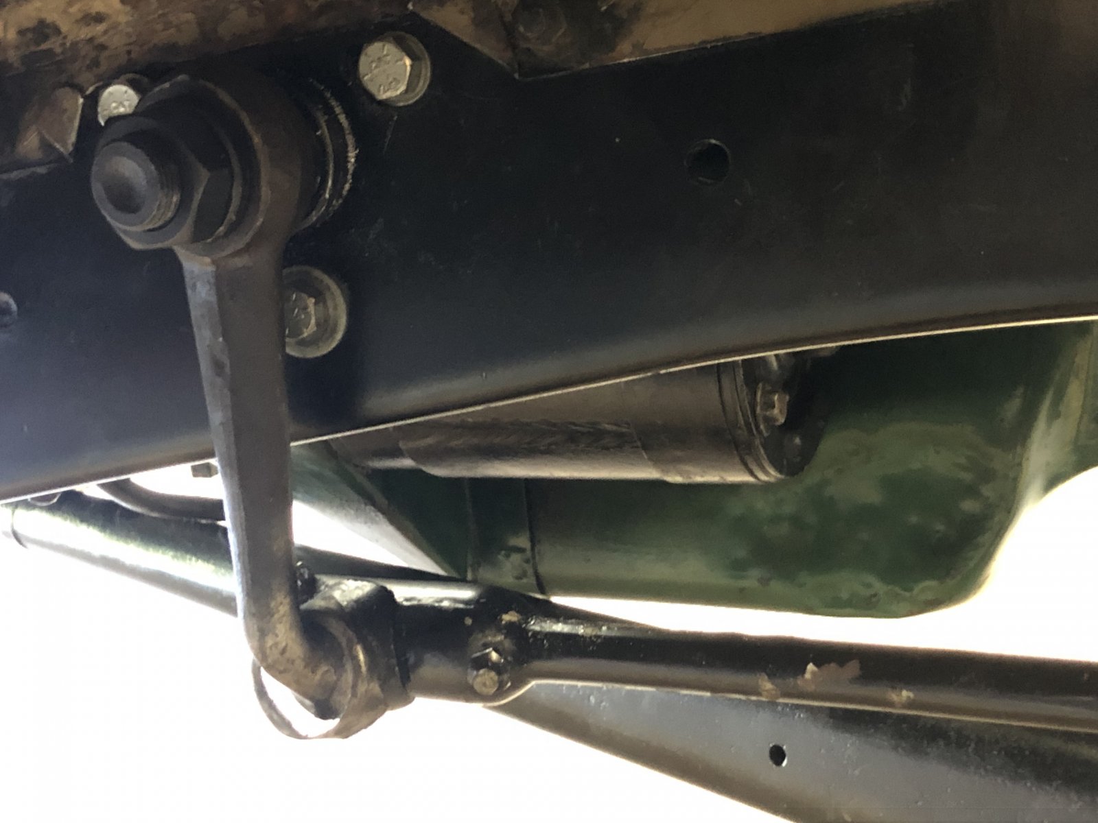

  15. HUDSON STEERING: Had a decent Christmas break so got some good garage time in and completed the Hudson Steering box install in the 1934 Ford Tudor. Have to say it has transformed the car, so easy to move and turn and a pleasure now to drive, the conversion is well worth the effort to complete and is singly the best upgrade to the car as far as drivability and achieved with No Cutting and No Welding and all original unmodified Ford parts used in a Hudson housing.
    So heres whats in it. (remember this is a RHD car)
    1934 Ford Original Steering wheel, shaft and column the steering lock etc all works
    1939 Ford LHD worm on OG 1934 steering shaft, and 1939 Ford LHD Sector Shaft (Hudson Sector shaft is 3/4 of an inch longer)
    1937 Hudson Steering housing, column boss turned down to 1934 Ford column jacket size and oil seal installed on sector shaft, sank outer bronze sector shaft bearing inward to accommodate seal width.
    1939-1948 Ford (Same as 1937 Hudson / Gemmer 3) Bearings, bushings, gaskets
    1934 Ford Pitman arm fits as original.

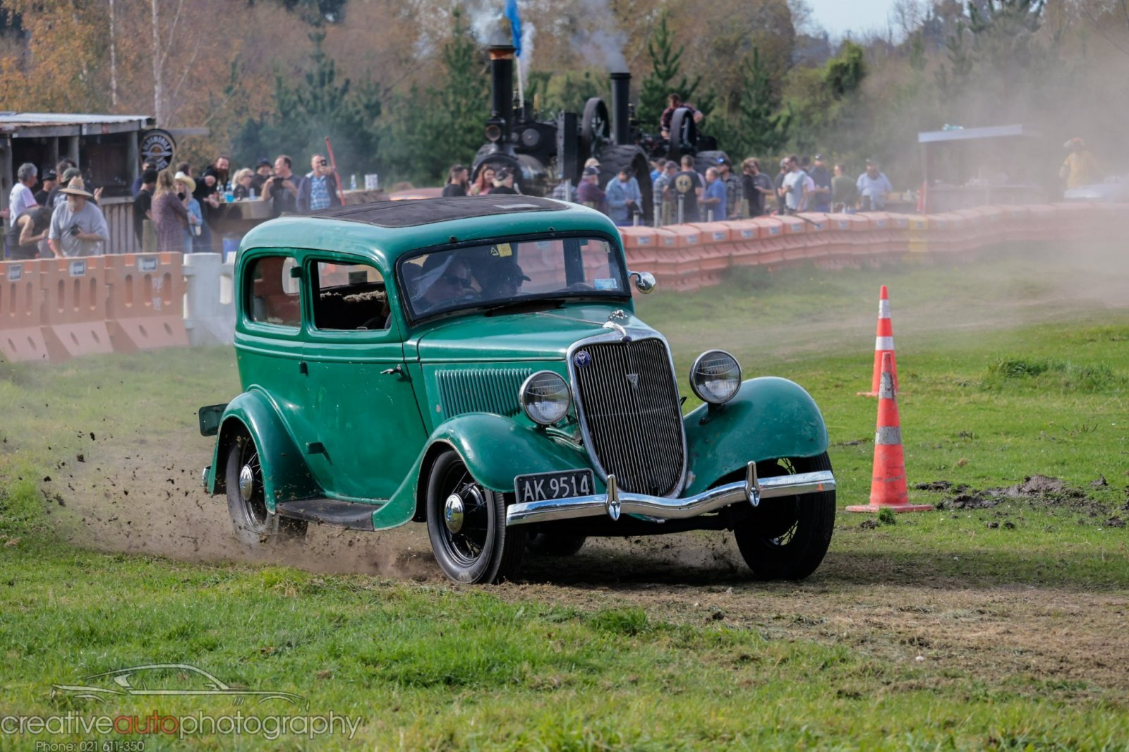

  28. LOOKING FOR SWAY BAR IDEAS 1934 FORD / GRASSKHANA EVENT: We had a annual Rust N Dust event this weekend so I took the Tudor along for a work out to see how everything would go, I figure it was a good test and opportunity to see if anything would break... Nothing did but the old girl is in need of some sway bars so I think that might be next on the agenda. What experience has anyone had installing on a stock axle front and rear configuration

  30. 1932tub
    Joined: May 31, 2005
    Posts: 416
    1932tub
    Used a Morris Minor front torsion bar on my roadster, worked like a charm
