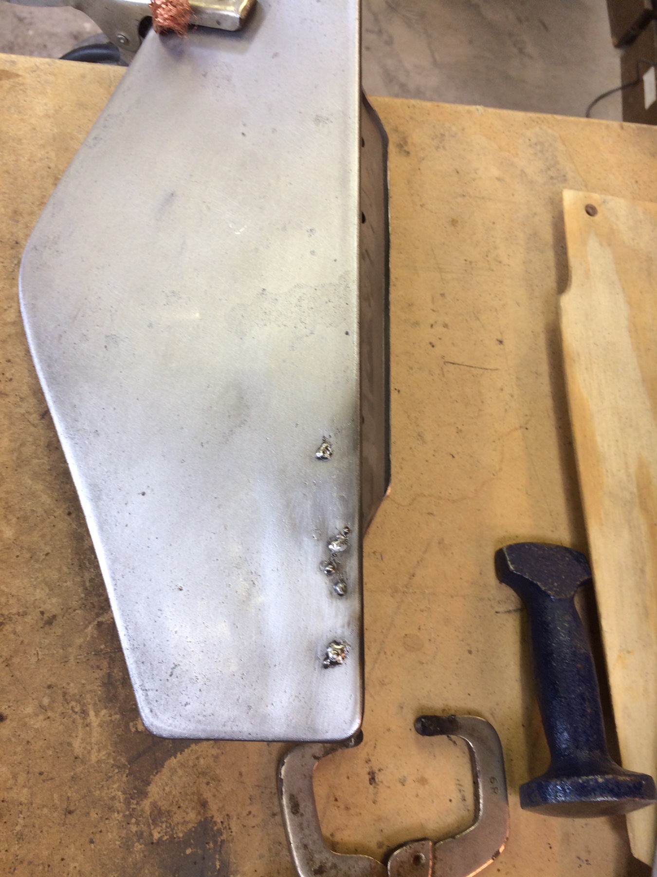

    Yeh, my first try at it.

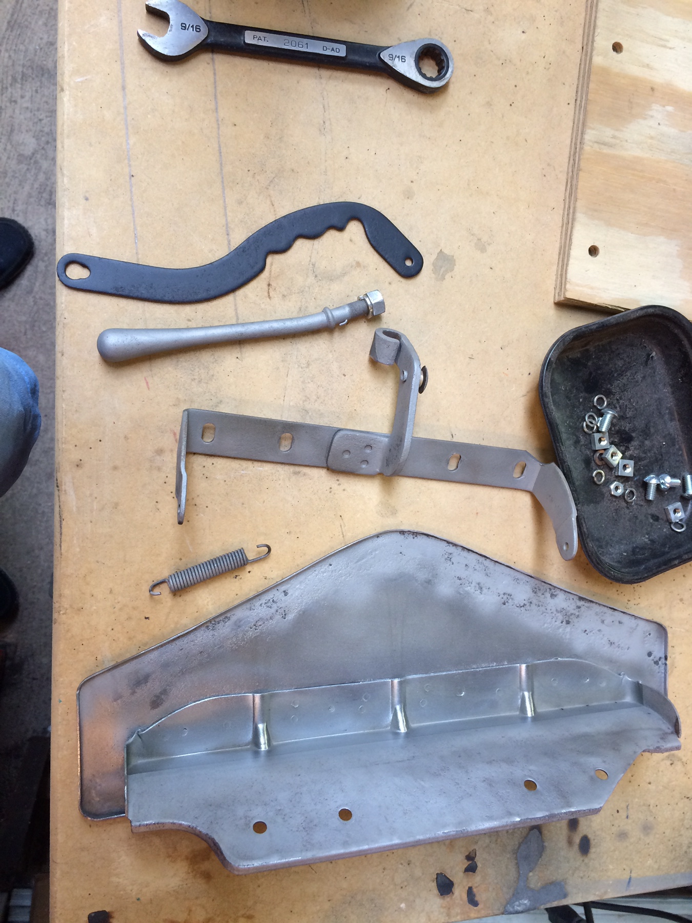

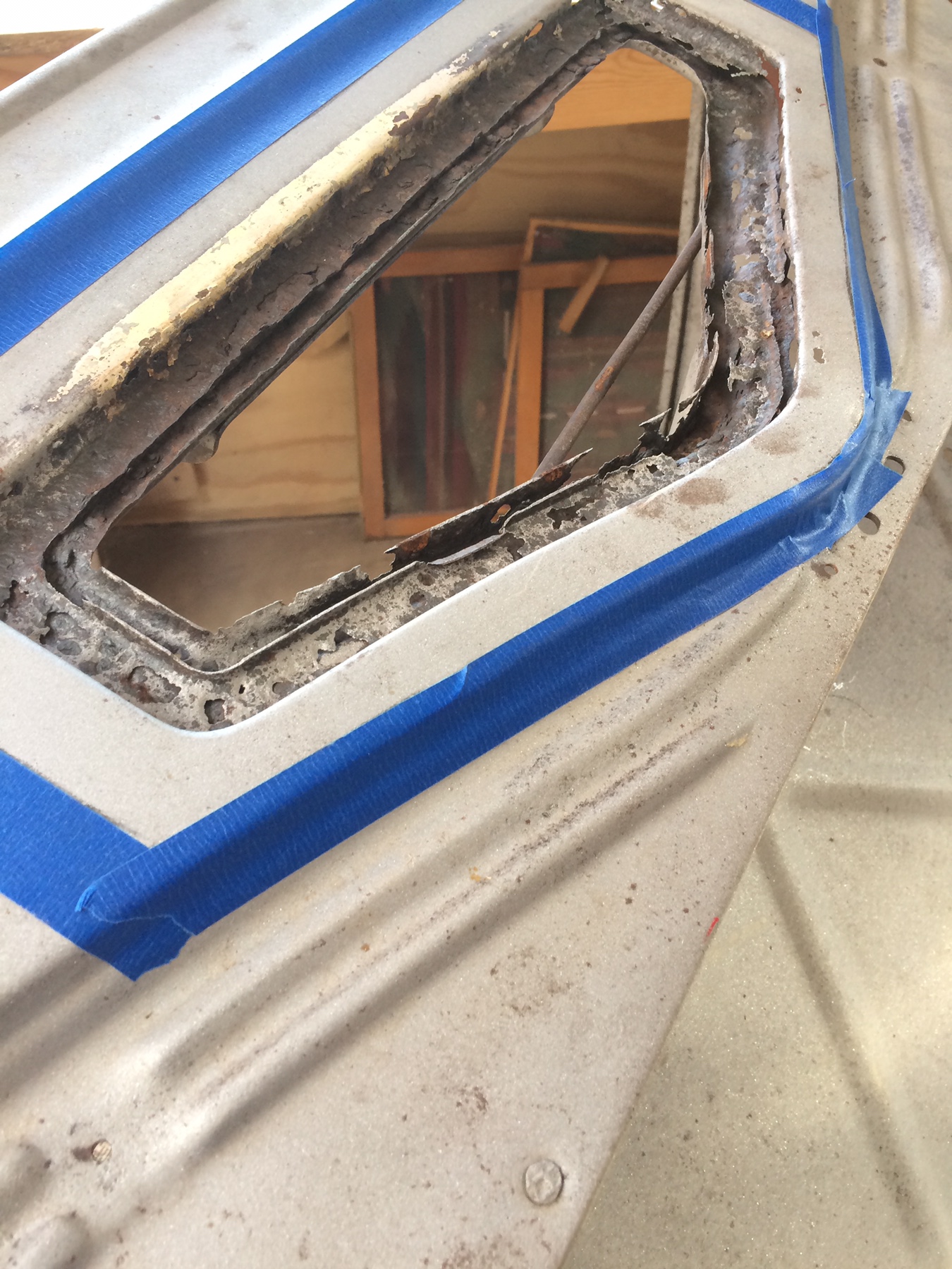

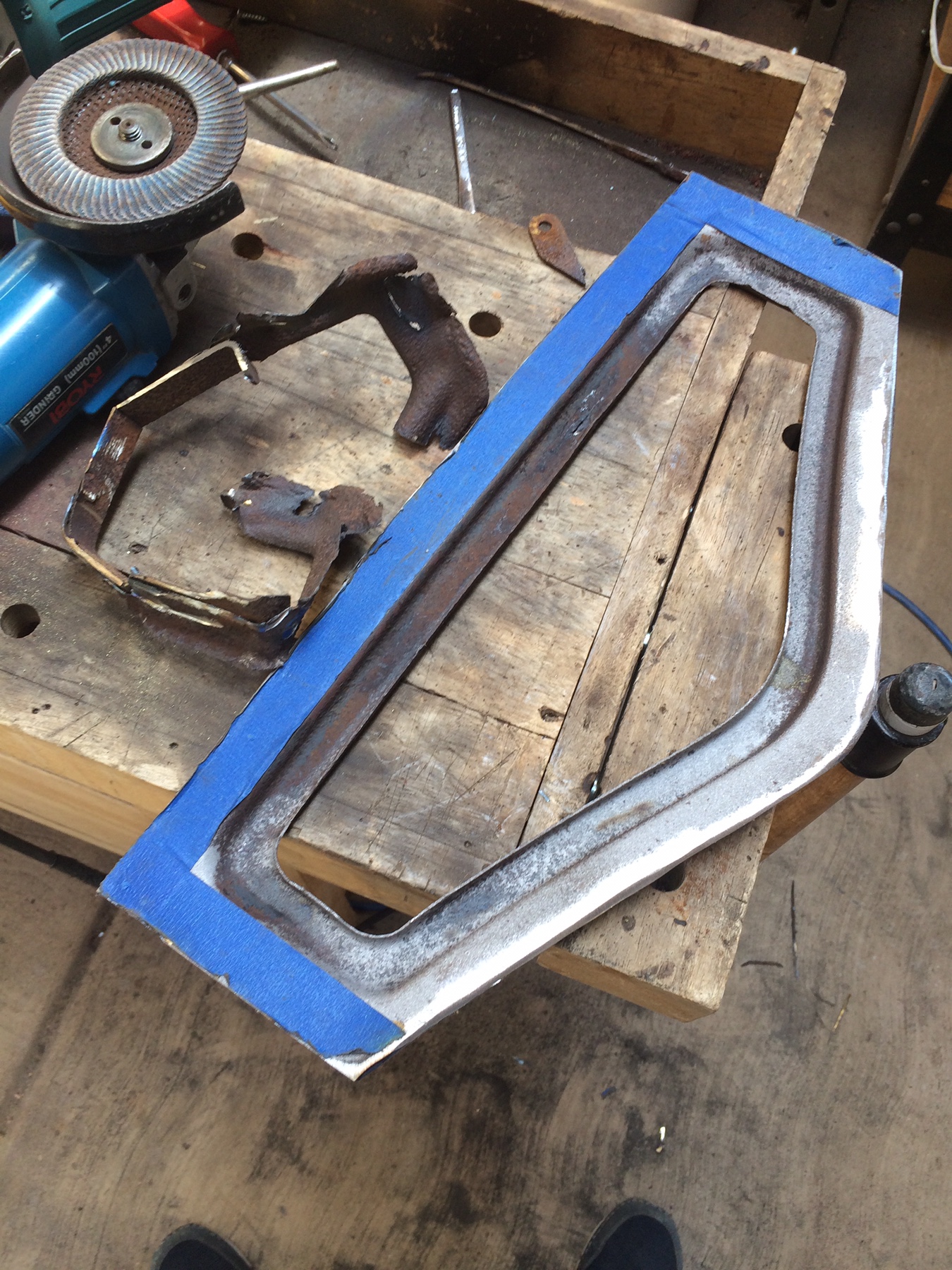

    Now for the vent
    Don’t worry, here is the replacement piece from my doner cowl
    All parts in evaporust for the night

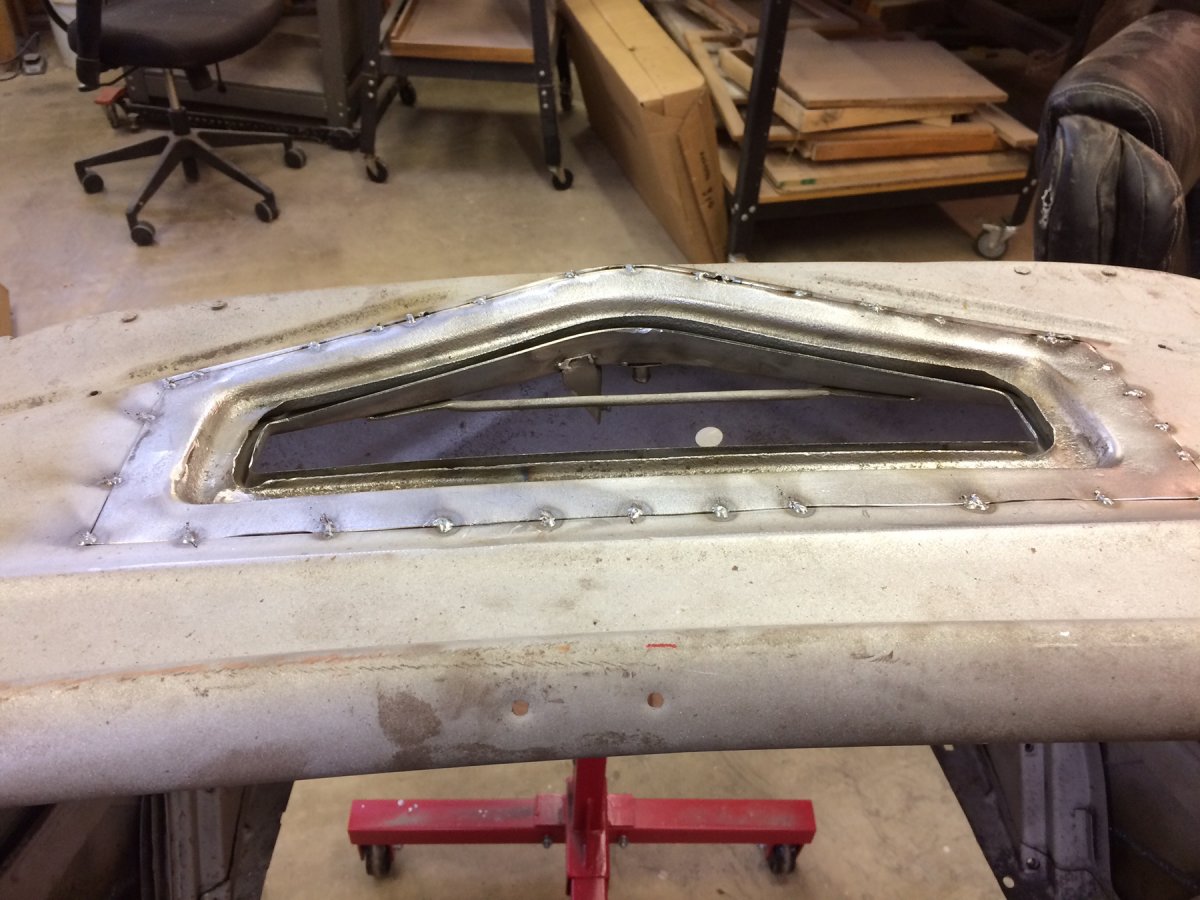

    Everything cleaned and ready for assembly. The drip rail is from SAR.

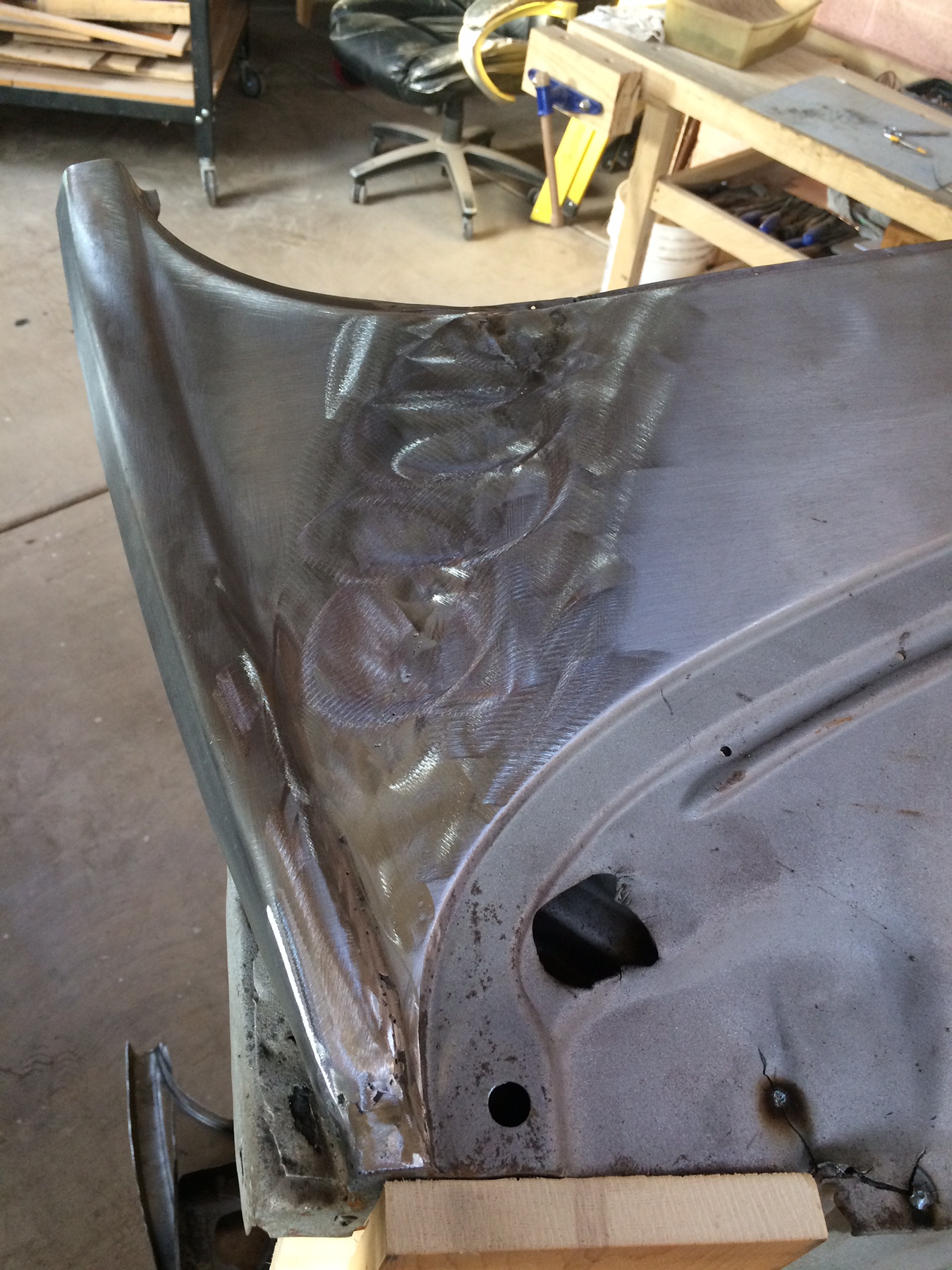

  14. The thing about leading for those that haven't done it is the amount of time getting the metal spotless for tinning and then tinning. Heck the actual leading part goes pretty fast after the prep work. Nice job !
  15. Elvis100
    Joined: May 21, 2016
    Posts: 386
    Elvis100
    Thanks, I think I’ll do the whole car with it

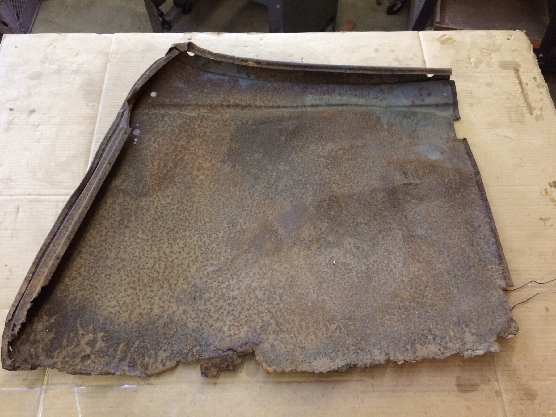

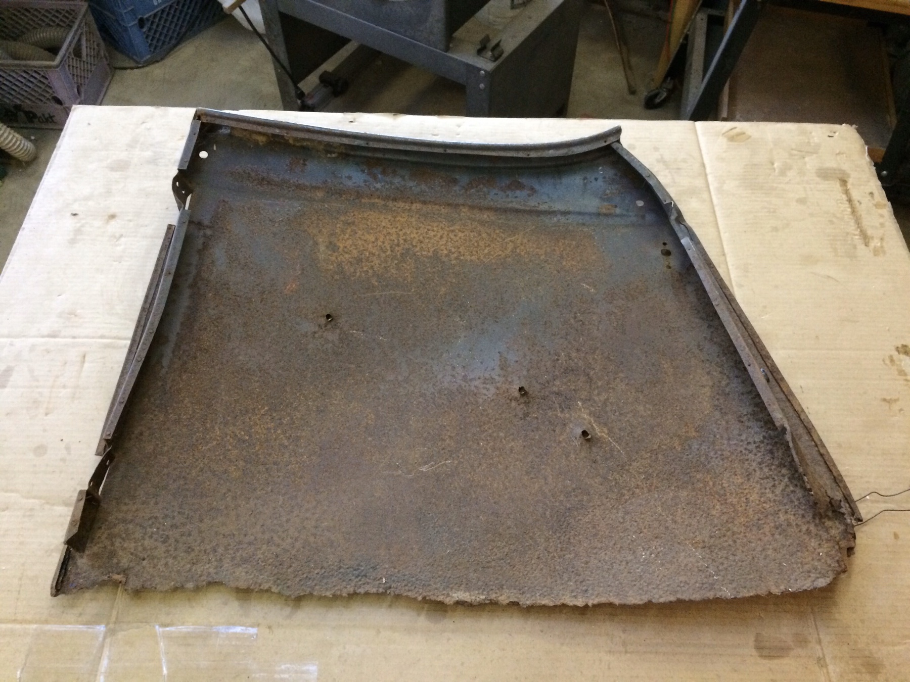

  23. Elvis100
    Posts: 386
    Elvis100

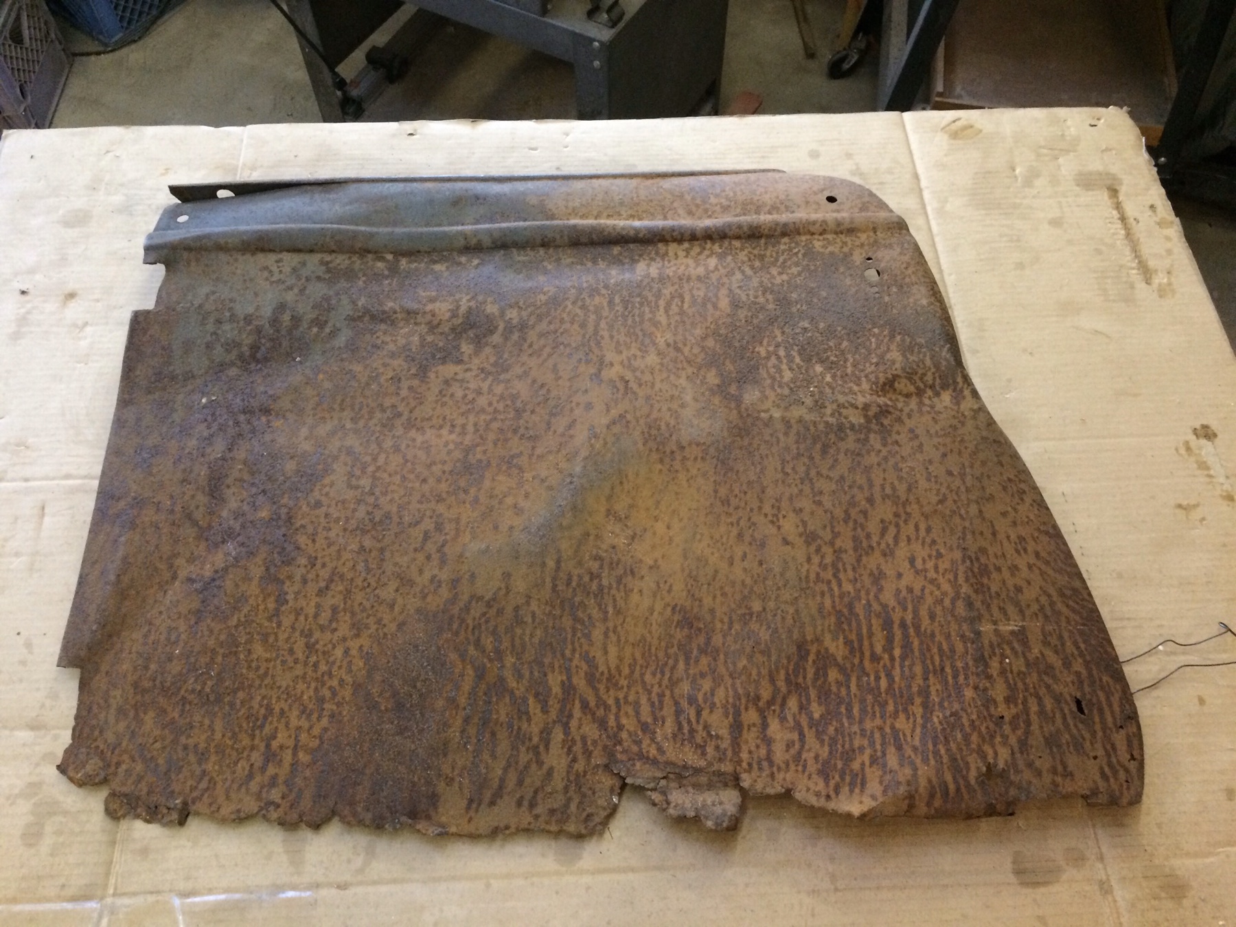

    I was able to get another pair of roadster doors from a fellow H.A.M.B.’r for a reasonable price considering... I’m going to do the metal repairs and make some wood for them.

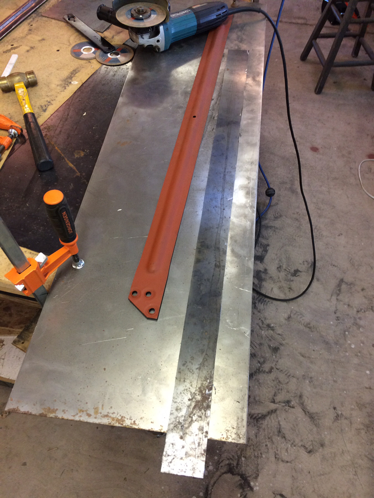

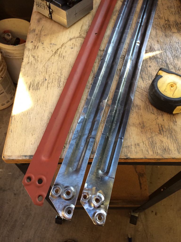

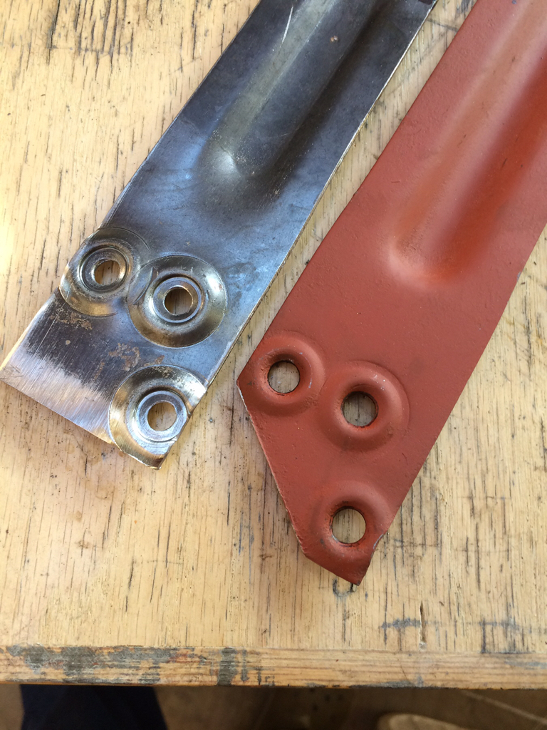

  25. Elvis100
    Posts: 386
    Elvis100

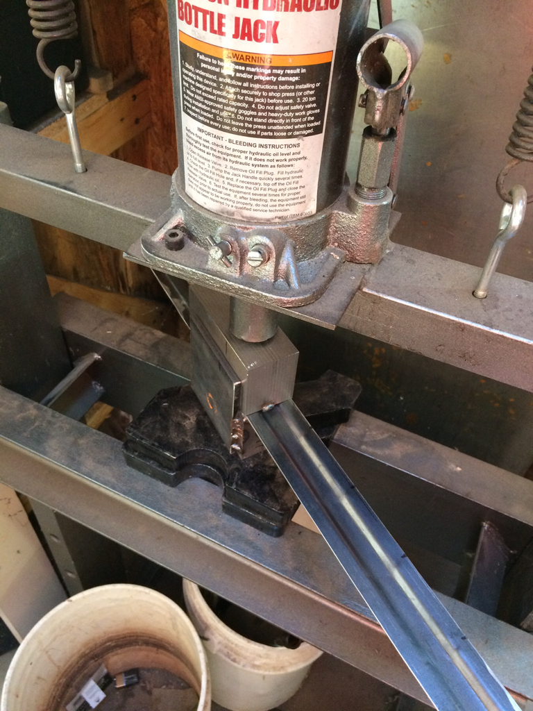

    There were no diagonal braces included with the doors. I made a die and banged out a set

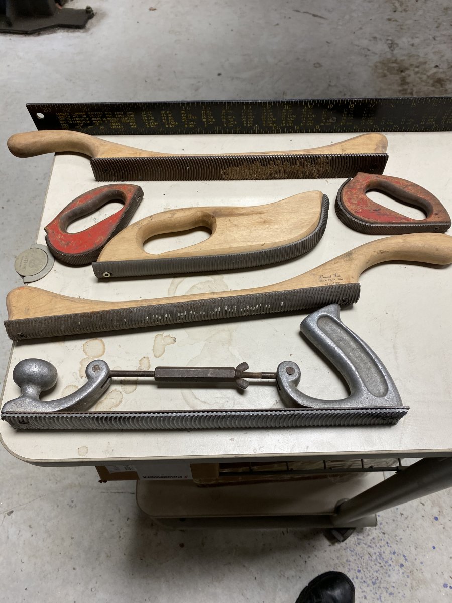

    FB7E0516-BC23-4D93-88EE-641ACA08ADE8.jpeg A5C2CADB-A48B-4945-AC8D-E2C9E7D7BDA9.jpeg 6B3DAD24-2C17-47C8-BA86-5A056220BE79.jpeg Perfect
    Original Fairmont pick hammer with the end burnt from holding panels in alignment and a selection of files including two small radius reveal files
