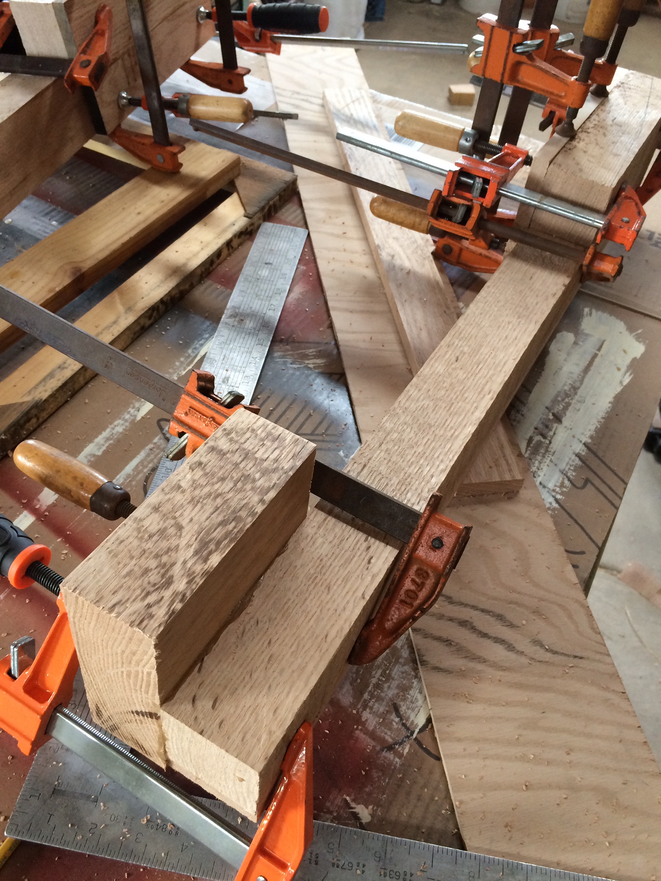

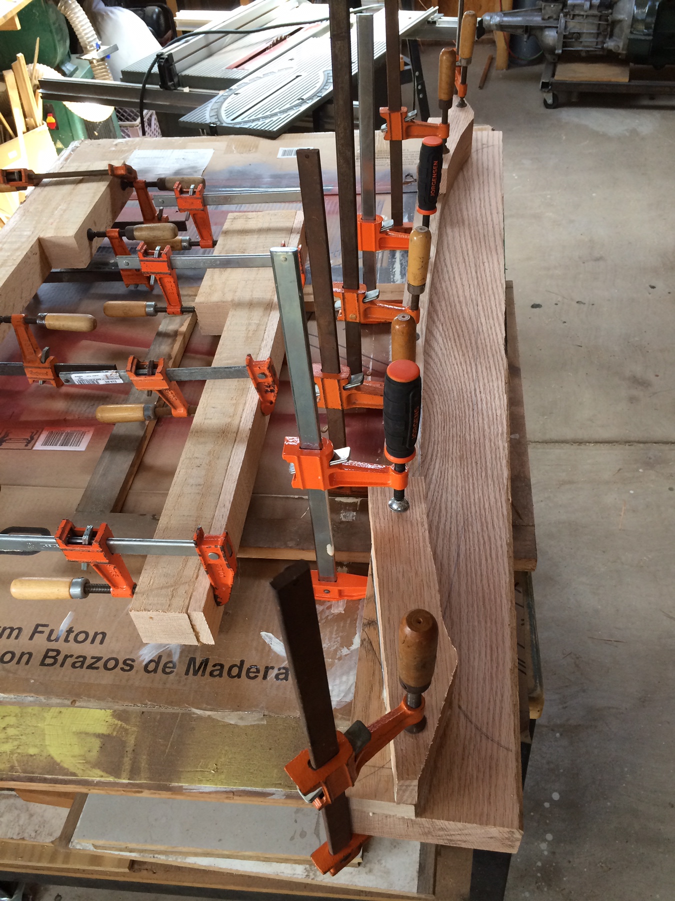

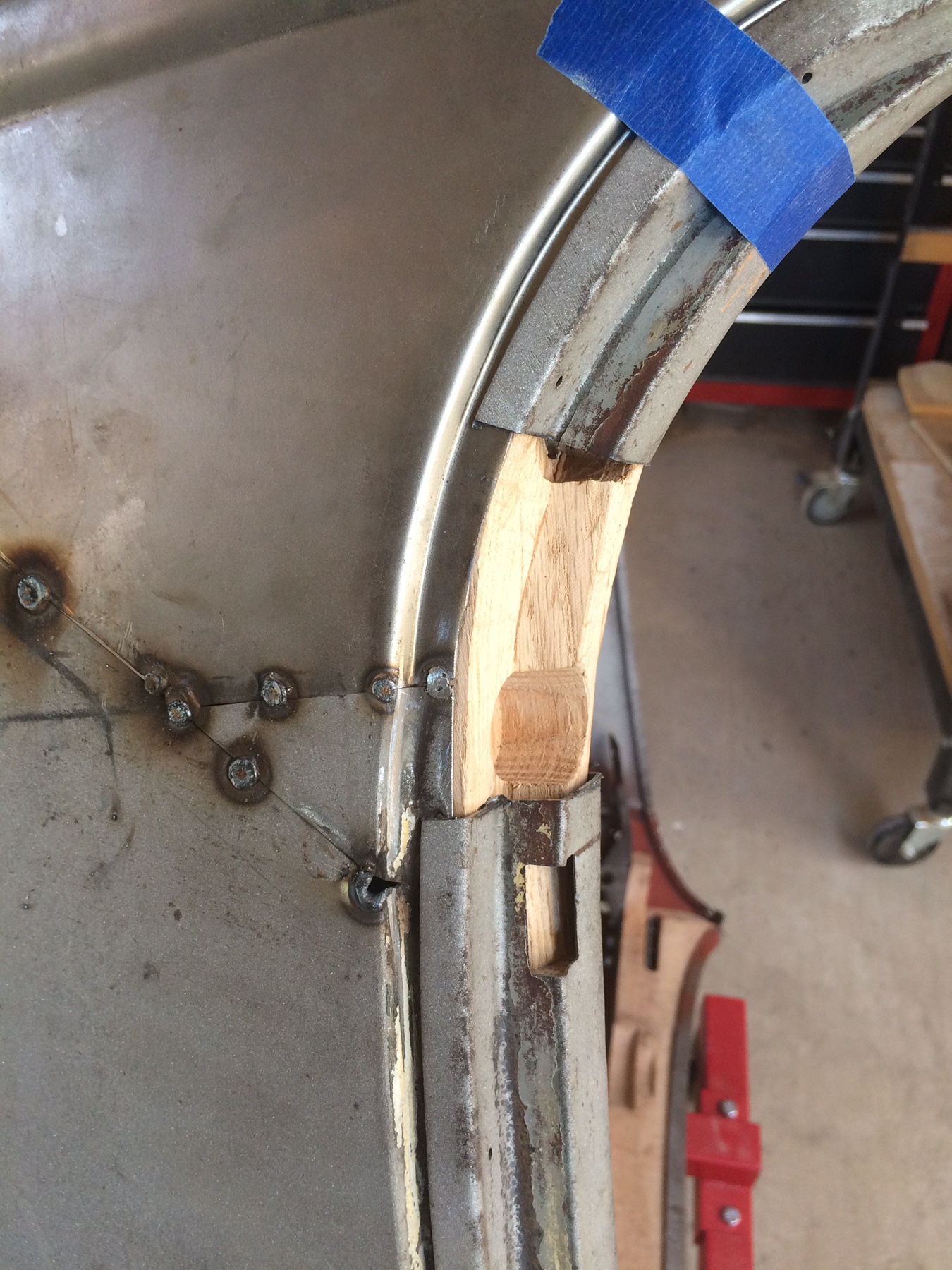

    Worked on the cowl top piece
    [​IMG][​IMG]
    Finished the glued laminates on the a-pillar wood

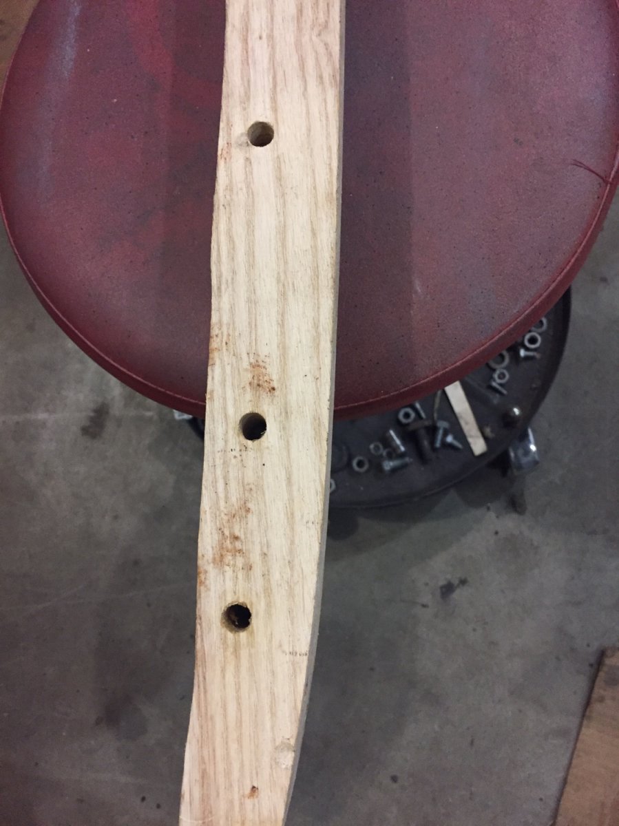

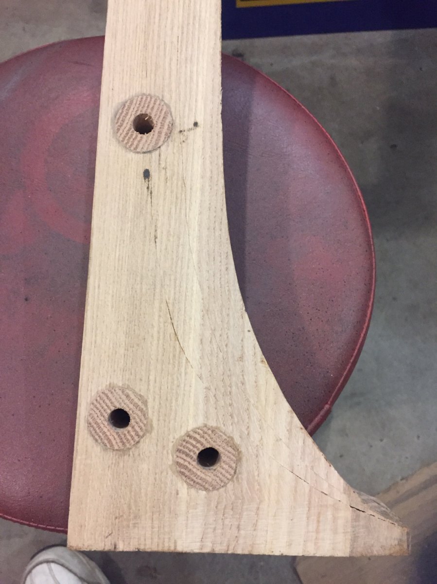

    I’m glad you are making the cowl wood pieces yourself. The pieces I got from the place in Utah were made incorrectly. All of the holes in the bottom had to be redone. The front to back holes were in the wrong spot and The nut holes for the inboard L brackets were counterbored on the wrong side. Pretty disappointing. IMG_6890.JPG IMG_6891.JPG IMG_6892.JPG

    [​IMG][​IMG]
    There are countersink on both sides, but the internal ones are only for countersinking the back of the a-pillar bracket so it sits flat. Yours don’t seem to have the rebate for the a-pillar bracket

    You are correct, I plugged the holes because they were 1/2” deep and I still need to countersink them for the brace

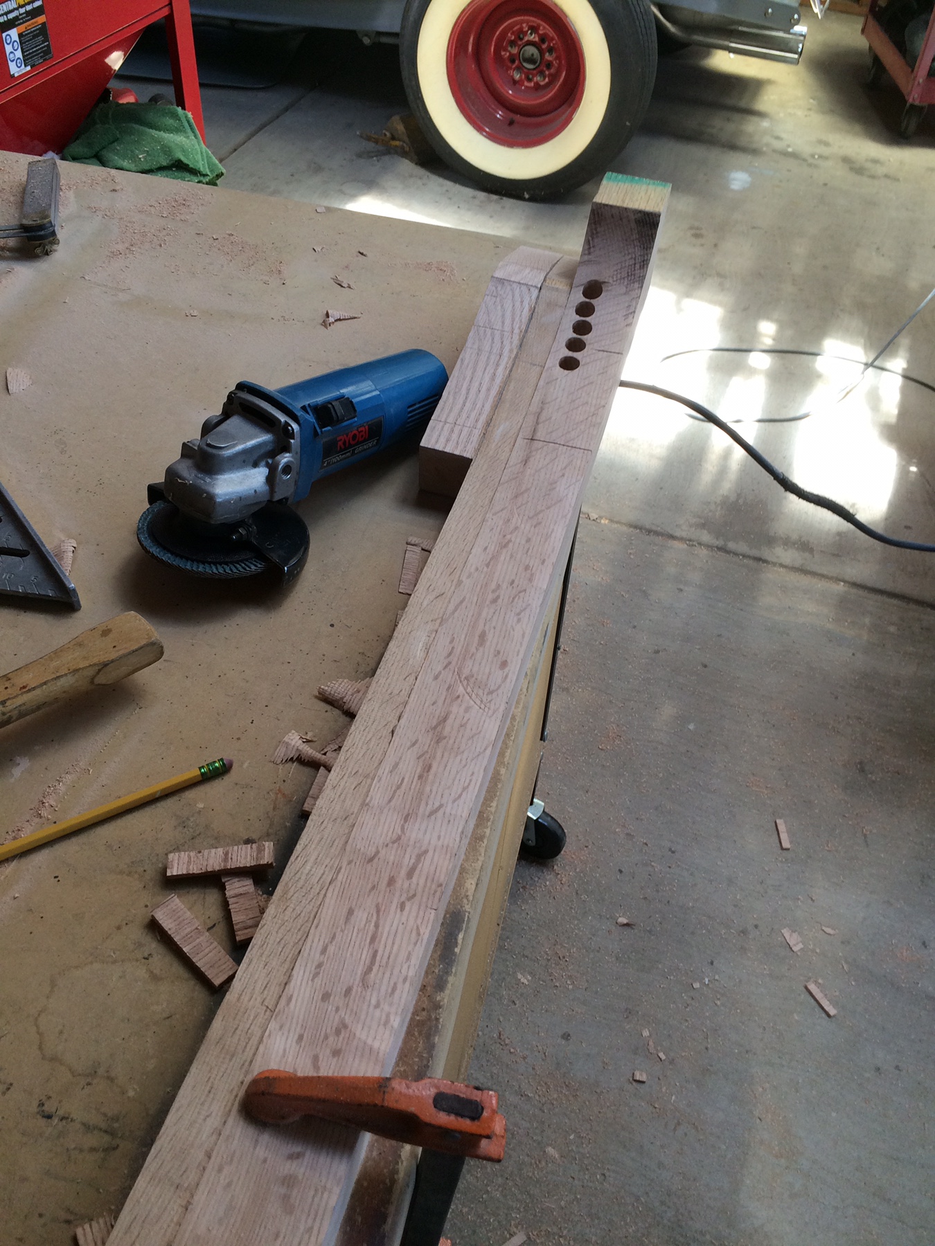

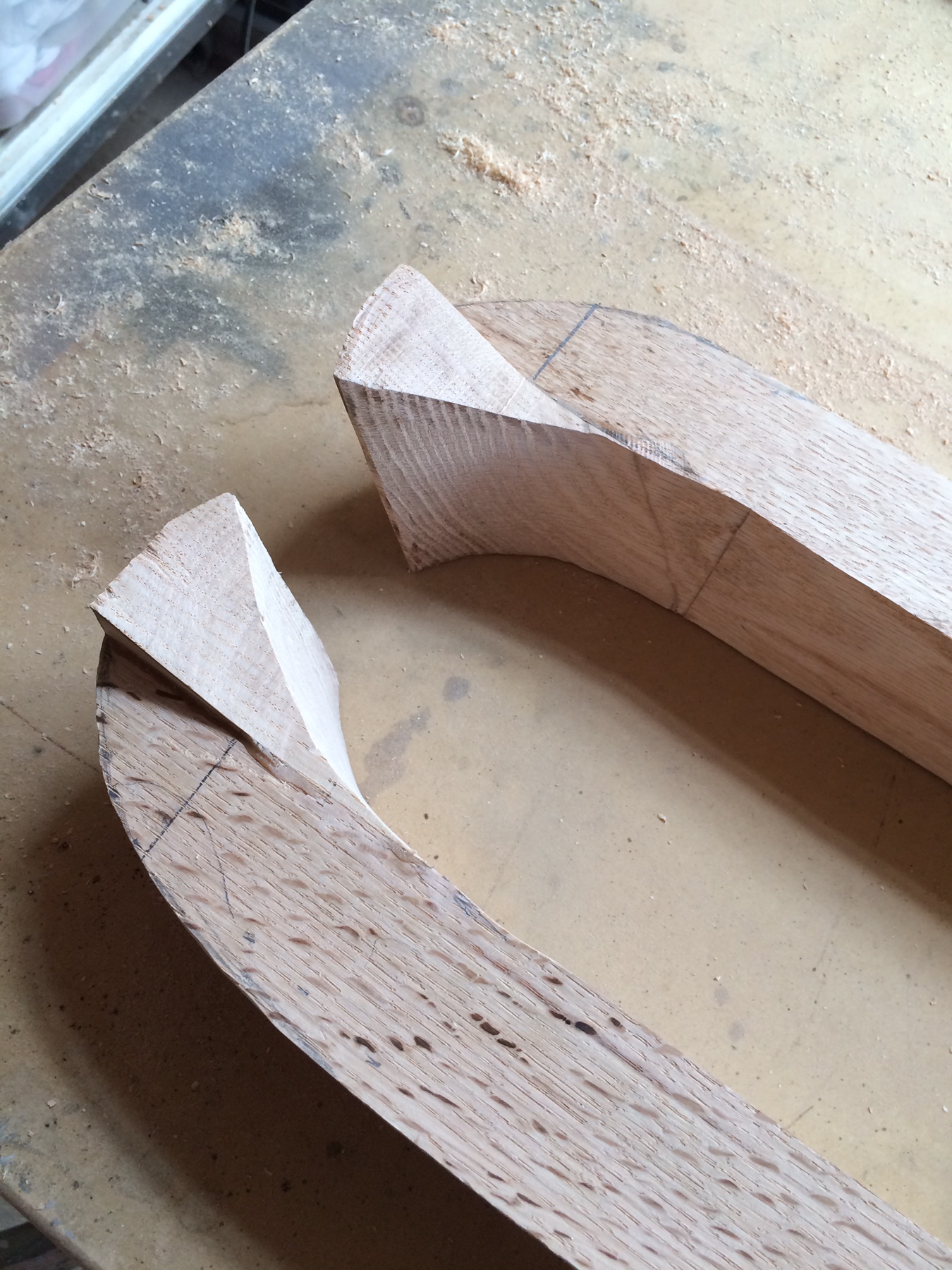

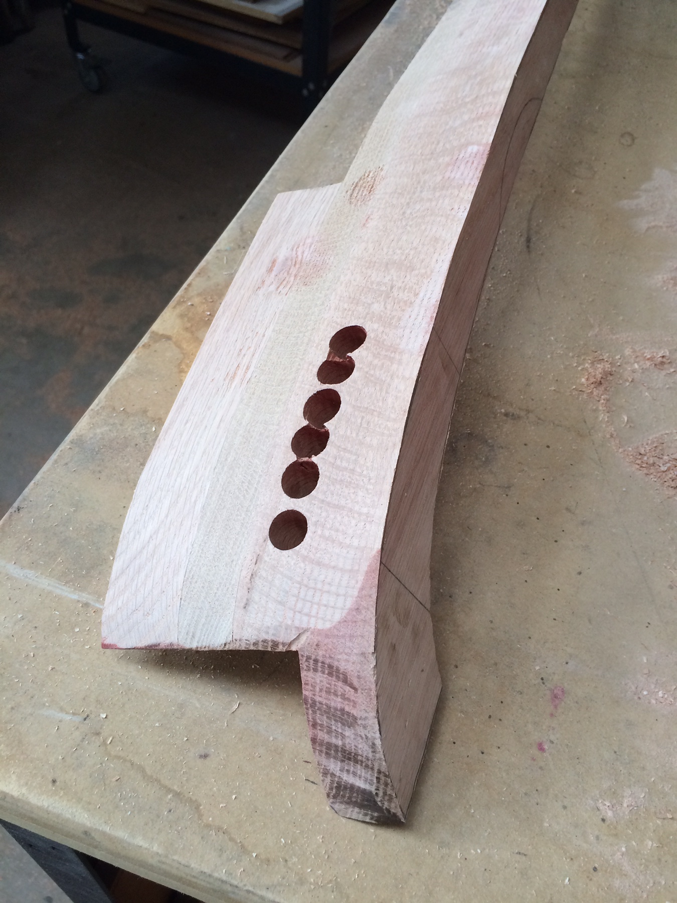

    More shaping on a-pullers
    I noticed an extra hole in the firewall

    Thanks, unfortunately I don’t think paper patterns would do it. The A-pillars have some crazy rolling bevels. I would recommend Brads Wood shop tel:360-317-5723

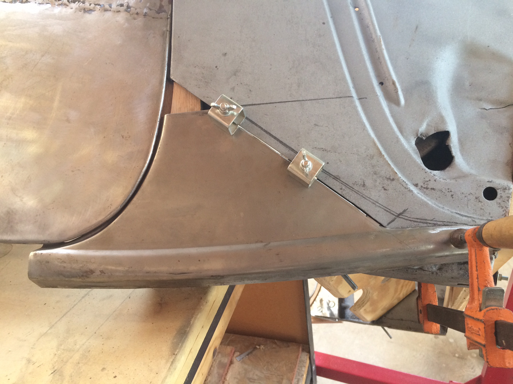

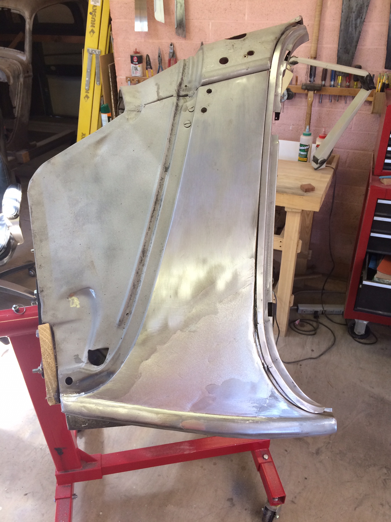

    Since this is an Australian cowl, in addition to the patch panels I had to make a piece to extend the door edge tins down to cover the new radius of the door opening.
    The modified with Australian next to it
    Both sides tacked, need to get some argon tomorrow and weld everything up.
