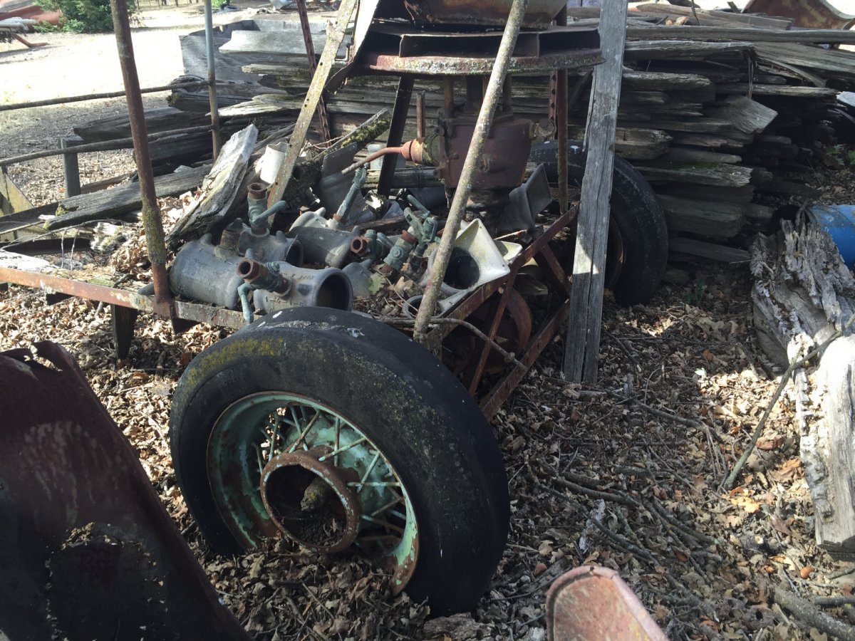

    Guy came by today to buy my Cadillac marine engine and gave me these. He had a super dual manifold, but not for my year. ImageUploadedByH.A.M.B.1441397231.821048.jpg

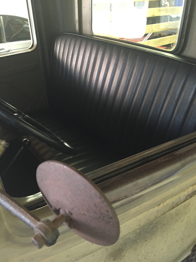

    Got the seat back and installed today ImageUploadedByH.A.M.B.1441833706.678530.jpg ImageUploadedByH.A.M.B.1441833736.275892.jpg

    The seat came out fantastic! Love the truck!

    Thanks, Jersey. The seat did turn out better than I expected.
