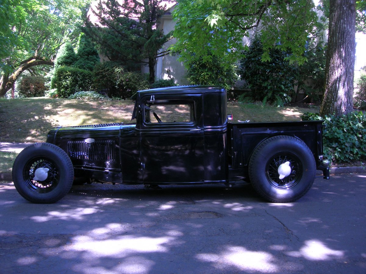

    I built a "34" Ford pickup hot rod with a 6" chop, channeled 6" over the frame and stretched 5" behind the rear of the door opening. The car has the stock radiator shell and full hood and side curtains. the engine is a 302 Ford crate motor rated at 345 HP. I have a Tremec TKO 600 five speed transmission with the .82 overdrive. The car has no fenders. My problem with this car is the incredibly loud wind noise starting at about 60 mph. I actually have to wear ear protection to cruise at 70mph. Conversation with the passenger is next to impossible. My guess is that the visor above the windshield channels the air to the left and right and that the noise happens as the air stream passes around the "A" pillar. I thought of fabricating panels attached to the top hinge to smooth the air around the pillars but these would be ugly and made of aluminum would cut down on visibility. I also thought of cutting the visor off to see if that eliminated the wind noise. That would be drastic but if metal finished correctly wouldn't look that bad. This would look more like the windshield treatment of a "32" Ford. I would like to know how other Ford pickup owners have addressed this problem and what people's opinions would be on whether or not DSCN3747.JPG removing the visor would eliminate the wind noise. I could always weld the visor back on if I wanted to. Thank you.

    Cutting off the visor would be wrong, and ugly. Do you have all the doors sealed, and the windshield? Maybe add more stick-on foam seals in the gaps. There are a few companies making a variety of sizes. Check the ads in a magazine like Street Rodder. Make sure you are going 360 degrees around the doors. I bet Ford didn't have much more than the windlace under that tin strip above the door.
    Also, maybe the noise isn't all wind, but vibration as well. Sound deadener like Dynamat or Lizard Skin could help a lot. Sure couldn't hurt.

    I had a 34 ford hot rod pickup with a lot of wind noise, the nasty 348 Chevy (lake headers) was not quiet either. I always thought about fabricating a removable rear window to let the air pass through the cab more efficiently. It would be worth a try to remove the rear window and take it out for a highway cruise. Let me know how you fix your wind noise problem. Don't cut that visor.. You have an awesome truck. Gary

    Very nice truck...........what are the ''dots'' on the top?

    I wonder if cutting 3-4" holes in the face of the visor would have any effect?
