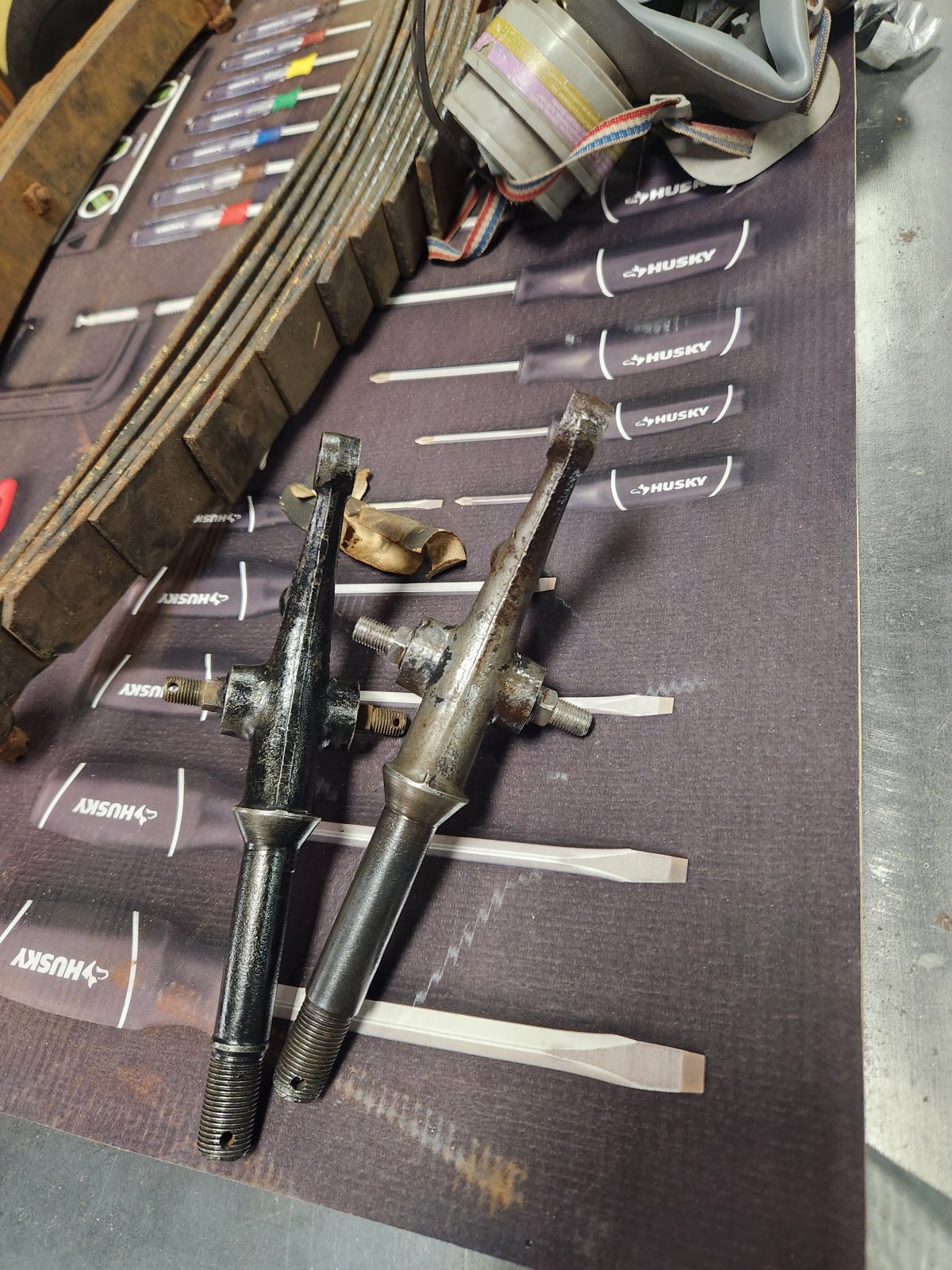

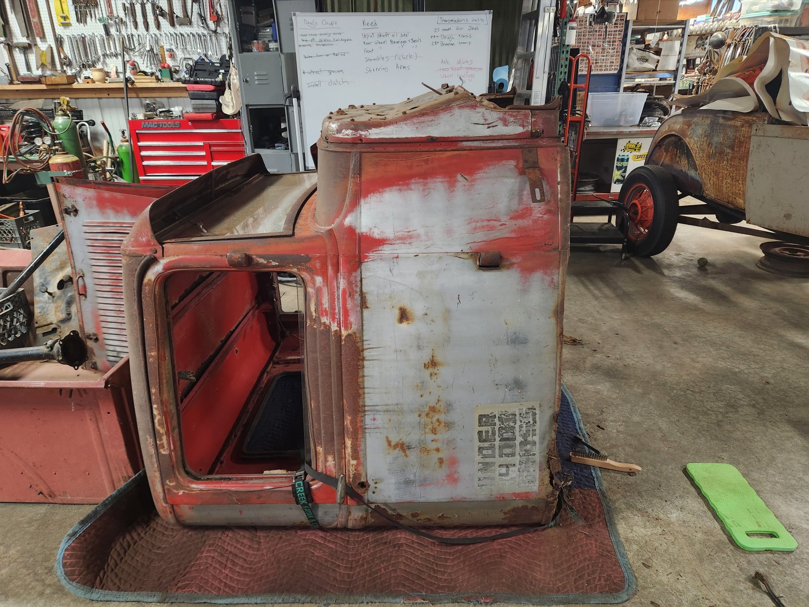

    Here is the sheet metal
    Great patina, right? FYI that is original red paint under 1 repaint. Original v8 truck too.
    At this point I set it aside, and started looking for a chassis...which took several years. I didn't try to hard. Obviously. But I did finally acquire a full roller. This in itself was an adventure that included getting lost in Oregon and loosing the poor steering wheel at 60 mph..
    Unfortunately the frame was full of rust and Bondo, but I was still young and dumb, so I spent a lot of time welding up the frame. It's strong and well done. But not to my current standards...more on that later...
    Anyways. Then life happens. I moved the shop like 5 times in 5 years. Blah blah blah...sometime last year I found a nic3 bed that kinda matched, and now here we are.

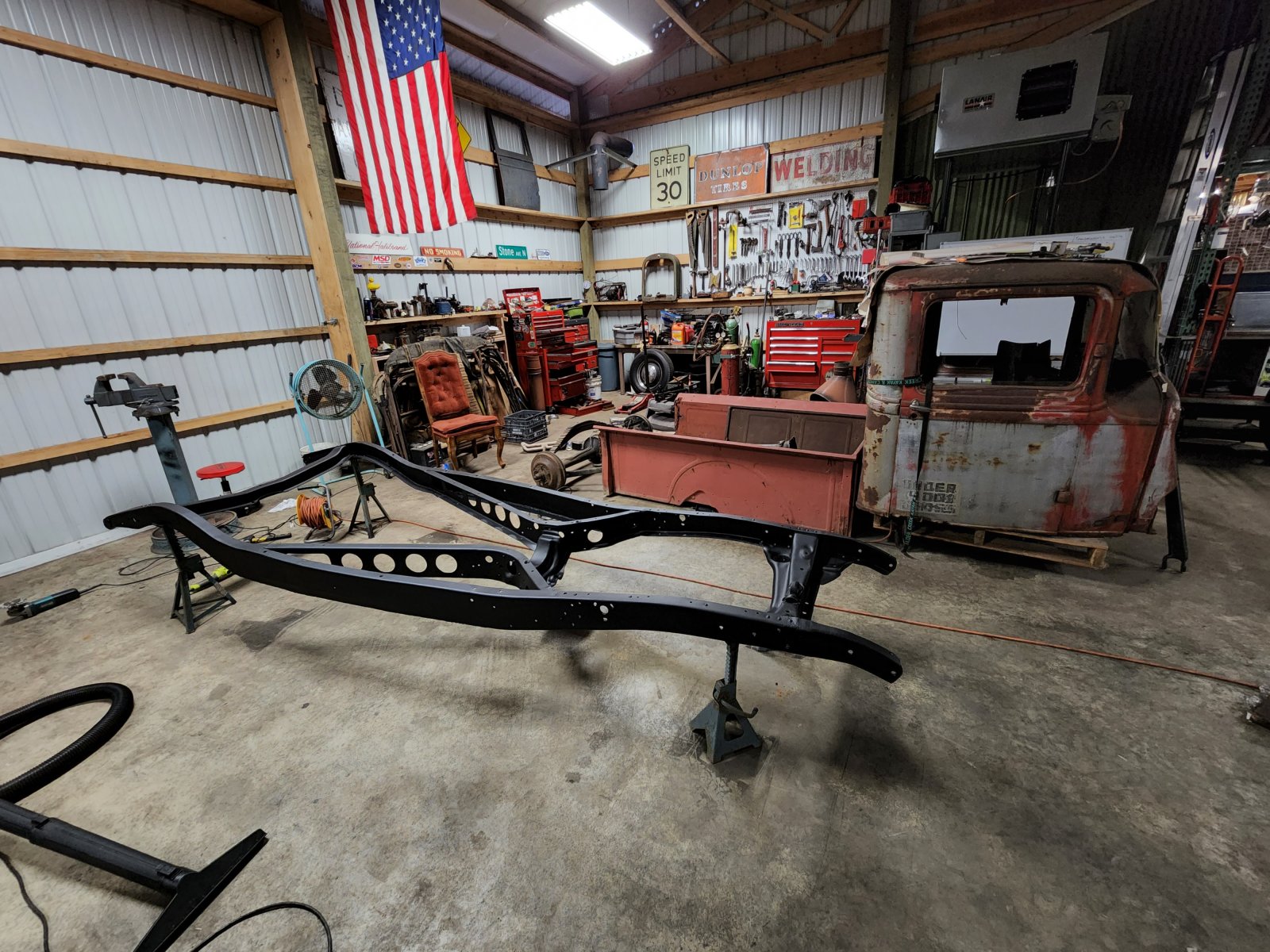

    I just painted the frame this last week.
    I have a nice dropped axle and unsplit wishbone. It's getting a flathead v8 and rebuilt 39 transmission. Juice brakes. Etc....very basic build. Patina is staying.(I know, how dumb am I) It will probably get some fenders.
    I was originally building this as a replacement for my black truck. We'll see how much I like it. I've got enough cool, but lesser model A's and trucks and stuff that I think when I finish them, I could sell off a few and probably get a Henry 32-36 roadster or something of similar value. Not really sure what I'll do. But I like building them as much as I like driving them. So here you guys are. Hope you guys enjoy this thread. I've got some pretty major motivation going since Pat Ganahl passed away. I'm working on everything at once. Lot's going on, but the Fire is lit and we're building steam!

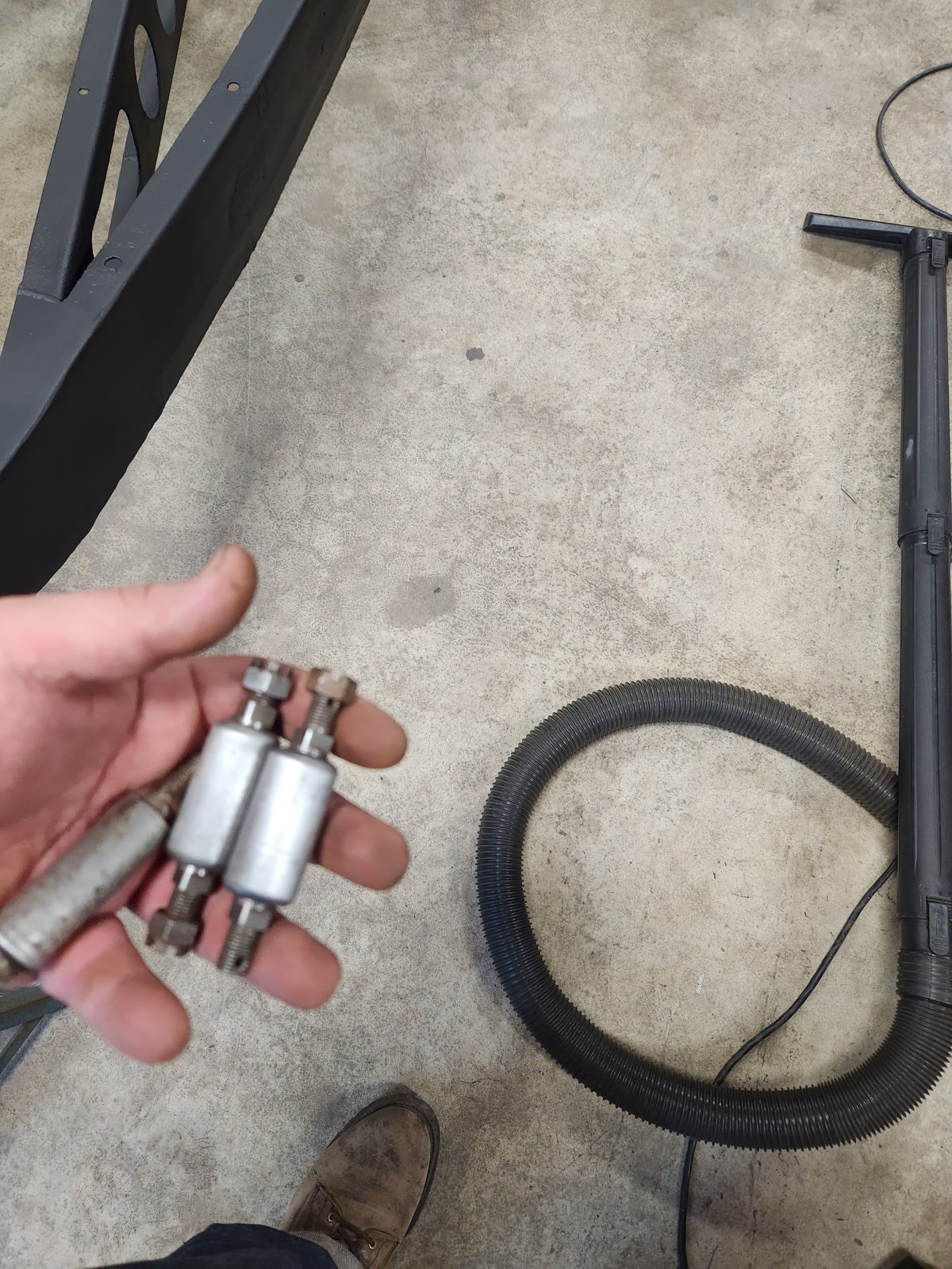

  3. If anyone has any tips for installing 32-34 spring shackle bushings in the perches, I'd love to hear your advice....otherwise I'll start trying to monkey fuck it here this afternoon...

    Did this a long time ago but iirc, this seemed to help: heat the spring and freeze the new bushing. Maybe I’m too late?

    On to the install.
    I was kinda expecting a KR Wilson type tool for this. But the old vice and socket trick did it. I did have a little issue with one not going all the way in, but press made short work of that issue.
    First off, which maybe this is obvious. Don't try to do it like this. You'll push the guts right out...
    Not actually speaking from experience here.
    I did use a off topic 14mm socket and and Taiwan made 3/4 for my press...
    So there we go, 2 perches on a lunch break.

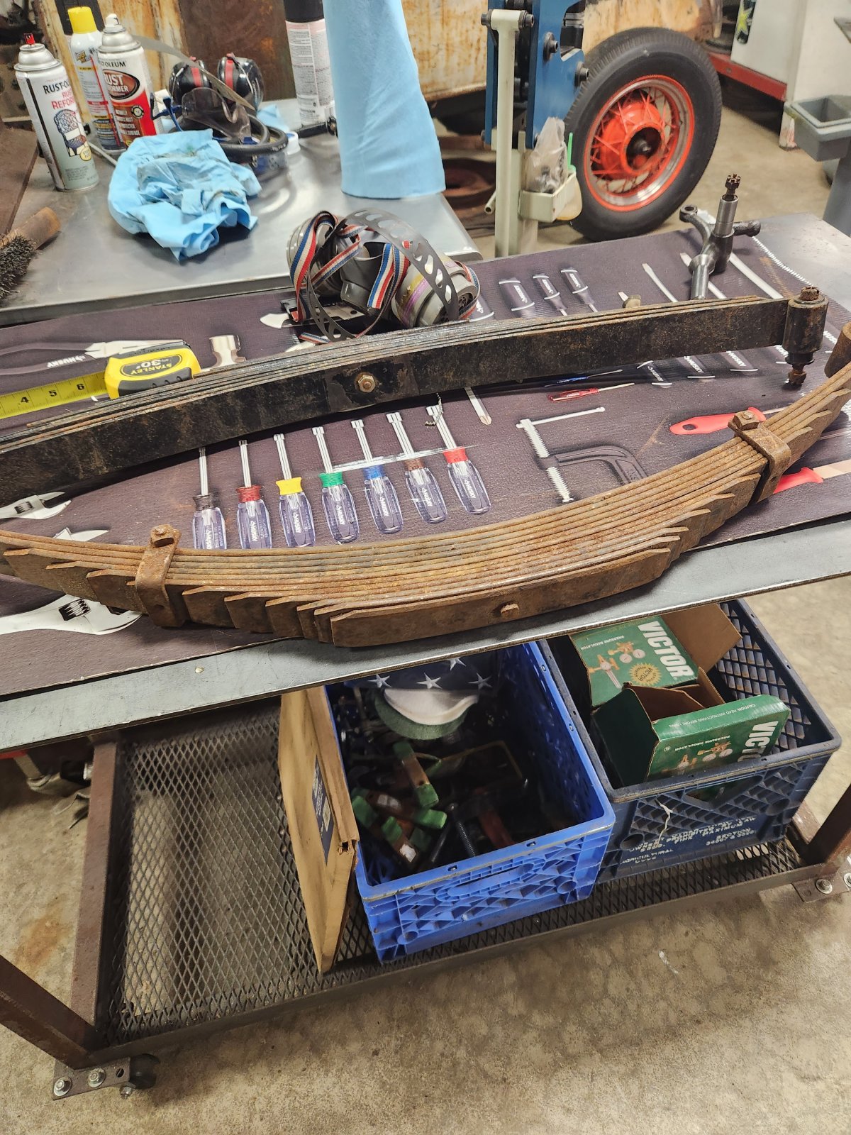

    I also grabbed a couple springs out of my stash....made a damn mess too, as they were on the bottom.
    The black one is the original spring from the chassis but its kinda mangled. So I'm gonna go with the rustier one and clean it up.
