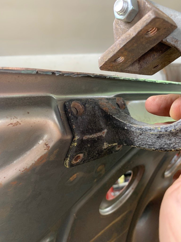

    No holes are drilled, but what goes in the whole once drilled?
    Rivet nuts?
    Caged nuts?
    Drilled and tapped plate?
    What did Henry use?
    Thanks,

    Henry used 5/16 UNF round nuts electrically welded in behind the trunk inner. I think 33/34 and 35/36 hinge parts are the same.

    Weld some plates on the back side and drill/tap them to match the hinge. 5/16 UNF sounds about right.
  4. What MVee33 said.
    Not a good pic, and enlarging didn't help, but I'm thinking that they were like D-nuts. Rivnuts would work well I would think.

    They were D nuts crimped in before the skin went on the outside. You will have to be more creative. 5/16 steel with threaded holes snuck in there some how and spot weld thru a 3rd hole in the center
