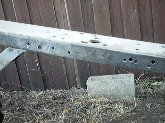

  10. So, I went out and wire wheeled the top of the frame rail and found nothing. What is up with that?

    They could be anywhere along that area -not just directly over the steering mount.
  12. I thought the same thing, so I cleaned from the front crossmember to were the rear kickup starts. I didnt see anything..........
    Anybody have any idea's?

    That looks like the bottom of the frame rail judging by where the steering box holes are
