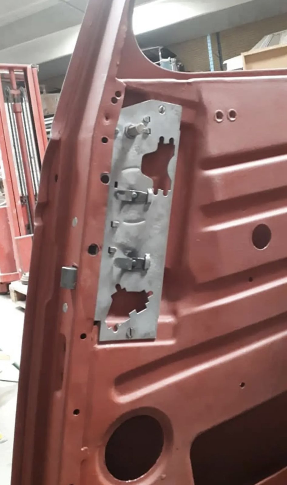

  10. Johnboy34
    Joined: Jul 12, 2011
    Posts: 1,541
    Johnboy34
    from Seattle,Wa
    Original 34 latches look like this. These are the later style, center inside handles. The 33 & early 34 have front mounted inside handles and use different inside door skins.

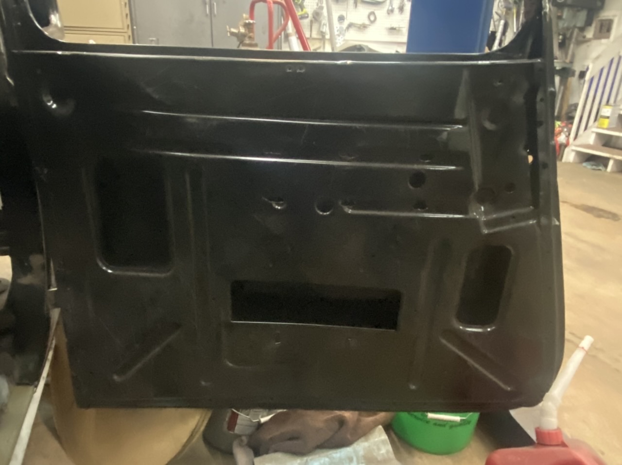

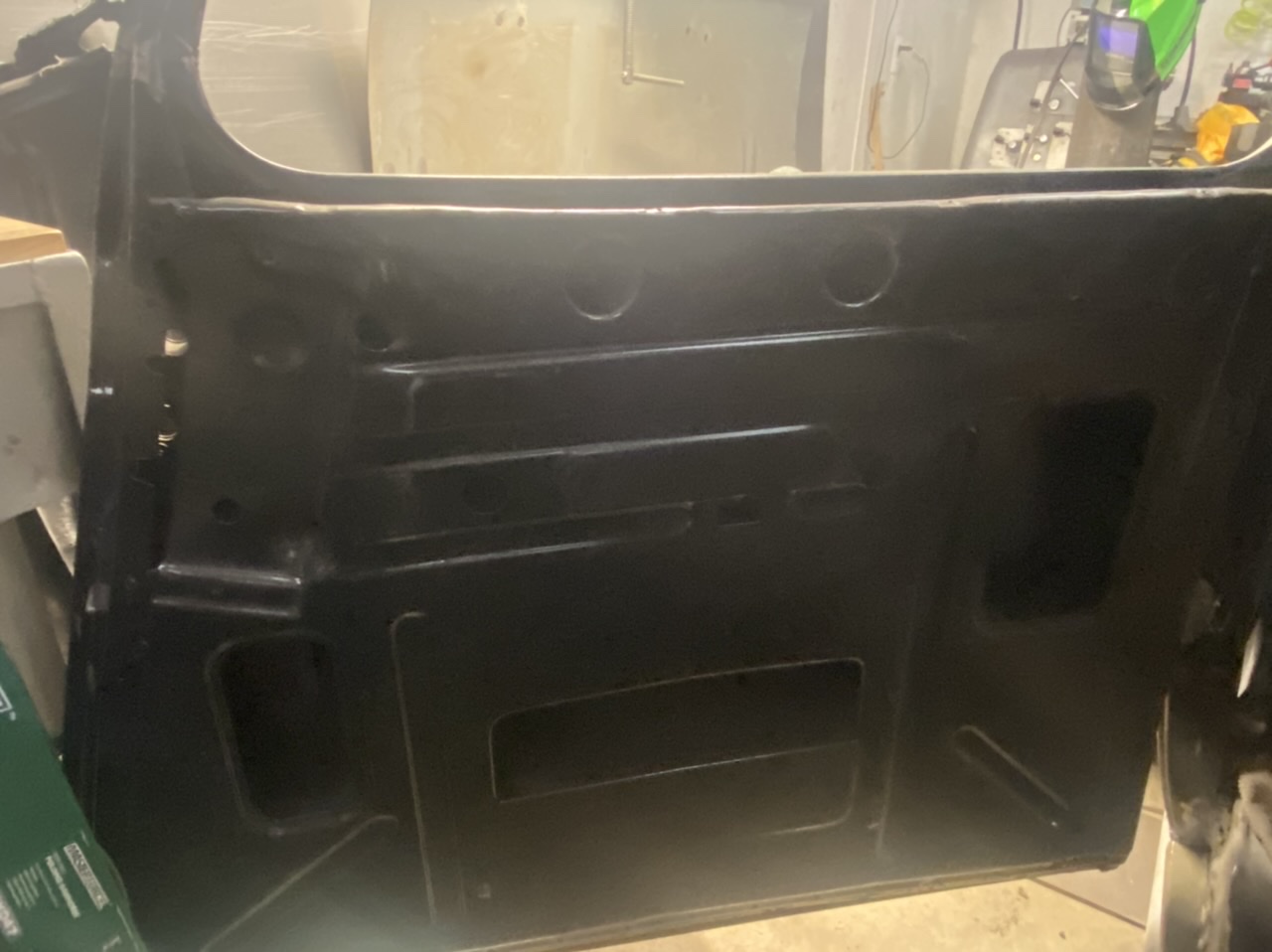

  14. Enemy1
    Joined: Nov 25, 2018
    Posts: 43
    Enemy1
    I know 1 of my doors is a 33 and the other was a 34. The extra steel on the 34 window opening has been removed to match the 33. Sorry for my ignorance but how do I tell if I have the early or late style 34? Can someone post a pic of the interior panel differences? Can I make the later style latches work on early style doors? If so 31aford, yes I would be interested.

    Here is what the late 34 door looks like with the latch installed
  16. Enemy1
    Posts: 43
    Enemy1
    As they say a picture is worth a thousand words. I would guess I have the early 34 door and the 33 door. They look way different than yours. So I would be better off finding the earlier latches or go with bear claws and completely fabricate something.. I was hoping to avoid the fabrication after just re-chopping the top,,,,,,,kind of burned me out. Thanks for your help 31aford. this is why I am on here. If I knew everything I wouldn't be!

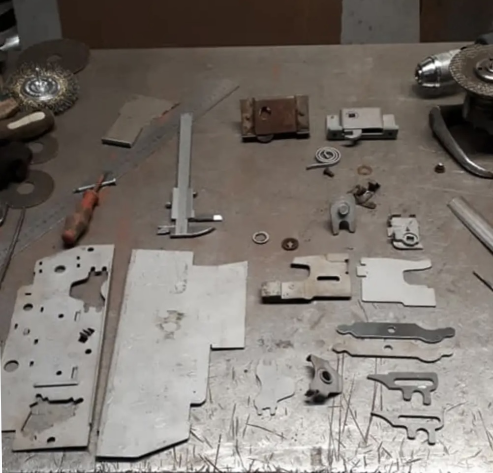

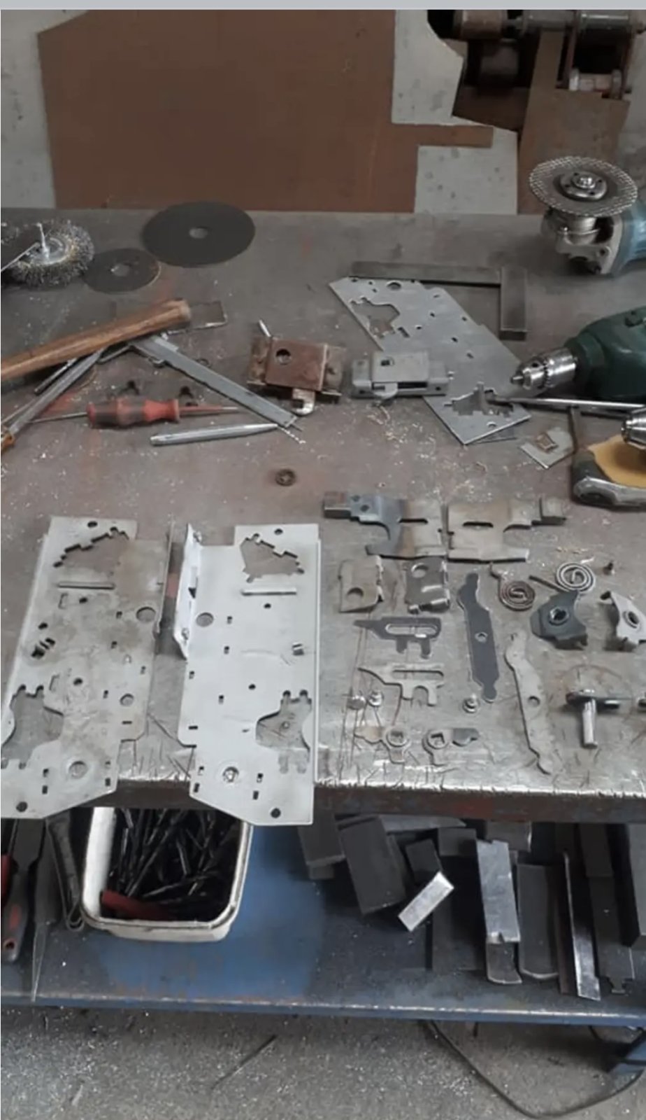

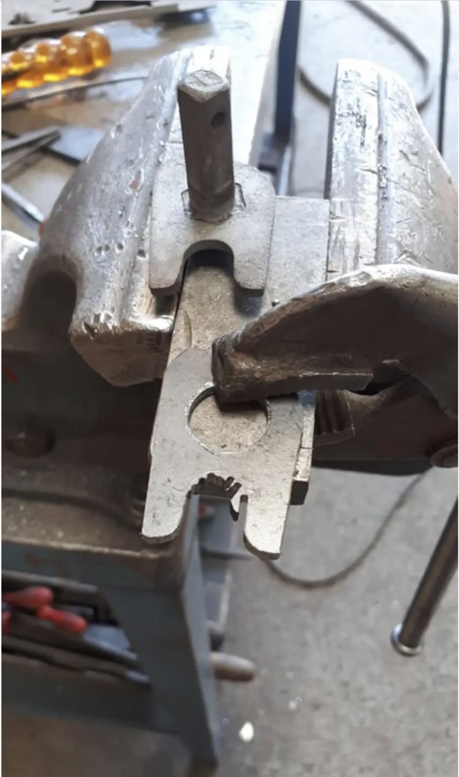

  18. 4ever18
    Joined: Nov 1, 2007
    Posts: 535
    4ever18
    I wish I could recall from where I found these photos and the description of the process, nor do I recall the author. Whom ever he is, he’s quite the resourceful craftsman. He had one latch, which he disassembled and made a mirror image from to create a latch for the other side. If you can locate even a crappy latch, perhaps you do do the same and make a pair of new latches for your car. Hopefully, these photos will help anyone wanting to take on such a project. E7A80442-E61A-464A-A67A-245F5347A9C6.jpeg D50E8388-B4CE-45DA-A769-4E0B2D727792.jpeg AF174AA1-BF4E-488A-96B7-A0A3CD16F92C.jpeg 04C01B1D-20A1-456B-A1A6-3B48FB95CA04.jpeg A5ABE890-3576-405A-8E16-AD36F253A235.jpeg 94DD9A2F-0D3C-4866-BD0B-144D1A9A636C.jpeg
