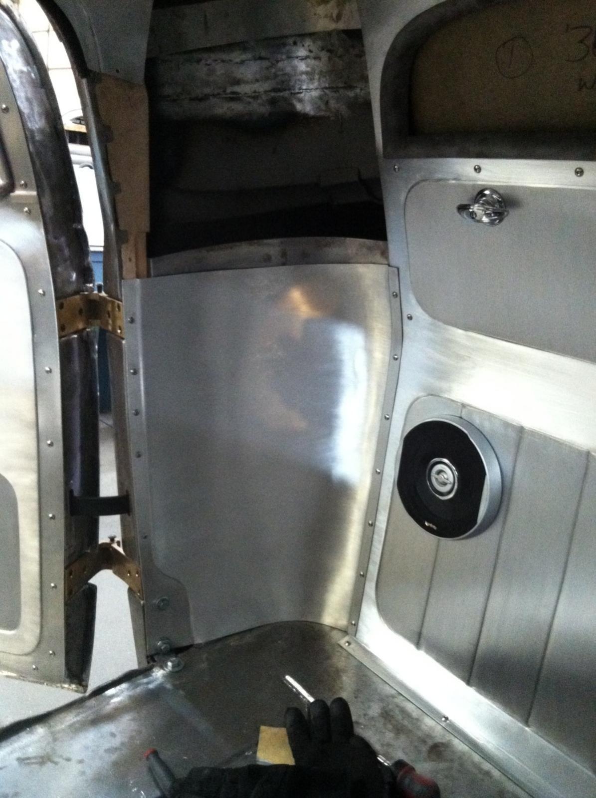

    Thanks. Josh was out on personal parental duty Monday so progress is a day behind. He did get started on the last area of the interior yesterday and sent
    the attached picture. I am really looking forward to this part of the build wrapping up as the side pipes are next!

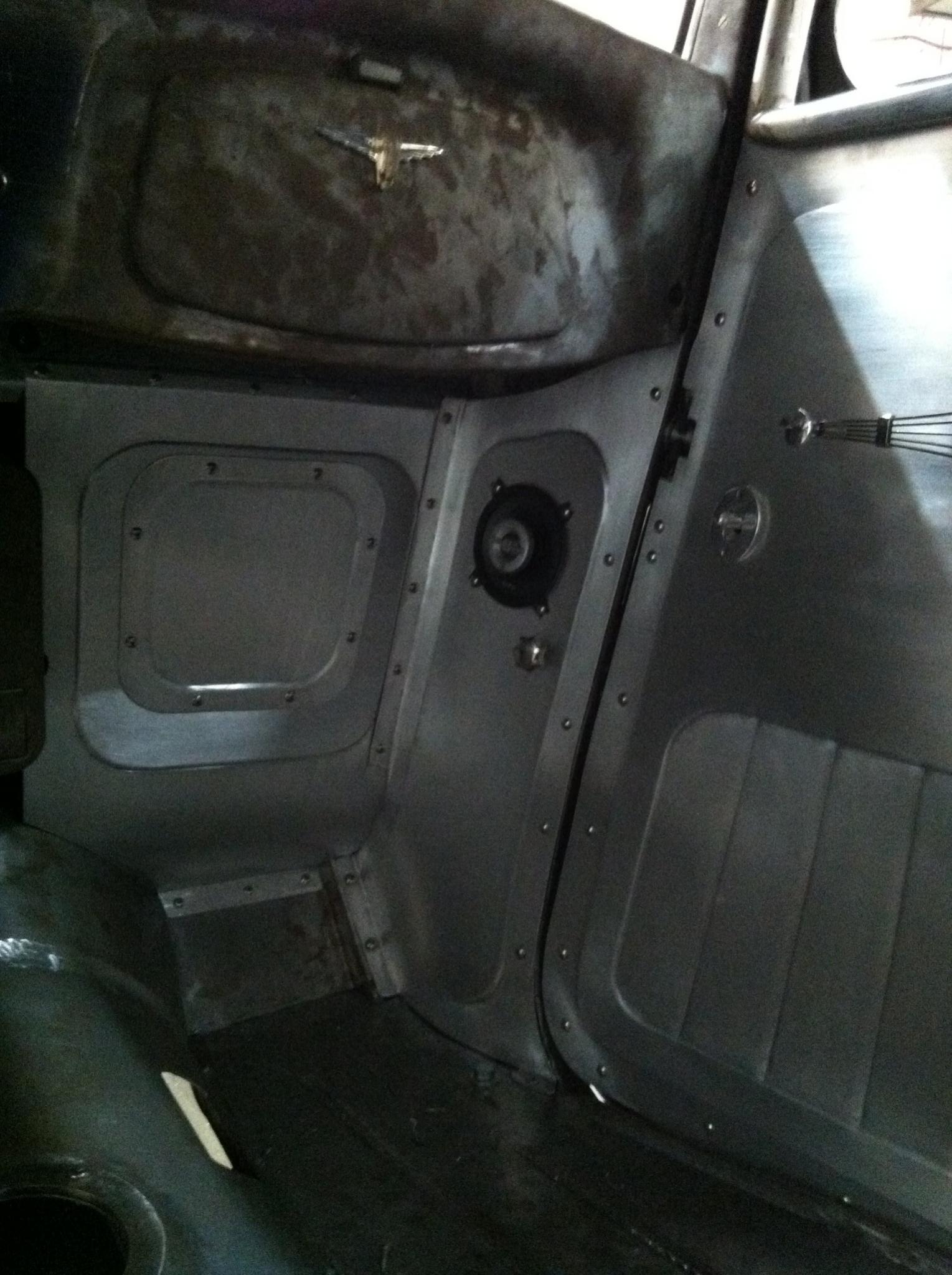

    Josh was able to complete the last of the tough interior pieces today and sent me some great pictures. (see below) I am just thrilled to death with the outcome and it hits the nail right on the head for what was intended.
    THANK YOU JOSH!
    The only areas left to complete are the kick panels with speakers. One of my issues in life is that I am getting more and more hard of hearing. I asked Josh to use a flush mount speaker solution to enable me to change them out easily. Unfortunately , I turn them up and eventually blow them out. The coupe is going to be very loud with the side pipes and the need to be able to swap the speakers out easily is a forgone conclusion.
    regards,
    George

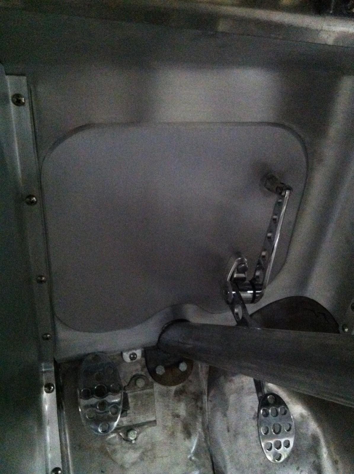

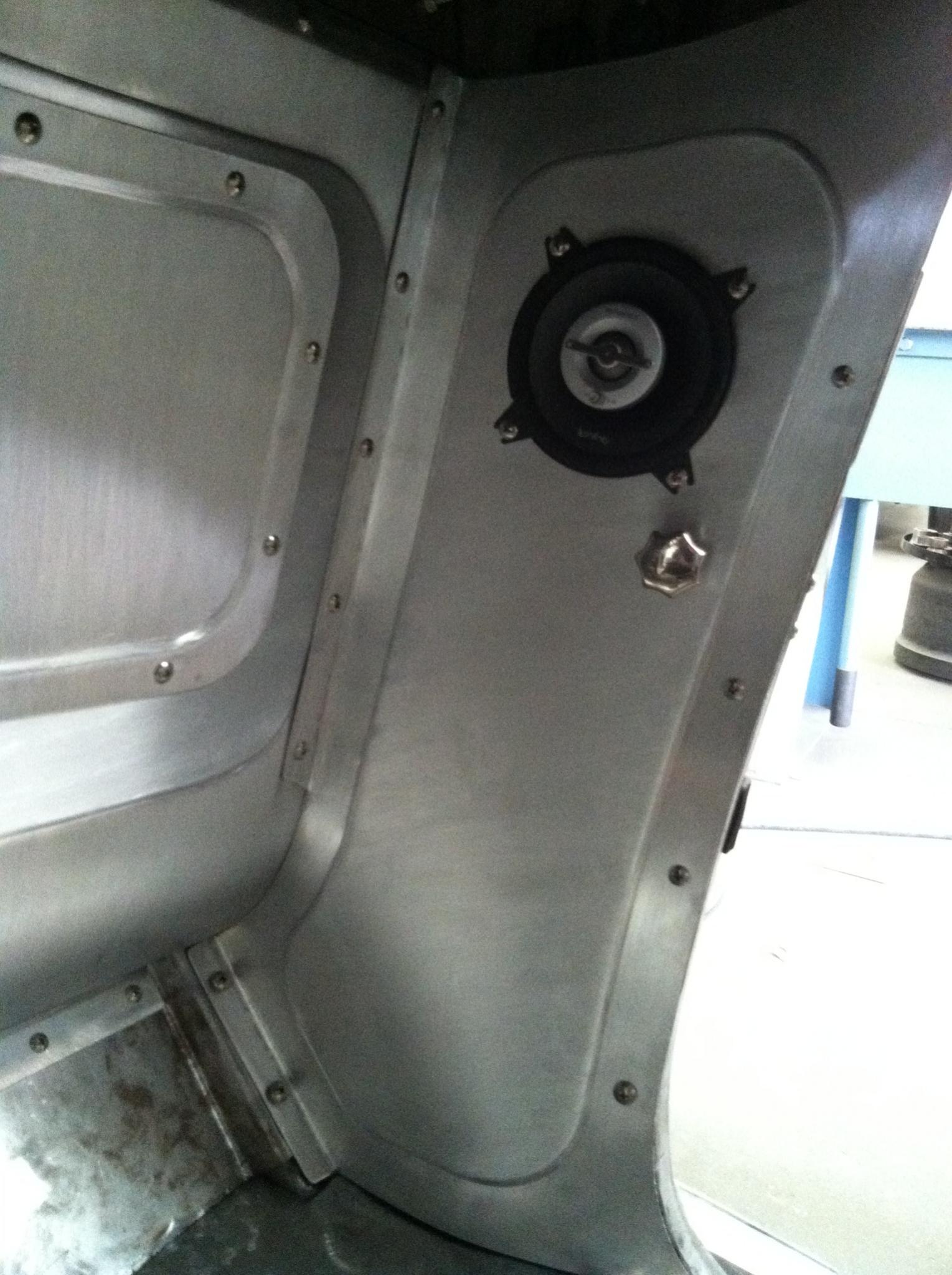

    Here are more update pictures from Josh's effort on Friday. The panel with the access hatch is to get things hidden. SPECIFICALLY,.. Heater hoses and wiring.
    Josh had made a great effort to keep things as clean as possible.
    The knob below the speaker is for the "safety dead bolt". The last we need is for one of the doors to pop open and wrap around to the quarter panel. YIKES!!

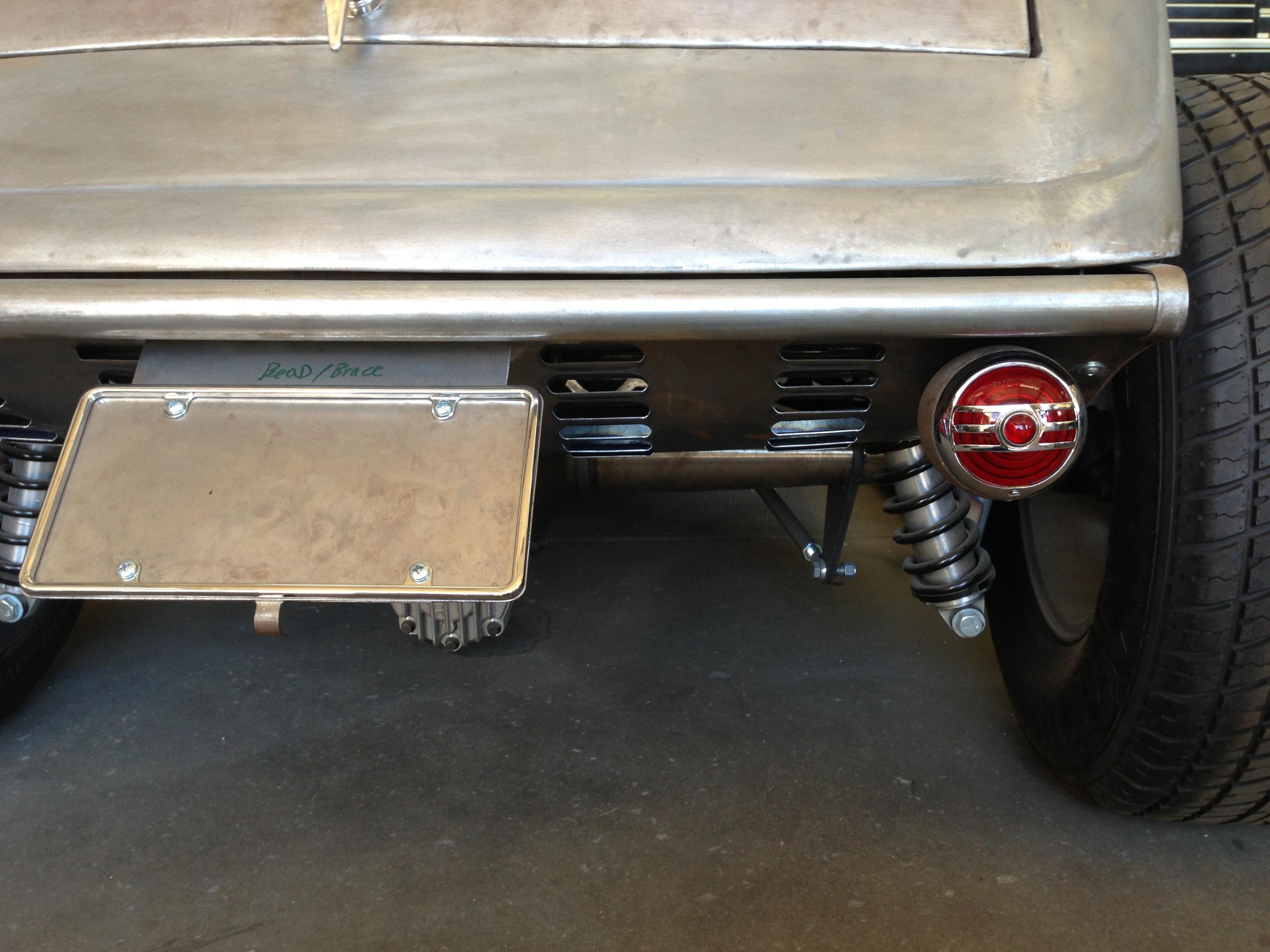

    Another small milestone that took a long time to accomplish...

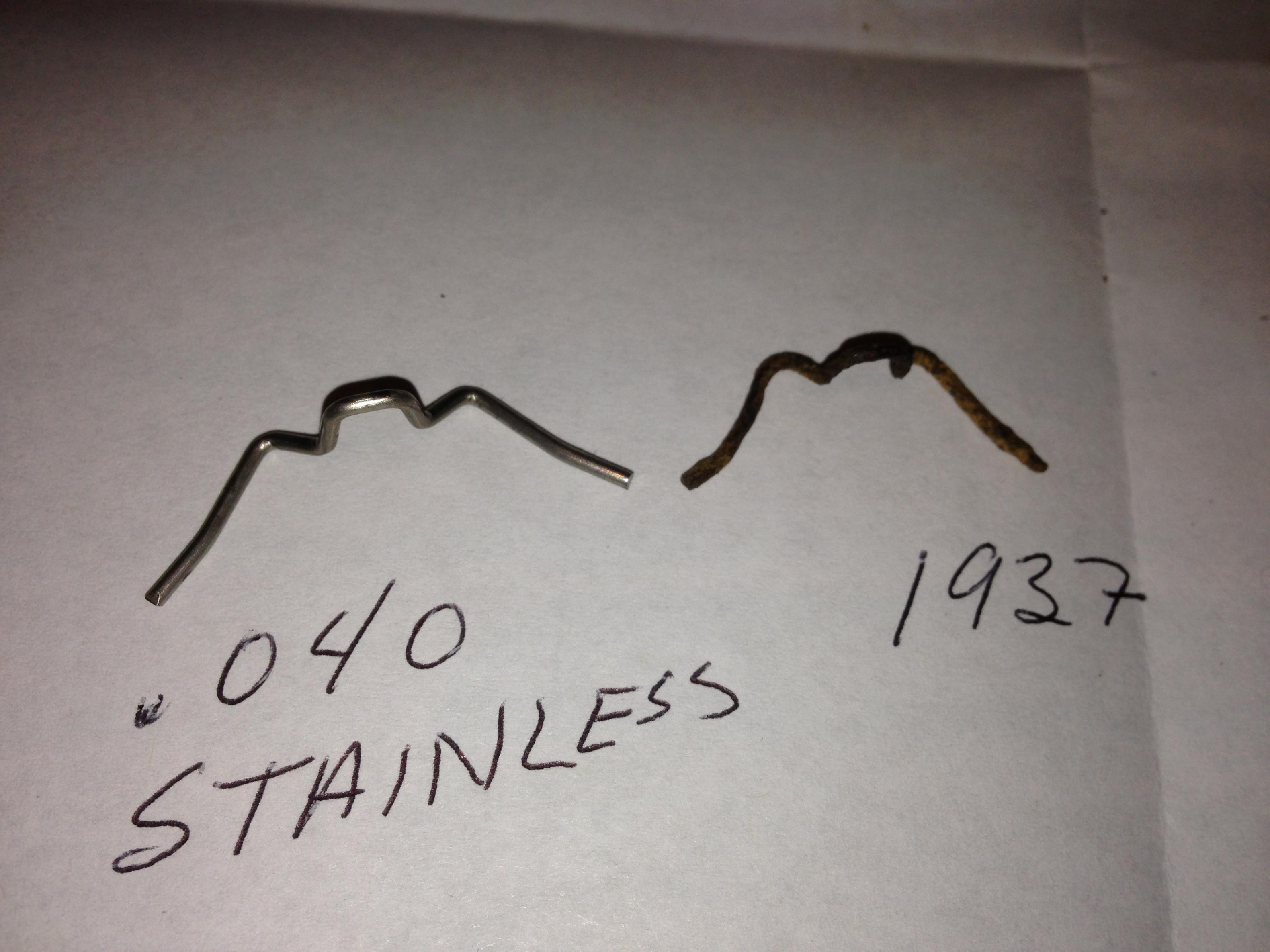

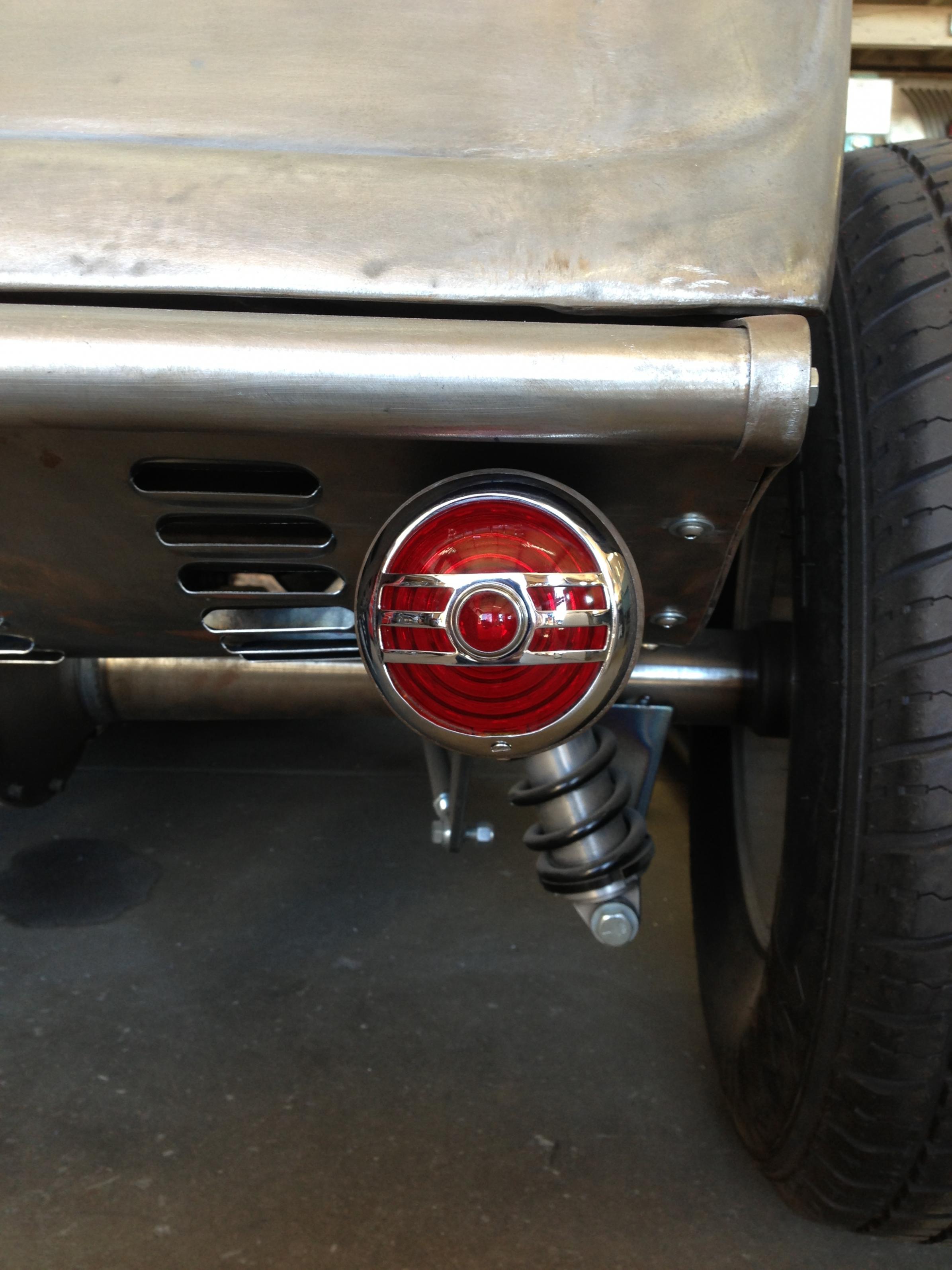

    Please see the attached pictures of the 1937-38 Chrysler/Desoto Tail Light Lens retention springs that I had re-manufactured from an original sample part instead of having to glue the lenses in.
    You might remember that the original ones were rusty and would break when I was trying to reinstall them.
    I am very happy with the outcome and have put one lens together in the picture to show where they go.

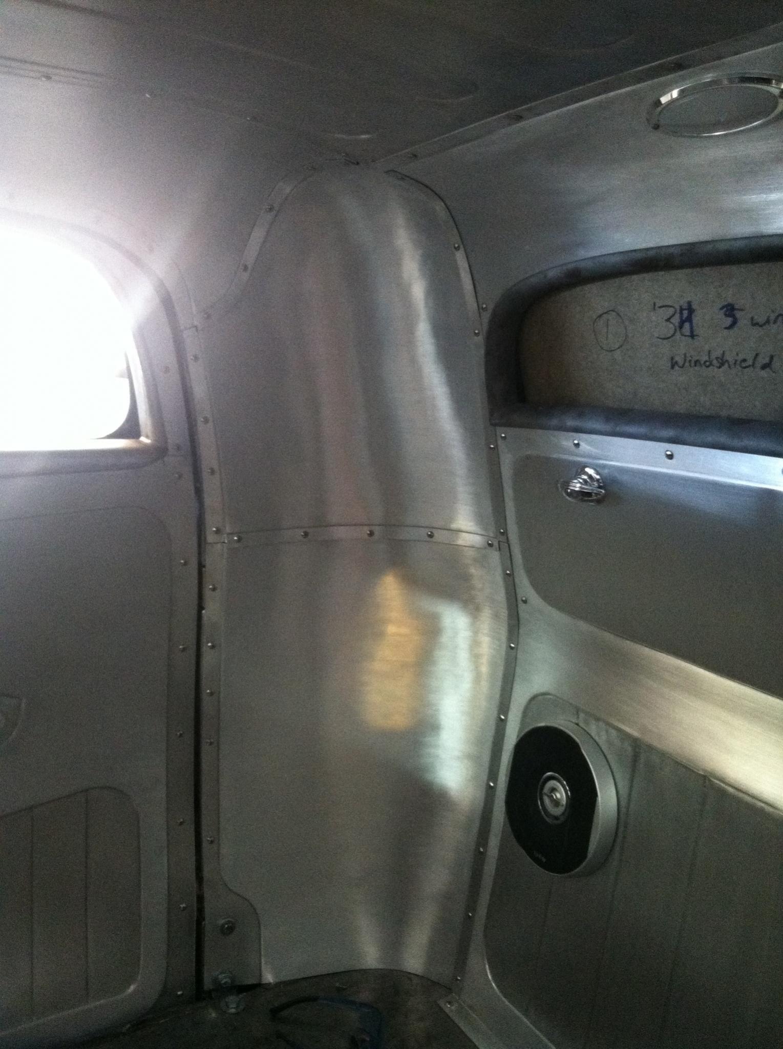

    Great news from Josh in Loveland! The Interior Panels are 100% complete. It took a little extra time on the panel with the gas pedal as Josh had to run the pedal linkage and get it worked out with the Fuel Injection throttle shafts. This had to be completed to enable the location of the hole through the firewall.
    I sent a note to Josh that said..."MAY I HAVE AN AMEN?" I can not began to express how exhilarating it is for me to see this progress.

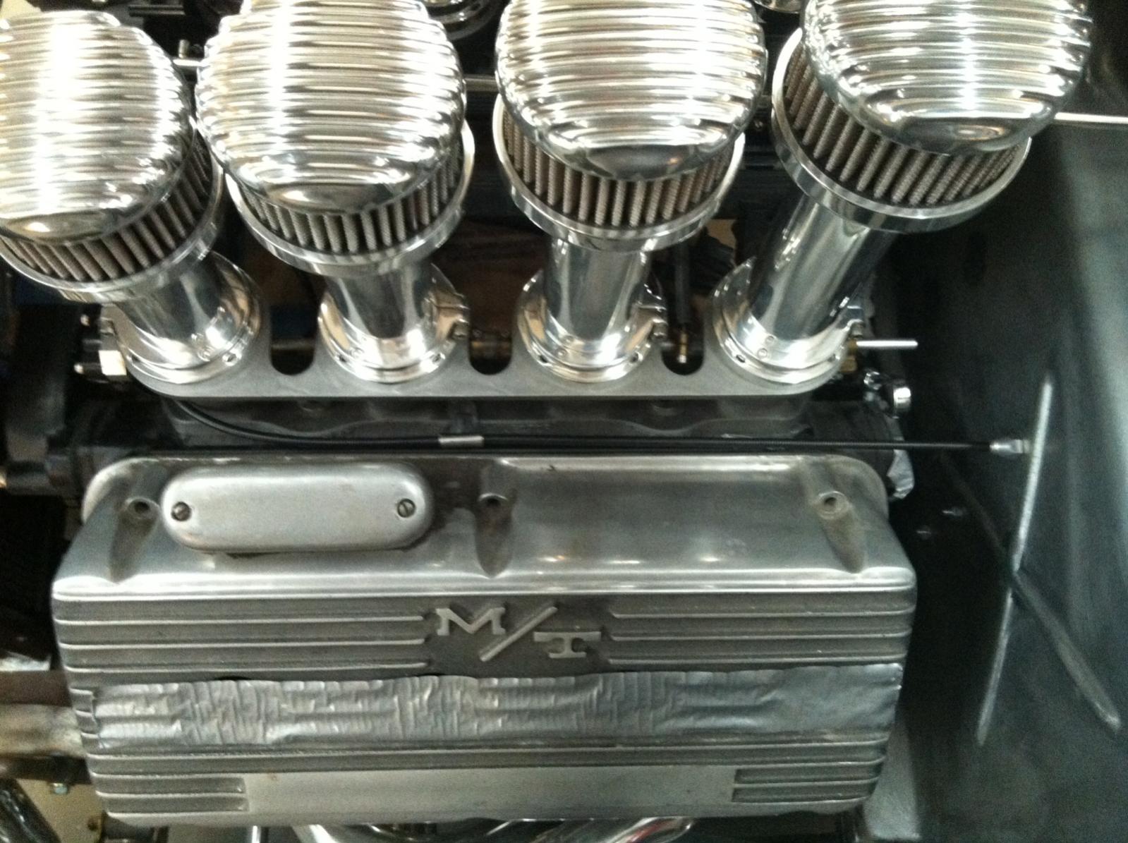

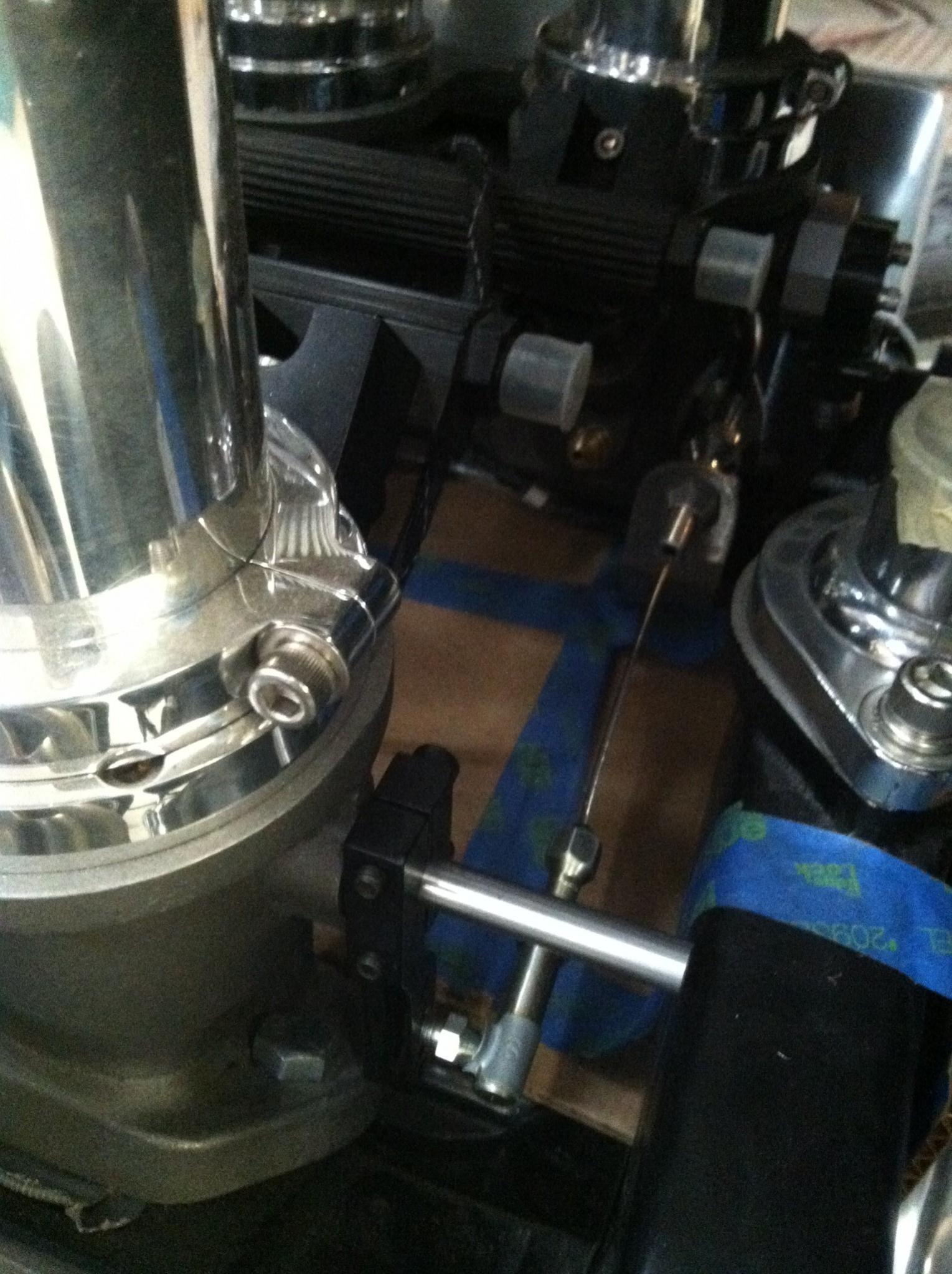

    Here are a few pics to show the throttle cable runs the full length of the intake (first picture) before making a 90 degree turn, then clamped before attaching to the throttle shaft on the opposite bank (second picture) via a throttle arm with ball.
    Although a little harder to see, the third picture is a clamped "TV" cable that is actuated by a lever that is pulled when the throttle cable is pulled.
    The trick will be to adjust and get a good ratio. I don't remember off hand, but believe it is over 2.1 to 1.?????? The key will be to get it adjusted correctly in order to have the tranny perform properly and not burn itself up!

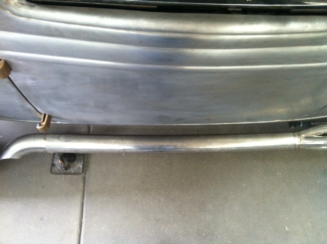

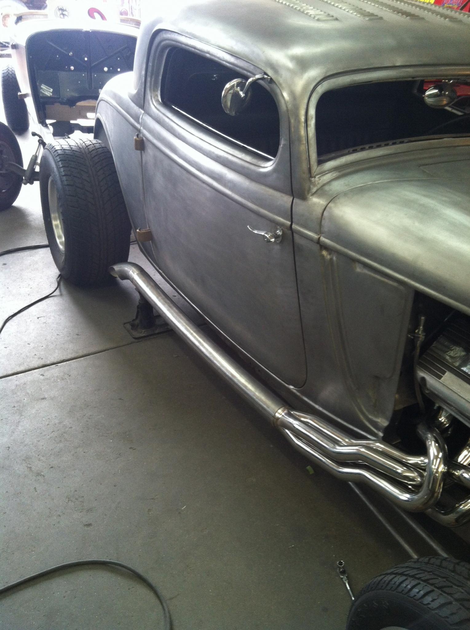

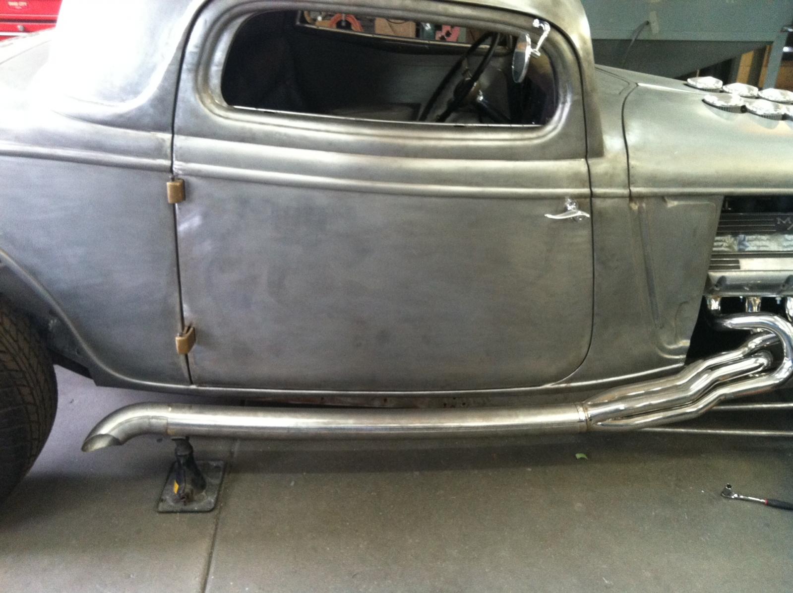

    One of the last fabrication items for the build is to complete the side pipes. Please find the view of the side pipe parts laying ready for a Monday morning start.

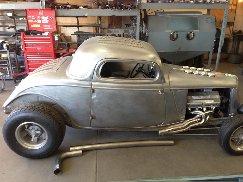

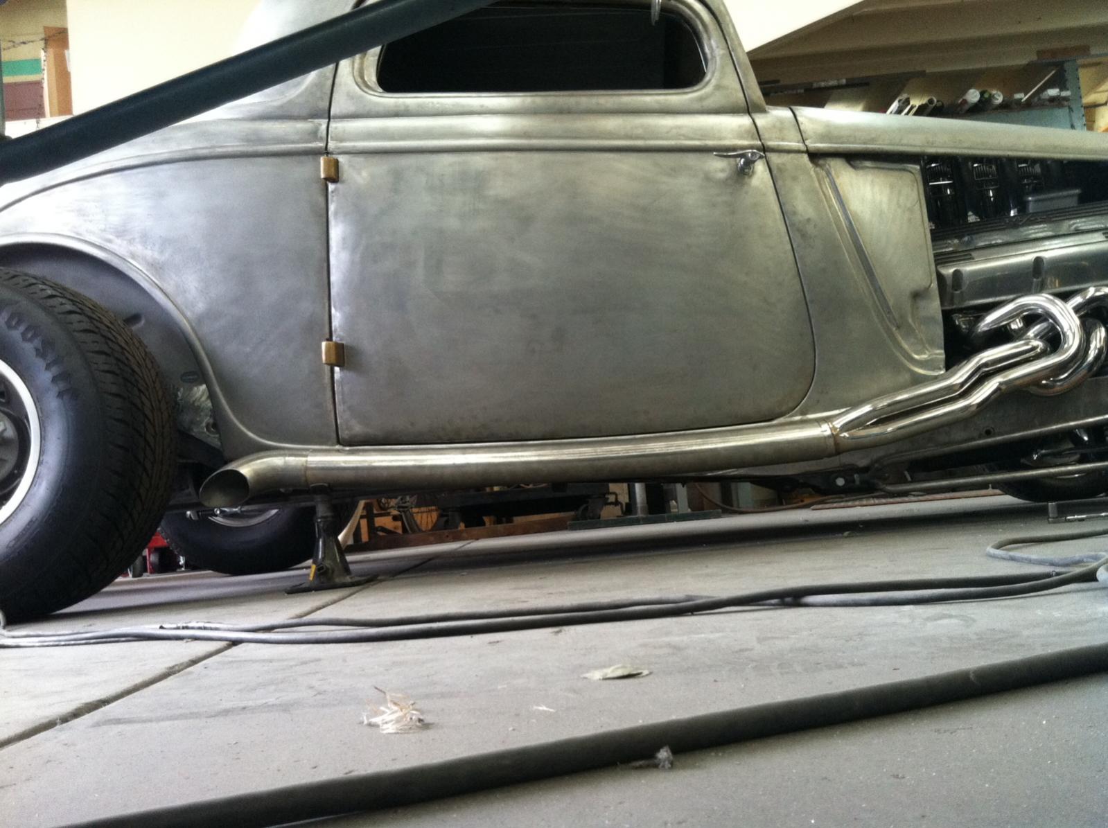

    It took a big effort for Josh to shrink the collector to allow the side pipe to just fit/slide over it for a good seal. The turn out is a trial and error effort from Josh and is much better than a straight cut.
    Please take the time to look at all the pictures closely as there are 2 curves that had to match to get this right. 1.The arc of the lower body ... check! and 2. The arc from front to back with the curve into the quarter panel...double check!!
    This has been a major focus to get right. From figuring out the 340 plus foot radius using snow board detail from Dustin to managing the collector size and output direction to achieve not only the fit displayed below, but to get the scale right.

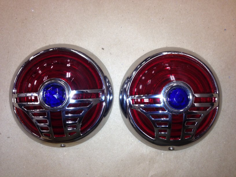

    Here is a set of 1937/38 Desoto Bezels that I had re chromed before installing a pair of good used lenses with my new springs.
    I really like these Desoto's as they are a little more Art Deco than the Chrysler's.
