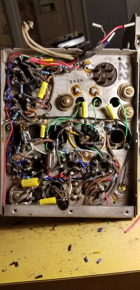

    This is where I began with it. Sat on the bench, vacuuming years of dead things and dust out of it.
    Stripped it all down and cleaned it all up. Overall in really very good shape for having been sat in a Missouri barn for nearly 50 years.
    Worked on a few of the little details, like tidying up chewed-up screw heads and giving them a nice shiny coat of nickel.
    Started replacing all the old components- most of which were no good or borderline. All new parts should see it work reliably again for another 20-30 years certainly.

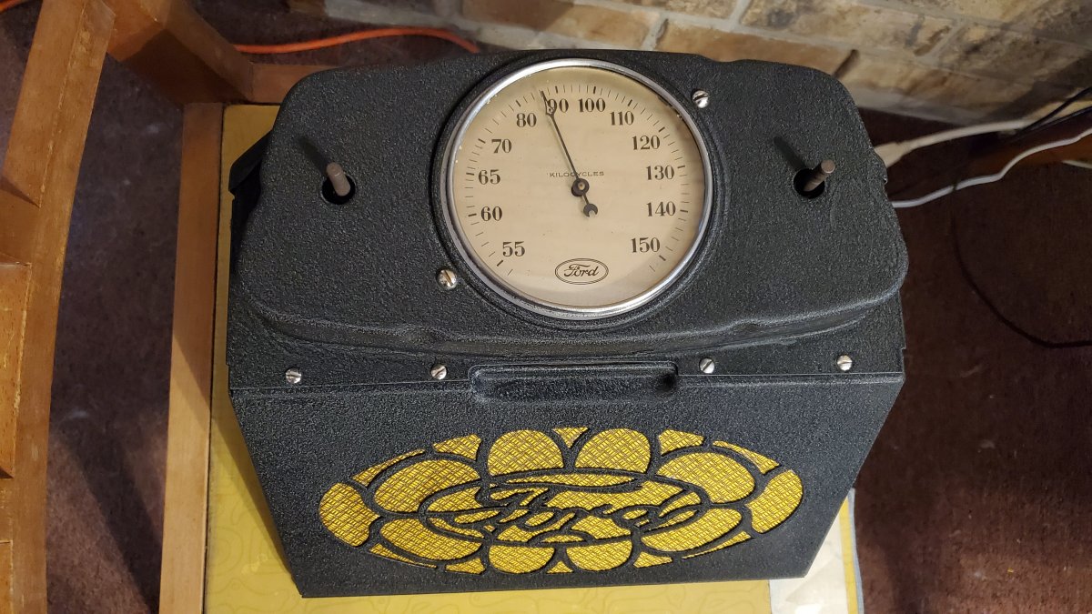

    Very nearly completed the rewire, got it all aligned and picking up radio stations, running happily on the bench for hours.

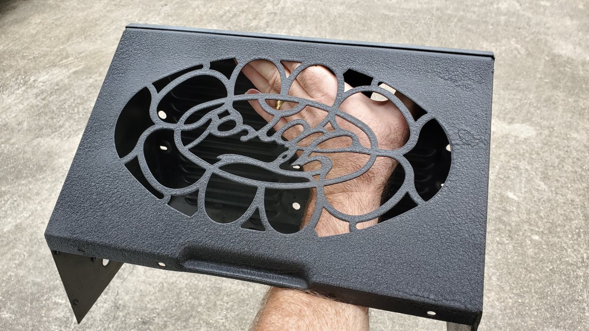

    Tried my hand at a bit of bodywork. Cleaned up and painted the sheet metal of the case.
    Polished the dial bezel, cleaned the glass and tried the front on for size. Looks good. Will look better with new knobs (on the way, the originals are long gone).
    Lucked out and found a place in Louisiana (of all places) that is remanufacturing the exact grill cloth. You can see the scrap that came off- that was the best bit, hidden inside! The new cloth is beautiful and should look really good.
    Up to date to tonight, that's the third go around painting the case. Wrinkle paint, the original finish, is a pig to get right.
    Worth it though.

    There we go. The wrinkles will pull out as it dries.
    I think that looks real good.

    Ended up redoing the grille cloth. Looks good now.
    Very rusty lid clip cleaned up, polished and nickel plated. Reattached to the case and it holds the top on again.
    Phil

    Worked the top side of the chassis tonight and replaced the crispy old wire with new yellow cotton (as it was originally) covered wire, so it looks a bit more correct when the lid is popped off to access the tubes.
    Added aux-in and isolated it from the rest of the chassis in case a tube goes short, won't take the iPod or whatever with it.
