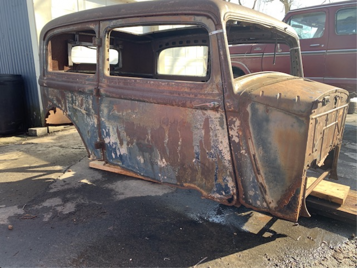

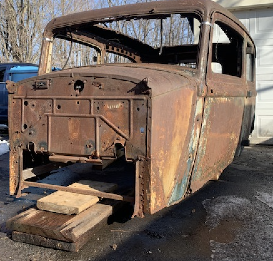

    Hello HAMBers,

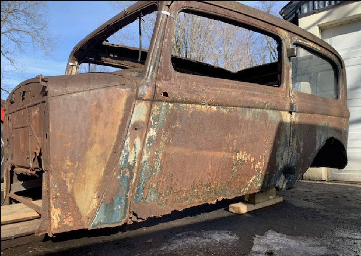

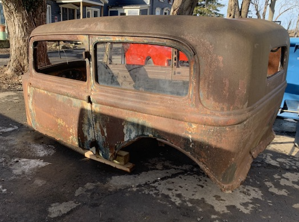

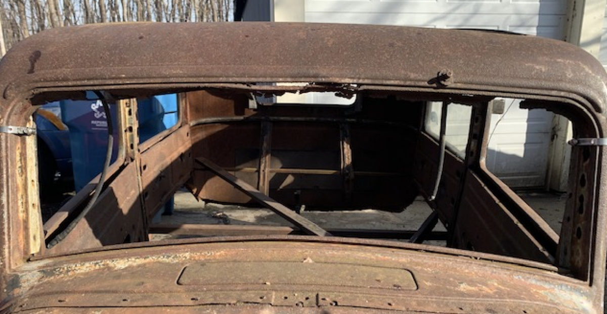

    I am finally getting around to sorting out HOW i am going to get a hot rod together after all these years and have been saving this 33 Plymouth Sedan. This car is ROUGH and most replacement panels for the early mopars are not available. I've considered morphing the car with Ford replacement panels from the same years, but i am not sure. I have been building and fabricating for 13 years and I want real world perspective on best way to accomplish repairing this one.
    It needs:
    Floors
    Rockers
    Door bottoms
    Cowl Patches
    Front window channel
    Plans are for it to be fenderless. Doesn't need to be anywhere near "show quality".
    Screen Shot 2020-02-08 at 7.36.48 PM.png Screen Shot 2020-02-08 at 7.36.55 PM.png Screen Shot 2020-02-08 at 7.37.06 PM.png Screen Shot 2020-02-08 at 7.37.18 PM.png Screen Shot 2020-02-08 at 7.37.25 PM.png

    I've seen a lot worse. I'd tackle it, if it were mine.

    I would fab all of the needed panels for that, if it were mine. It will take a lot of work, no doubt, but that is what I would do. There is some good info to be found on here, and elsewhere, on shaping panels and repairing door frames, it can be done. One bite at a time, and you may spit some of those bites out and start over, but it can be done.

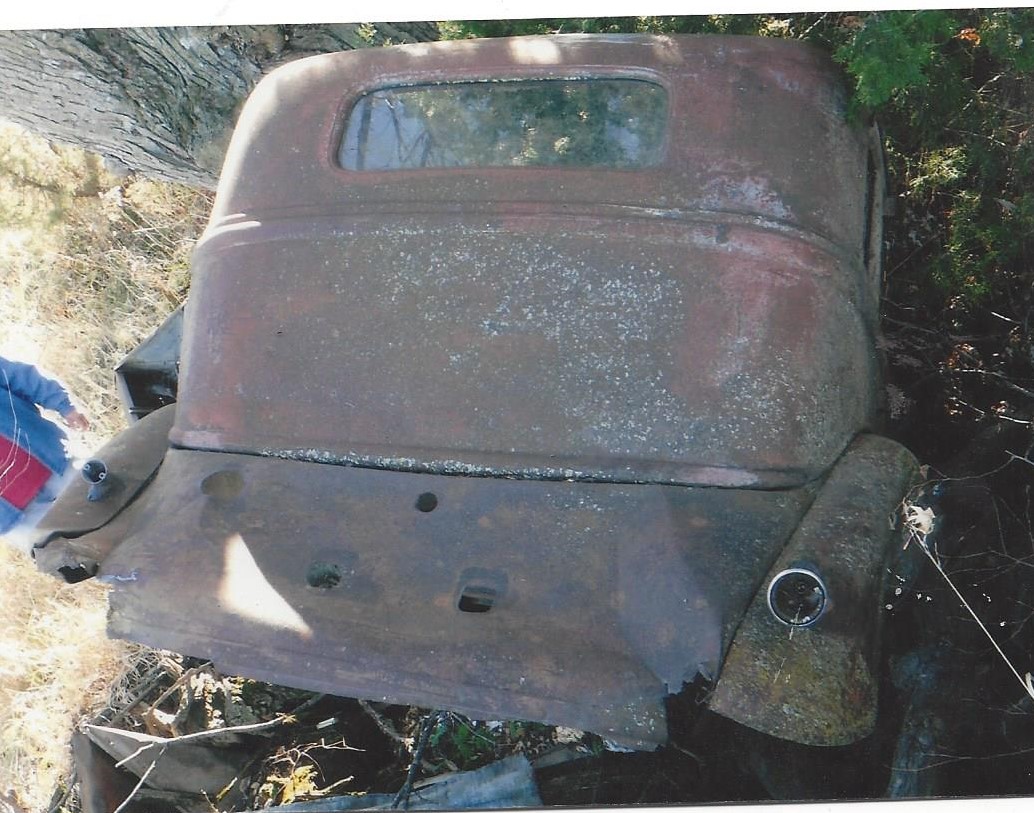

    do it... the mopar floors will be relatively flat, compared with '33-'34 fords...
    a competent metal brake guy should make the rockers and sills...
    a little shrinking should put the desired L -R bow in them...
    find a clever guy with a bead roller and an English wheel to make the patch panels... compound curved with flat beads across the bottom...
    maybe bent conduit arch to form an edge from the skin to the wheelwell … not correct radius but doable at home... don't be afraid... most of us have cut out what we have done and started over... a few times...

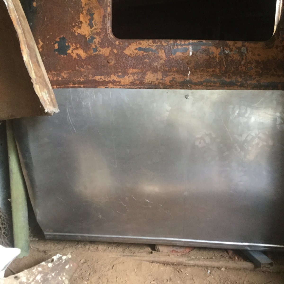

    It looks pretty straight foreword. It all comes down to the patterns you make. Get some magnets and craft sheet sized cardboard, place the cardboard over the damaged areas fasten with magnets and cut out to the desired shape. Place the patterns over the sheet metal and cut out oversize.
    This is what I made up recently. 0236675E-81EB-484C-9F38-81B8E39E11CD.jpeg A5FA262E-C1D1-4EBF-B2AD-1B10BC0F6631.jpeg

  12. Worth saving for sure.....they are really cool cars. But then I'm biased.
    It's easy for us to say"fix/build it", it would be a huge amount of work/$$ for sure.

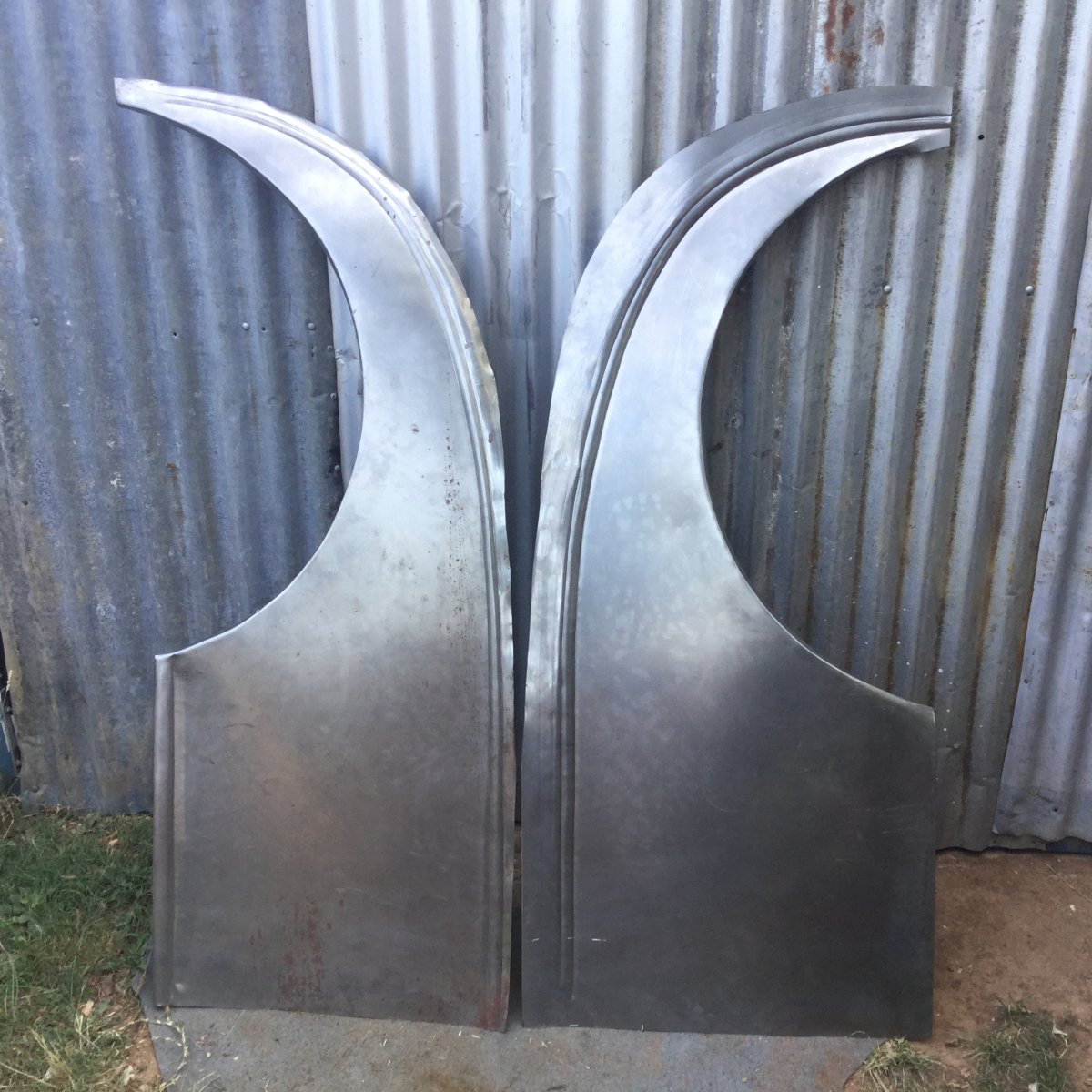

    Since it has no floors, it's a great time to channel it a bit!:D I made patch panels for both sides on mine, but it wasn't quite as far gone as yours.

    I suppose your vision of the finished product will have a huge bearing on how you build the car. If it needs to be perfect, or close to it, you need to find someone that can create the new panels the body needs, anything less then a perfect replacement part won't do, and you certainly wouldn't want to use Ford parts on your Mopar. If you are looking for an imperfect fun to drive hot rod you built yourself, most of the panels you need can be made at home if your willing to learn how. Personally, I make my own panels, but I'm OK with imperfections. Gene

    I would use ford patches , the bottom of these Body's look like they were ground off .
    When built as a high boy or channeled
    Had a 34 dodge PU , and ultimately that is why I sold it .
