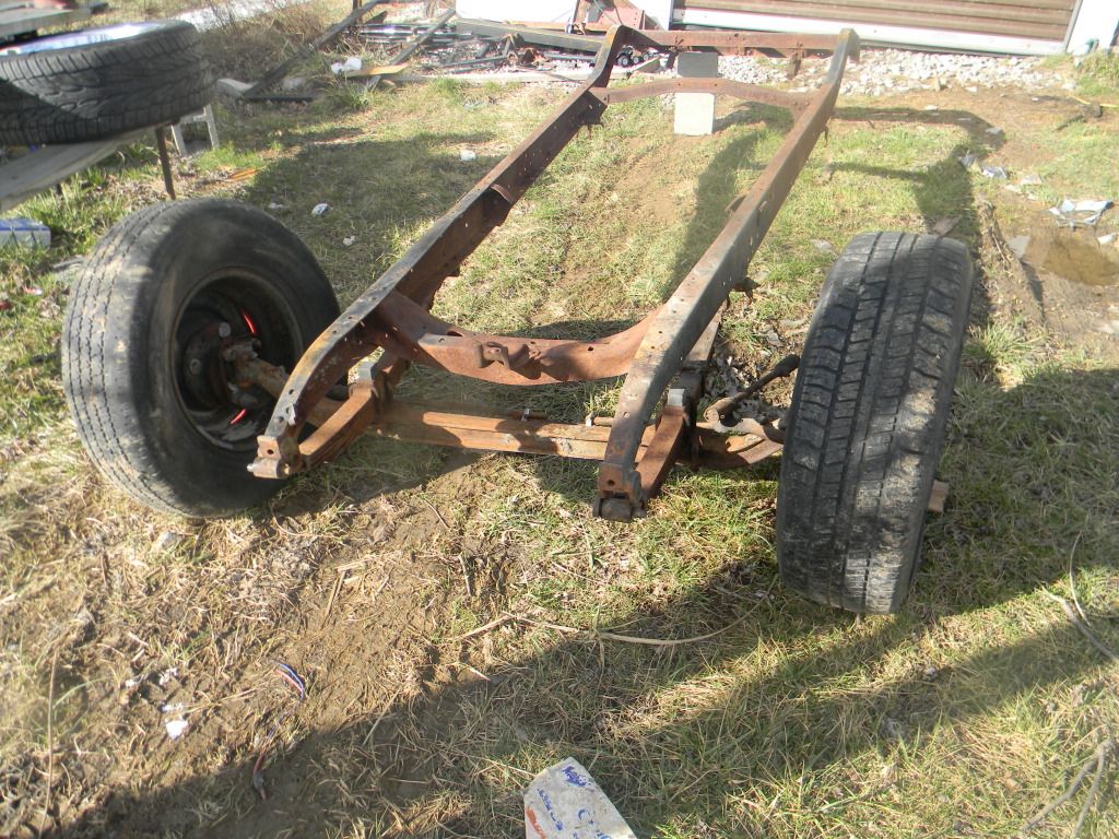

    not much to see yet. got the frame out of the stash o parts and a 53 chevy truck front end. the base of the build.
    the engine build is going on at another thread. i thought it be best to keep the engine by itself until completed.
    the frame is a 1929 chevy from what im told.

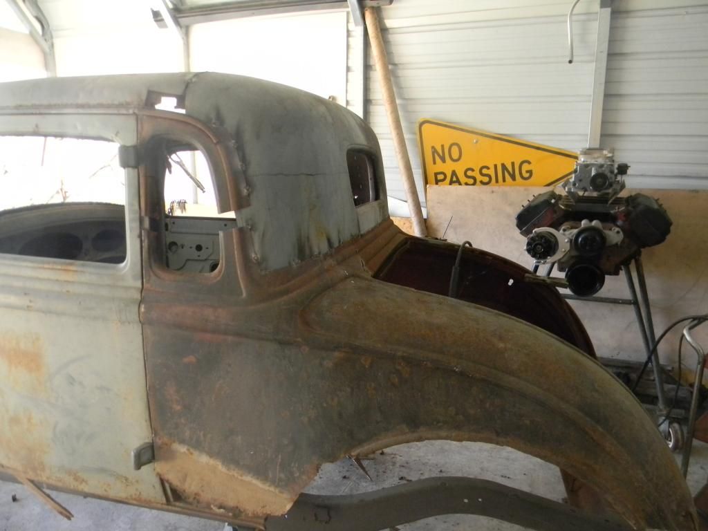

    here is the pictures of what yall been waiting for....atleast part of them....hahahha
    the front half of the car is from a 33plymouth 4dr. SOLID and hard to come by in kentucky or any state east of the mississippi. heck even the original subfloor is still attached.
    the rear half i still have in the enclosed trailer. will be getting it out and laid on the back half here in the next couple days.
  10. shtterbug8
    Joined: Jul 31, 2011
    Posts: 512
    shtterbug8
    interesting....my coupe rear half is shorter in height from the body line up to rain gutter. looks like im going have to chop the front half or make the rear half taller. :confused: i guess the person who told me the two halfs were the same was wrong. ohwell. where is that damn zawsaw:D

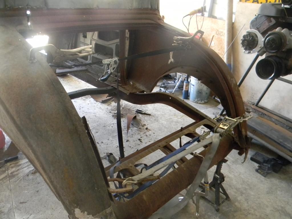

    rear quarters and trunk will be mopar sheetmetal. no lisense plates here.
    the 29 chevy frame is being used because it was really solid, cheap, and similar to what a 33plymouth would be. buggy springs front and rear. the 53 chevy truck front end is because once again buggy style front suspension. also 53chevy truck aftermarket scene is huge. 33 plymouth parts are not. i just installed the disc brake kit for safety reasons.
    here is the progress ive made today. passanger quarter panel tacked on. measuring up the differences....1.5" total in height. not bad. once its stretched out no one will ever know.

    got a little more done today. im only working about 1.5 to 2 hrs at a time during the week because i work 10hr day are work and commute 2 hrs to work. so i dont get much free time any more like i used to.
    drivers side tacked up and the rear window replacement clamped up. looking good to me. the rear window is a little higher than stock....inch and half to be exact. lol.
    the rear half is off the donor 4dr.
    remember guys....just trying to get everything fitted up. original tin is hard to come by nowadays.
    the trunk opening near the window im measuring 38 inches wide. this is a measurement i made before the two rear quarters were seperated. i need to know the measurement nearest to the taillight panel or gas tank. not sure if the opening stays the same or widens. so if anyone has a coupe out there can you please bust out a tape measure for me? thnks.

    did some more work today... grabbed some rachet straps and did a crap load of measuring. welded some braces in....then attached the lower tail panel. its not the best thing in the world to work with but its a good pattern. rusty rusty rusty. damn. tail panel.
