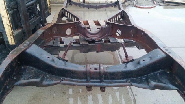

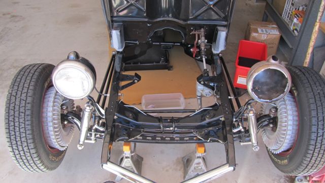

  3. Pewsplace
    Joined: Feb 10, 2007
    Posts: 2,795
    Pewsplace
    Here you go! All rivets are round heads. These are stock frames with original rivets.

  5. Where the inner X meets the side rails, on the top of the rail, the back 4 rivets are countersunk flat heads, and on the front 4, the rear one is countersunk flat head , front one is round head.
    At least they were and are again on my '33 pickup frame, and were on a '33 passenger frame I had.

  7. Not sure I totally understand your question, so i'll answer both I think it may be.
    The 6 ones that are on the top rail, that have a countersunk top, joining the X have round heads on the underside.
    The rivets in the bottom rail are round head on both ends of them.
    The transmission saddle uses 1/4" round heads.
    I bought all my NOS Ford rivets from Roy Nacewicz
