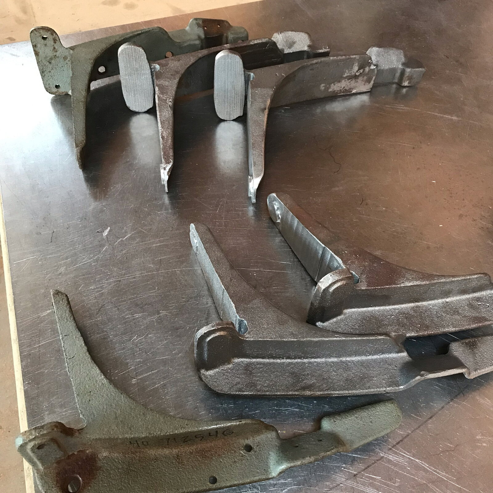

  27. Elvis100
    Joined: May 21, 2016
    Posts: 675
    Elvis100
    Fit check the second one
  28. Elvis100
    Posts: 675
    Elvis100
    Just a quick post, if you are building a roadster from a pile of parts or converting a phaeton. These will be available soon

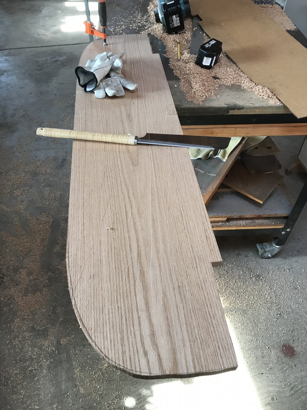

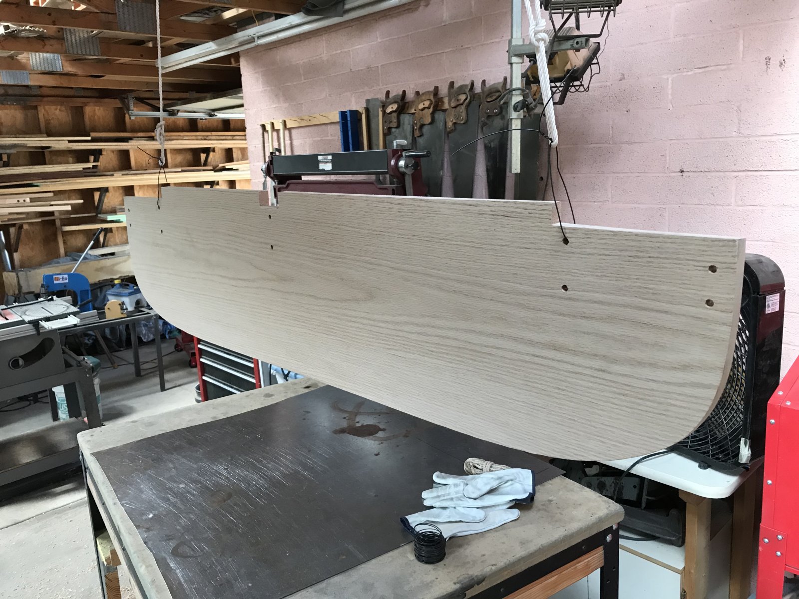

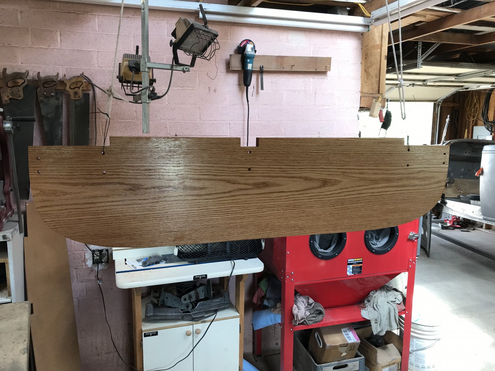

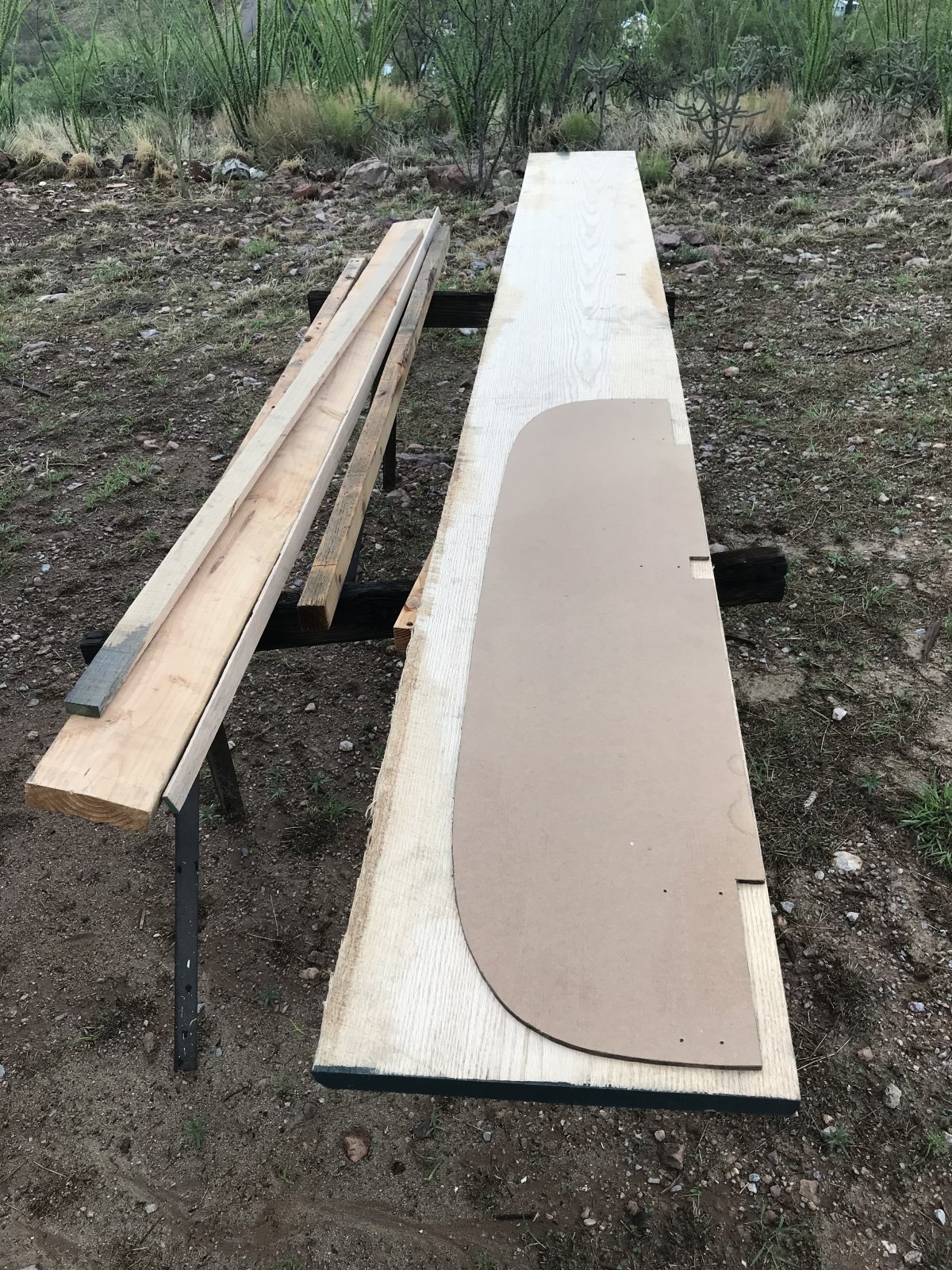

    Elvis100
    Made a package tray using a pattern a friend sent. It was just a little too wide to fit in my bench top planer, so I used a handheld power planer to get it down to 3/4 inch. Sanded and first coat of marine varnish.
