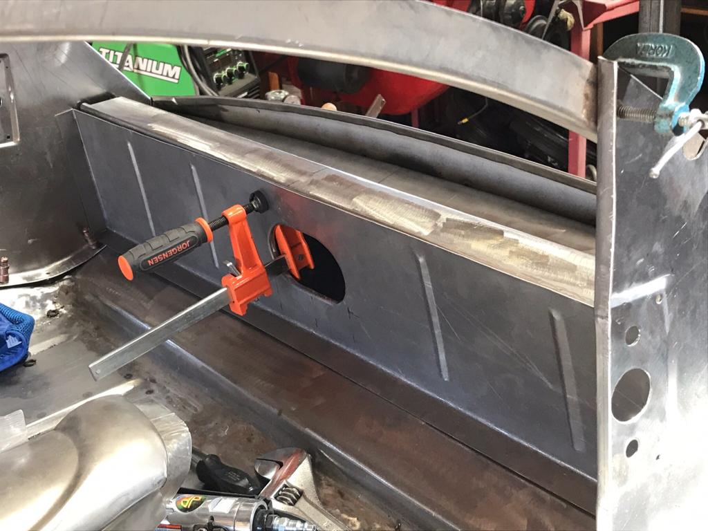

    Made a new trunk lid latch support panel, or whatever it’s called

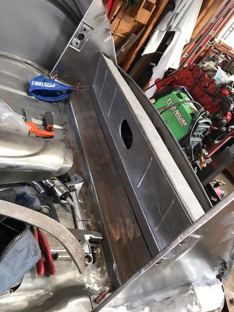

    Got the trunk latch bed panel formed, now to drill all the mounting holes and install the captive D-nuts

    I spot welded some 5/16-24 captive nuts on the back of the support panels. I had welded some fixed nuts on my coupe and they worked pretty good. Without these you have to lay down on the floor with both arms outstretched to install these bolts once the quarter panels go on.
    Still a few more holes and the D-nuts, but all the new panels are clicoed in their final position with everything fitting pretty good

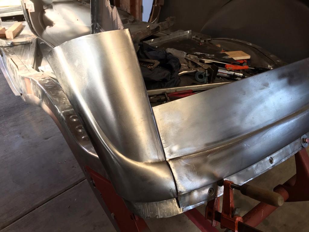

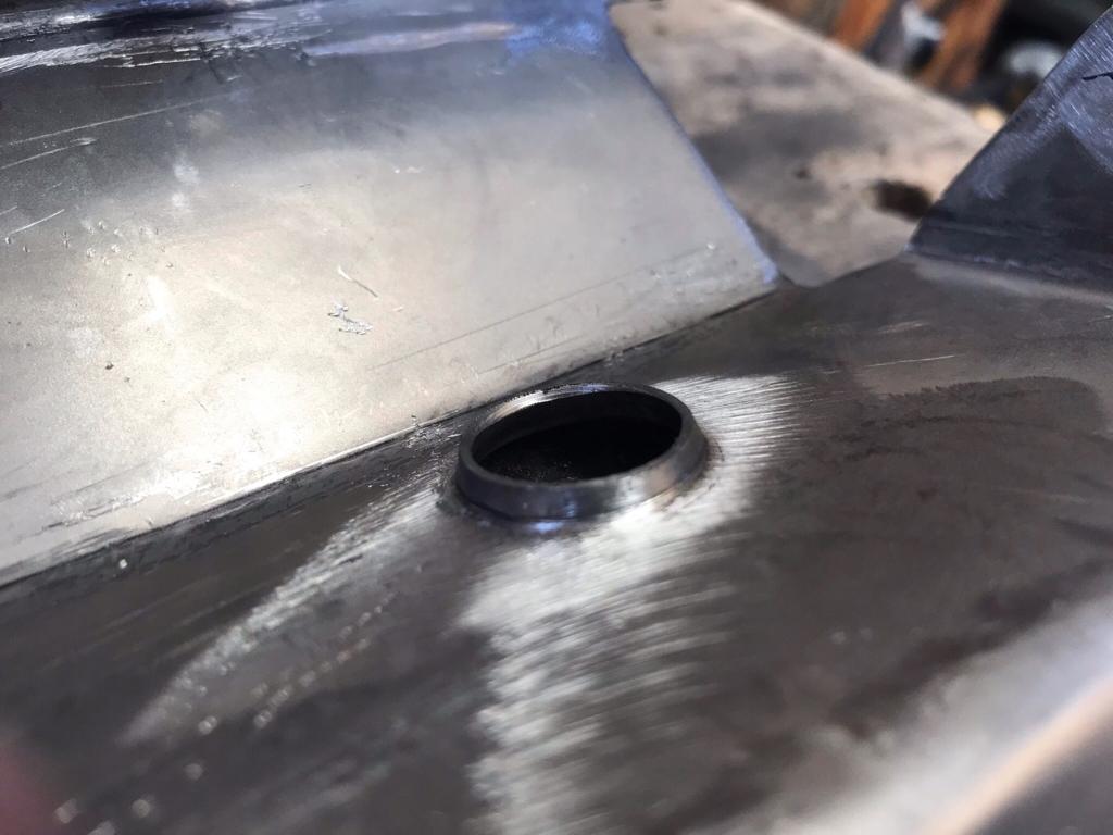

    Finished up the D-nuts and holes for bumpers. The bumper hole has a lip on the underside, I undersized the hole and used some improvised tools and it worked great!
    Started on the rear corners now that I have a good foundation

    So, you have a tool to crimp the D nuts in place, or you tac them ?
    Elvis100, loudbang and Stogy like this.
  15. Elvis100
    Joined: May 21, 2016
    Posts: 562
    Elvis100
    I use the ball end of a tie rod stud and a hammer. The round end pushes the flange out and then clean it up with a hammer. I use the same stud in the press when there is clearance.

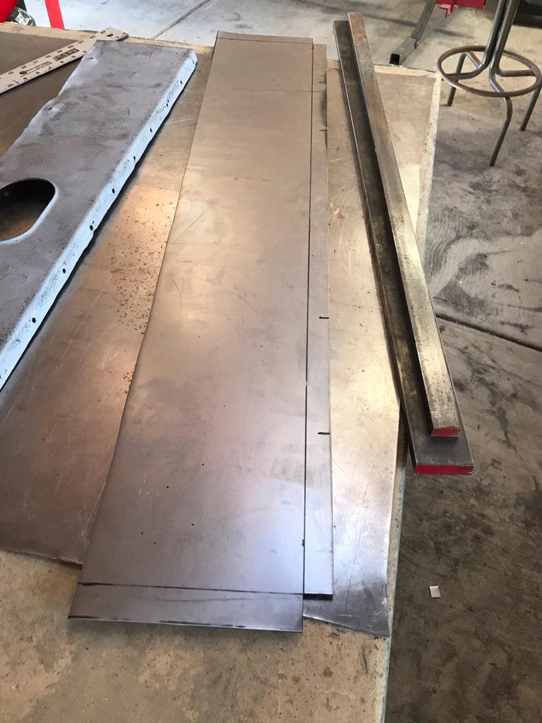

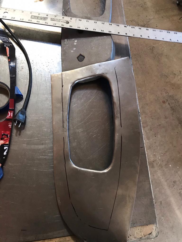

    Made a die for the toolbox dimples on the forward quarter panel support. Made the right hand support, my original is a little lacy. The left one will be a lot easier without the dimples.

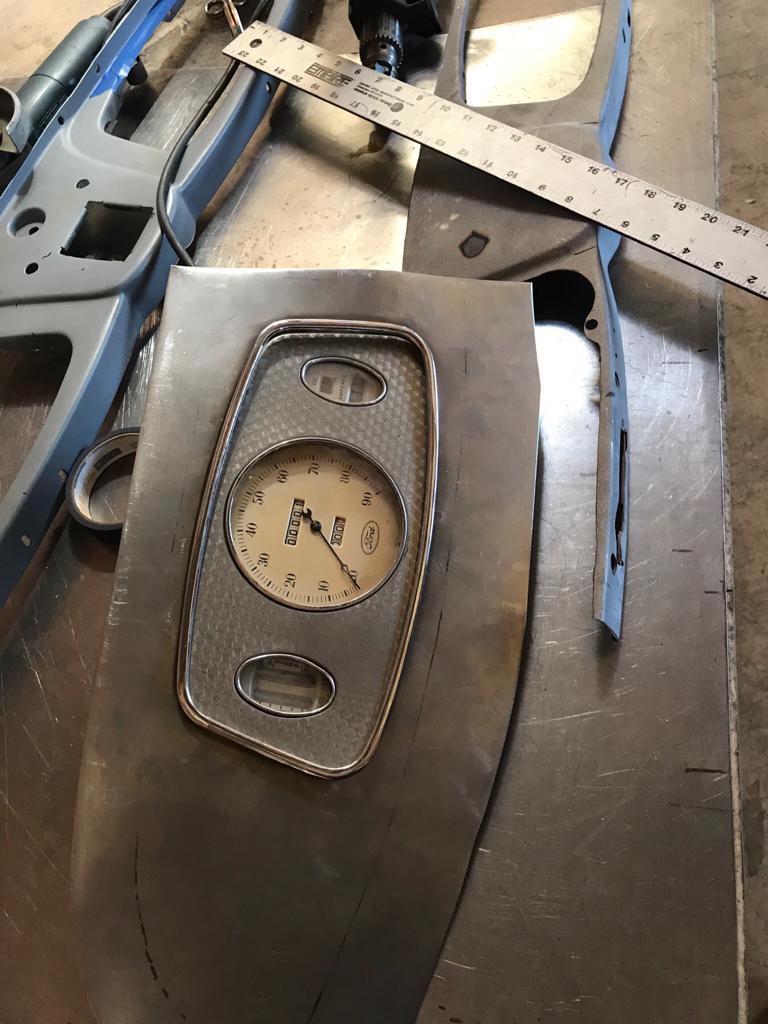

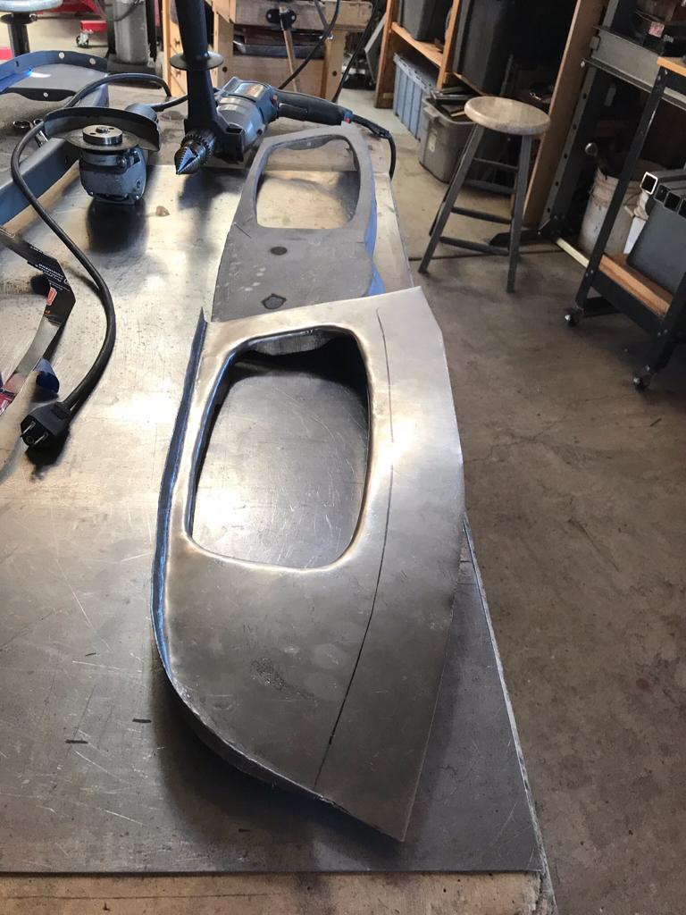

    A little side project, Turning this heavily modified closed car dash into a 33 roadster dash

    Finished up the Frankendash. Did an experiment using vinyl wrap woodgrain. I think it came out pretty good for my first time. The nice thing is you can just peel it off if you don’t like it.

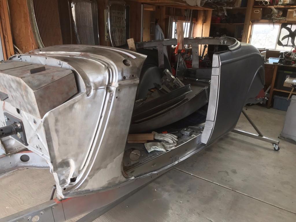

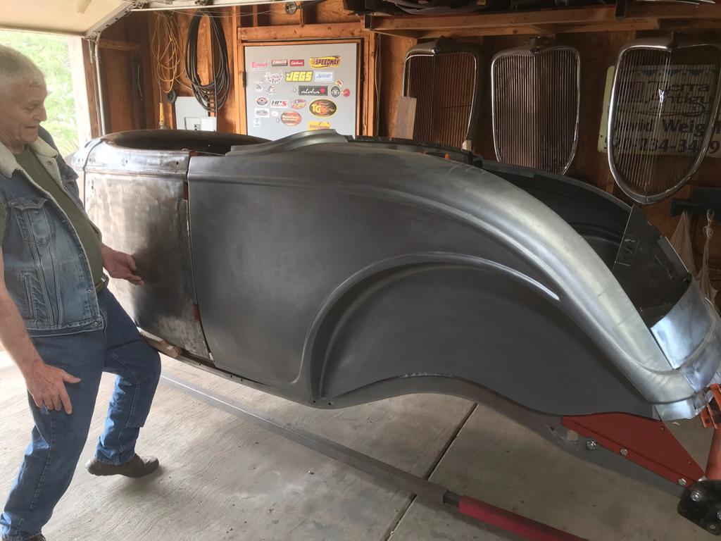

    I started on the left quarter panel. Tack welded the new corner and offered it up to the car...it fit terribly. I offered up a SAR quarter to double check that there wasn’t something wrong with the under structure. The SAR quarter fit beautifully. I do need to adjust the b-pillar a little, but it was almost a drop fit. The gaps on the door were almost perfect and the height adjustment on the b-pillar should fix. I think I’m going to go with the SAR quarters on this car, and maybe use the original quarters on another car.
