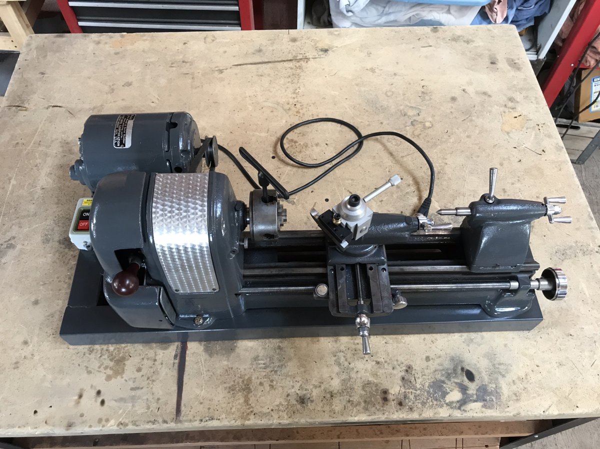

    Relaxing day, cleaned and polished the rear quarters. I had stored them in the carport and they were covered in flash rust. Then after lunch I rushed over to pick up my $85 craftsman 109 lathe of Craig’s list.

    good score! looks like a cute lil' bugger. gotta have a lathe in the shop. i have a nice clausing 14", but i have always wanted a small one on site too for little jobs

    Yeh, I have needed one a few times. This will definitely come in handy.

    The 109’s are well know for bending the main shaft, be careful not to take too deep of cut with it.

    Thanks, I’ll take a look at it when I clean it up.

    Spent a few days refurbished the little lathe, The main shaft was bent. I was able to get a solid one to replace it.

    That's cute as a bug!
