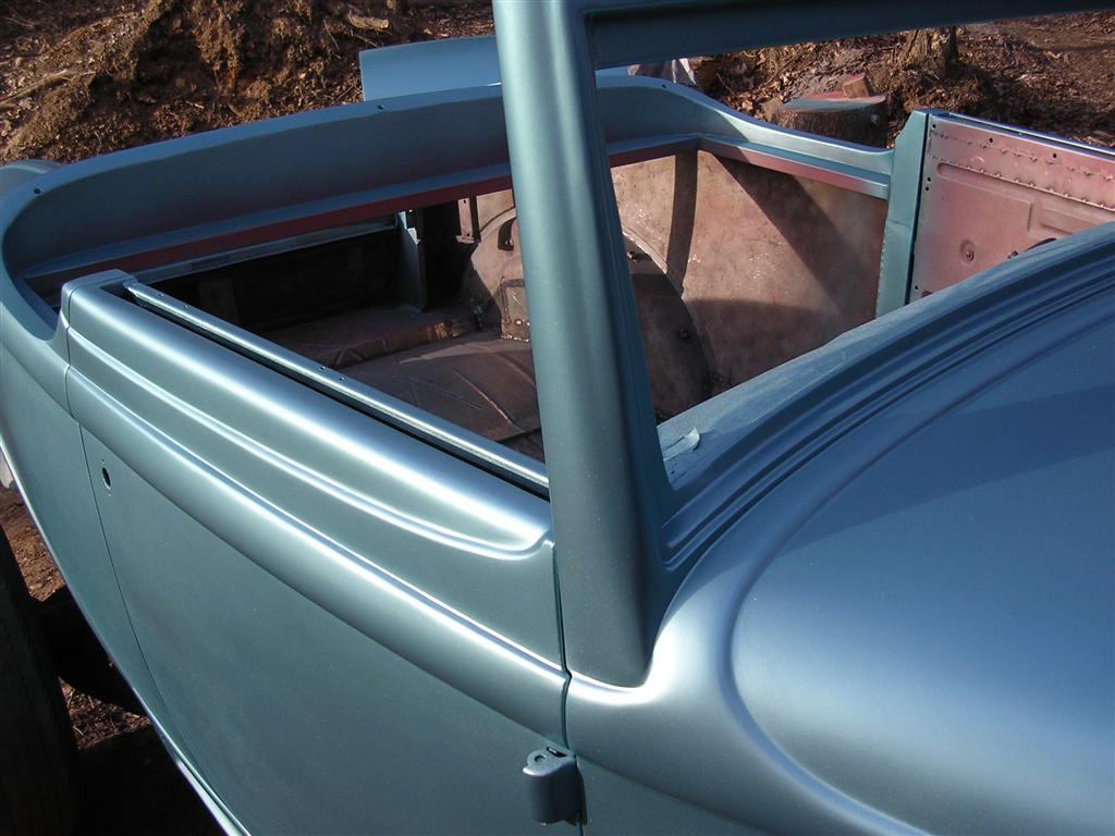

    Hey guys, just got back from the FItchburg swap meet and thought I picked up a 32 closed car frame to fit my 5 window.... but it's different! the bottom of the frame has less radius than the 5 window. can anyone spell out the differences between the two so I can figure out what I have?? I will take a few pictures later as my battery is on the charger at the moment....
    basically, the frame itself is a bit thinner than the 5 window I have.....and flatter around the cowl.

    just did a google search and came up with this side by side pic... going by this shot I think I got a 3 window frame..... I will have to get some pics of my two frames side by side and ask the experts opinions. I don't have or know of any 3 windows around me to compare.

    took a couple measurements.... the frame is 3/4" thick vs 1" thick that my current 5 window frame is (it's rough) inside to inside of the center of the frame 10 1/8"

    There are a few cars/truck frames that look the same as Ford from a distance, but are not the same.
    It sounds non-Ford to me. pics would help, of the hinges etc

    Frame only looks like a 5 window. Possibly a repop. Don't think that the one with glass is a 3 window. Don't think it is a ford either. If it doesn't fit right it may have been tweaked to fit a certain car, as they probably weren't a great fit to start with. remember that the original cars were built in 30 different factories so not every thing fits right.

  11. The no glass frame looks a lot smaller at the points than the other. Like if you placed them cowl sides together ? How much smaller is it ? Also
  12. The "cowl curve" seems more extreme than a 32 would have..compare? Tim

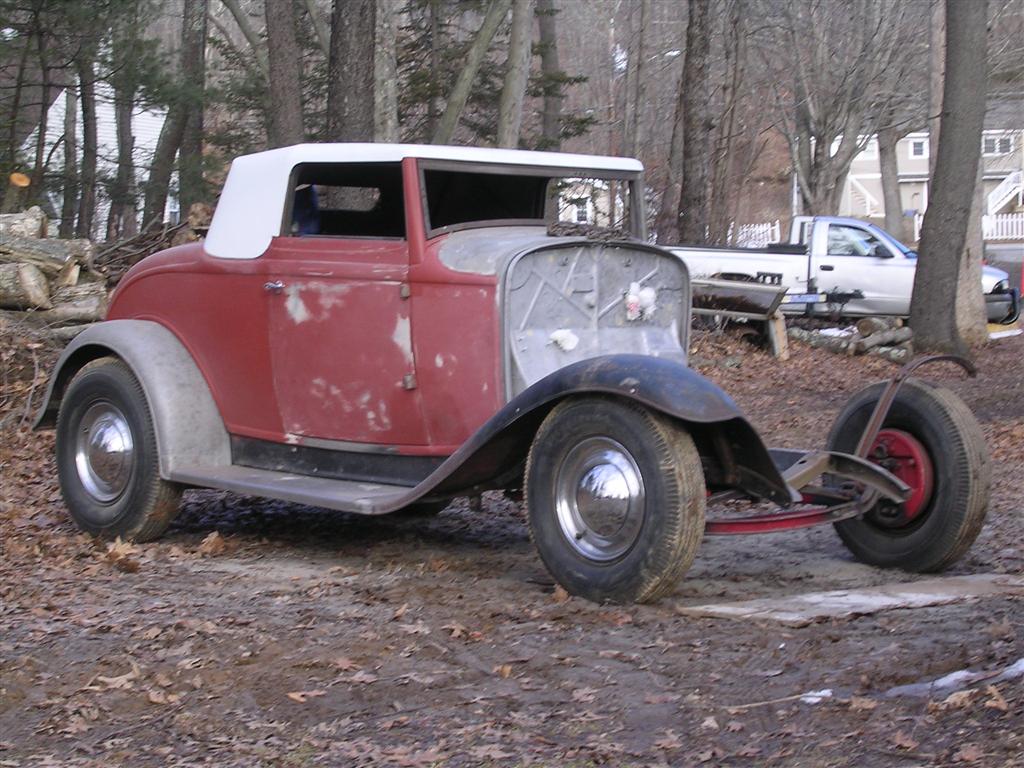

    it's fairly straight up and down... I'm about 90% convinced this is 33-34 dodge or plymouth.
    here's a shot of a 34 plymouth with a crank out windshield, no slides.

    I am 100% sure now, the hood sides laying in the rotting leaves were identical to those of this picture when I found my windshield frame.
