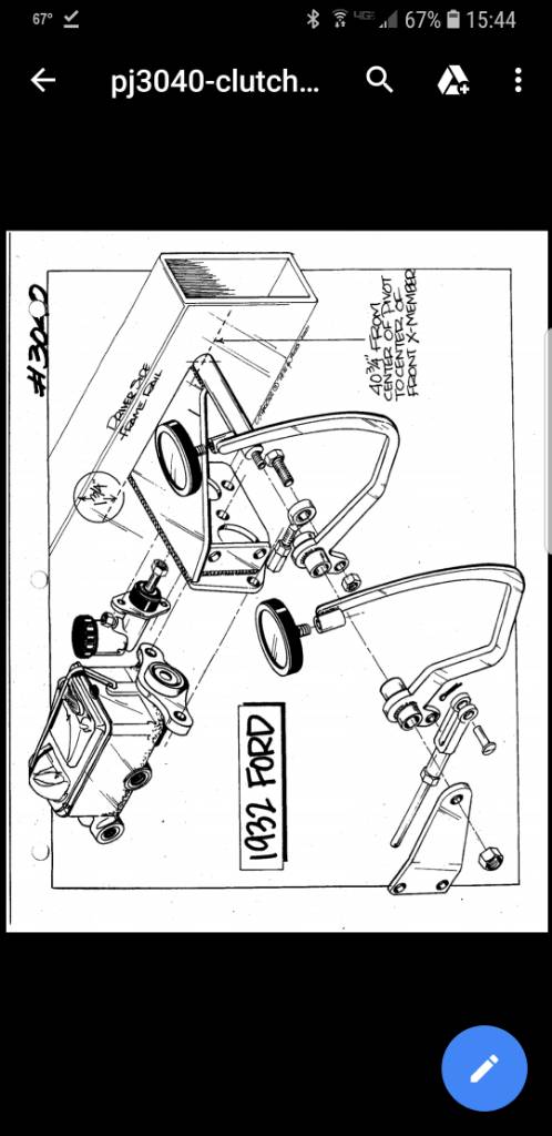

    I just spent several hours on the web yesterday searching for the perfect manual brake mc and mechanical clutch pedal assembly for dads 32. I spoke with a guy at Pete and Jakes, they recommended their hydraulic clutch kit. Part number 3040LC (less cylinders) The guy on the phone had used this kit on his car with mechanical linkage with no problems, so I ordered it. He says all you have to do is not use the mounting bracket for the hydraulic clutch just attach a heim joint with a rod on the bottom of the clutch pedal for the push style Z-bar. Hope this helps.
    Sent from my SM-G960U using The H.A.M.B. mobile app
  16. FlyingRN
    Joined: Oct 10, 2018
    Posts: 49
    FlyingRN
