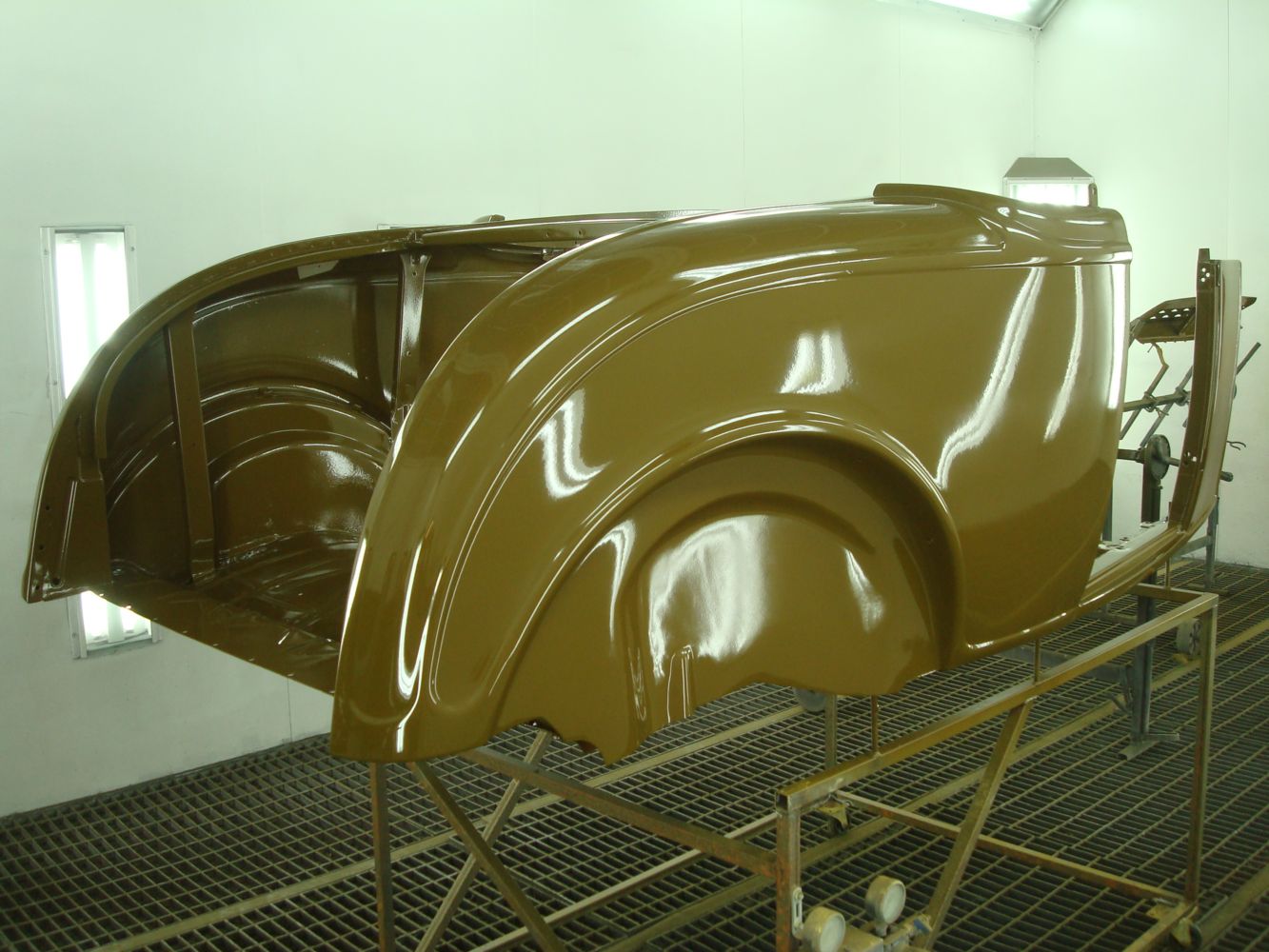

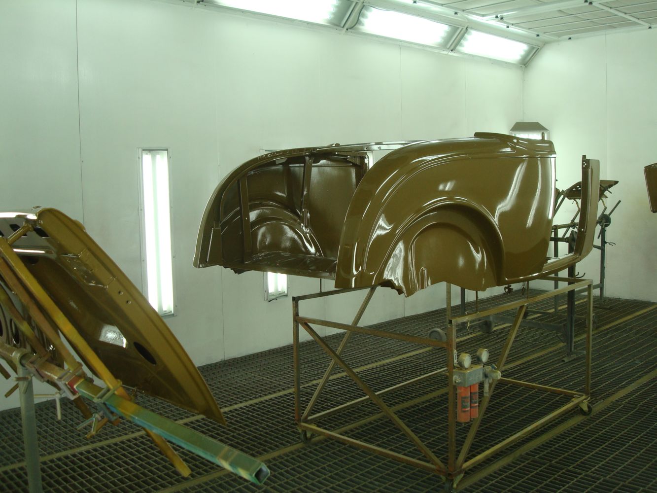

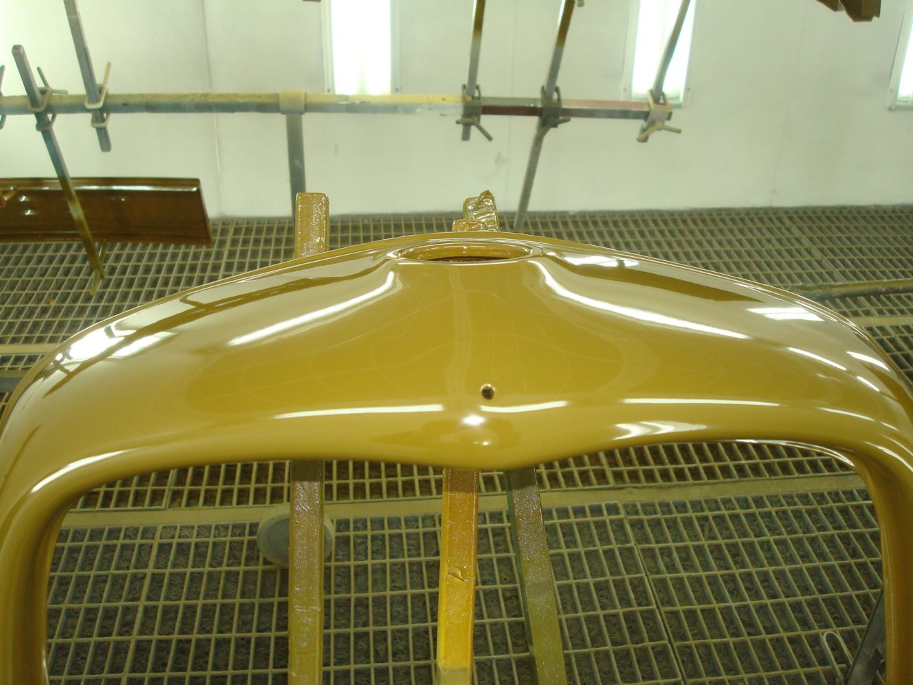

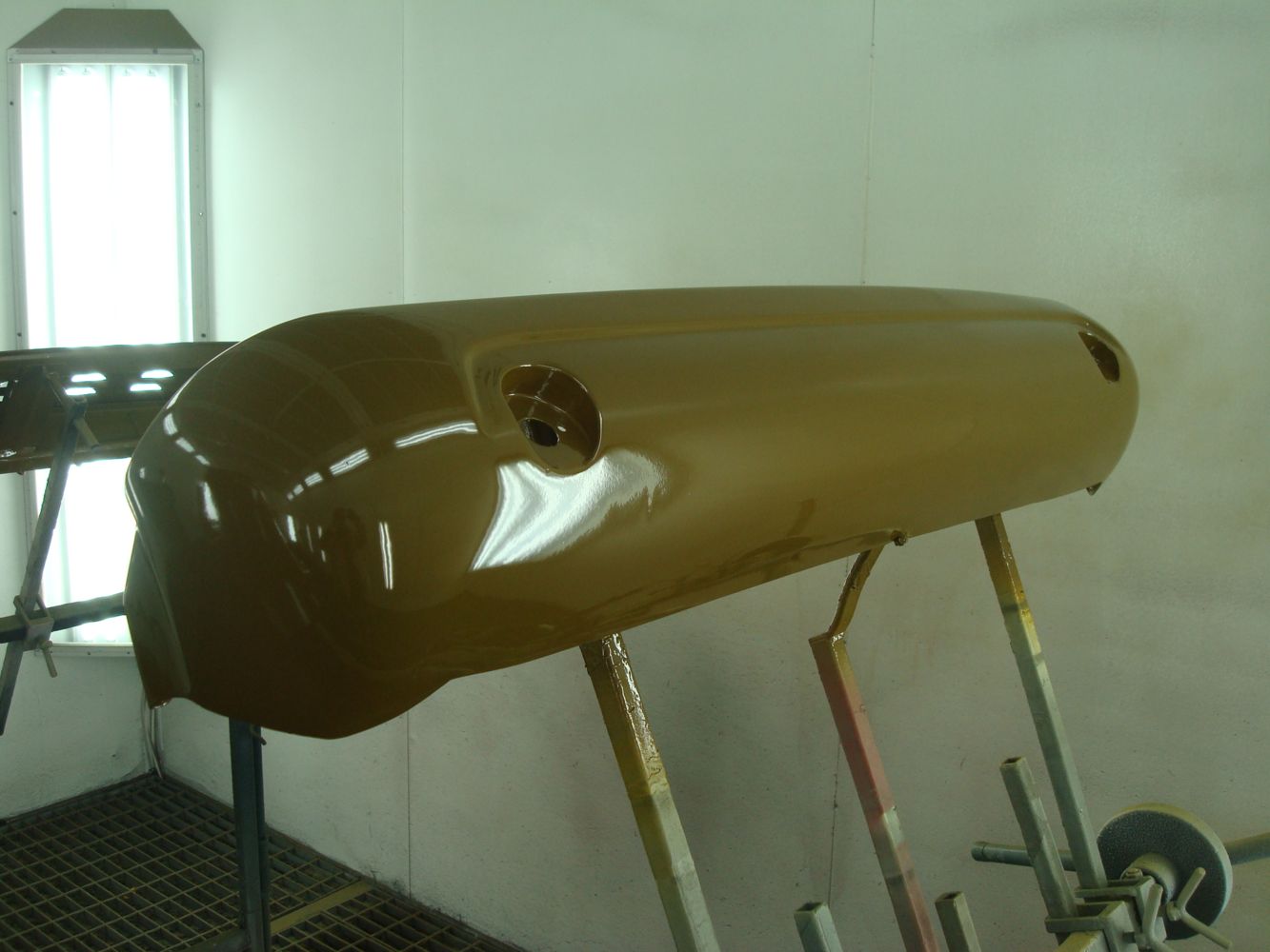

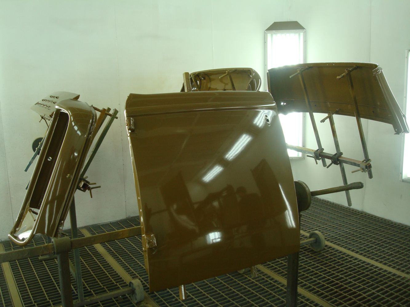

    Today I got paintjob ready. It was "small Christmas" after long 5 month working with body and frame.
    Rgds,Aulis

  2. ChuckleHead_Al
    Joined: Mar 29, 2004
    Posts: 1,955
    ChuckleHead_Al
    That looks cool, what color is that? Great job.

    Love that color! More photos!
  5. AULIZ
    Joined: Oct 28, 2005
    Posts: 1,309
    AULIZ
    Thank You very much.
    Color is Olive Green 2K Acryl (glasurit). 10% matting base increased.
    Tires are 28", both front and rear.
    Wheels 1936 Ford 16x4.
    Aulis

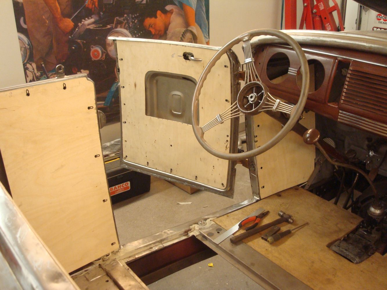

  6. Love that color and the '39 dash!

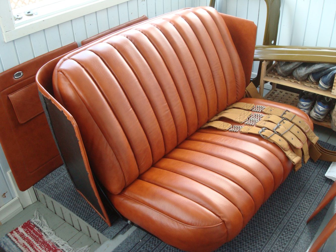

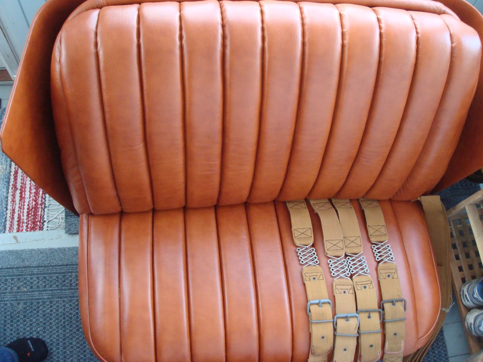

    I put some more pictures when frame has got color etc. and when all going back together. Monday I go to pick up interiors from West-Coast, 50miles from here, and can´t wait to see how all are done,....... I have give instruction and pictures from 40´s - 50´s rod interiors when I left tempered 1939deluxe sofa + plywood panels there.

    I like the dash, What is it?

    1939 Deluxe has given Dash, Column.

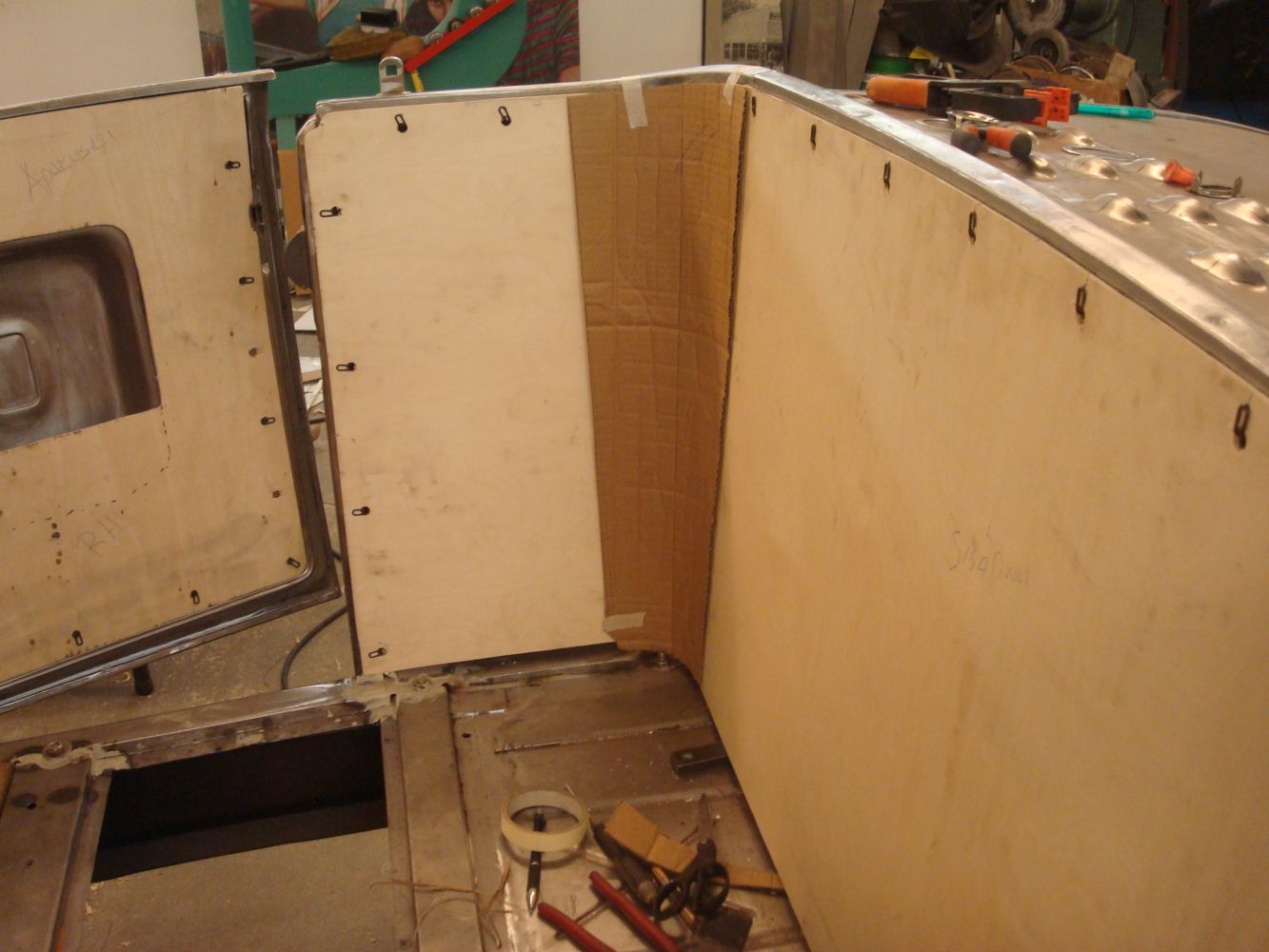

  19. JeffreyJames
    Joined: Jun 13, 2007
    Posts: 16,612
    JeffreyJames
    from SUGAR CITY

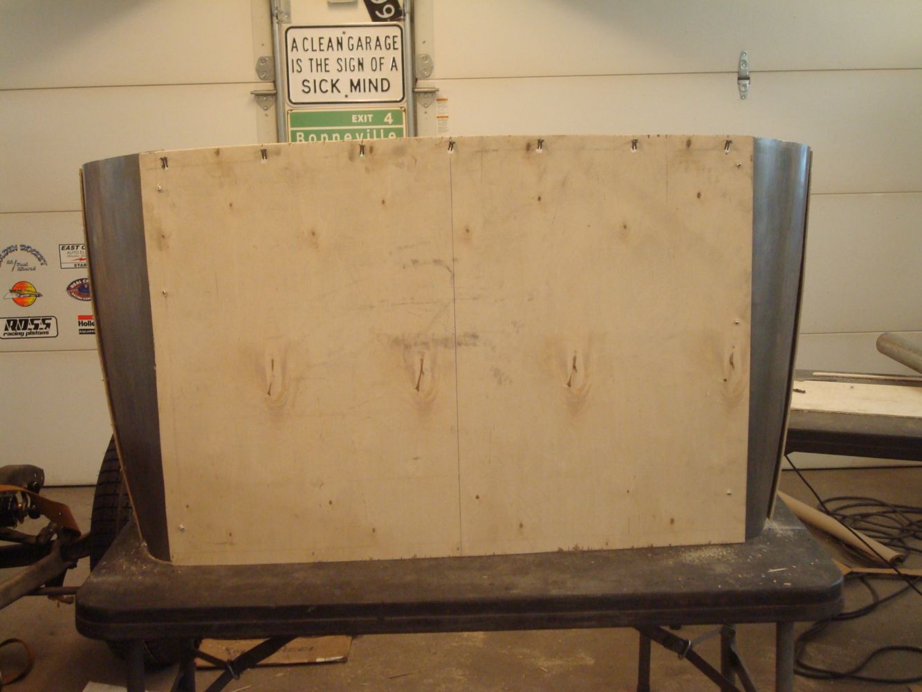

    What size luan did you use? My auveeco clips fit like shit and that's after opening them up a bit because they would not fit at all on 1/8" thick luan. I'm almost convinced that trim screws are going to replace those damn clips!!!
    Roadster looks awesome!!
  20. AULIZ
    Posts: 1,309
    AULIZ
    Thanks.
    Panels are plywood (4mm = + 1/8") and corners are steel. I made using englishwheel, so can have curved corners both ways.
    Clips I bought from C&G Early ford Store (escondido, CA), B 20015 - door upholstery clips - few dollars 50pc.
    Aulis

    Just picked up interior and hood belts (originally FinnishArmy belts from 50´s).
    Aulis

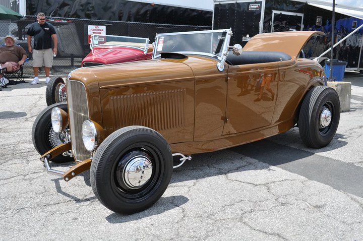

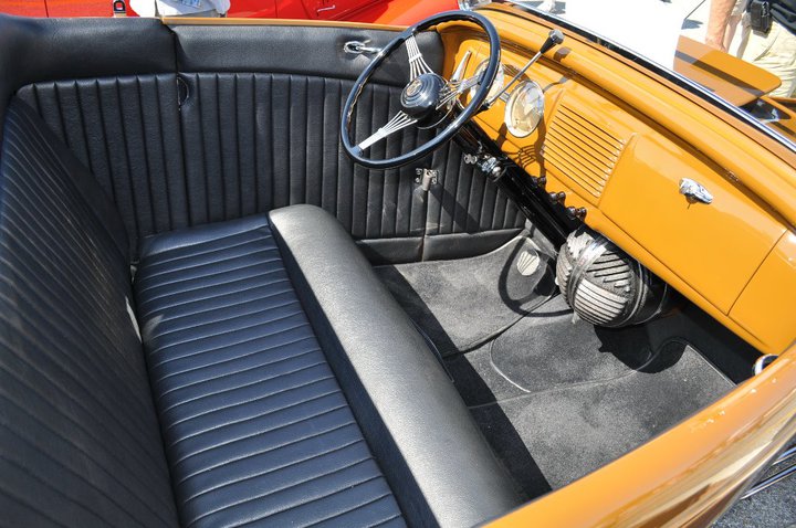

    Here is what it will look like done! I have had it done for 3 years now. Cant wait to see your finished

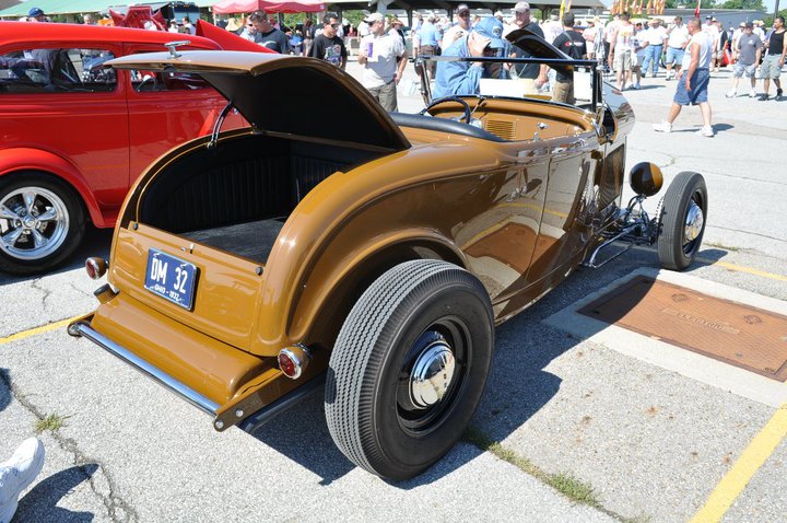

  26. What is the canister in the trunk to the right of the fuel tank?

    I like that Brown roadster very much. Black interior and wheels with hub caps makes it very very nice. Color is also "timeless", classic!
    Is that dash + steering column 1940 ford?
    Small roundend ganister is old toolbox. Maybe from tractor, old catepillar, car,...I do not know what it´s originally, but looks good and rather good shape.

  28. LowA100's car has a '39 dash. Column drop is a '40 piece.
