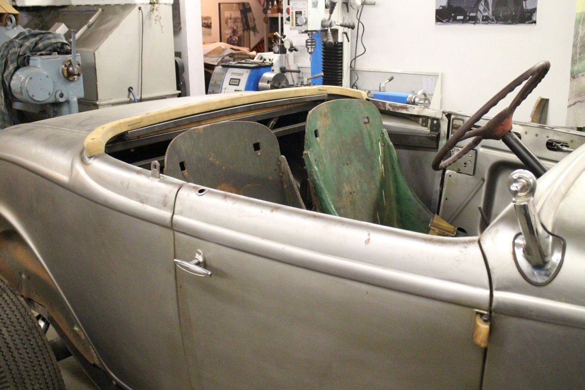

    I was 2days out of homeoffice and same time picked up new Project.
    Project arrived from Houston Texas (Originally from Iowa) few days ago. Now familymember is safely in own garage.
    I built this car ready during this winter. Some body changes, change engine and tranny, drop down rear end of body and maybe little front too,......

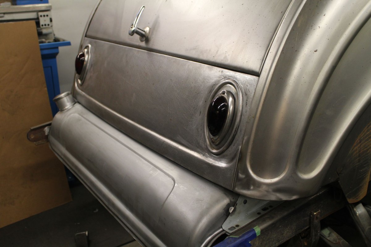

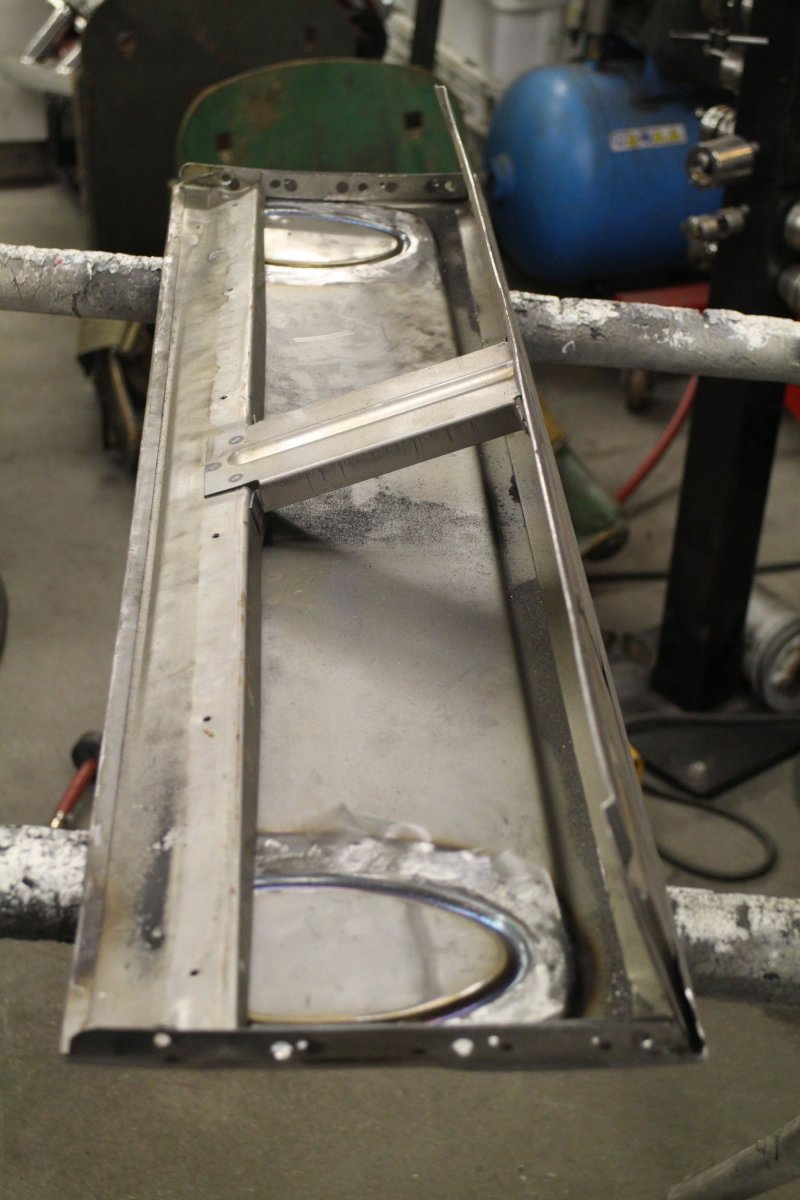

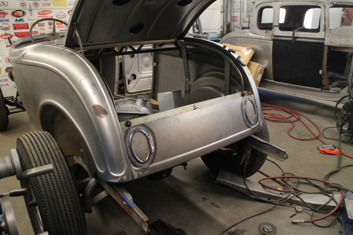

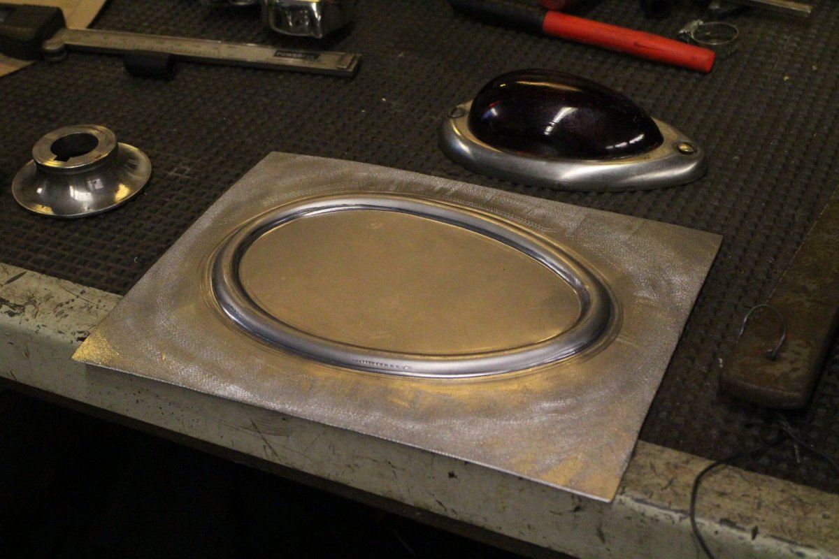

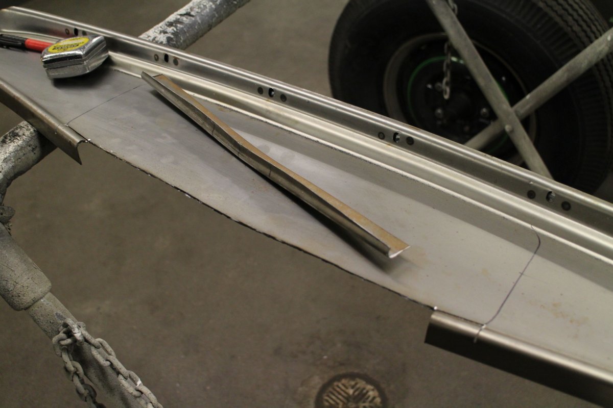

    I have been lazy,... but today worked hours with roadster.
    Need to make holes to that panel and tigweld those new sheetmetal pieces there.
    Taillights are 40´s K-D 540.
    Dash is next after this. Need to shape it to fit auburn style alum. dash panel.
    Aulis

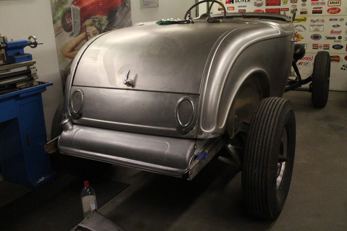

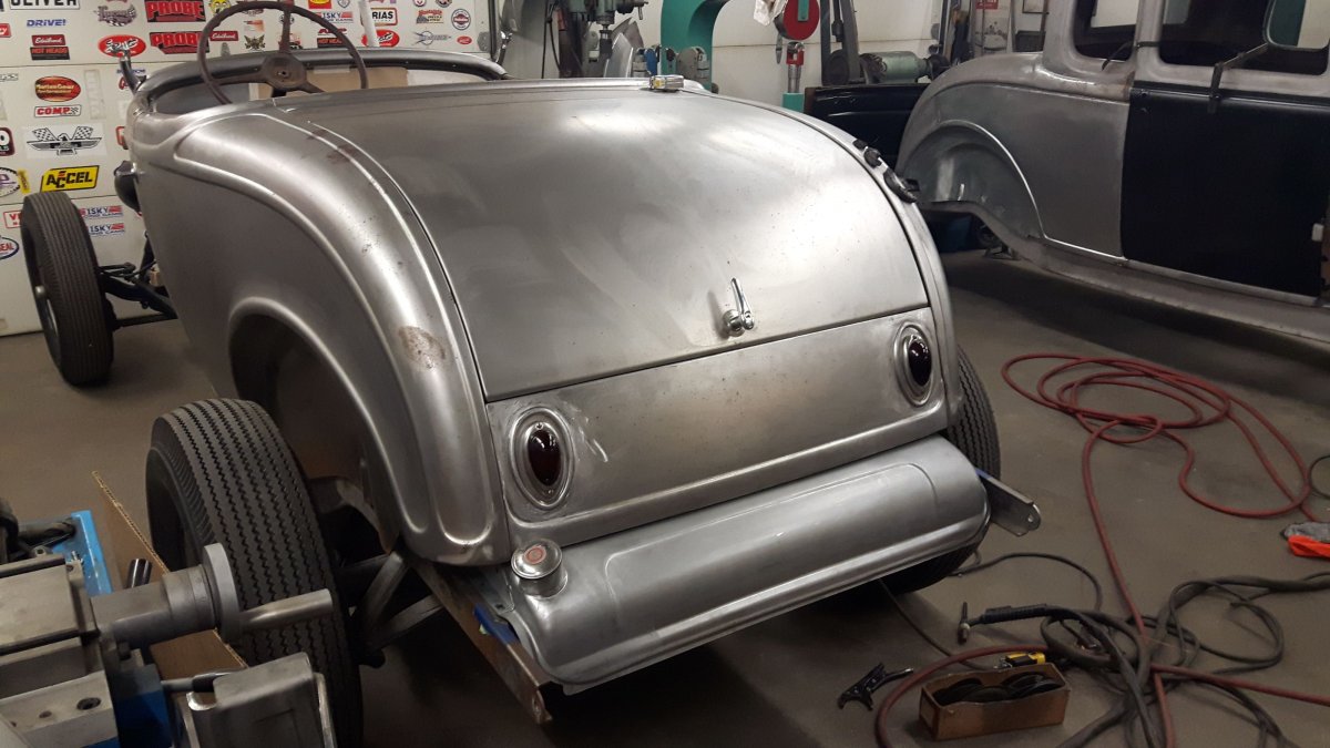

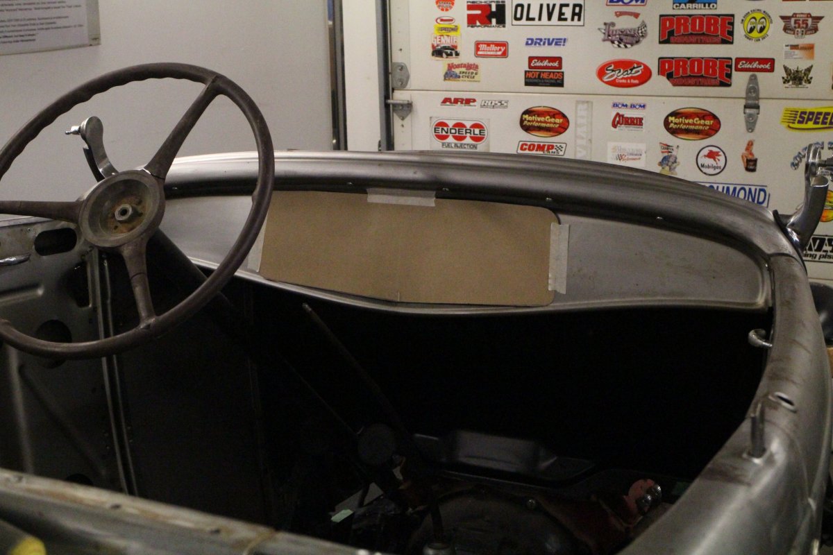

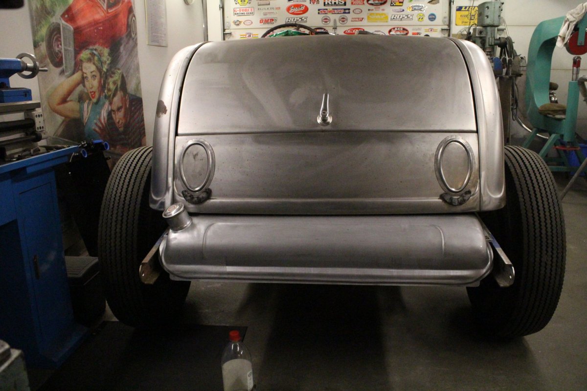

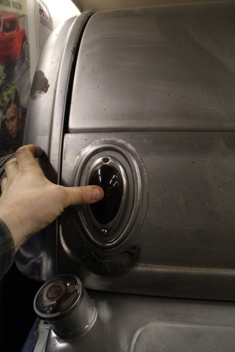

    Now sheetmetals are welded and lights bolted on.
    Tomorrow need to cut and weld dash.
    Aulis

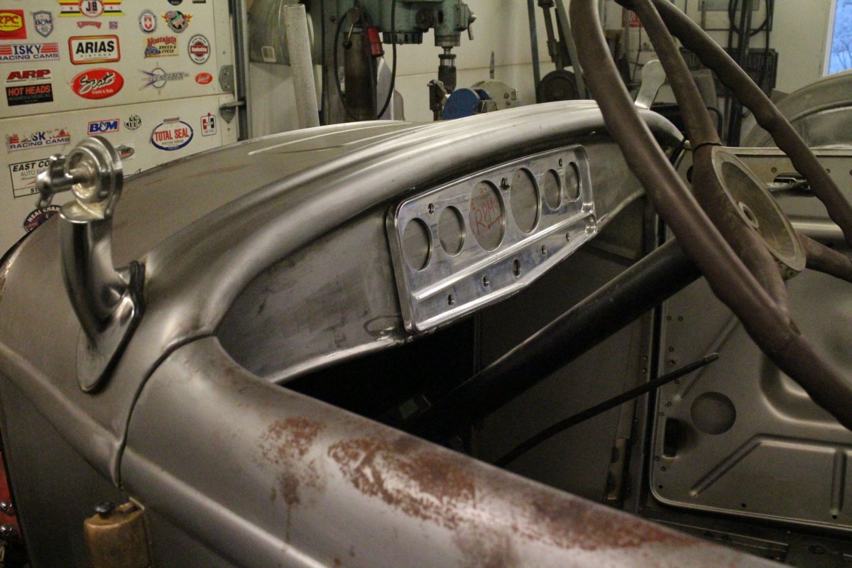

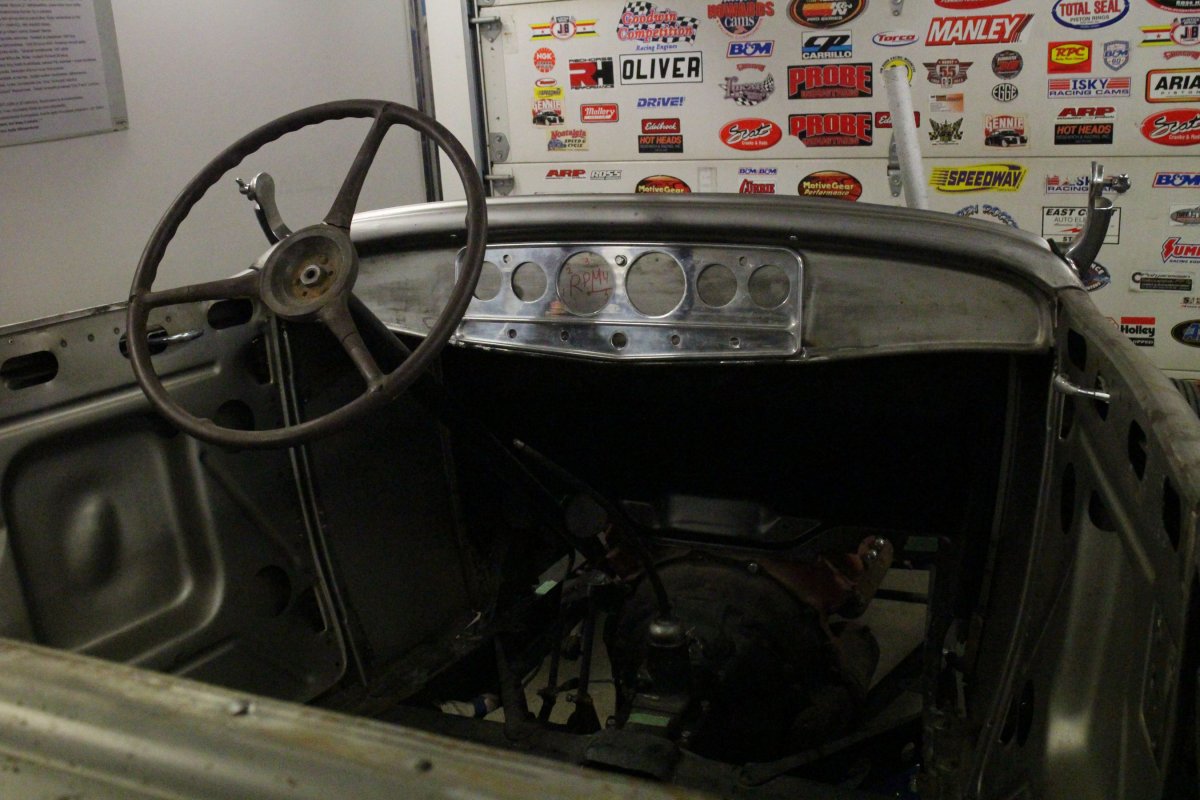

    Dash changed.
    Gauges and gaugepanel bought from HamB, thanks "nassaublue65" VA Usa.
    KD taillights bought also from HamB, thanks "hb32", B-C Canada.
    Aulis

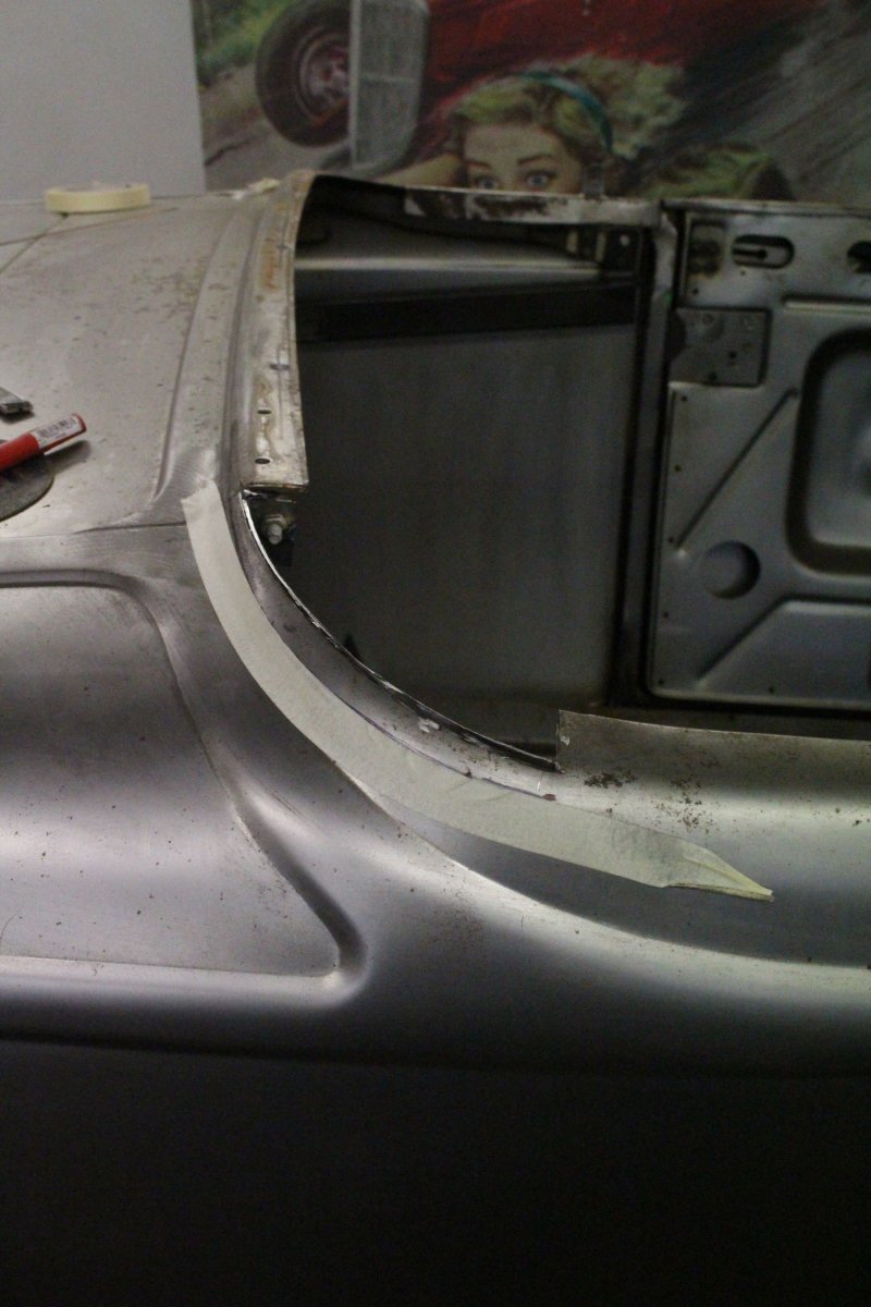

    Here today result. Continue Friday Morning.

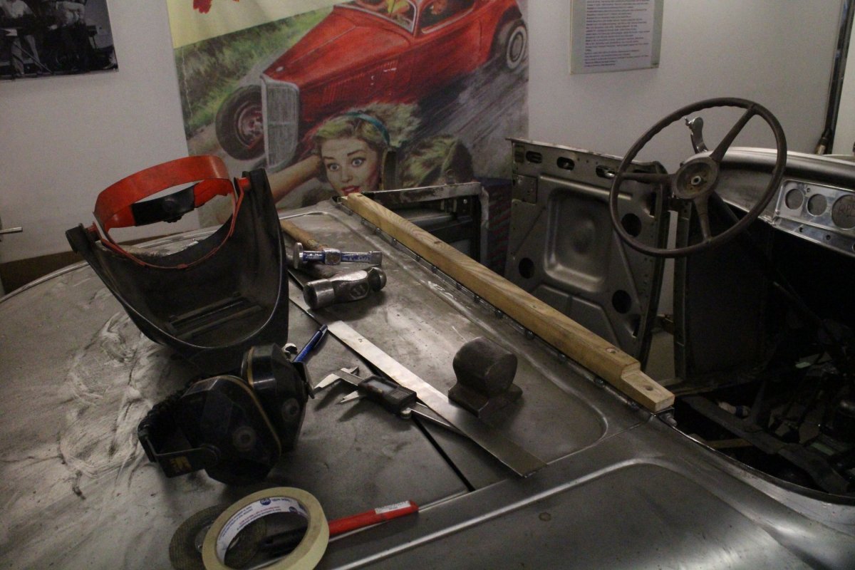

    I like more original style body, when Wood tack rail set is "dropped", so... I cut and weld.
    Total drop is 1/2" . Cut upper side of tape.
    Aulis

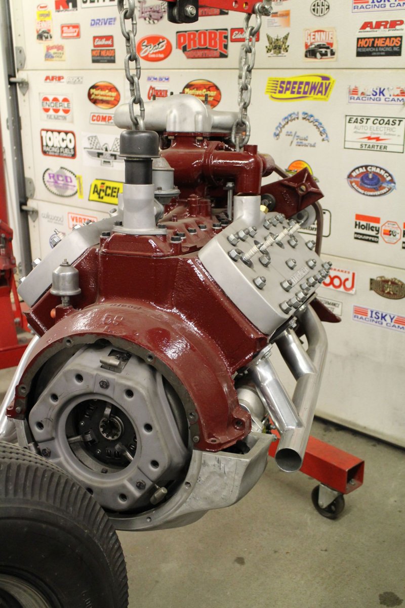

    few pics bodyworks.
    some engine swap pics.
    somebody has made nice clutch arm......
    Maybe I change it original 1932 arm.
    aulis

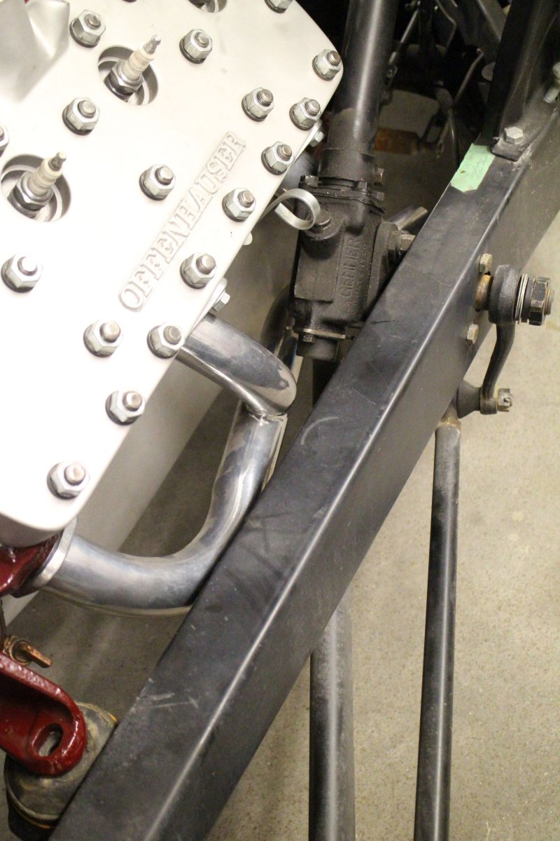

    Questions:
    1) what is difference between 1939 Double Detent tranny gears and Lincoln Zephyr gears? Earlier I have had only DD trannys and this one with LZ gears I have keep stored for good Project.
    2) Gemmer steering box. Looks like 1932 Ford original box, but this one has very long columnshaft and -tube.
    Steering wheel is higher and upper. Maybe I need to cut column .... Now looks like strange.... What is this steering box? Is there many different lenght steering column/column shaft in year 1932?

  26. trey32
    Joined: Jul 27, 2014
    Posts: 326
    trey32
    Is it possible that it's a model A steering box??
  27. AULIZ
    Joined: Oct 28, 2005
    Posts: 1,479
    AULIZ
    I do not know. I have never had any model A box. I do not belive, because A-ford box is 4" longer than B ford box.
    Not that way, not possible.
    I slide out column tube and one thing is sure, nobody weld this column axle longer. Looks like very good condition and original lenght.
    All dimensions, size,...is same than original 1932 ford - 1934 Ford.
    Only that mounting adapter is not same those 33 and 34 yearmodels, if we compare those for 1932 box..
    I was google and try to find info Sunday evening and Im rather sure that its BB box.
    I open box when I take body off and work with frame.
