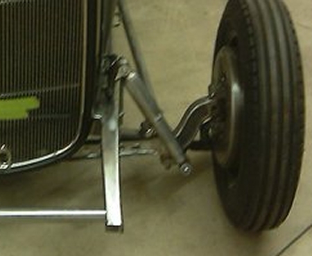

    Quick note on the steering..My 32 Roadster has a 39 steering box, and the draglink is parallel to the tierod in all planes..so it is do-able. I cannot fit aftermarket cylinder heads due to the proximity of the steering shaft past the head, and the Box is inset into the rail about an inch, its all compromises..you are right about that. I dont know if your setup induces bump steer..but it does increase the effective steering ratio somewhat, expect to be wheel twirling a fair bit when parking!

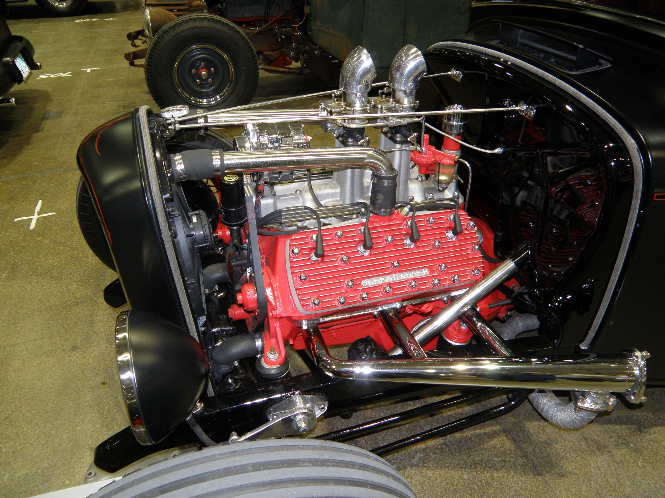

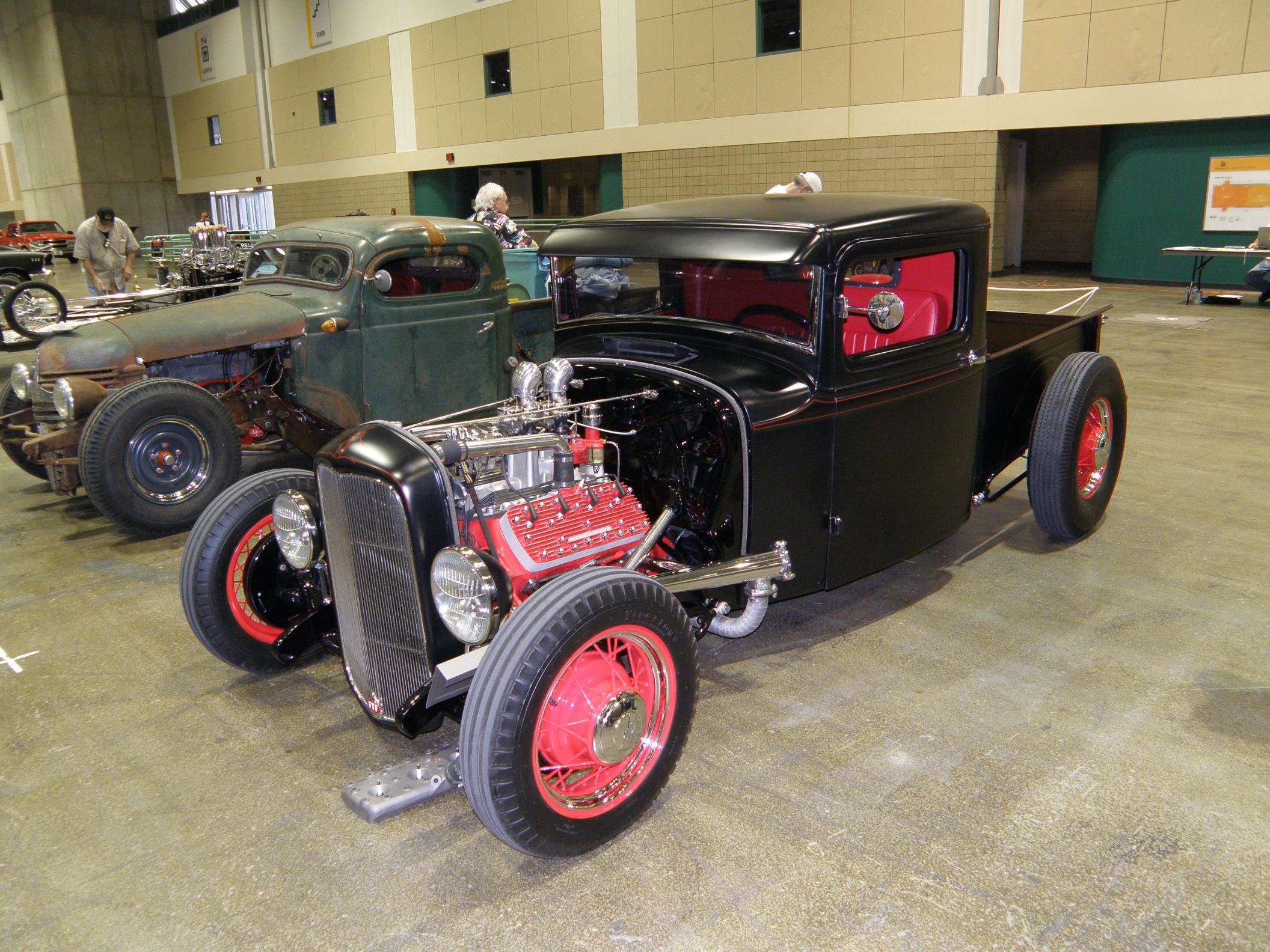

    I just found and read this thread.....Cory I met you a few years ago at the KC world of wheels....Your roadster is sweet, For those who have concerns about his steering setup...He is fully aware of what it will drive like as here are a couple of pics of his 34 pickup I took at the show with the same steering setup......Also I wanted to point out As I am sure alot of readers are unaware......Cory is a young guy, And very talanted..(and I'm talking like student Young...LOL)..I couldn't believe it when I was checking out his truck at the show and he walks up to it and gets inside.....At first I thought this truck must belong to his dad or something, But after talking to him about it for awhile I realized he built it....And is just a very talanted youg man....I can't wait to see what the roadster will look like finished...
  25. That thing is killer! The stance is dead on. Fine craftsmanship. I dig the engine mounts and the Navaro speed equipment rocks!

    Thanks for the comments Doug. I had over 10,000 miles on the truck when I sold it.
