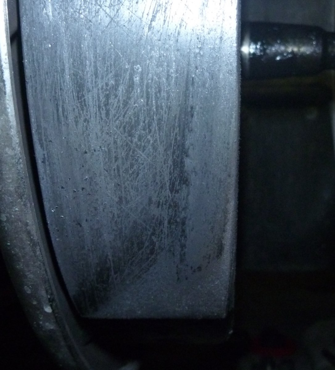

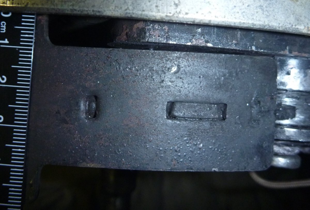

    Hi and thanks for this very helpful post on these brakes. Great thread too on this sweet pick-up.
    My issue has been that the leading shoe on my Lincoln backing plate/Buick drum combo has been pulling into the inside of the Buick drum face. My drums were 'as new' showing zero wear...had them trued to the hubs of coarse as well.
    Now I've read this post and things are getting better.... filed pin hole...opening it so shoes could find centre and all. So far so good....brakes vastly improved...but my old issue got worse. After 3 days of buggerising around ... brakes apart and back together many many times I 'think' I may have found my other issue...can someone help?
    Seems to me, and I do not 'know' ... that the plate that the top of the shoes are near to under the pin is not sitting in the correct place. Are the top of the shoes meant to ride on these? I guessed that they should and that either the wrong shoes were supplied to the Lincoln copy kit maker without their knowledge .... or the plate in question is too thin?
    I have made a temporary shim at the back to place this plate in the 'correct' position...I think.
    Any way, the issue with the shoes seems to be fixed.
    The pedal is higher then it ever was....27,000 miles on it now, and the brakes are working as they never had. I had no idea that they'd be as good as they are now. I expect that if I'm on the right track that these brakes will only get better when I do a permanent fix.
    See attached photos. first one shoes the shoe not parallel with the supplied plate position that I'm asking about and that I have since shimmed out about 3 mil. The next photo shows the angled wear at the bottom of the leading shoe. ( I lightly scuffed and cleaned the shoes and drums before I started)
    What does someone who knows think of all this? Thanks, Dave

    Getting the shoes centered in the drum is a major factor in how well these brakes work. Just the slightest bit off and the braking power becomes significantly compromised!
    That large plate at the top/inside of the brake plate above the wheel cylinder should absolutely be parallel with the shoe and the shoe should rest on it along with the two raised areas on the plate about in the middle of the shoe. They are there to keep the shoe aligned parallel with the drum surface. It looks like your brake plates may have suffered some slight manufacturing defect and could most certainly cause the issue you (hopefully) were having by allowing the shoe to twist when applied. Good catch!
    The other factor that is so important is that the shoes are arc-ground to exactly match the radius of the drum so that you get full heel to toe contact. It is very rare to have a shoe match the drum perfectly right out of the box.
    :cool:

    Hi again Dennis,
    Thanks so much for your reply and input. I'll do a permanent fix on the guide plate now. I am not the one you spoke to on the phone, so it seems another person saw and had the same problem. The
    Wilson kit I have is very well made...I've seen some with very cheap adjusters and retainer springs on other brakes but mine are very good. It's just this mismatch that occurred somehow. I had my coupe up to 80 m.p.h. for some tests and got on the brakes and it pulled up very hard like it had discs on the front. What a change! Thanks again and I'm sure that this information will help many drum brake owners achieve superior brake performance ... and may even save a life down the track.
    Cheers, David
