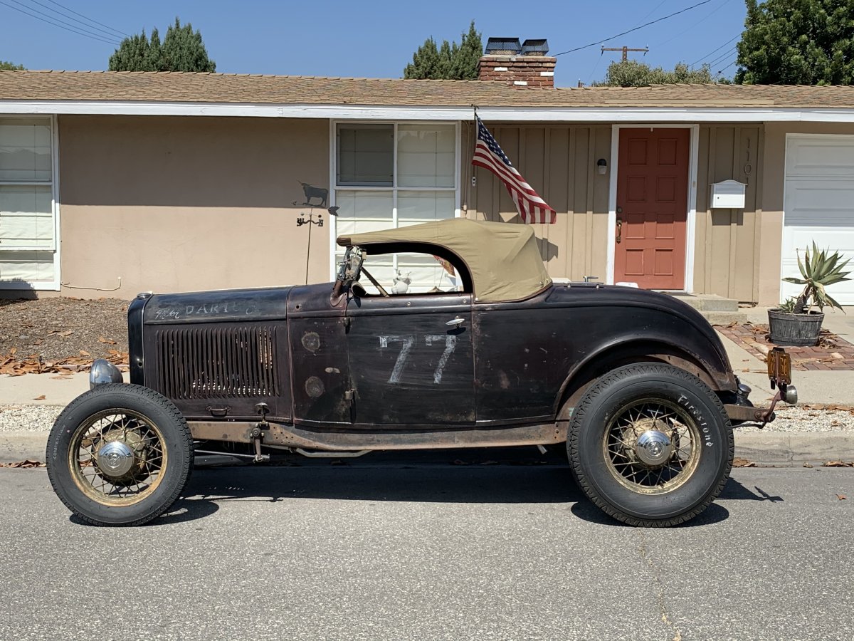

  9. deluxester
    Joined: Mar 14, 2004
    Posts: 468
    deluxester
    I took it for a run at a private airstrip last weekend for some racing! ..And to take some photos of the work done so far.
    DFB78F8C-6429-4955-9F01-C1F38C36F880.jpeg 1205AF2F-0FC5-48FD-9293-0A82E3B12BD2.jpeg 02DAAF66-DD1B-43F2-A64A-E48C4A3D32AE.jpeg

  10. So-cal Tex
    Joined: Aug 24, 2005
    Posts: 1,373
    So-cal Tex
    Nice work, I really love this car and all the nice touches you have added, I learned something new that the tack strip was originally dove tailed unlike the repro word kit I have in mine.............tent canvas is a great idea to get that original aged look for your top, I am going to steal that idea if you don't mind?

  11. x77matt
    Joined: Mar 2, 2004
    Posts: 680
    x77matt
    Wow man- this turned out so cool, I had to go back and start from the first page to follow your journey again! The top is brilliant, everything you did is just perfect!

  12. dumprat
    Joined: Dec 27, 2006
    Posts: 2,814
    dumprat
    from b.c.
    I love the top! I would find it hard not to make the wheel colour match it though. I think it would really pull it together.

  20. deluxester
    Posts: 468
    deluxester
    Ya, I was hoping the tent fabric would be more of a khaki color as the seller showed in the photos before I purchased it. I’m getting used to the od green, though. I might experiment with some matched wheel covers.

  25. So-cal Tex
    Posts: 1,373
    So-cal Tex
    How much did you chop the windshield and the top?
  26. deluxester
    Posts: 468
    deluxester
    Removing 3” at the windshield upper stanchions left me a dollar bill height at the center of the glass. I then removed a little more than 3” from the main top bow to maintain a level side window opening. The top irons are heavily altered as well.
