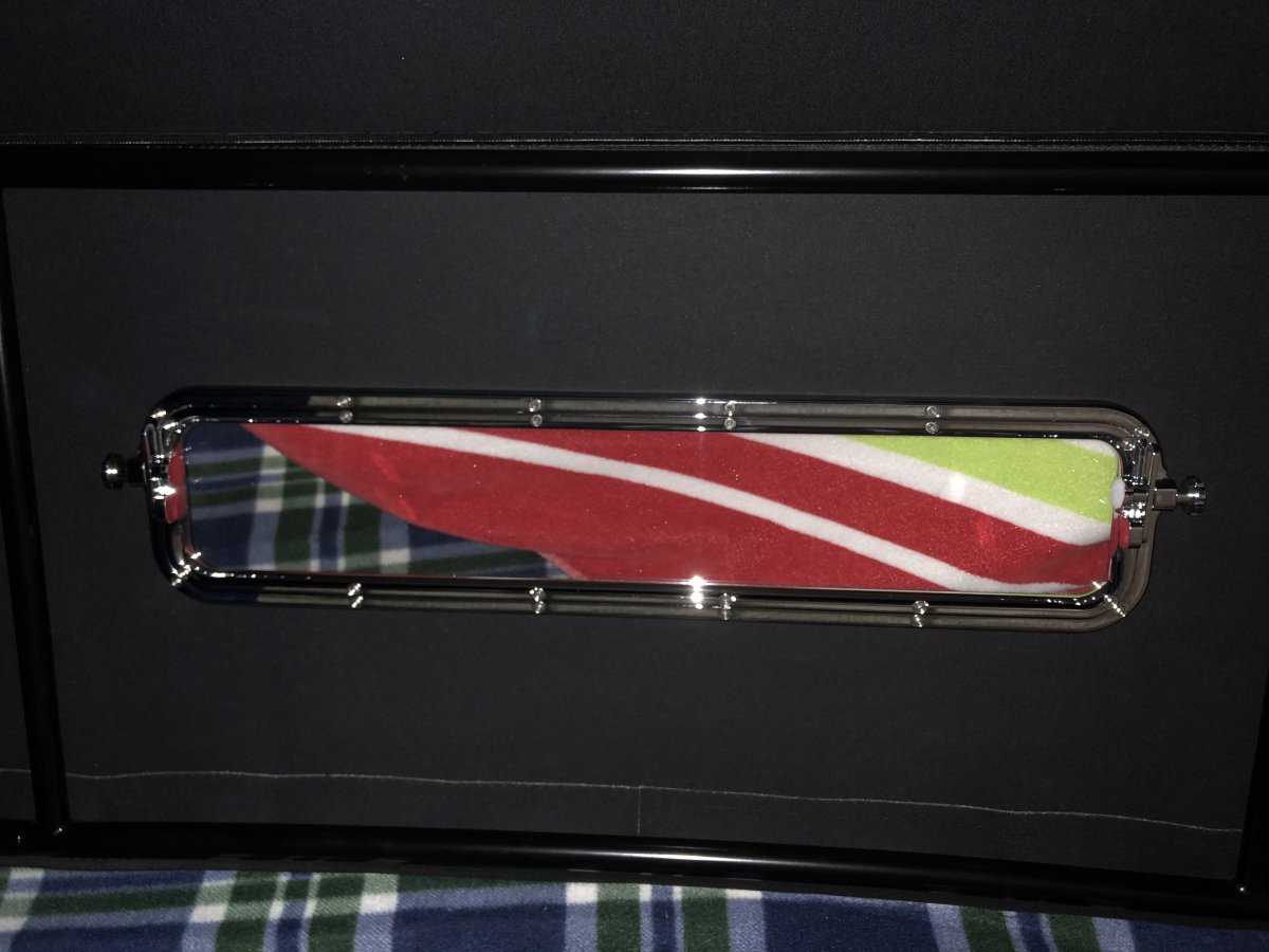

  25. How does the fold out rear window deal work? I’ve seen a few pics of those before and they look like a great solution.

  27. Ron,
    Two thumb knobs rotate it out on the hinge tighten them back up, thats it. sorry for the lousy pictures, top is off the roadster rite now.
