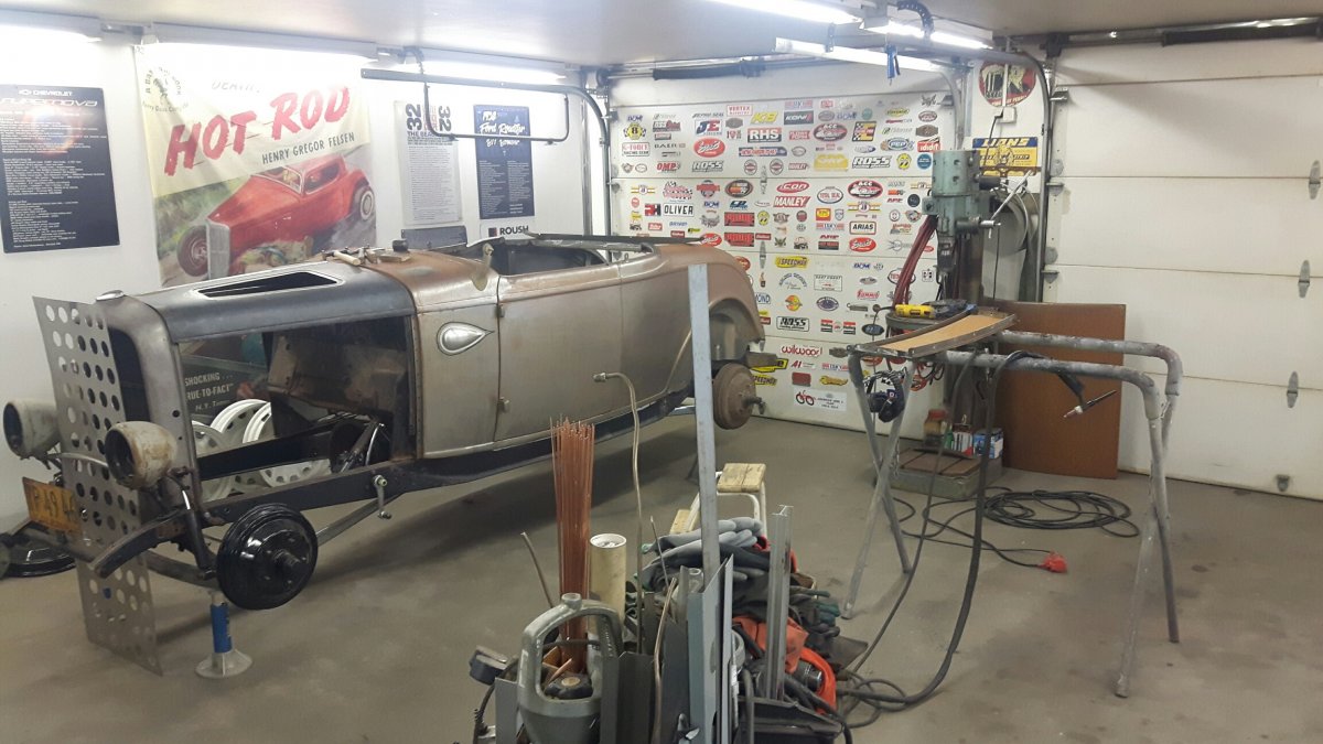

    I sure hope you have some strong arm friends to help you move these items around as they are more than enough to cripple a healthy back and more...
    I suspect a man as mechanically astute as you, moving stuff around is just another extension of same using dollies, block and tackles, straps, hoists and careful planning...

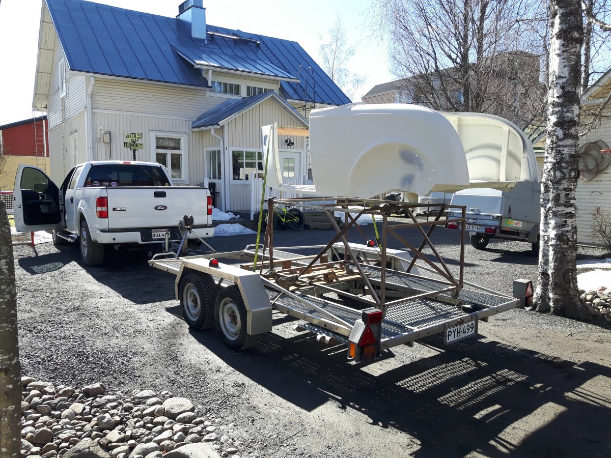

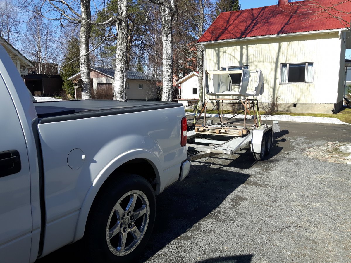

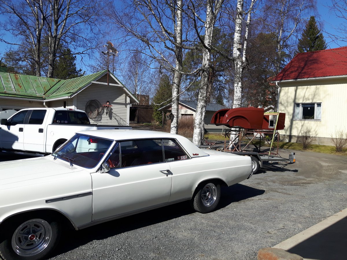

    Few days ago I tow body to my friend´s car painting company.
    Aulis

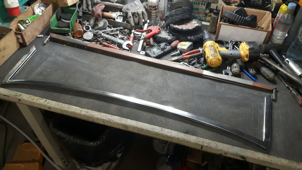

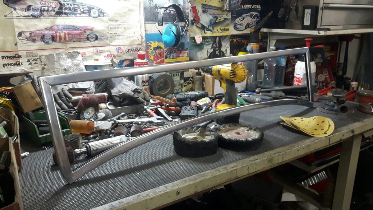

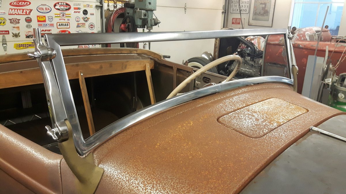

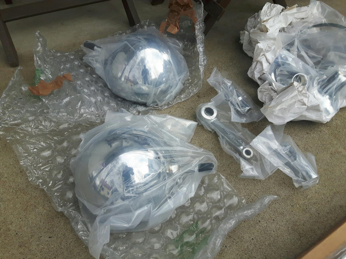

    Today arrived come stuff from DalaKrom Ab , Borlänge Sweden. Micke has done again great job. I finished own parts ready for copper and crome. 1935 pick up headlights, headlightstands and horns were rough. They removed crome, made basics and now those are like brand new.
    For me only +3" chopped windshield frame, draglink, draglink ends and pitman arm.
    It was small Christmas for me.

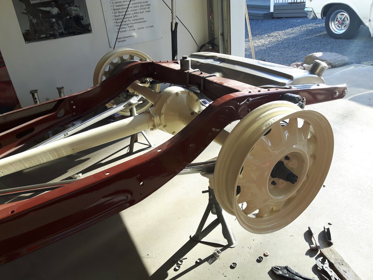

    Today only sanded down firewall, steering columntube and fixed another 1932 ford rear shock. It was leak heavily, so I welded and lathe shock valvetap, sealed it with new o-rings etc.
    Tomorrow, Thursday, I will paint rearaxle+driveshaft, firewall and tranny
    Aulis

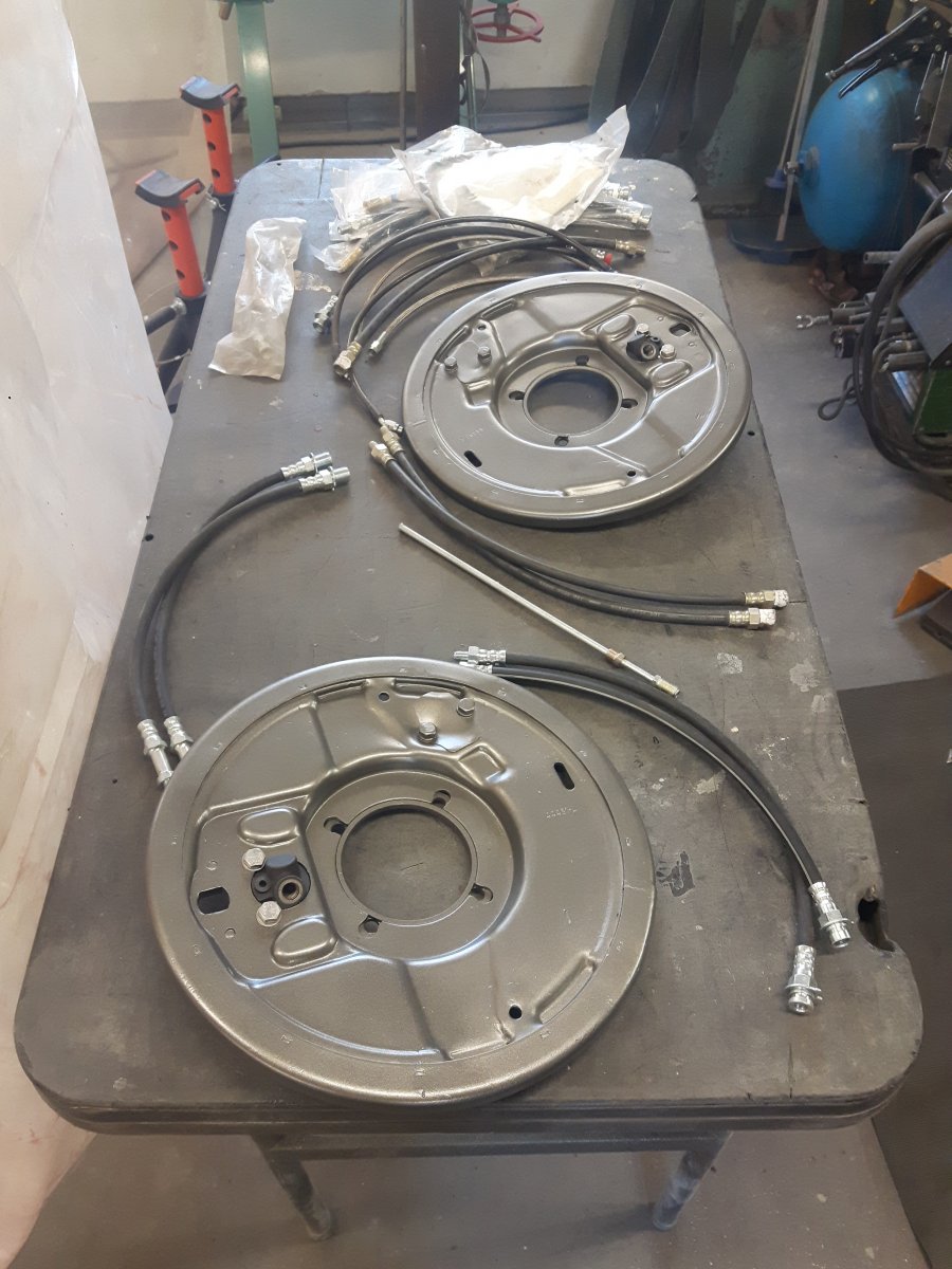

    More painted parts.

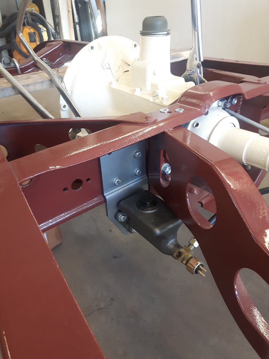

    Mainbrakecylinder bracket arrived from California.
    Only $40 + sh, good price.
    aulis

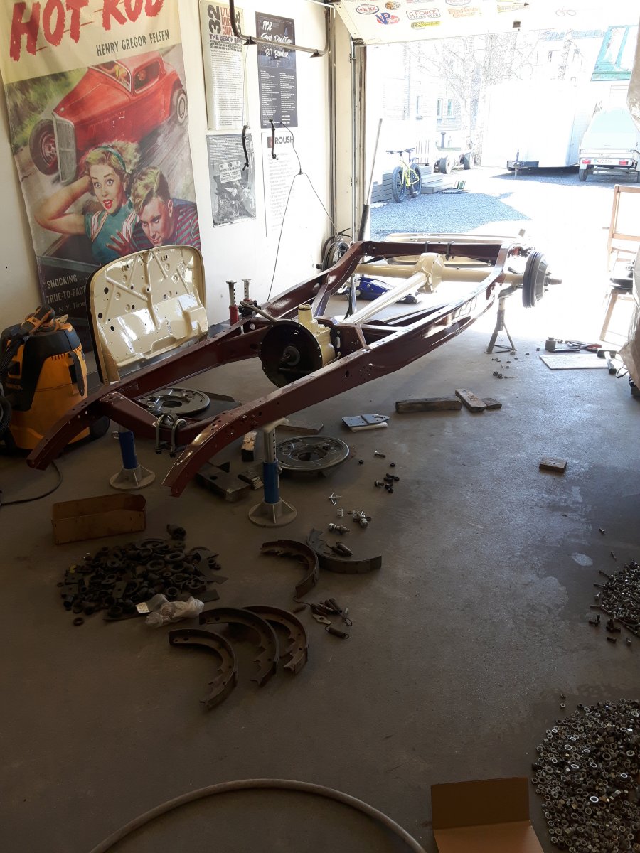

    Friday was bolt on day.
    Aulis
    stoker-576.jpg stoker-577.jpg stoker-578.jpg stoker-579.jpg stoker-580.jpg stoker-581.jpg stoker-582.jpg stoker-584.jpg stoker-585.jpg

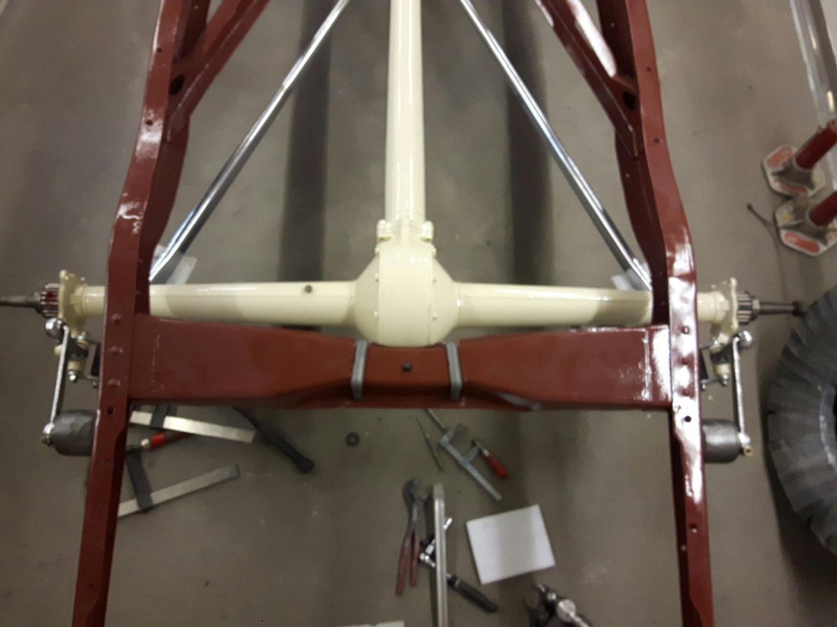

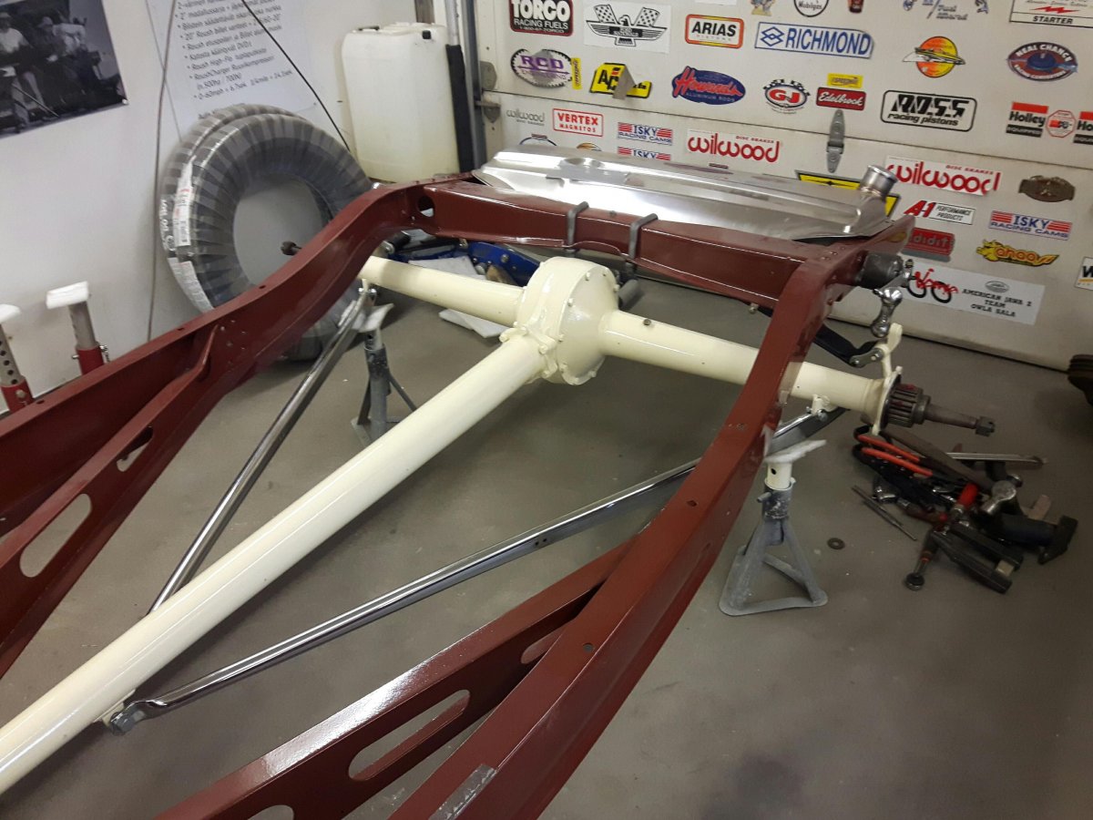

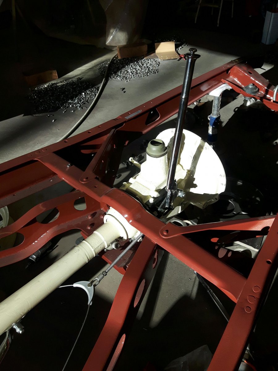

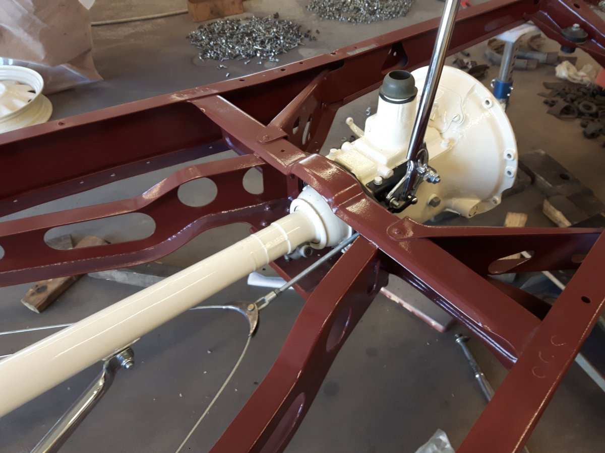

    Tranny, rear speader bar ...installed.
    Tank need to remove once more and polish it.
    I have drilled 2,5mm deep notches (driveshaft tube and rear axle) for brake line. Maybe now good situation to install brake lines. I found one rear brakeline set, but that is mean to follow wishbones, so cant use that.
    I think my friend has not spray yet empty body. That is good, because I have so much things to do with frame, brakes, axles... 20210410_102917.jpg

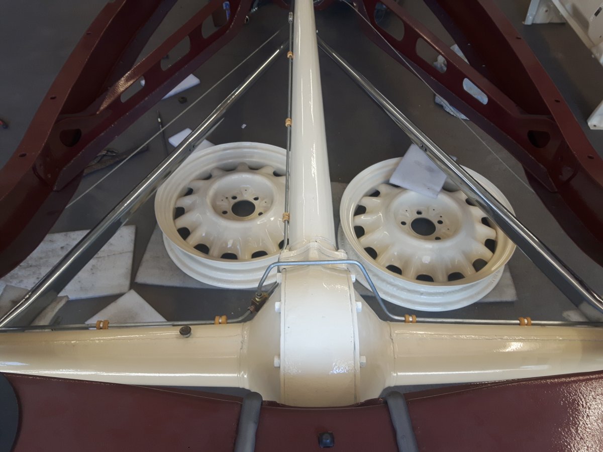

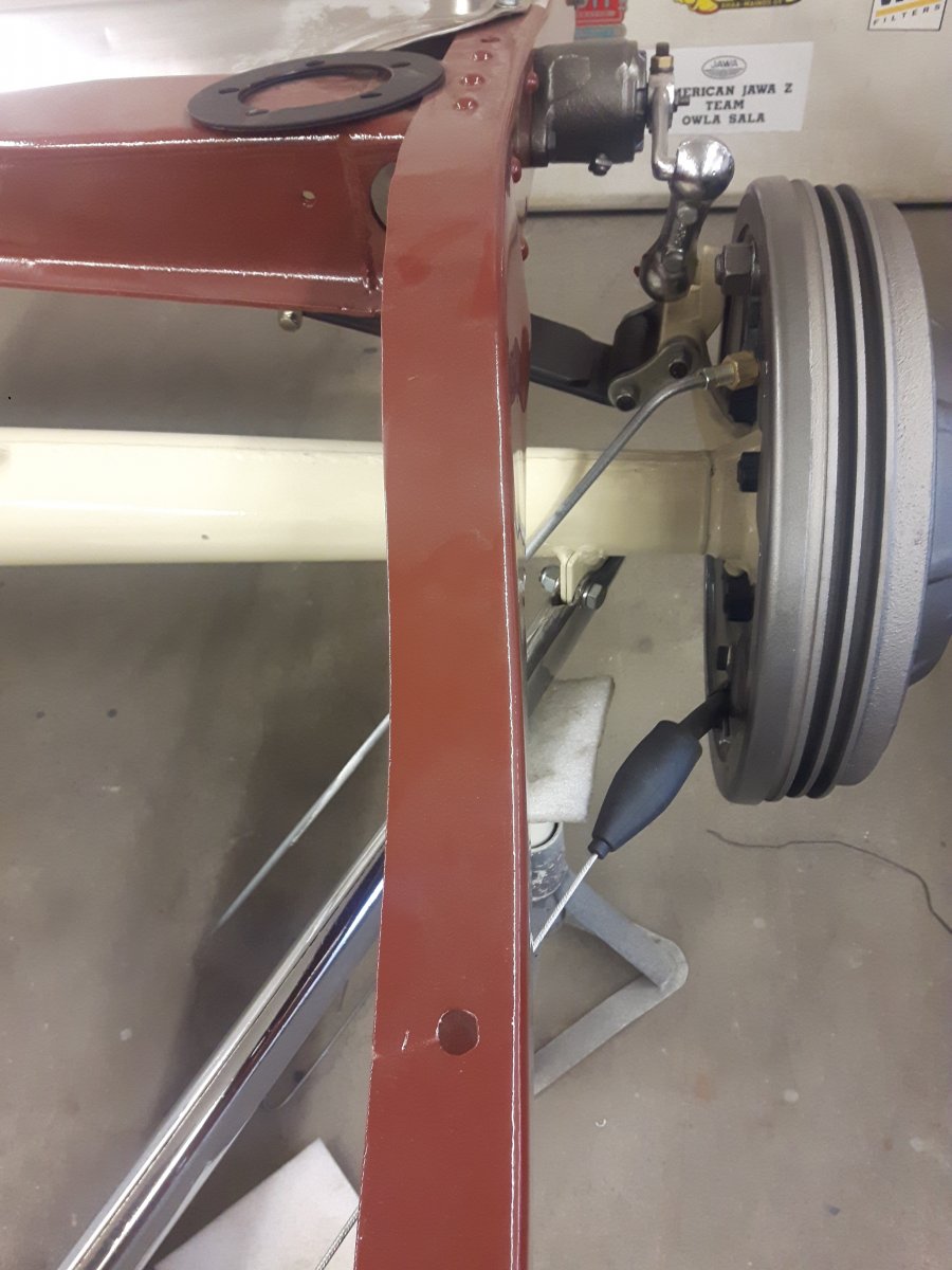

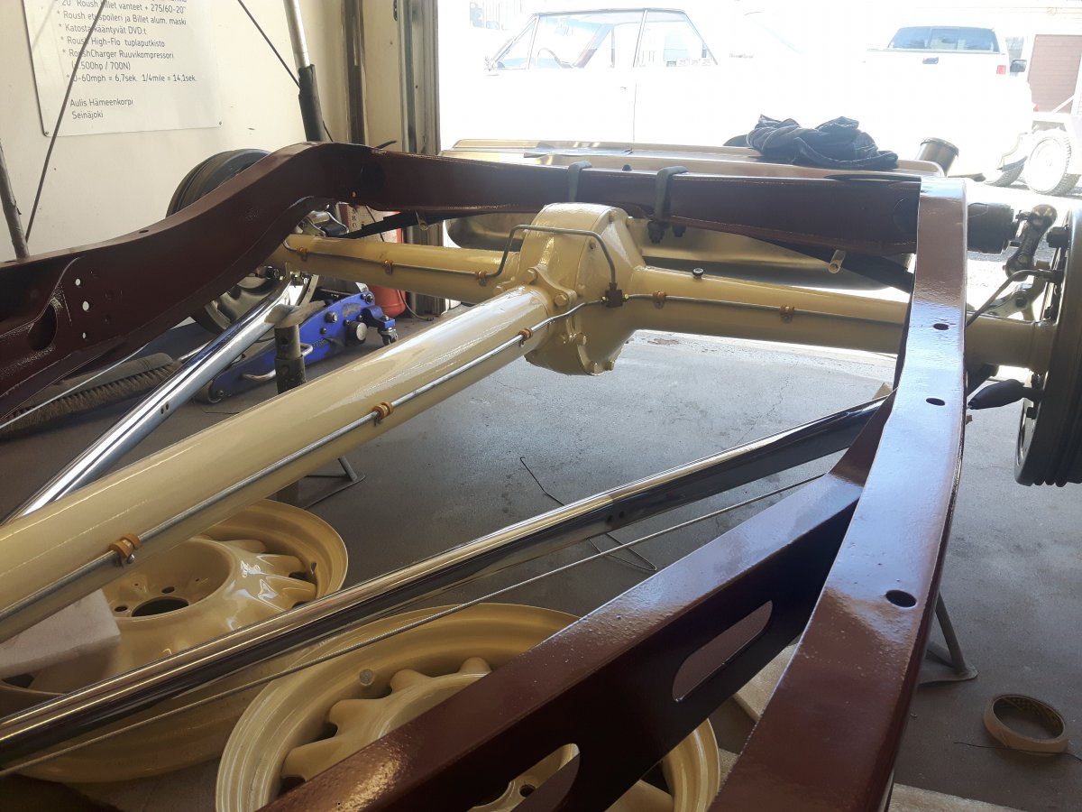

    This week has been too busy. No time to built hot rod... Dayjob is "bottleneck".

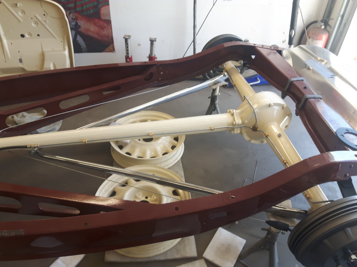

    Today I installed rear backing plates, shoes etc inside of drums. Also drums installed with new snaprings and seals.
    First time wheels there bolted on.
    Tomorrow I polish fuel tank, install emergency brake cable, handle,...
    Tomorrow , Friday evening, my friend is spray basic body. I pick it up home on Saturday. same time we put it on its place.
    Aulis

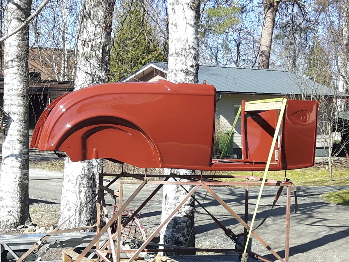

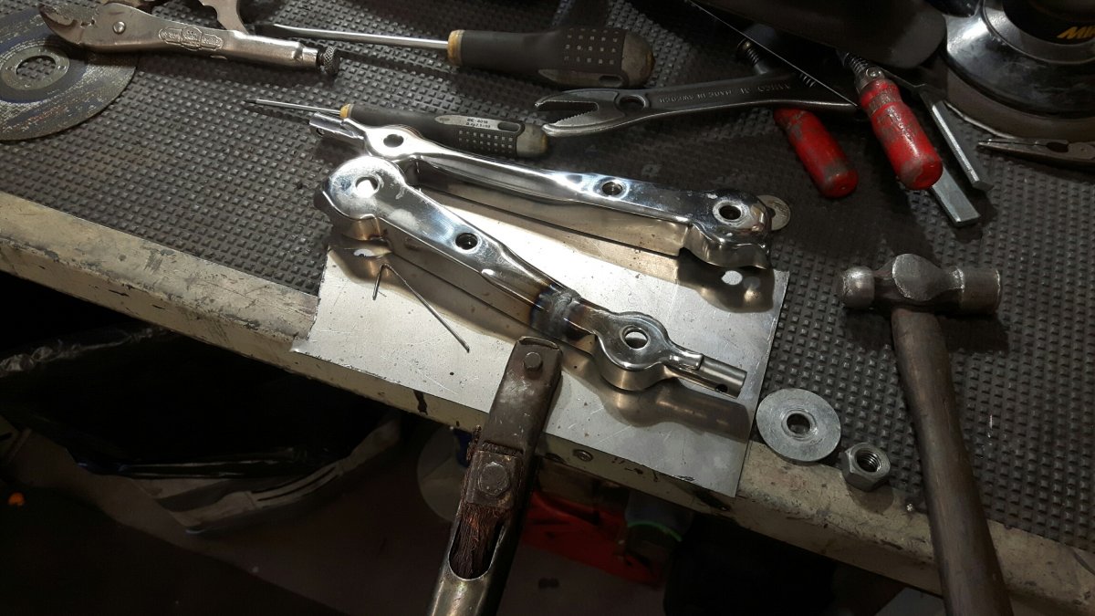

    Yesterday, Friday, I made handbrake. Late 30´s lincoln bendix brakes, 1939-40 cable, homemade rod, old rod ends, new cromed handle and homemade handle bracket. Now works like "old train toilet" (only hole behind trottle).
    Today picked up body from my friend´s car painting company. I like.
    pictures posted later
    Aulis stoker-589.jpg stoker-590.jpg View attachment 5037285 stoker-592.jpg stoker-593.jpg

    Saturday morning I carry empty body home.
    Next week will put in on frame.
    aulis
    stoker-594.jpg stoker-595.jpg stoker-596.jpg stoker-597.jpg stoker-598.jpg stoker-599.jpg stoker-600.jpg

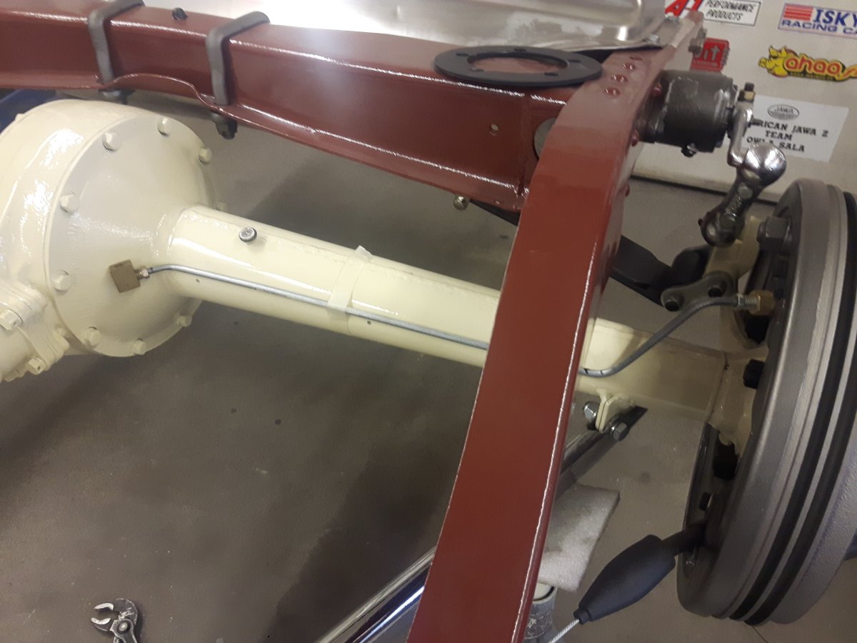

    Today I installed brakecylinder and bracket, made brakelines from wheelcylinders front to main clinder.
    I used old aircraft clips for brakeline mounting.

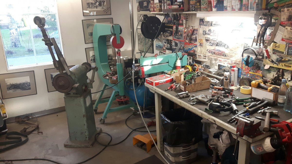

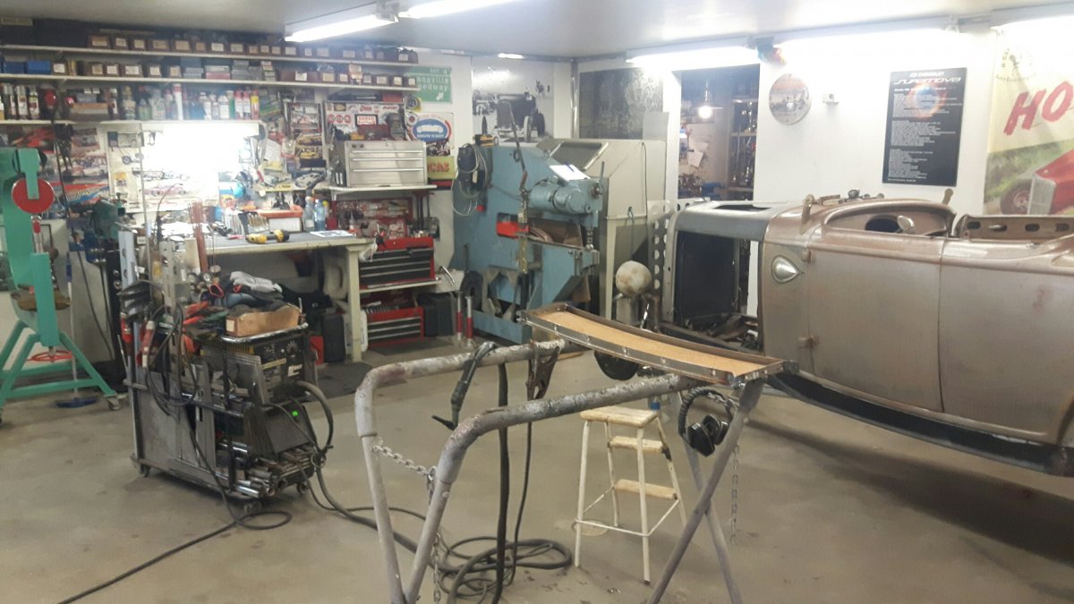

    old hickory
    nice workspace.
