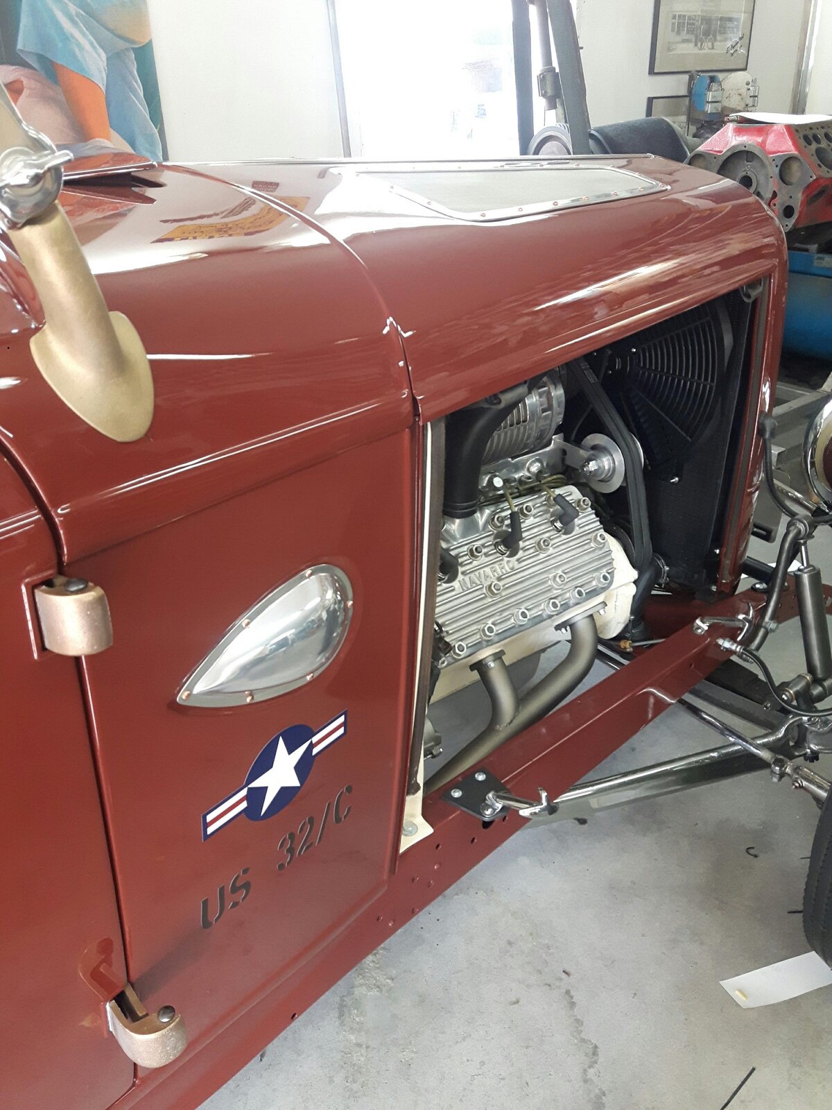

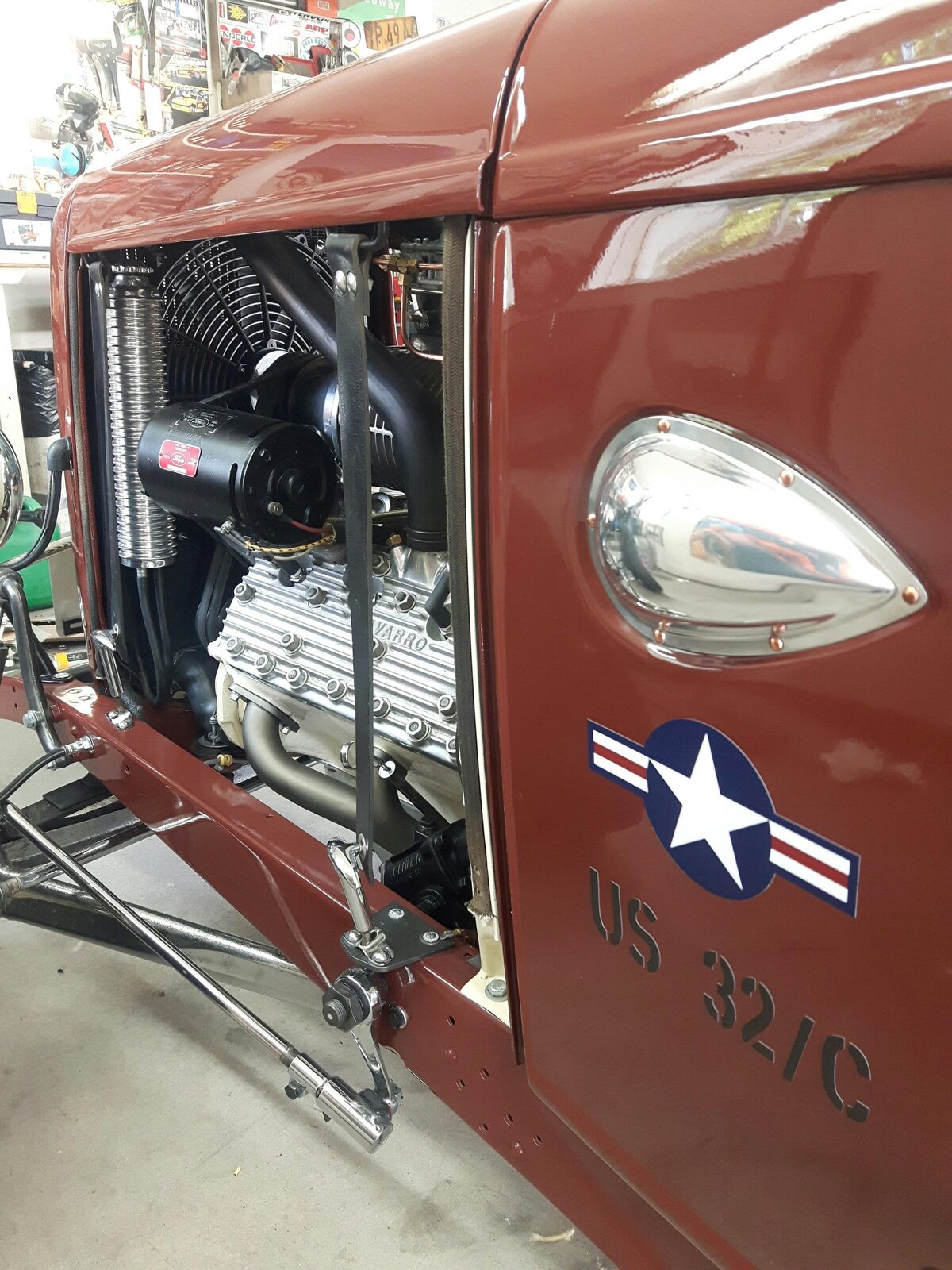

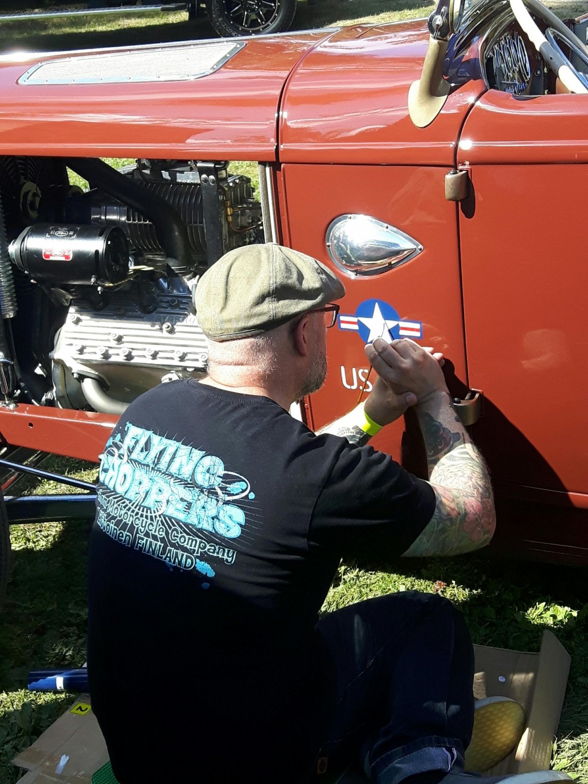

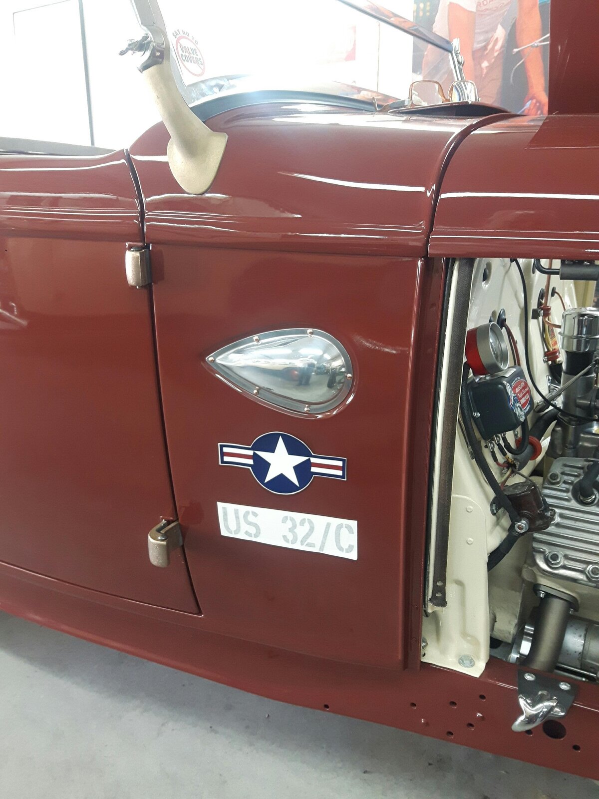

    Today I installe 16" electric fan. Now its Street Rod... :oops:
    Walker Radiator is sailing on Atlantic sea. They told me, container arrive to Finland 7th of July.
    Few sticker installed too. Engine sound is not good high Rpm,... Tomorrow I open carbs and check that both are OK and maybe change bigger jets. Feels that engine needs more fuel. Tune up is what I like. Yesterday I changed another magneto cap.
    My friend owns Ahaa -advertising agency (www.ahaa.fi). I send them samples what I want and owner Mickey made some stickers to this car. Earlier he has made for example auliz stickers (trailer, small stickers) etc....
    Stickers installed. If not good idea -> easy remove. Old US Airforce star, etc....
    Aulis

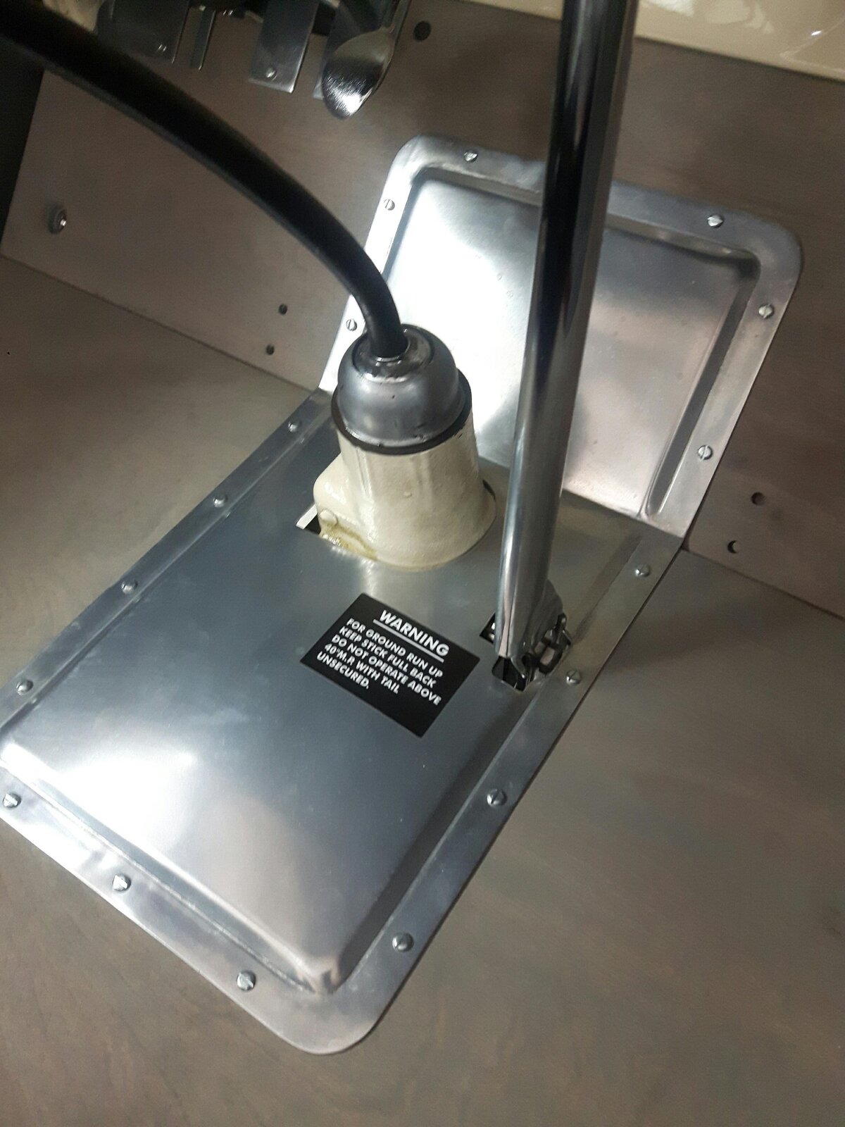

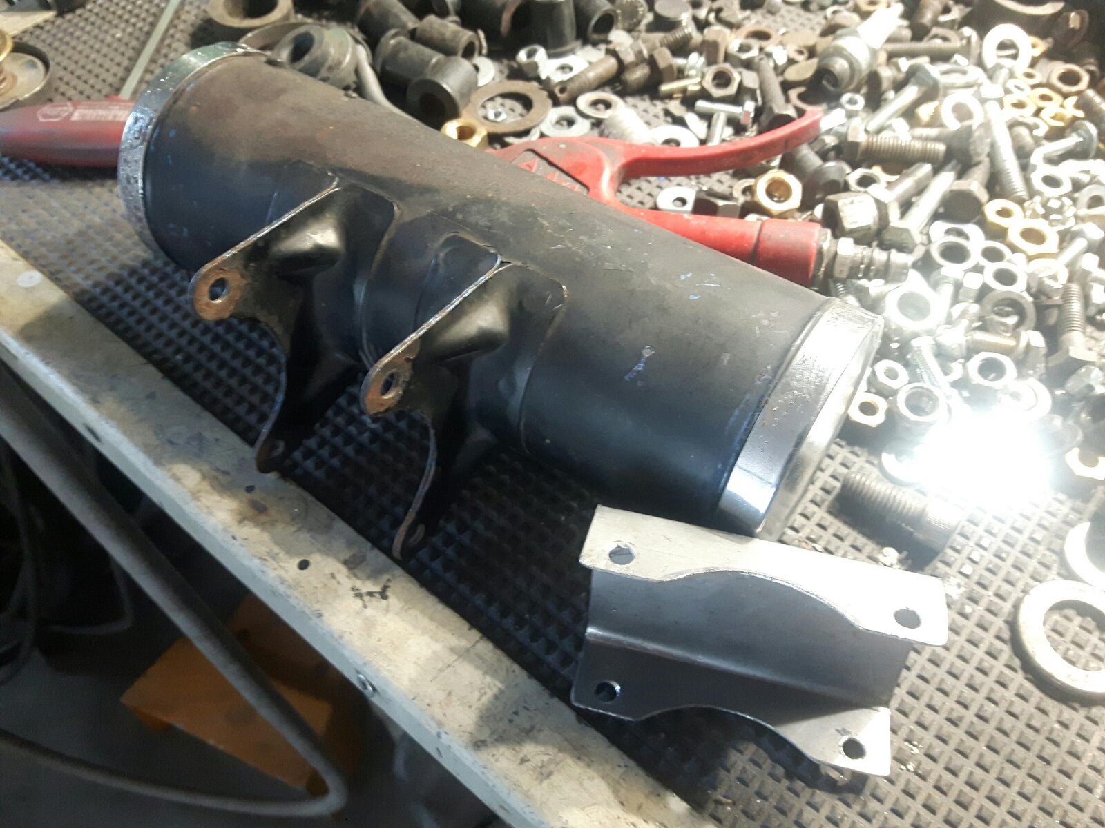

    Today, Sunday, I continue doing small things. I found old round tool box, which I basted with glass and installed with homemade bracket on cabin floor.
    Also installed new USB output to battery bracket, if need to charge phone etc.
    Can leave phone in bag on trunk and charge there.
    This week I take longer trip with this Roadster. I drive up to Oulu city (350km) see my friends.

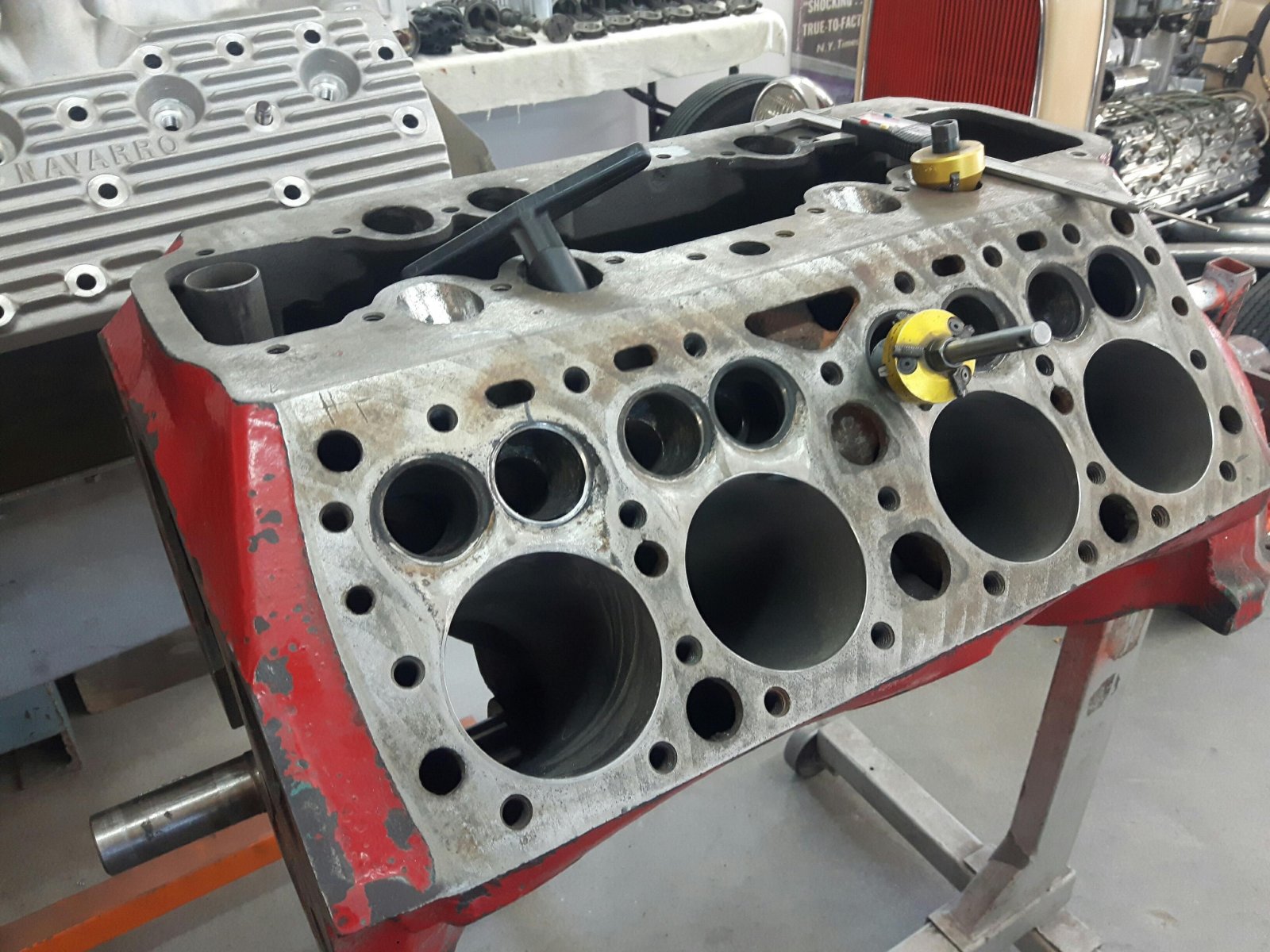

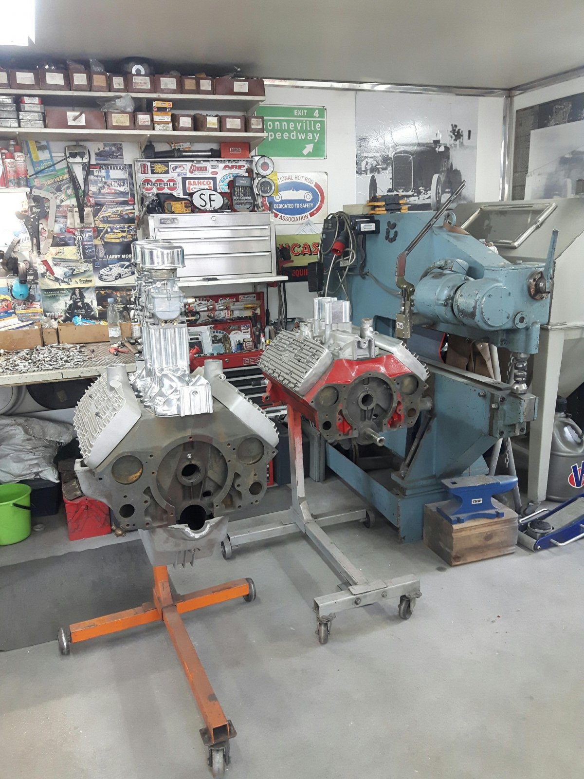

    1) 296cid 59A Roadster engine. all ready balanced, runners are big, seats are big,.. just need to make valvejobs, wash and put together. Navarro heads, Navarro intake, Ross, Scat rods, 1.60" ss valves, G-185 valves, Harman collins magneto (just recoiled), Winfield SU1 cam, Schiefer alum. flywheel, Alum. oilpan, 2 x 97....
    2) 239 +060 59A engine is for sale. 030 pistons, rings, 8BA rods and bearings. I have grinded crank over (010/010), L100 cam, 1.50 ss valves, G-185 springs, Edelbrock very high compression heads, polished china intake, 2 x 2bbl, Vertex or Cirello magneto which I will modify to 8BA style, steel oilpan.
    Slowly looking for parts ready on tables.

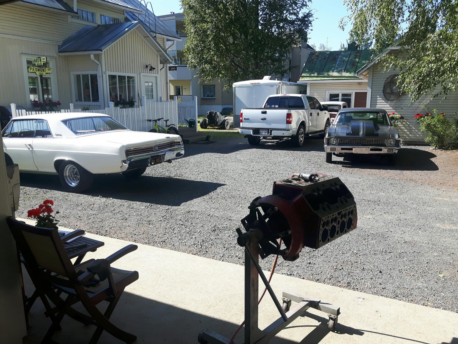

    Cheers from Finland
    Covid is strong again. Is it 3rd or 4rd "elimination" round going on,.... I have get both shot, so I can travel for example to Estonia, Sweden without any 2 week quarantine. This weekend they have bigger drag race competition in Tierp Arena in Sweden, but I pass it.
    Last weekend we drive +600km (400miles) with my girlfriend. Nice meeting in Luvia, Fin. Rods, Am.cars, Harleys... Roadster works OK. Now can drive 60mph (100kmh) speed without problems, thanks top quality and not leak radiator. Still had small problem with two cylinder. Spark plugs are darker, even wet. Yesterday I made again compression testing. She push starter button and I used 50-60y old compression tester gauge. Result is not right, because I have superhcarger between intake runners and carburetors even I fasten trottles open. I was check that result between cylinders are nearly same.
    Gauge show result 90-100 all cylinders. With open intake flow result is much more bigger, but I do not need that result. After testing I was sure that piston rings, valves are OK. I removed Harman & Collins magneto cap. I foud there two nearly 1" long crack. Those cracks were located bottom of cap (cylinders 4 and 8). cylinder 8 has not worked right and cylinder spark plug has been also darker. I found good old distributor cap and changed it. Now exhaust heat is OK also cylinder 8 which was all the time 50% of other cylinders. Infrared thermometer is very good tool when fire up race engine, test and tune old engine.... Now a days those are not expensive (+- 20usd/euro).
    Yesterday I started to built 59A +030 engine. This engine I will sell when its ready. I have grinded crank to 010/010. Installed sleeve to 3cylinder. I will use 8BA rods, 59A pistons, new clevite bearings, F-100 hot rod cam, Johnson style lifters, SS valves, Edelbrock Hi-comp heads, Chinamade polished intake, Carb raisers, 2 x holley 94, BBC vertex magneto + 8ba front cover, steel oil pan (Industrial model -> long deep sump).
    Yesterday I fixed 3 cylindersleeve top and removed steel/cast iron from seatrings and runners. New SS valves are bigger 1.55" size. Seat rings must make bigger approx 0.10" (2.5mm). 5hours and I get ready another side of engine. Runners, valvejobs. I make 3 angle (60dec / 46dec / 15dec).
    Aulis
    stoker-832.jpg stoker-833.jpg stoker-835.jpg stoker-836.jpg stoker-837.jpg stoker-838.jpg stoker-839.jpg stoker-840.jpg stoker-842.jpg stoker-843.jpg stoker-844.jpg
