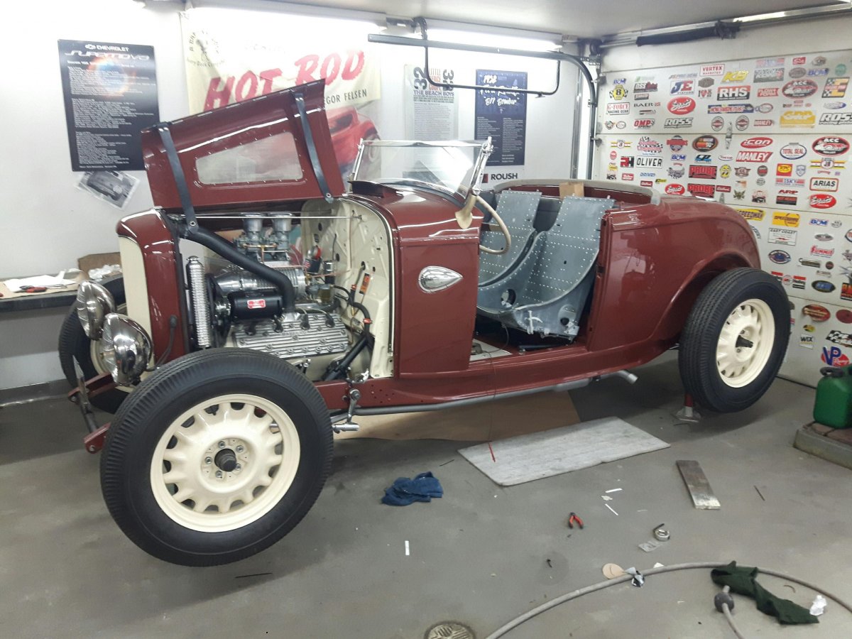

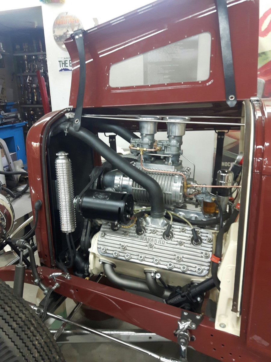

    Today polished headlight bar center and painted ends. Bar is old hot rod style and made using original 1932 headlight bar.
    I increased fuel in tank. I had only 4litre 98oct , so I increased 3litre more VP 116 racing fuel. Changed oil and fired up. Engine sounds good with those exhaust. Loud pipes.
    Saturday morning, when crew chief Oskar is still sleeping, I go there and start hammer and polish those original 1932 headlights. I decided, I install first those original headlight until 7" size lights are customized, welded and painted.

    Today I made all front wirings ready. Also made 1/4" tube to fuel press gauge on dash.
    Old style 12V 50W/32W headlight pulbs not found from here. I had only one here. From Sweden (Dalhems) found those and ordered. I like those, because not too bright than Halogen etc...
    Engine runs OK. Another waterpump is leak. Maybe I need to piece it, make machinery jobs and install new "coal seal" there. Those old truck pumps are not good, but not have any 100% rebuilt on stock. One day job to make rebuilding.
    Tomorrow I need to buy 14-15" electric fan and install it. I know that it will be needed with supercharger engine.
    After fixed wirings under dash I can put together interior, doors... Draglink, Tie rod need to tight and increase cottered pins etc. and many many small things before test drive.

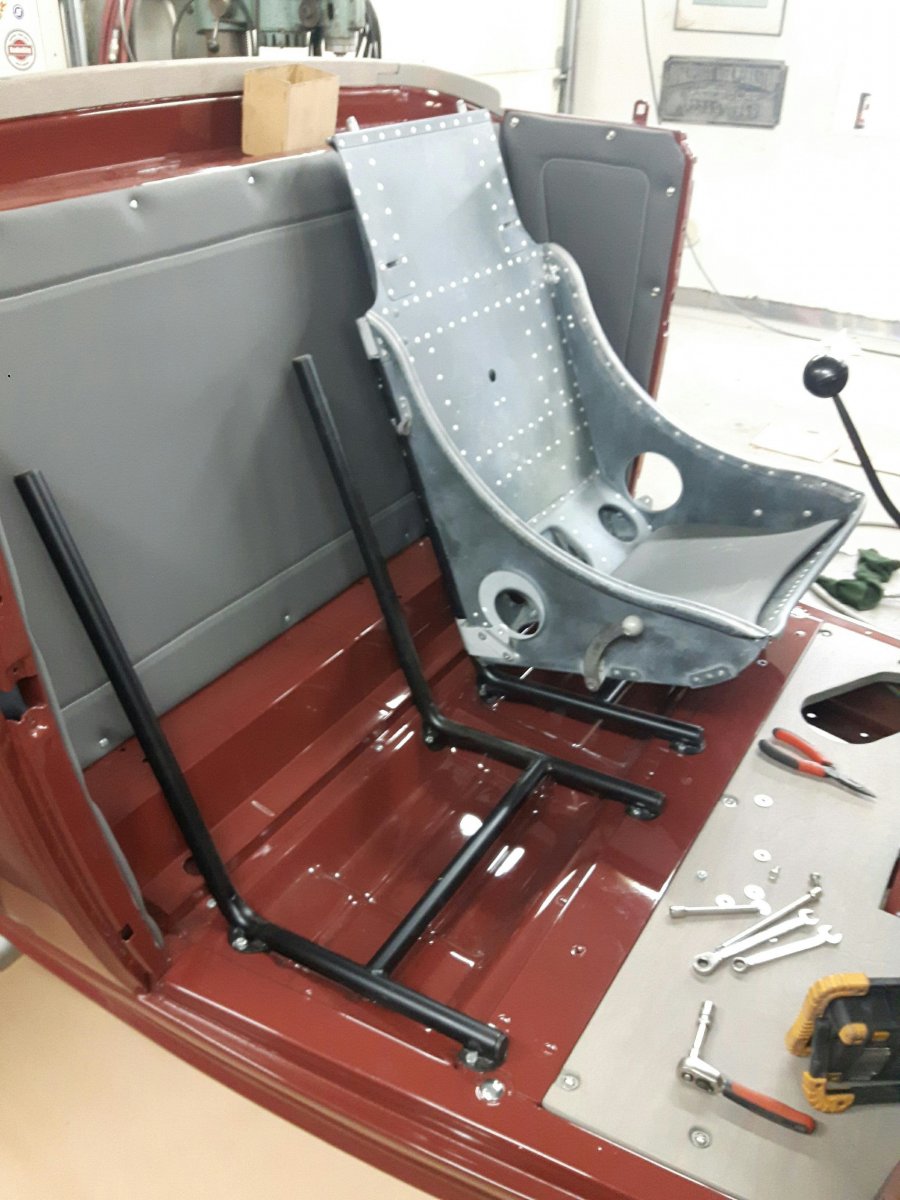

    Yesterday I installed overflowtank. Also adjust brakeshoes and bleed brakes.
    Today I fasten wirings under dash, installed kickpanels. Seatframes are bolted on.
    Tomorrow continue with doors and maybe take first testdrive if this windy "small storm" is over.
    Aulis

    Yesterday i was opened harman collins magneto. once year need to fix it. surfaces are oxidized.
    Same time changed new autolite spark plugs. I was take ride 60-70mpl (100-115kmh). I have problem with radiator. Nice nearly 100% condition but very old brass radiator. That is not enough for supercharger engine.
    Im waiting for that Walker , which I bough from US, is arrive to Finland. New Walker has maybe over 50% cooling area bethween 4row pipes. I have note earlier that its enough. While I need to install 16" electric fan inside of radiator. Looks terrible, but I have there already one extra cloth wire. Today I install fan and one relay next to fan. One wire from dash is needed to ground relay.
    Two pics shot by professional photographer Pauli Pirskanen
    Aulis
