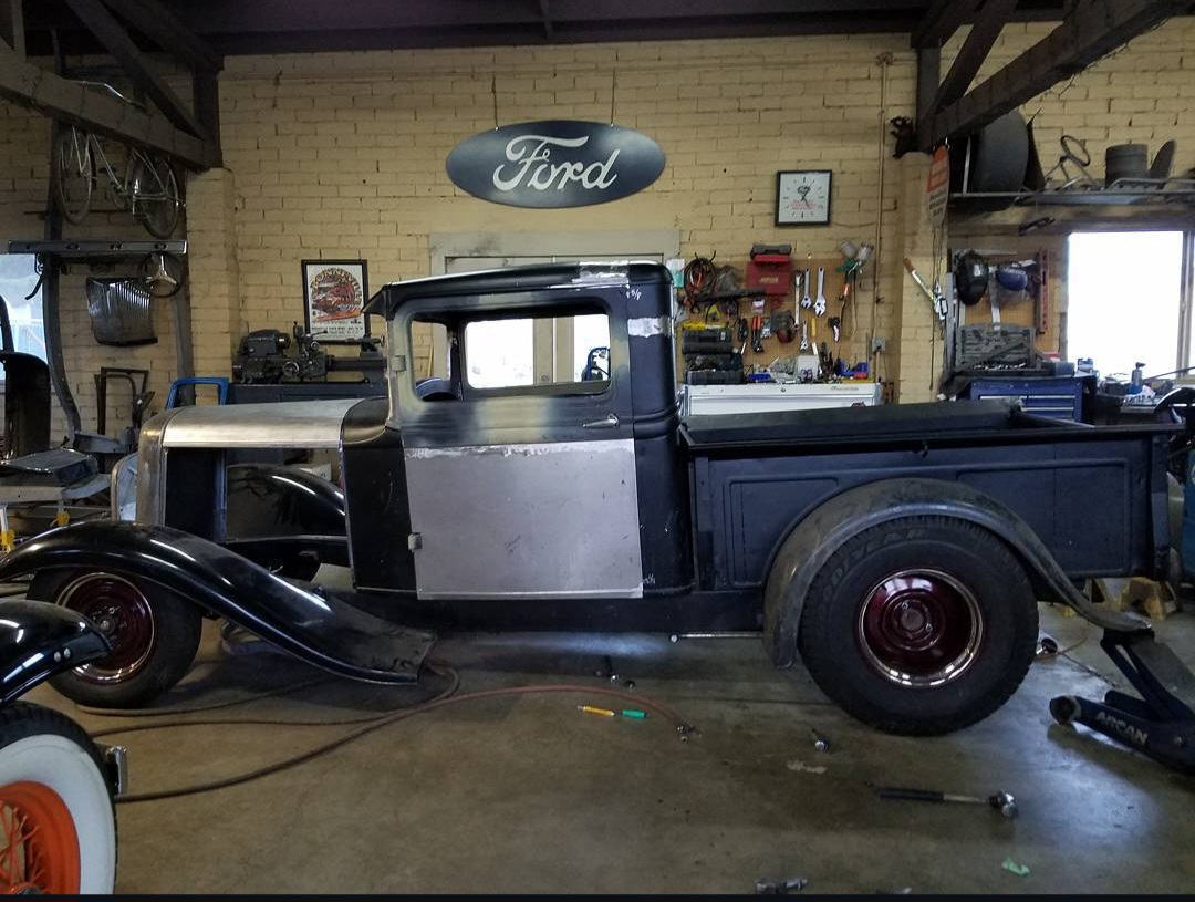

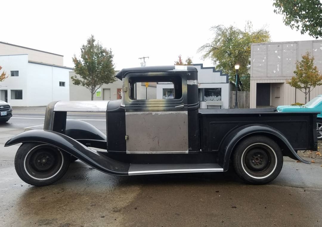

  12. I'll try to dig some pics up of a full fendered 32 pickup that was extended in the middle of the doors a friend or mine built. It's still in bare metal mock up stage. It was very suttle!
    *edit, here ya go. Stretched 4" and chopped 3"
    Fogger, Kiwi 4d, Hotrodmyk and 7 others like this.

  14. Bandit Billy
    Joined: Sep 16, 2014
    Posts: 14,365
    Bandit Billy
    Where did the 3" go? Shorten the bed?
  15. looks like the frame was also stretched in the middle based on the lower pic with running boards and that the front of the box to rear fender stayed the same.
    Bandit Billy likes this.
  16. Bandit Billy
    Posts: 14,365
    Bandit Billy
    Yep, now that you mention it I can't stop looking at it.

  18. ***Area-51***
    Joined: Mar 25, 2005
    Posts: 852
    ***Area-51***
    from Ohio
  19. Both pics are of same truck not a "before and after" its been a few years ago but from what I remember the frame wasn't stretched, the bed was shortened. Unfortunately I can't find anymore pics of it, the pickup is still unfinished sitting at a different person's shop for the past 4 years.
  20. Looking at it more, I think its a 32 Box on a 33/34 Ford frame, but the box has not been modified as it would need to be shortened in the front. The 32 box has a shorter "gap" between the back of the cab and then the rear fender vs a 33/34 pickup. I also dont see the lip of the 32 frame beauty mark.
    32 Pickup:
    33/34 Pickup: 38174816822_2bedcef74d_k.jpg
    The 33/34 truck is my 33 pickup, the tail end of the box has been shortened but the front half it stock.
    akoutlaw, bschwoeble and 53olds like this.
