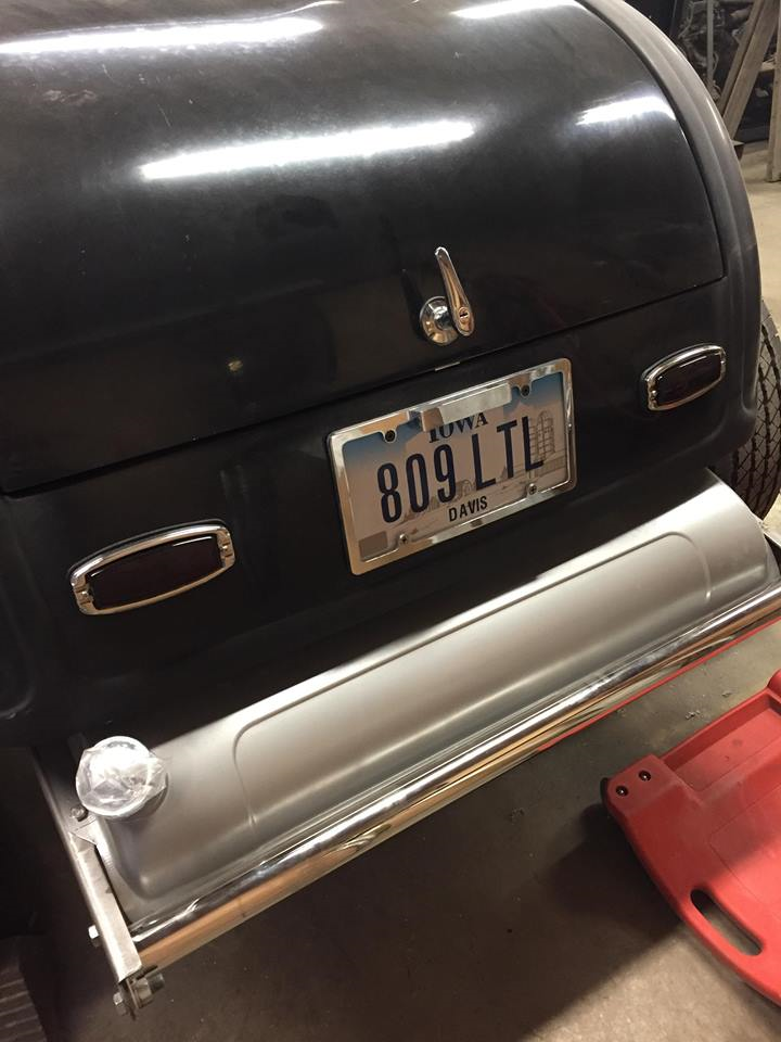

    Looks like a Tanks Inc normal gas tank cap that come on mine. Also bought my tank at Yogis.Still has the plastic on it in the pics.
    SPark
    Hamtown Al likes this.
