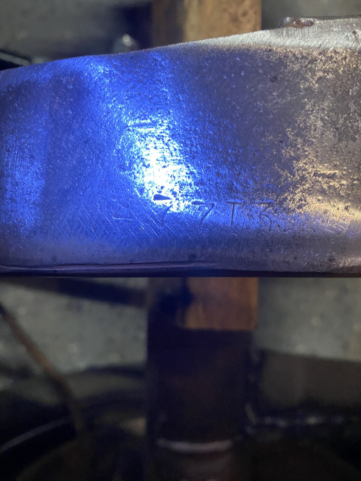

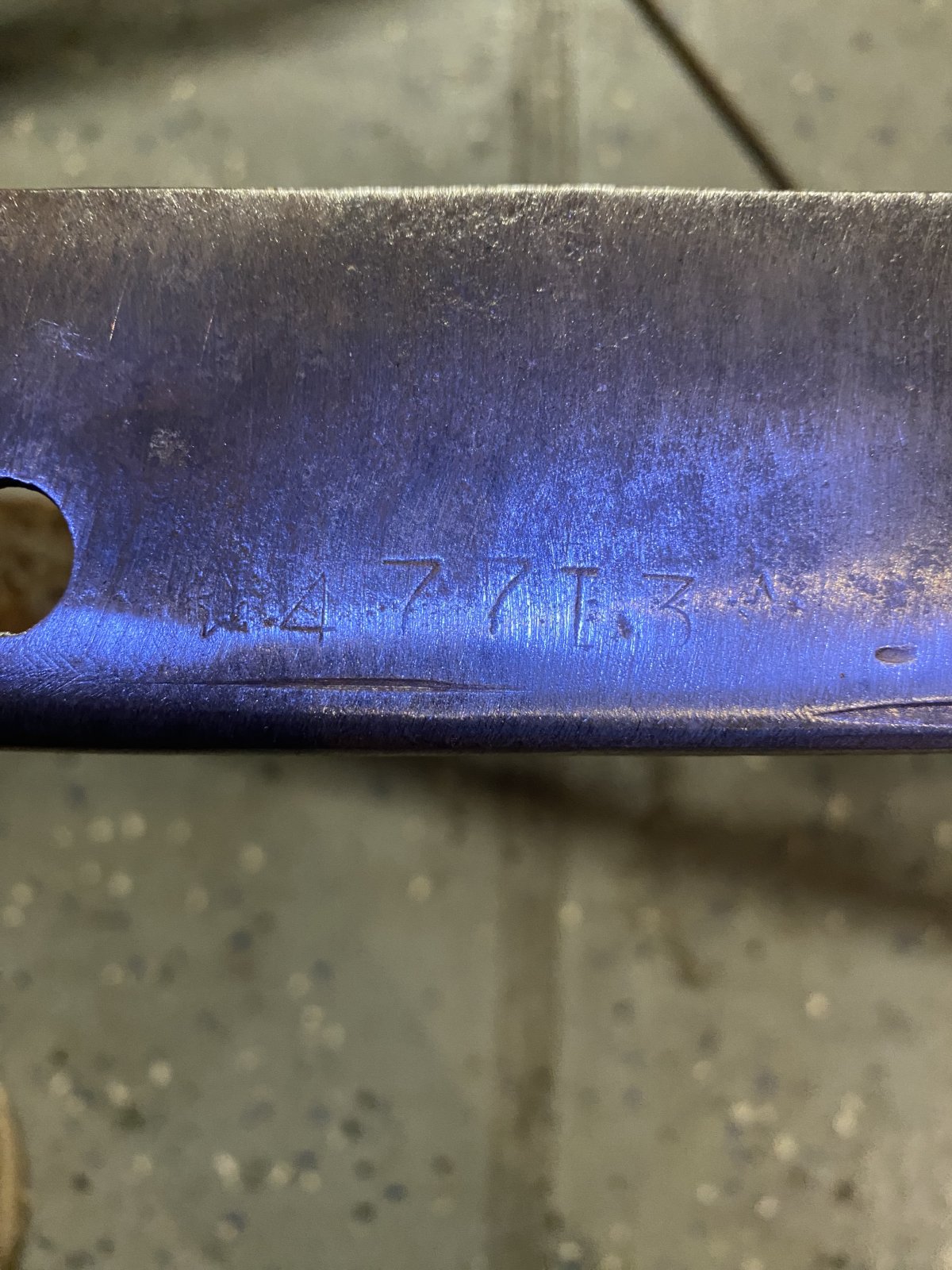

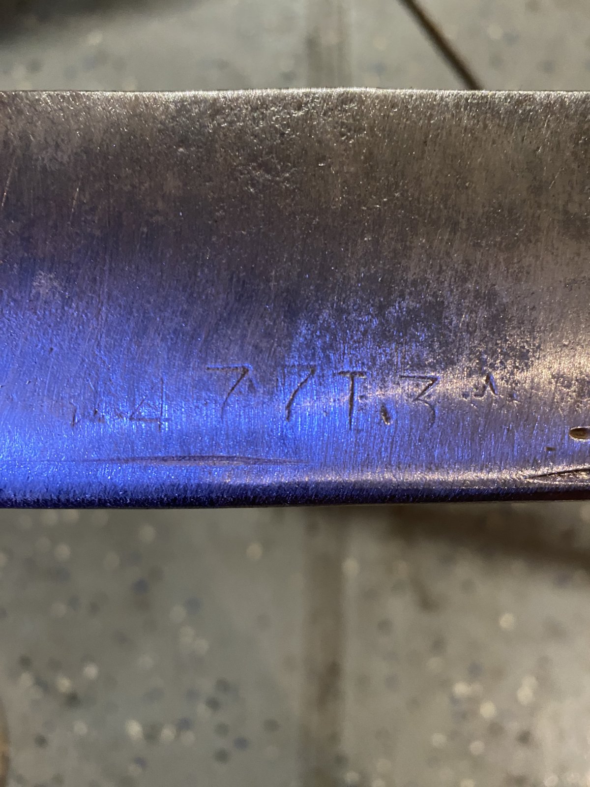

    I have a 1932 Ford frame that is stamped: 477I3 there are stats at the start and the end. I have not found anything that makes these numbers work for 1932. Any thoughts? The stars and numbers match the type of stamping a you’d see from that era.

    The letter I represents the number 1.
    Your serial number 47713 fits within the 1932 range.

    Obviously it has been tampered with. No 32 passenger frames had those numbers like that. Star stamps are easy to get. Just a made up number. I am 99.999 percent sure. You will get the same answer on the ford barn. From what I know all passenger frames started with a STAR then AB, B, or 18. Then production sequence numbers. Original numbers are in three places on top of the left frame rail. You might find them if you start stripping the top of the frame. Inside the firewall leg and half way back and on top of the rear hump.

    Is it the same number on all the correct spots on the frame?
  7. I had an original Ford frame(32) that had the star at beginning and end,but started with the letter F—-HAMB members said F was for right hand drive. 18 followed the F meaning v8. Number was F18xxxx. IMG_0296.jpeg
  8. The serial number was stamped at three places on the top of the left frame rail. Typically, the stamping near the firewall was the only one to get the 18- prefix or the B- prefix. The other two locations merely had the serial number with no prefix.

    Its stamped middle of the frame and the rear, near the hump of the rear axle. The cowl stamping I suspect is no longer visable due to cutting and splicing of old frame.

    If that's the number on the title.... Don't worry about it. If the numbers are stamped in the two other places ... Don't worry about it. Contrary to Ducendude statement there are lots of non standard numbers that have been reported.
    Imagine it's 1932, it was your birthday and you did some major partying over the weekend but you're a good employee and show up Monday to make your $5. Your head throbs everytime you swing that hammer. You drop the one and eight stamps, screw it, you continue to stamp until the line moves and you get a chance to pick them up.
    There was 31 assembly plants in the US alone. Lots of opportunities to mis-stamp that frame.

    Scott, Your number is most likely legit! A lot of the 32 frames I have had do not have the complete serial number in the middle and on the rear kick up. I have found this very common on 18- V8 frames. Your frame is most likely a V8 frame and the complete serial number would be *18-47713* If your cowl number was still intact I would bet that is what it had stamped on it. A lot of the time you will find the complete number in the middle location of the frame but not always. And almost always the rear location is missing the "18". Not sure why Ford did not stamp the complete serial numbers back there but thats what I have found over the years. Your number looks original and legit to me but If you want to look at and compare next time you are coming up my way I probably have 9 or 10 original 32 frames here you can look at.

    What makes me 99% sure your frame is a V8 frame is the prefix for the 4cyl cars was AB or just B and all 4cylinder 32's started with the number 5 and your first letter is clearly a 4
