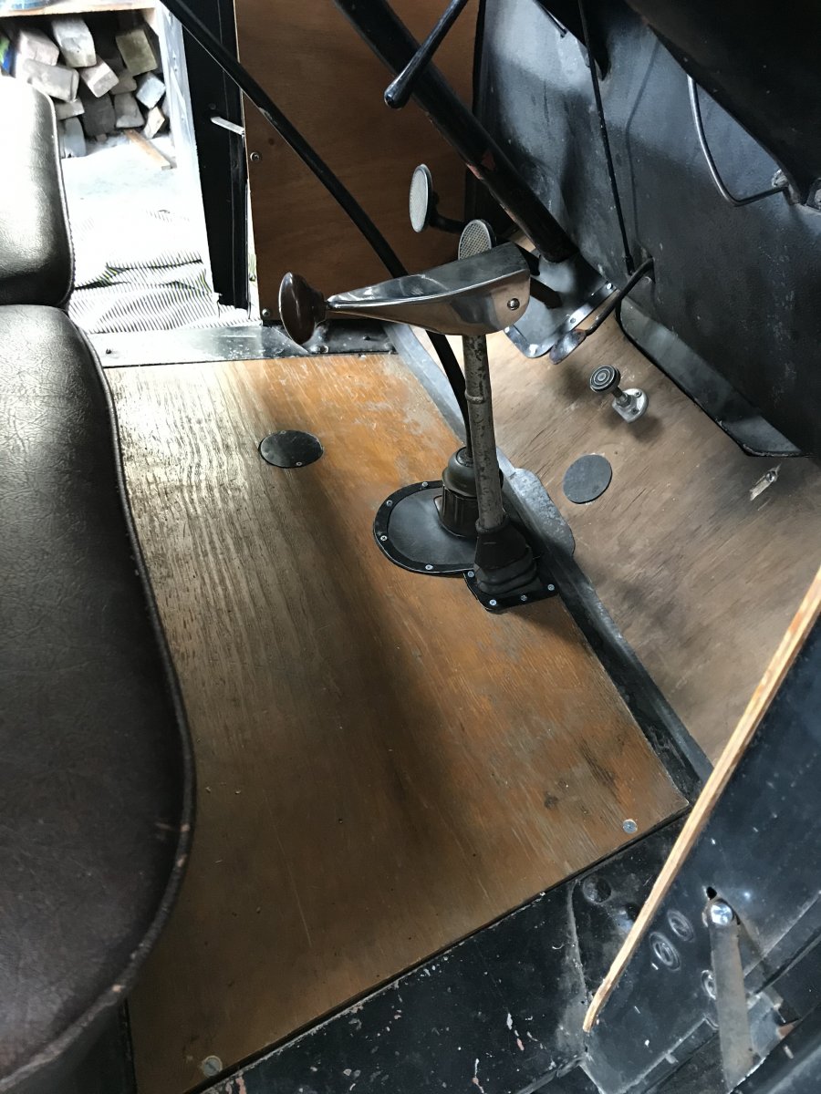

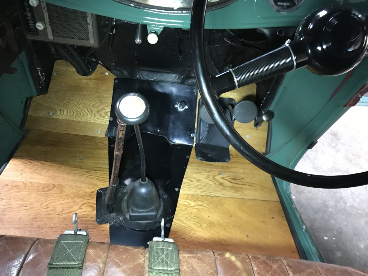

  13. Kiwi 4d
    Joined: Sep 16, 2006
    Posts: 3,172
    Kiwi 4d
    The 32 pickup still has the flat ply floor we inherited .It keeps our feet off the road.
    Slight tunnel in our green 32 coupe to clear the T5 and the F1 pedals . Not fancy but functional AFA01059-2241-4A28-86B1-7B0CD1417625.jpeg C04A80A3-A18D-4517-9974-3C30994EE240.jpeg

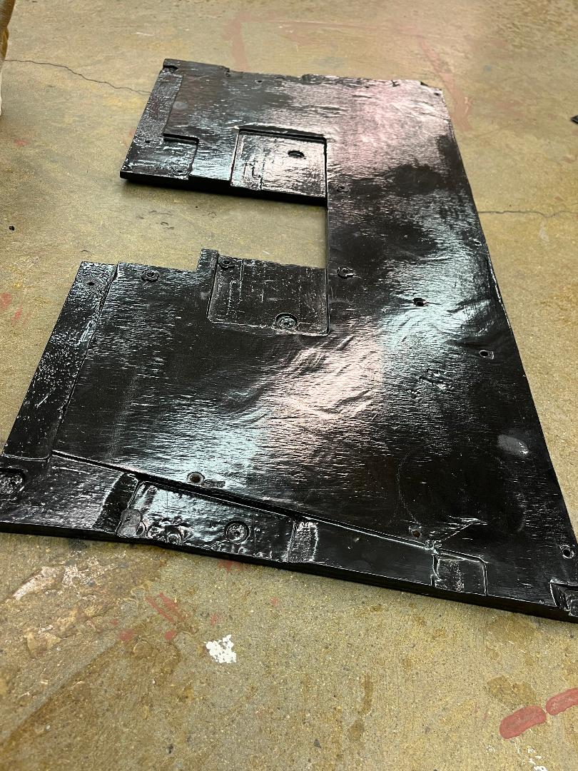

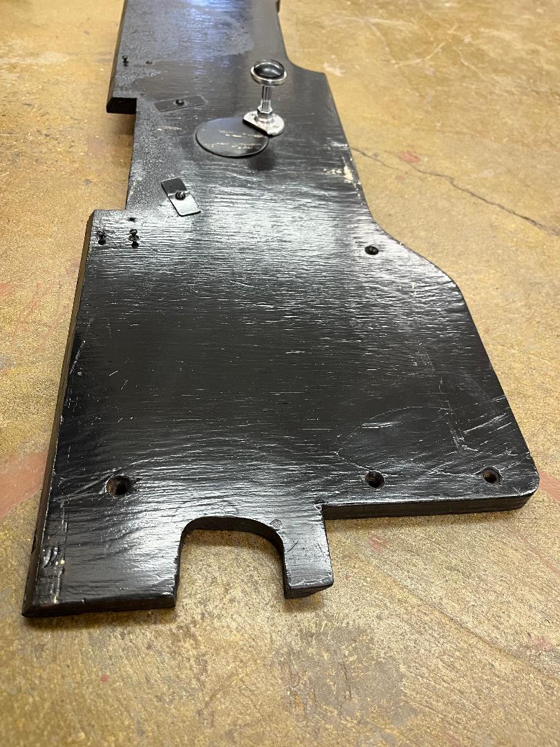

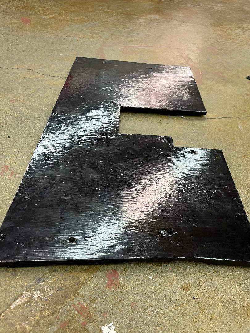

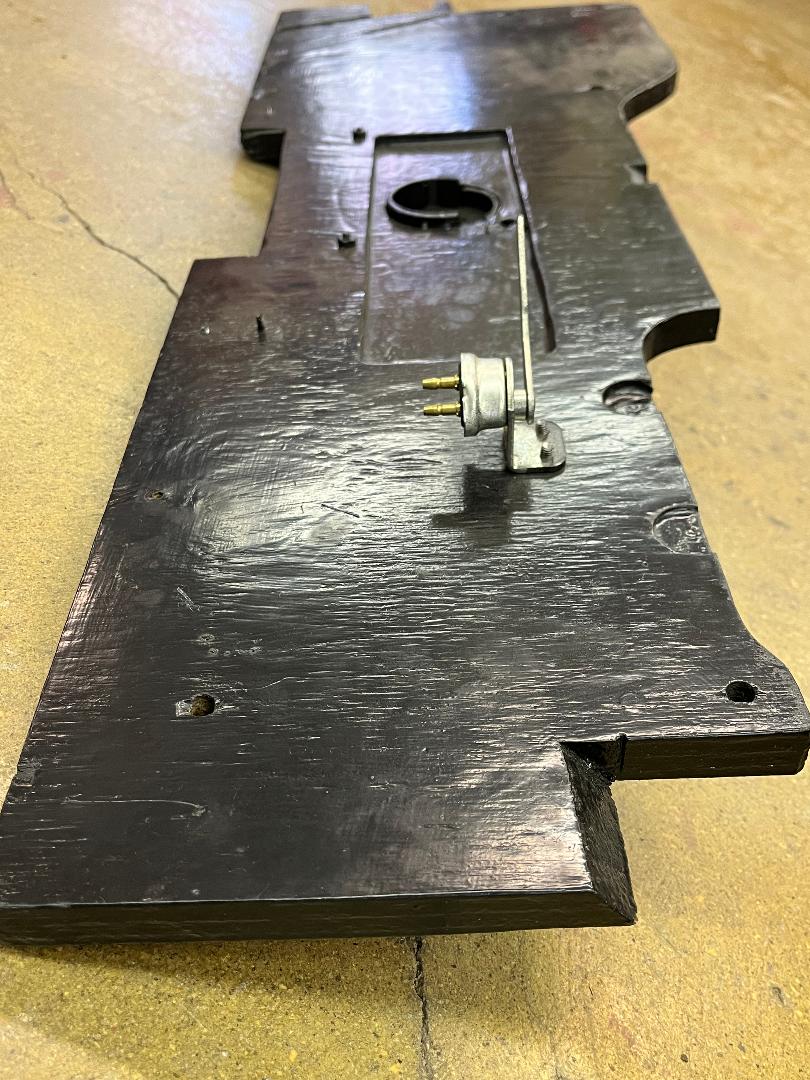

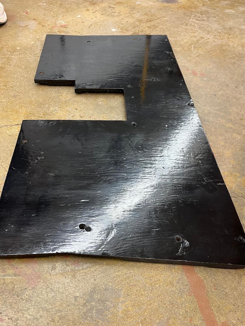

  14. dlw1932
    Joined: May 19, 2018
    Posts: 326
    dlw1932
    from Nebraska
    The boards I was making were made exactly like original except I deleted the oiler door hole required for an original 32 transmission and the original style carpet snap barrels (really hard to find). I had a friend CNC them so they were really precise and made from 13-ply marine Baltic birch plywood. They are actually quite complex and would be rather difficult to reproduce with hand tools, as they have several recesses on the underside for rivets, subrail laps, and the bellhousing. We quit doing them because they were a ton of work, and we had guys trying to negotiate our $185/set price. Maybe we'll do another run sometime if there is enough interest. Attached are some photos of the boards in my coupe. They are stout! IMG_2193.JPG IMG_2196.JPG
    dads32, teach'm, C69A and 3 others like this.
