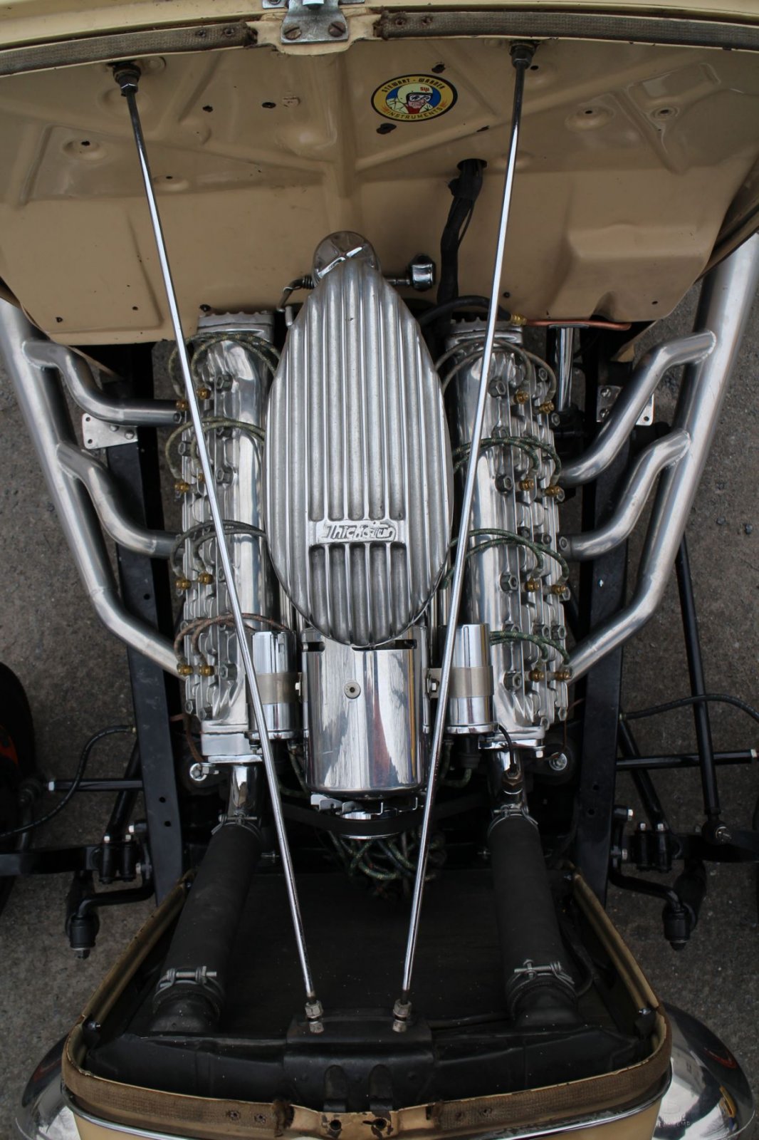

    Heres one I did a while back, it normally has a 1pc hood top on it. Blown BBC, 700R4, 9" ford rear, 4" drop heavy axle, the top was LaBaron
  2. AULIZ
    Joined: Oct 28, 2005
    Posts: 1,479
    AULIZ
    Hmmmm,.. BBC+8-71 blower,...You have 1100kg moonrocket !
    I have 409cid (425hp) in my 5w coupe and that is rather fast (high 11sec - low 12sec quarter mile), I suppose Your car can go high 10s. Lebaron top looks good and their quality is good. I have sold some their roadster tops and install one.
    Looks good.

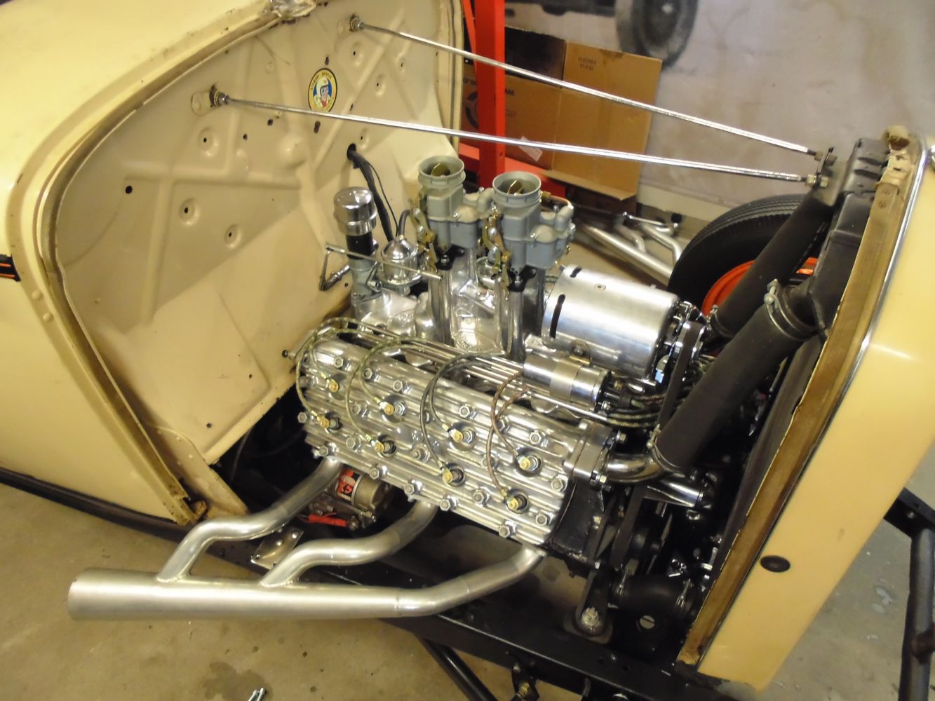

    Now 21stud Flathead works fine.
    -Heads: 2-3days measuring, machinery jobs. Headbolts not go anymore thru chambers.
    -last cam bearing was installed wrong. I turned it and now fuel pump rod is going its Place.
    -didn´t have enough long fuel pump rod, so made it. Maybe these old PM7 Thicksun intakes need extra long fuel pump rod, longer than found from cataloques.
    -Installed Howard 363 cam. and new Isky springs, c-lips, retainers and 7dec locks. Not anymore "coil blinds".
    -Im using 50s Champion LA 11 and LA 15 spark plugs (side Electron).
    -Changed straight lower radiator hoses to my own production S-curve hoses. Same time droped engine down 1/4" and still little too high (front), but not want to change original engine stands.
    -During winter I and my son Oscar have done new door and patch panels.
    -I removed Facet Gold Flo fuel pump , holley regulator and fuel lines. Found one old mechanical pump which I pieced and polished. Works good and looks more old style.
    -New 94 cabs I opened and changed Idle mix needles and power valves.
    -There was 35-36dec advanced ignition, I do not know why, but now i use +20dec.
    I take test drive and works good. Still need to make small adjustings (advance, carbs) but mainly all works good.
    Now brakes also feel good and balance was ok.
    aulis
